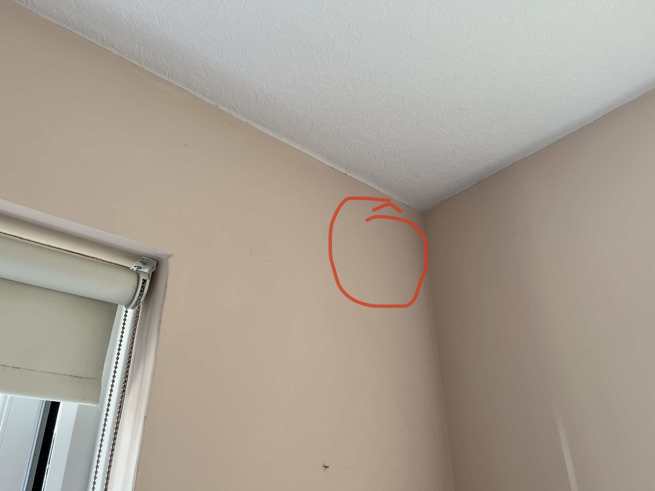

LLL Posted June 13, 2025 Posted June 13, 2025 I’m planning to drill a hole in the kitchen wall to vent cooking smoke outside. The hole will be located near the corner of the wall, approximately 50–60 cm from a window frame. It will likely be 100–150 mm in diameter. This is the ground floor and the right side of the wall is another room. Are there any structural concerns I should be aware of? thanks

Spinny Posted June 13, 2025 Posted June 13, 2025 Structurally you would want to check which way the joists run in the ceiling above and where they are positioned. If there is a joist running across the room with the end bedded into and supported by the wall that has the window in it, and the joist is above the hole you plan to make, you might end up cutting out masonry supporting the end of the joist. Also look for any electrical sockets or switches etc which might be vertically below your planned hole, as sometimes electrical cabling can be run vertically down the wall behind the plaster to feed the electrical point or switch.

LLL Posted June 13, 2025 Author Posted June 13, 2025 1 hour ago, Spinny said: Structurally you would want to check which way the joists run in the ceiling above and where they are positioned. If there is a joist running across the room with the end bedded into and supported by the wall that has the window in it, and the joist is above the hole you plan to make, you might end up cutting out masonry supporting the end of the joist. Also look for any electrical sockets or switches etc which might be vertically below your planned hole, as sometimes electrical cabling can be run vertically down the wall behind the plaster to feed the electrical point or switch. thanks for the professional advice, this is something I did not think of, I only worry that it is too close to the window and may break the beam on the top, but if it is 50-6cm away, I thought that is fine. regarding the joist, I thought if the hole is very close to the wall, see the pic, there should be no joist?

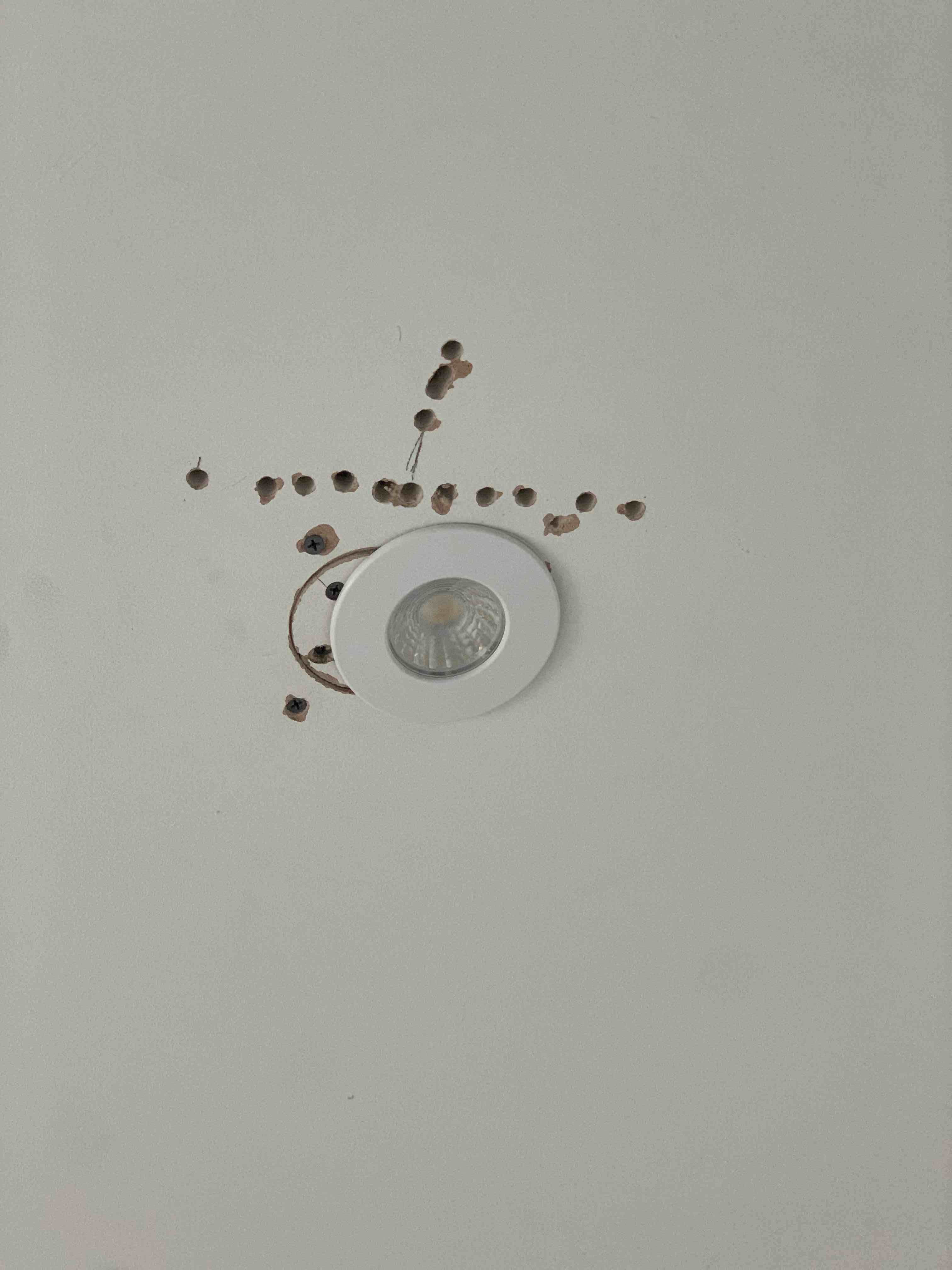

Spinny Posted June 13, 2025 Posted June 13, 2025 (edited) 46 minutes ago, LLL said: thanks for the professional advice I ain't no pro. I am an innocent lost in a building maze trying to find the way out. Lintels over doors and windows usually project about 150mm beyond the opening itself, so going say 200mm away is likely to be ok. But if you did hit a lintel you would notice and stop. Gently drilling a small hole with a drill could be used to see if a given point is clear of the lintel. Just worth checking joists - take a floor board up upstairs ? or use a screw detector to look for plasterboard screws into the joist, or tap the ceiling to see where it is and isn't hollow, or do like my sparky in the photo and drill baby drill. If the joists run the other way you should be OK anyway. Edited June 13, 2025 by Spinny
