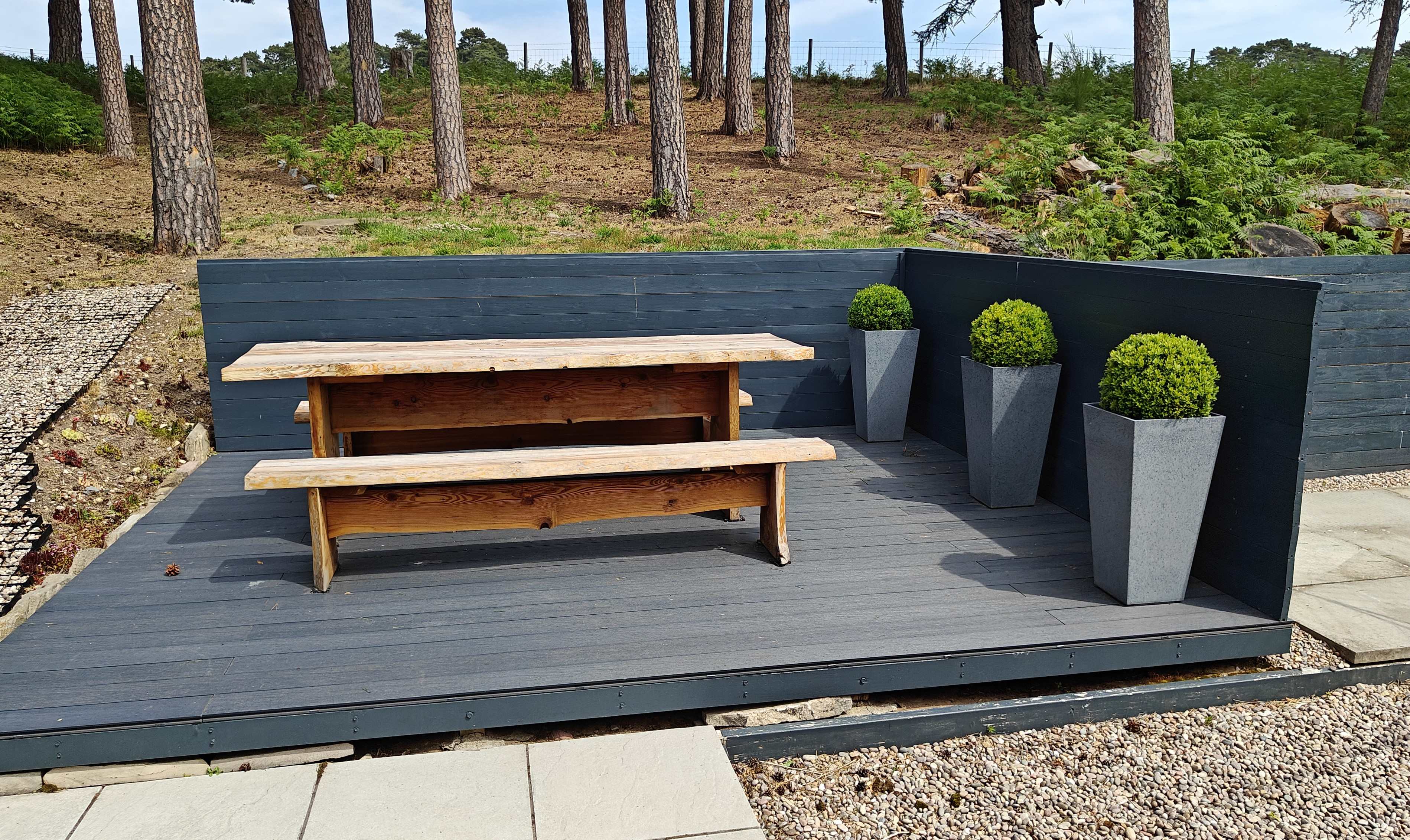

Planning a new pergola on an existing decking.

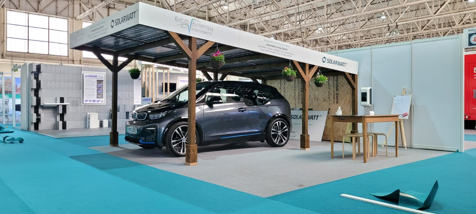

You can get Solarwatt panels which are frameless and less densely populated with PV, which allow more light through, if that’s of any interest / benefit?
They do another which is framed too, but a bit denser, still lets some light through though.
You can see it here, on a gazebo / carport doodah I made for my mates solar company. This is the best pic I can find which shows it.
The light lines under the panels are areas of clear glass with natural light coming through.
Solarwatt panel frameless

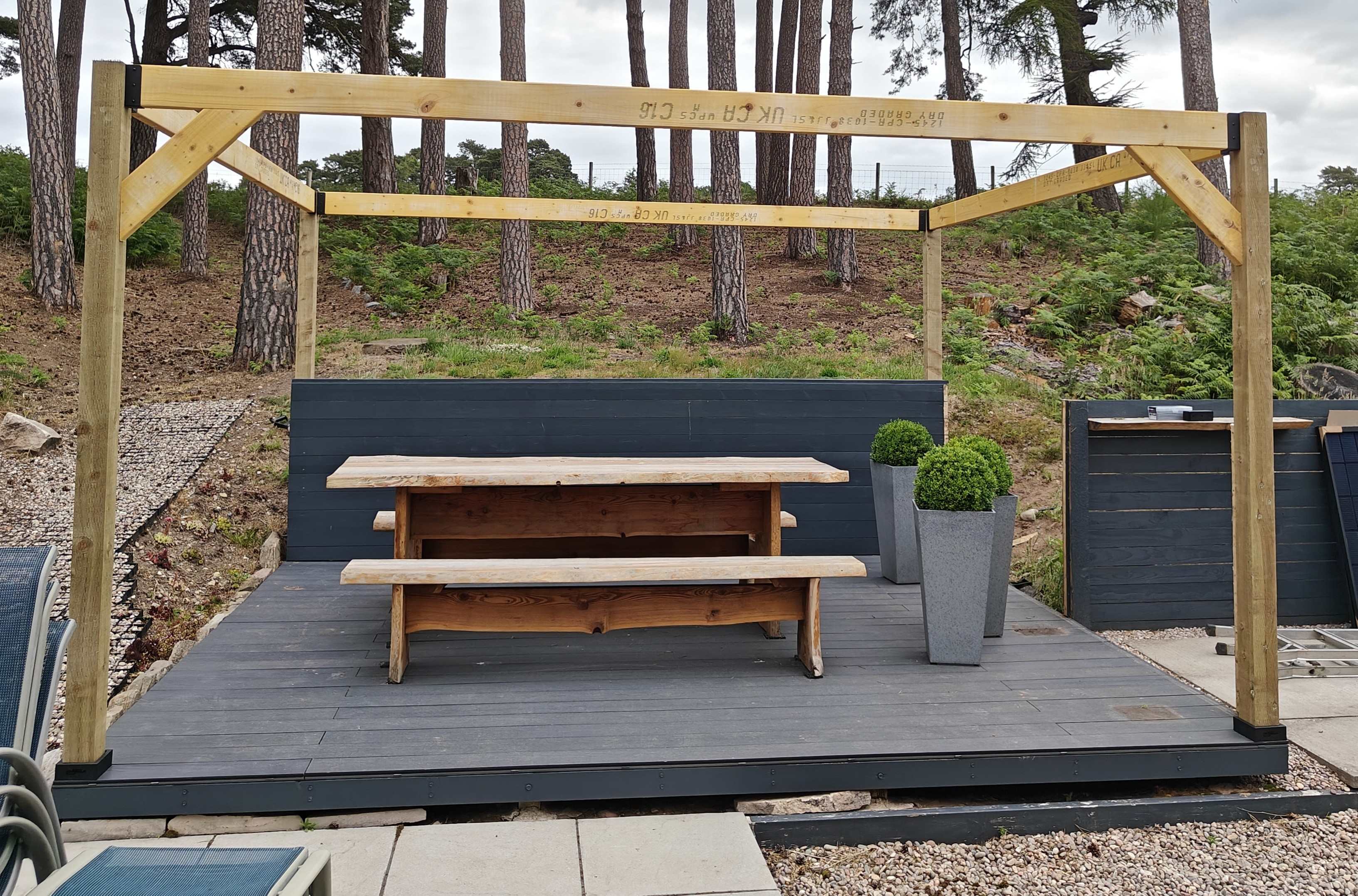

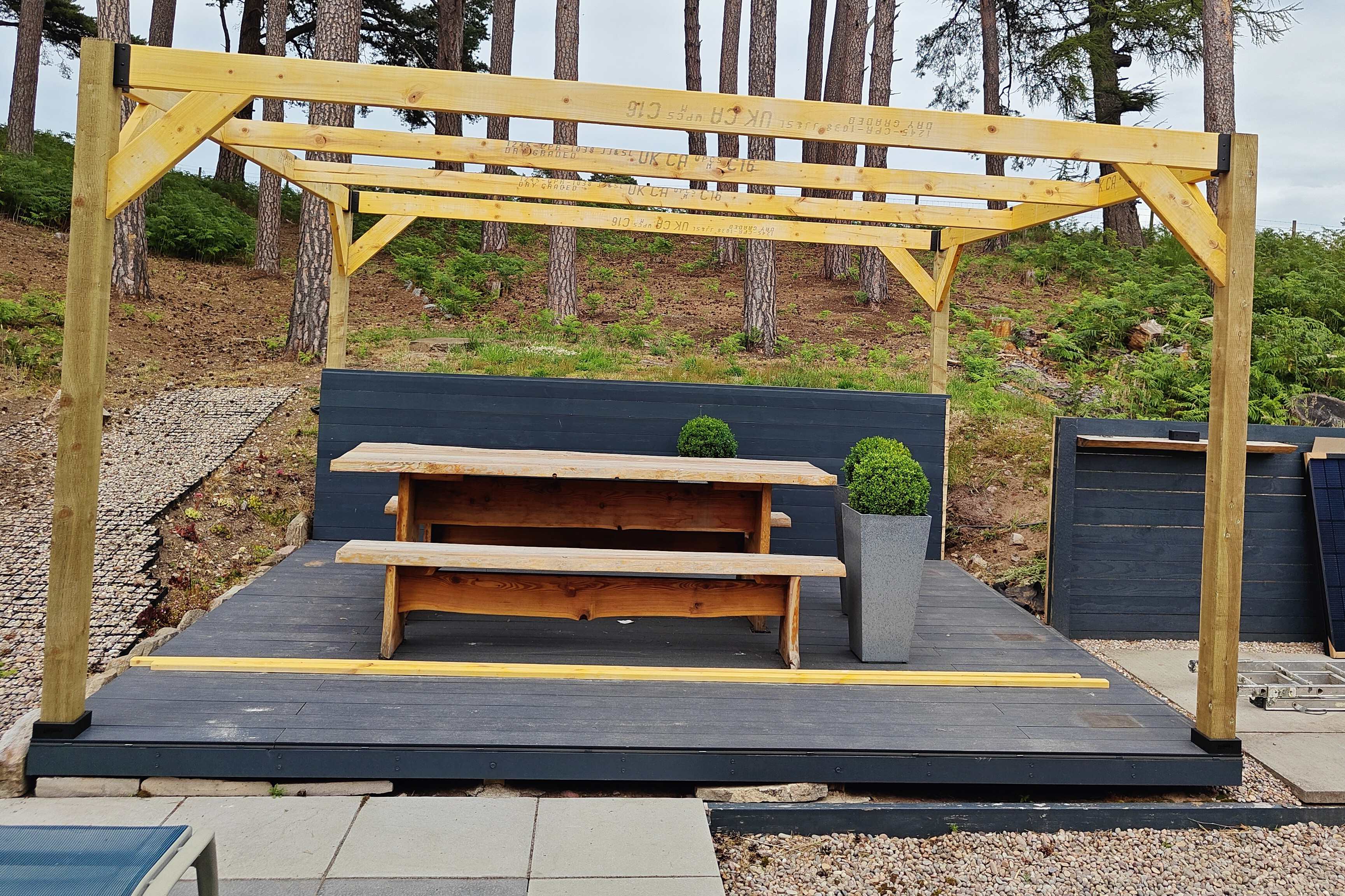

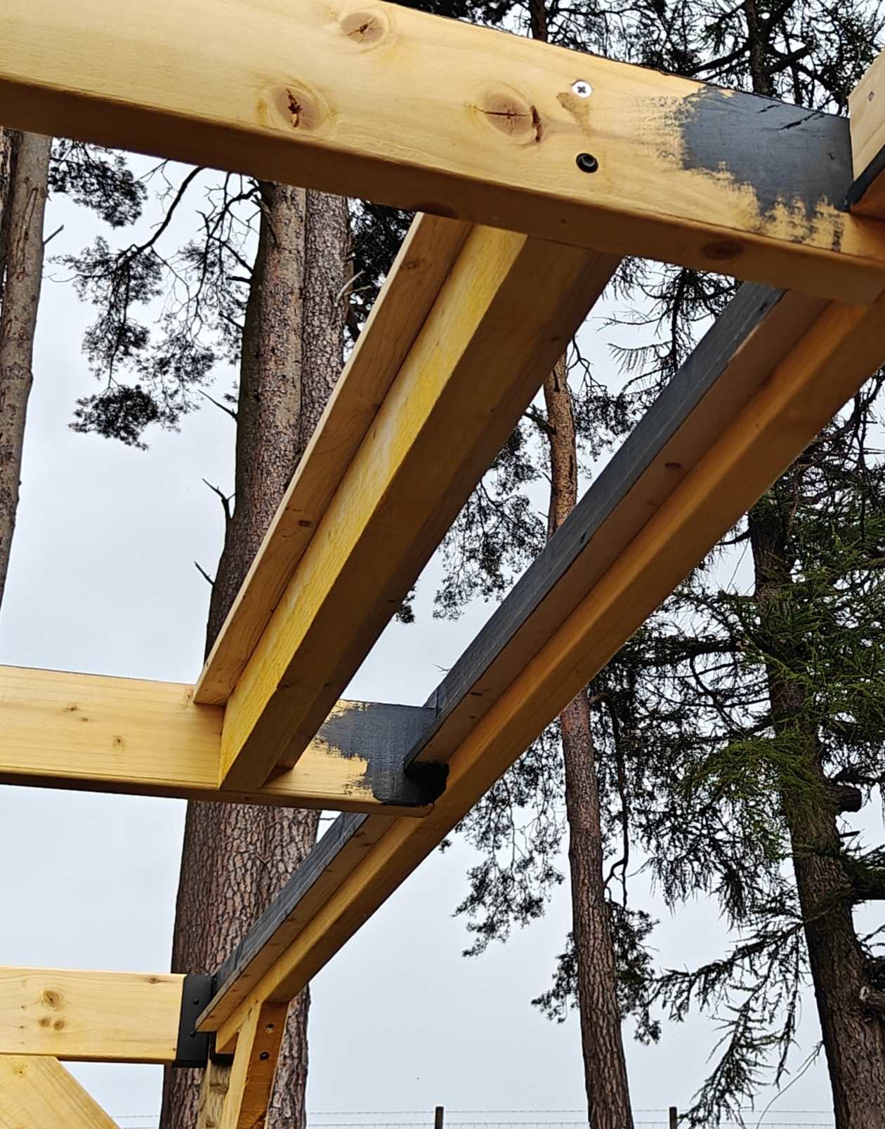

So day 1 working on my own, will finish corner bracing tomorrow and look at PV mounting. Posts are 100mm square. Side rails are 6x2. Rear vertical posts are screwed to existing decking posts which go up to the height of the rear wall. Used 3x 200mm structural screws on each post.
Progress today - photo a bit squint, not the decking.
All diagonal braces fitted. Two stringers to hold PV panels, reduced in height by 30mm to match PV panels. Flashing tape installed on top of PV mount stringers.

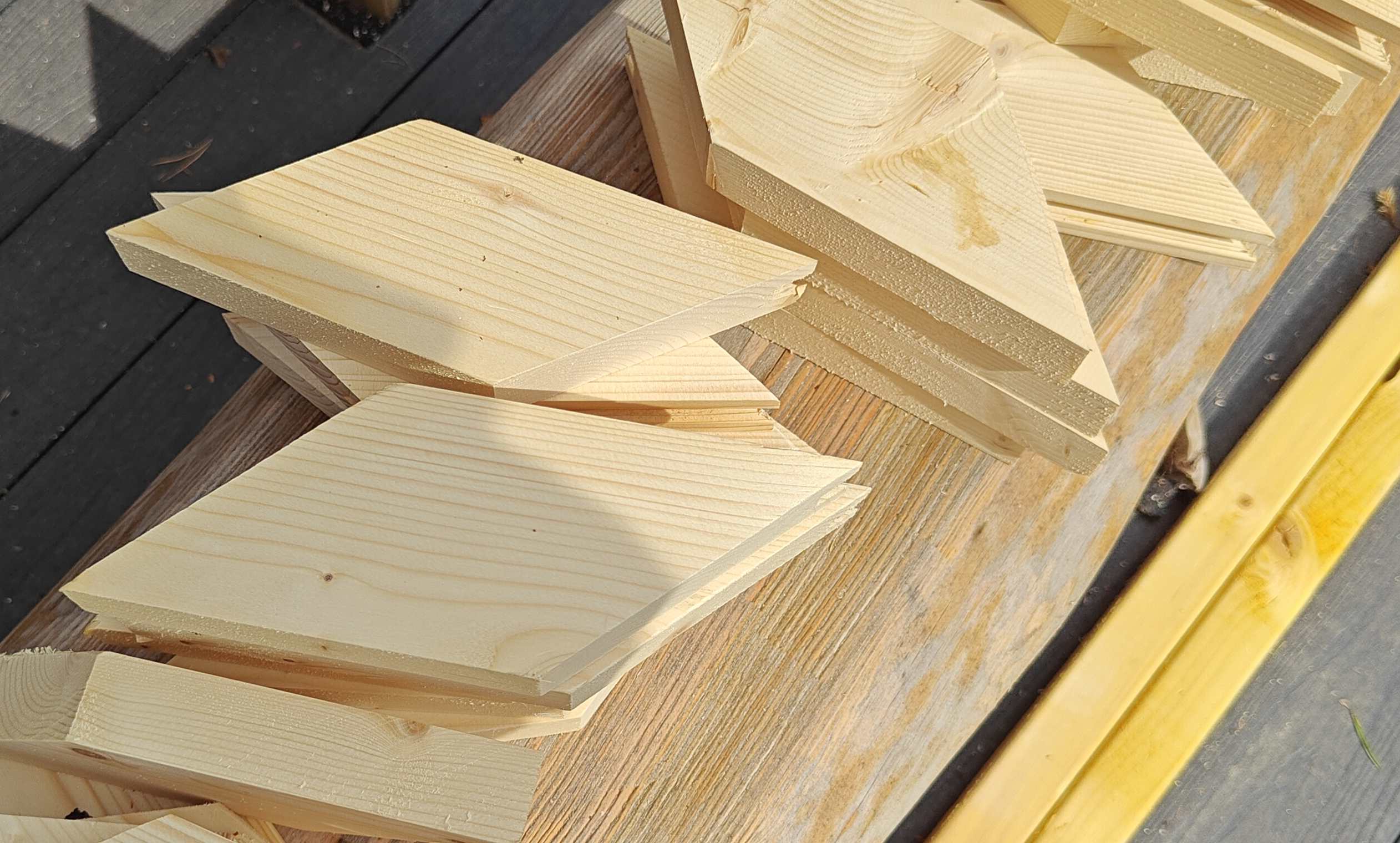

Lots of 45 Deg spacers to make tomorrow for roof slats. Lots of wood to use from other projects for that.
Not much to show for the last couple of days. Plenty of work but photos don't show much.
Cut lots of spacers for the roof slats, these are made out of floor boards I didn't use in the summer house.

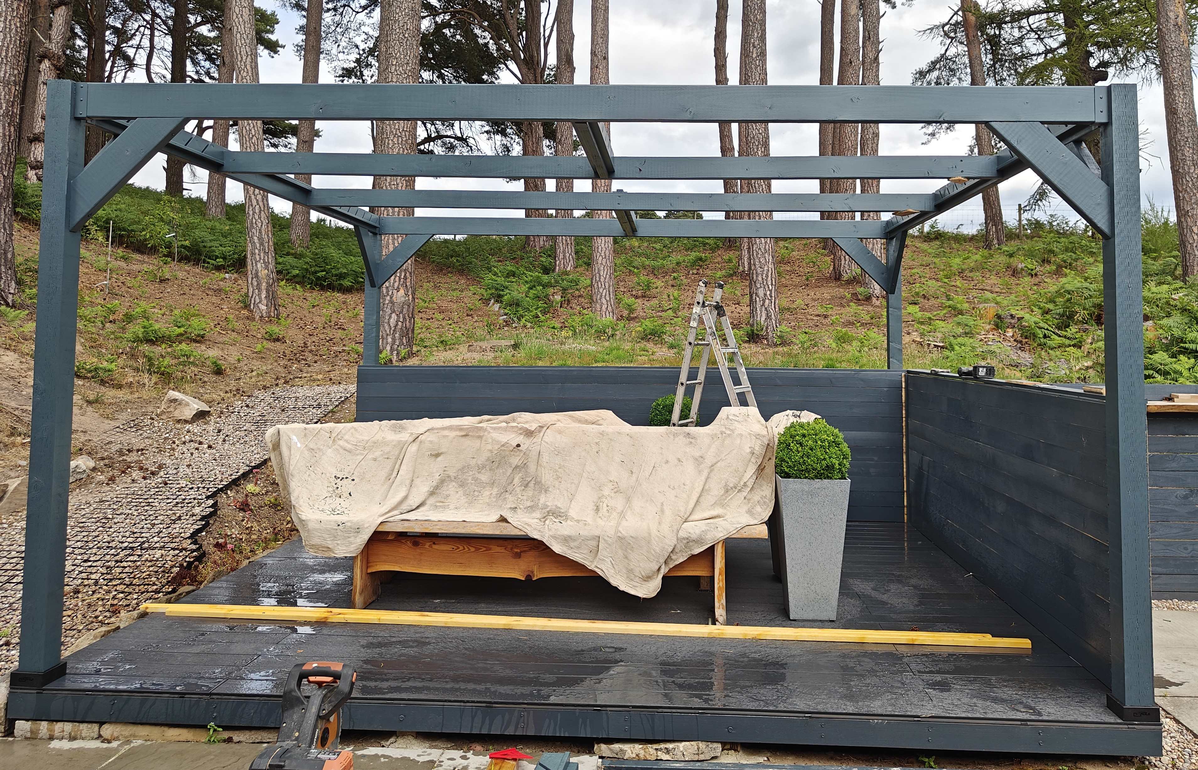

And finally sanded the whole structure prior to painting. Too hot to paint at the moment - for me and the paint.

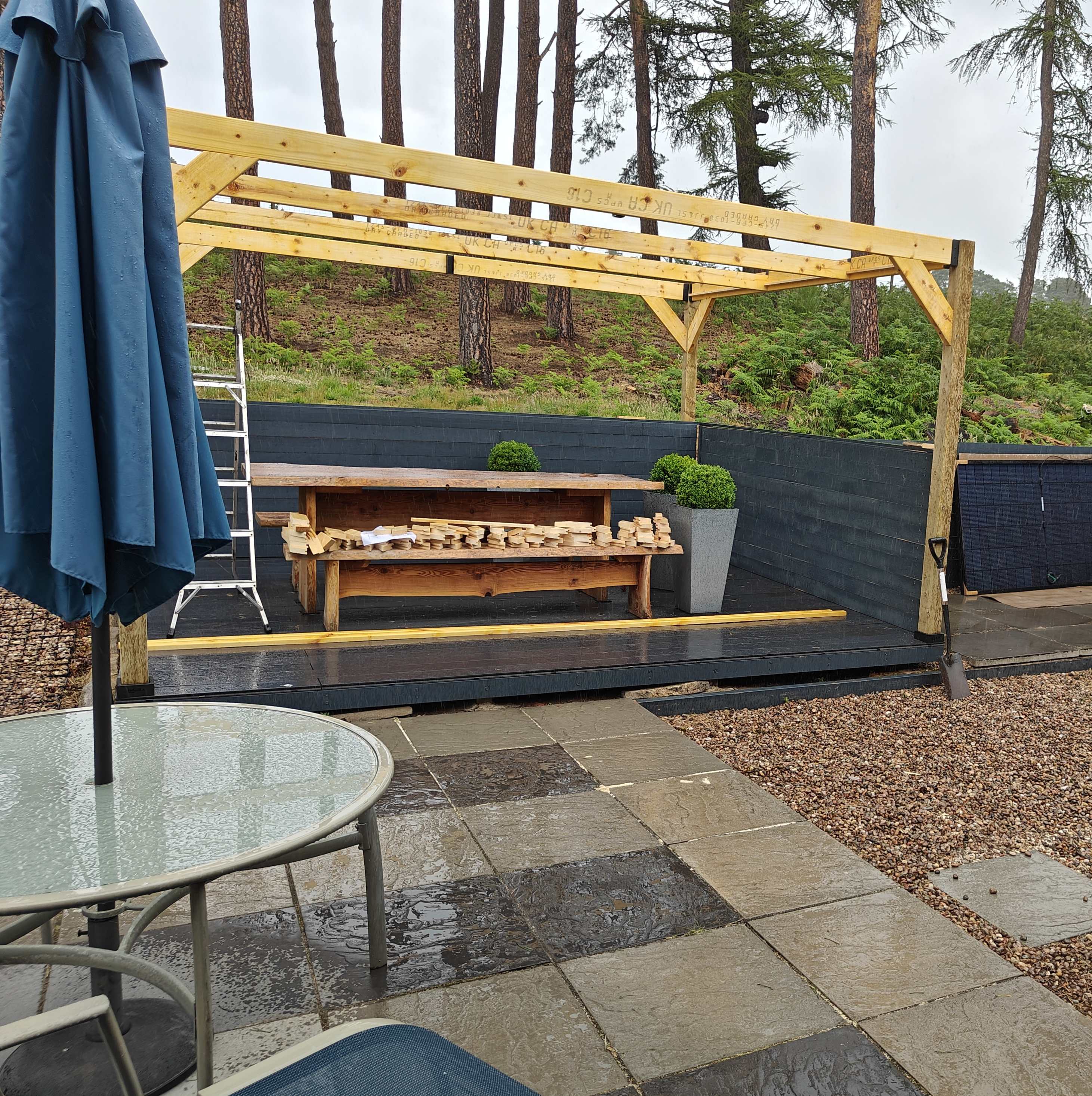

Rain forecast tomorrow, so not sure of the progress tomorrow, but would like to reassemble the half wall, I took down, but make it slightly shorter, to miss the new front right pergola post.
A bit of progress before the rain. Previous wooden wall shortened and reassembled.

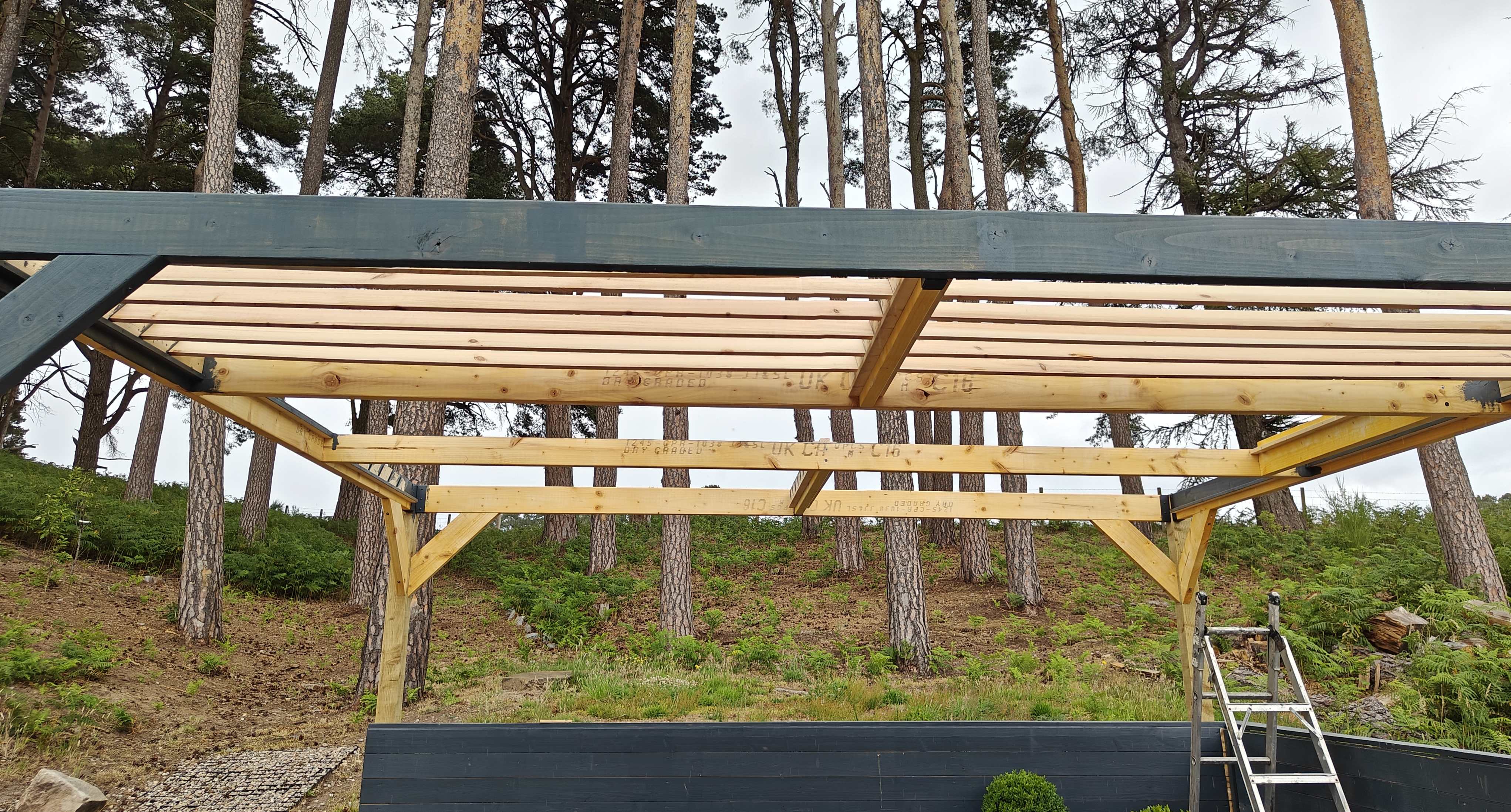

Started the roof and added some more structural timber to roof.
Ended up with a very short section of roof at end of the PV panels. But a plant will be located directly below so will be watered every time it's raining.
Started painting but rain kept starting so have abandoned that for now.

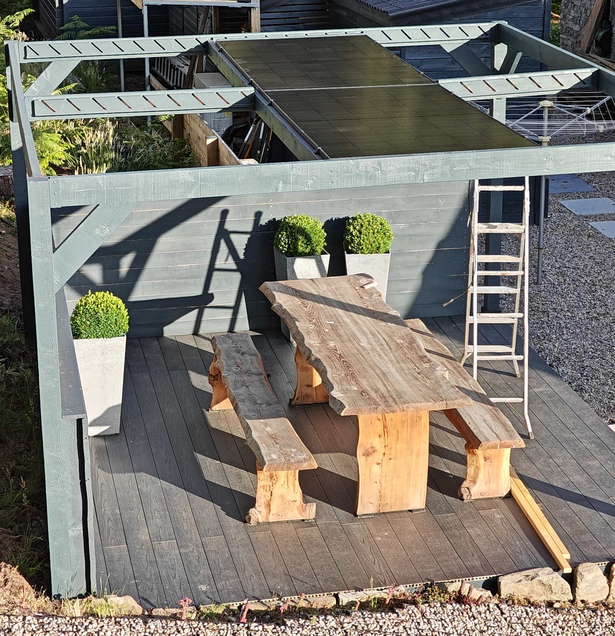

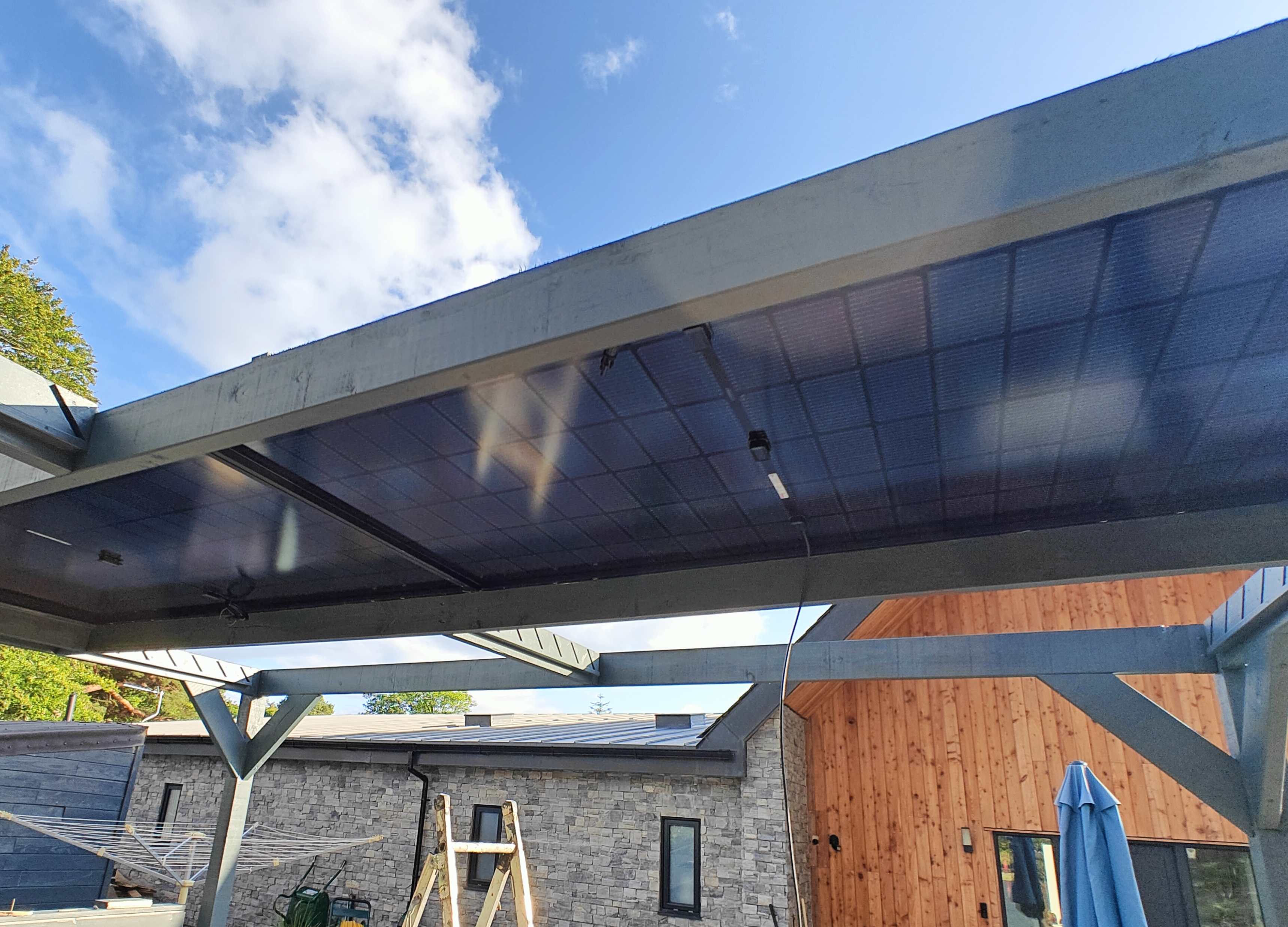

Solar panels on - 10 minutes for two of us.
From above
From below
Paint slats next and wire PV up

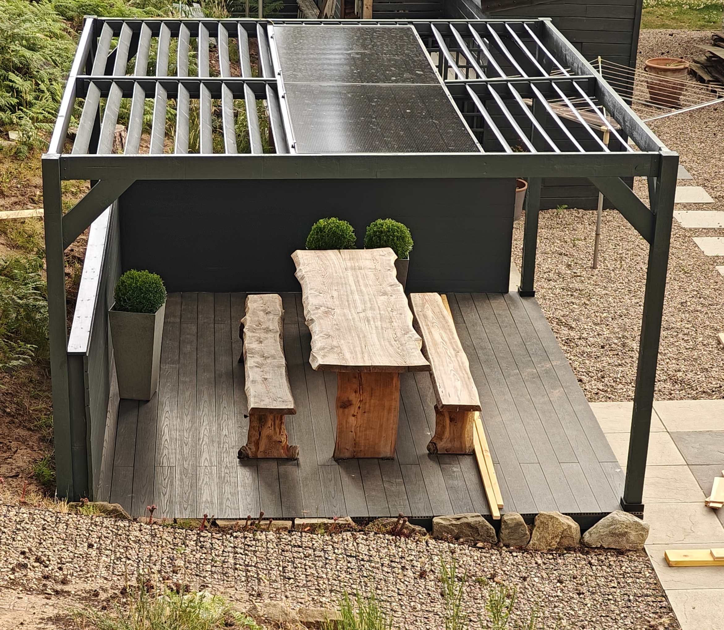

PV all connected and commissioned. Generating around 800 to 900W in full sun. So not bad, considering how far north we are, and the panels are flat at zero degrees.
Slat painting tomorrow.

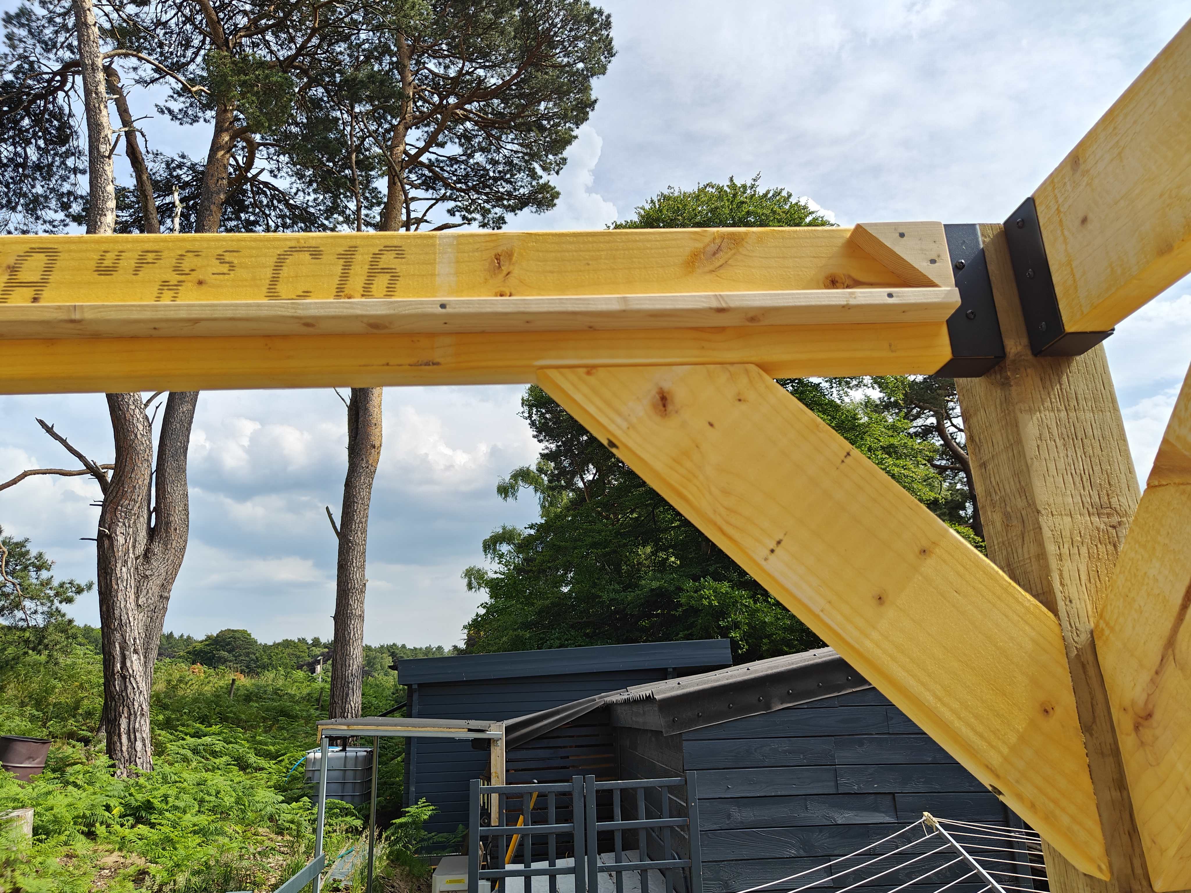

Had an issue developing with one of the roof beams. Had used C16 wood and one has quite a lot of knots. Anyway it started to save quite a bit around 40mm when I took it off.
So have replaced all the roof timber with C24 and added 2x 460W panels. So in theory 1.92kW of panels. However have retained the 1kW inverter (checked the voltages etc and all within limits). The 460W panels will clip the 500W panels a little, which is ok as I am only running against the 1kW inverter.  Looking for more time running decent number of Watts - so a long day at close to 1kW. Photos to follow.
Will be adding drainage clips to the panels to help move the standing water and debris.
