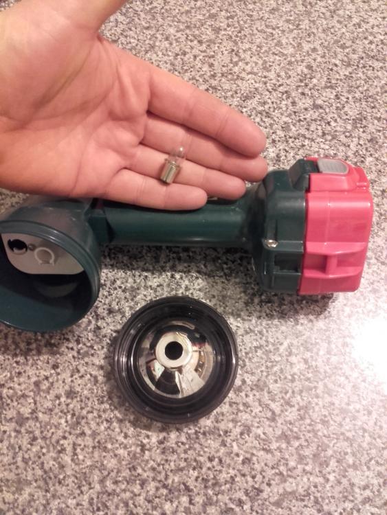

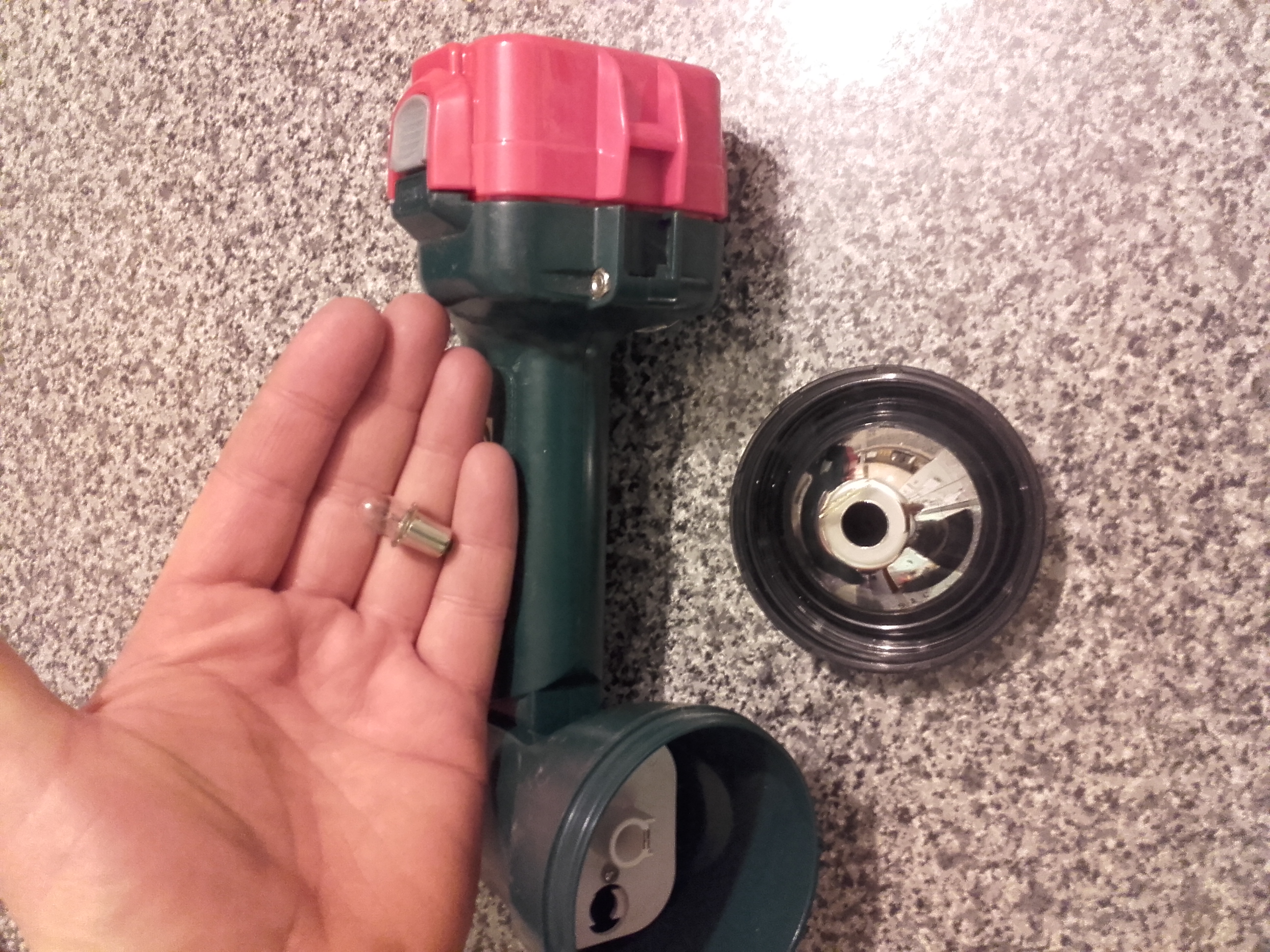

Onoff Posted December 21, 2017 Share Posted December 21, 2017 Where to get LED replacement? This one's 12V/0.7A. I'm seeing Cree ones at a tenner a pop! Anyone else upgraded their old torches? Cheap Chinese ones by the bucket load on eBay but SO many sellers! Link to comment Share on other sites More sharing options...
