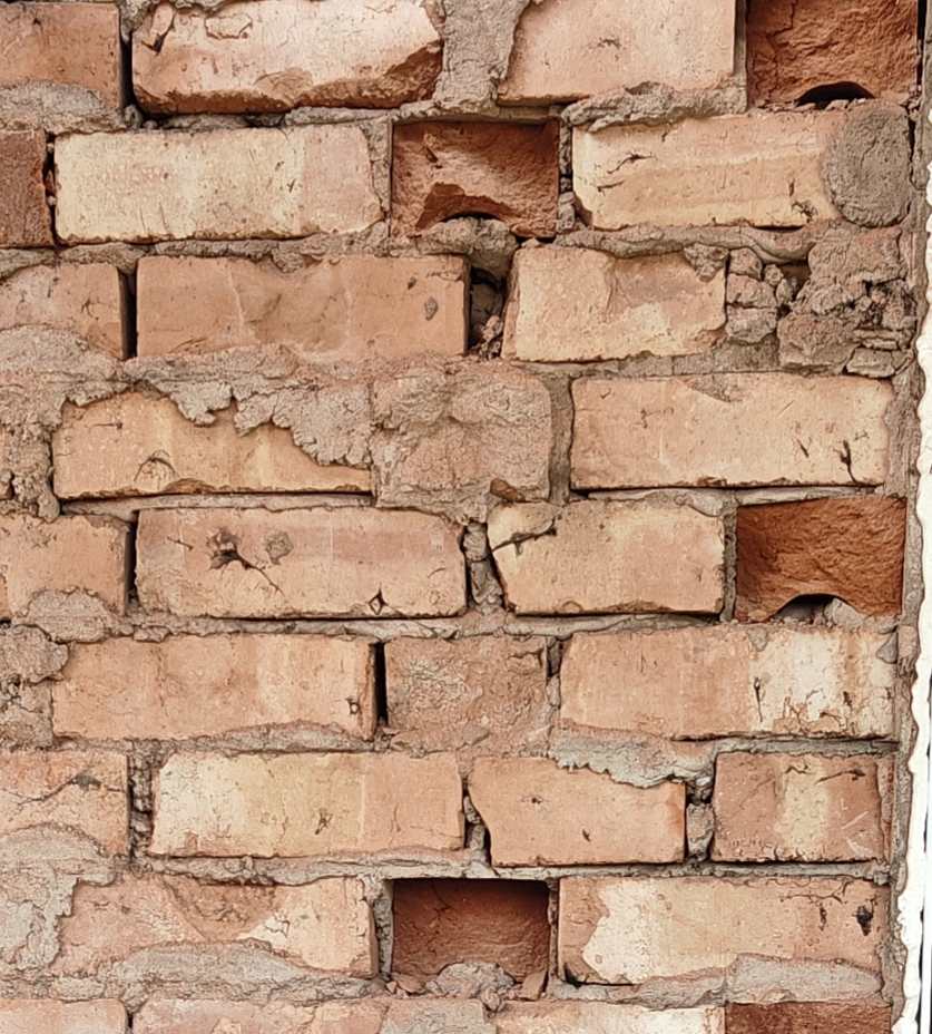

Firstly, as you appear to describe it, it is not a cavity wall. Is it all stretcher bond (long bricks only visible?). On a 'solid'  (never mind about the 10mm gap - it's effectively solid) wall the ties are in the form of bricks laid at 90 degrees, so for example you may see: header (short brick, i.e. brick laid across the 2 skins); stretcher (long brick), stretcher, header. Other patterns are also available. Can we see a picture?

I've attached a bit of the wall is exposed.

Can you show us a bit more? The 'half-bricks' we can see could be headers (the ends of long bricks) but if that's an opening to the right they may be 'true half-bricks'

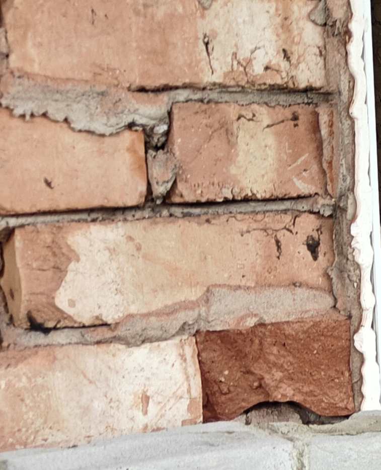

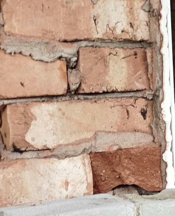

I've attached another photo that's all of the exposed element currently, I will try take a better one tomorrow.
Now looking at it the small bricks look like they could have been used to bond the two walls together?
The picture above, are all those half brick ends we see cut off as you removed ne skin?  If so as @Redbeard says they are the bonds.  Now they are cut off your new "outer skin" won't be bonded to the inner.

I've got a feeling thats what they were. The inner skin will be coming out as part of its a chimney breast, and have to be rebuilt with blocks or something I assume. Is it possible to bond them together if rebuild the inner skin of the section?
I think I would stop right there.  You are dismantling an existing wall with no knowledge of it's construction and no clear idea how you are going to rebuild it and if that will be structurally sound.
I think you need professional advice before you go any further.

Agreed. You can't remove half of a sold brick wall and rebuild the removed half in new bricks as is currently being done; it's almost certainly not going be structurally safe. And, since you're not replacing like-for-like, you also need Building Regulations approval.
Ooh err! Only just seen your 2nd pic. A little unnerving! Agree with @ProDave and @Mike re ?? stability. I think your plan to completely re-face the wall is at best ambitious. Even if you drop the plan now you still have a 2nd skin to build which will not be tied-in as it once was. You will have to fit screw-in ties to the old wall so that the new bricks can be tied in, or perhaps you could do it with resin anchors.
