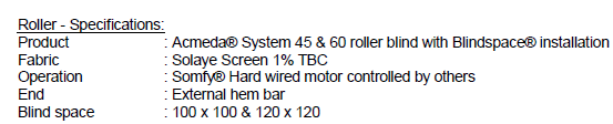

This is what the company have listed - image.png.d23f7df6c7e9f100e6908ba1535274c8.png
They are 230v and I will be using the Nano2relays, I presume I can just loop the feed in to 3/4 fuse spurs and have a feed from each to the motor,Nano2,tree cable and feed cable?
