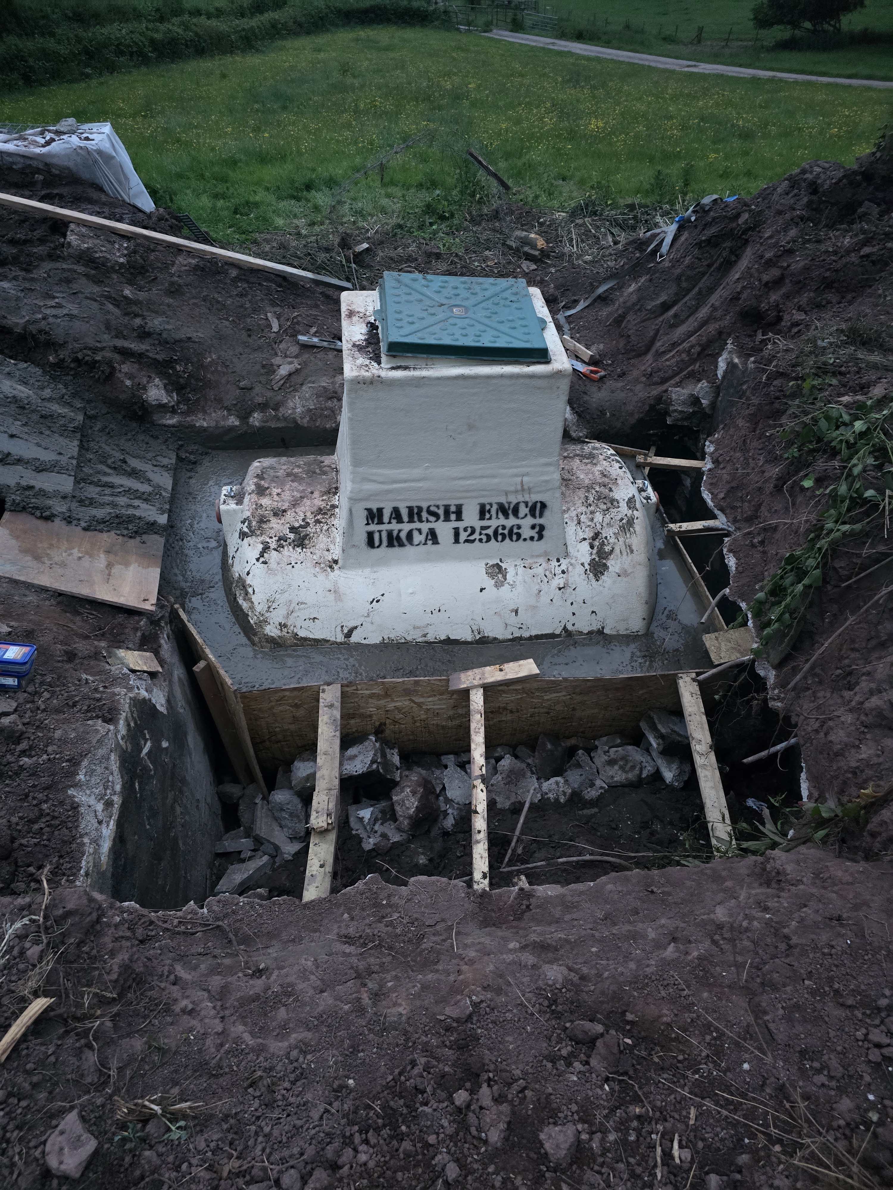

martynjl Posted Sunday at 09:21 Posted Sunday at 09:21 We've decommissioned our old cess pit, and removed a wall, and placed our new treatment plant into it, it's been concreted around the tank, 200mm below the outlet level, this is purely to anchor the tank in to place and as we're now passed the widest part and the tank, it's impossible for it to pop up. I now have about 1.2m left to back fill over the tank, and as I had to hand mix the concrete, and move the ballast a long way I'm not keen to do more concrete. Marsh say the concrete is only an anchor and not to protect the tank. Has anyone just backfilled with soil? Or will this be heavy for the tank?

Russell griffiths Posted Sunday at 09:52 Posted Sunday at 09:52 Just ensure the soil doesn’t contain large stones, backfill by hand and compact in layers of 150mm just with your feet, don’t use a wacker plate on top of the tank. wacker plate or substantial compaction around the surrounding area.

martynjl Posted Sunday at 10:58 Author Posted Sunday at 10:58 1 hour ago, nod said: While I’m not a tank expert One will be along shortly I have installed our last two The first one being in six years now I sat ours in 3 cube of semi dry concrete Then back filled with clay and soil 1 hour ago, Russell griffiths said: Just ensure the soil doesn’t contain large stones, backfill by hand and compact in layers of 150mm just with your feet, don’t use a wacker plate on top of the tank. wacker plate or substantial compaction around the surrounding area. Thanks Russell. I've seen your old replies to people facing similar situations. I was just concerned about the soil getting wet and adding a ton more weight and the whole thing collapsing. But then again I can't see gravel back fill (recommended by manufacturer) weighing less than soil. Your suggestion would make my life so much easier
Russell griffiths Posted Sunday at 13:21 Posted Sunday at 13:21 2 hours ago, martynjl said: Thanks Russell. I've seen your old replies to people facing similar situations. I was just concerned about the soil getting wet and adding a ton more weight and the whole thing collapsing. But then again I can't see gravel back fill (recommended by manufacturer) weighing less than soil. Your suggestion would make my life so much easier In that case you should follow manufacturer recommendations, all mine can be covered in soil.
