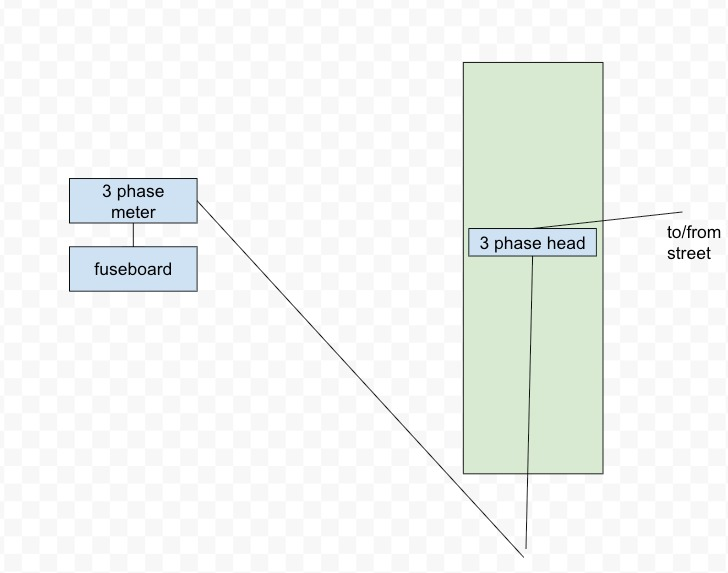

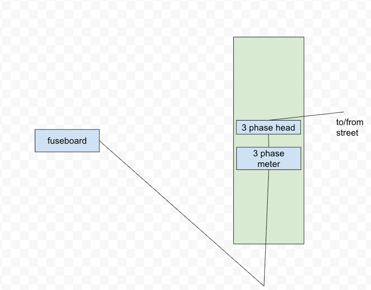

bmj1 Posted June 6, 2025 Posted June 6, 2025 Hi all - my current wiring is like this. All the plant is by the fuseboard. Is there any advantage at all to moving the 3 phase meter to be located by the fuseboard and plant ? (like the below) E.g. does this help if I start putting PV + batteries in, or exporting to grid, or anything else ? Or does it make no difference at all ?
BotusBuild Posted June 6, 2025 Posted June 6, 2025 I assume the PV will connected into the fuseboard (normal situation), therefore there is no benefit to moving the meter. 1
Kelvin Posted June 6, 2025 Posted June 6, 2025 (edited) Are you planning on putting an EV charger in at any point? You will need to run a cable back to the meter tails for CT clamps. There are other ways of doing this too. My meter is in a cabinet on our boundary with the main CU in the house and a CU in the garage. Octopus are installing the Zappi and want to run the EV cable direct to where the meter is. I hadn’t planned for this so have had to run a duct behind the wall and up to the cabinet, fortunately I had a spare duct into the cabinet. They also want to install a small CU in the cabinet but there’s no room in it (it’s a 3 phase sized cabinet but we are only single phase) Consequently I have had to install another electrical cabinet beside the main cabinet. The main thing is to plan for this by putting in a spare duct into your cabinet just in case. The PV panels are being installed on the garage roof and the batteries will be in the garage. I have a spare duct between the garage and the house to connect to the main CU. Edited June 6, 2025 by Kelvin 1
bmj1 Posted June 6, 2025 Author Posted June 6, 2025 Thanks both: 1. PV into fuseboard would be easiest, so no benefit. 2. EV charger is actually located right by the cabinet with the head and meter, so moving the meter will be a pain (would need to run another thick armoured cable) Sounds like the best thing to do is keep them as they are ! Thank you !
