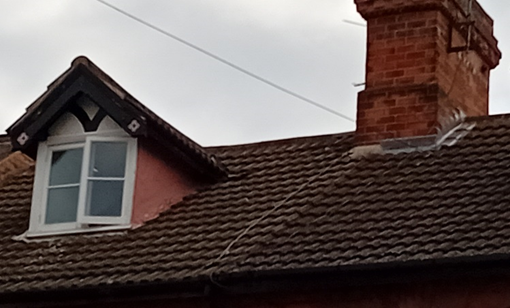

Its basically a cold roof, currently with limited amounts of mineral wool under the rafters. Also have a NW facing dorma. Continues below -->
My property inc.dorma,left, my roof adjoins neighbour to the right, @ mid-centre of chimney

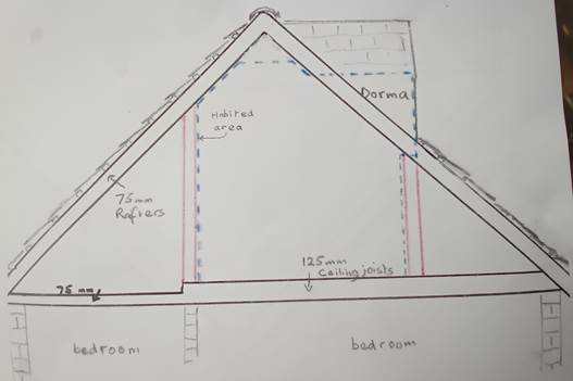

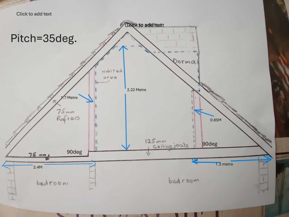

Section dagram :-
image.png.413e85574ace5a45d51acfab2c730c8d.png shows- habited area in green, stud dwarf walls in red.
Notes: (A) I see one immediate way for some u-value improvement – by ‘over insulating’ outersides of the dwarf walls, ie the 2 eaves (storage areas), compensating for deficits elsewhere. (but likely still insufficient).

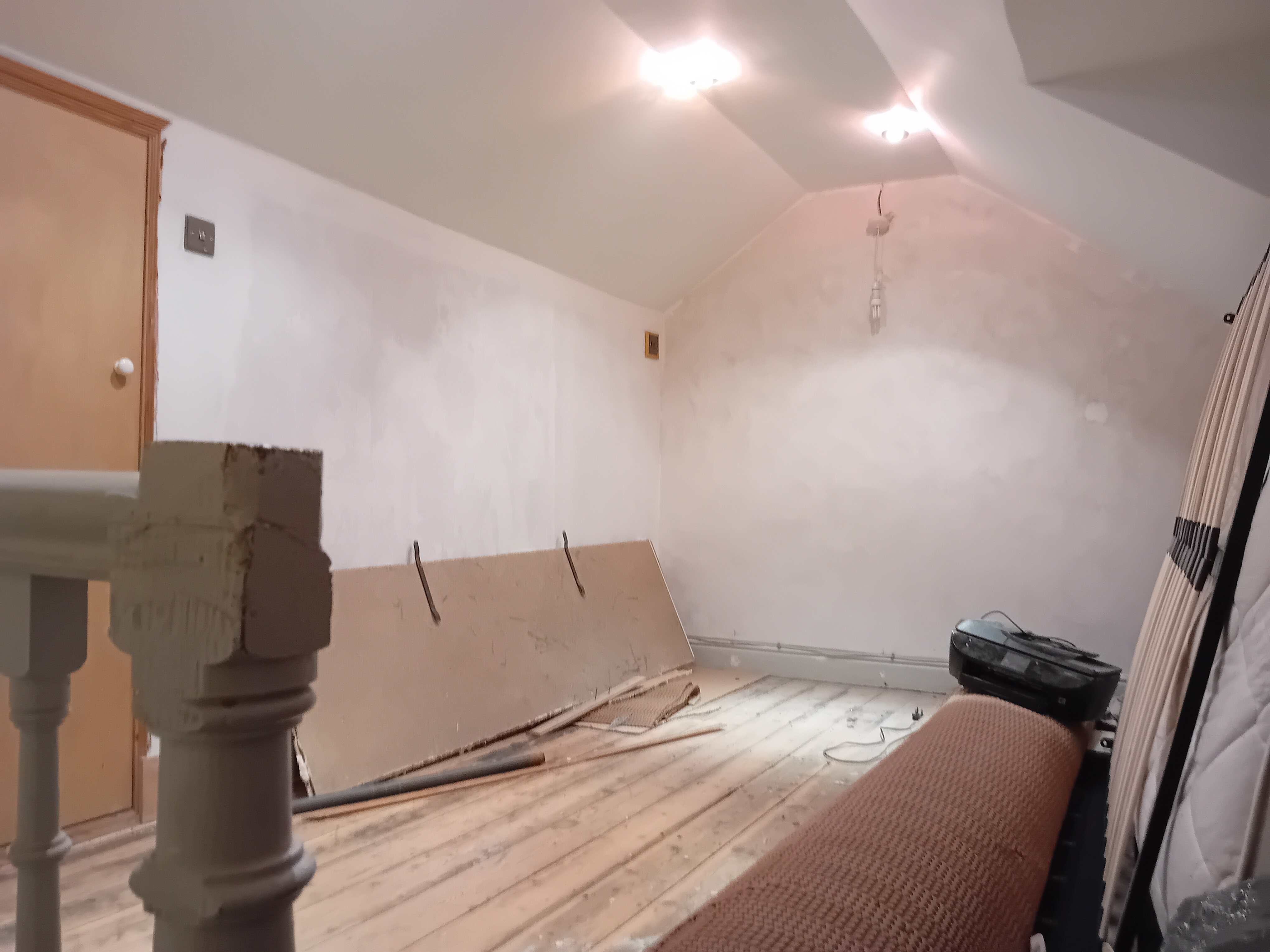

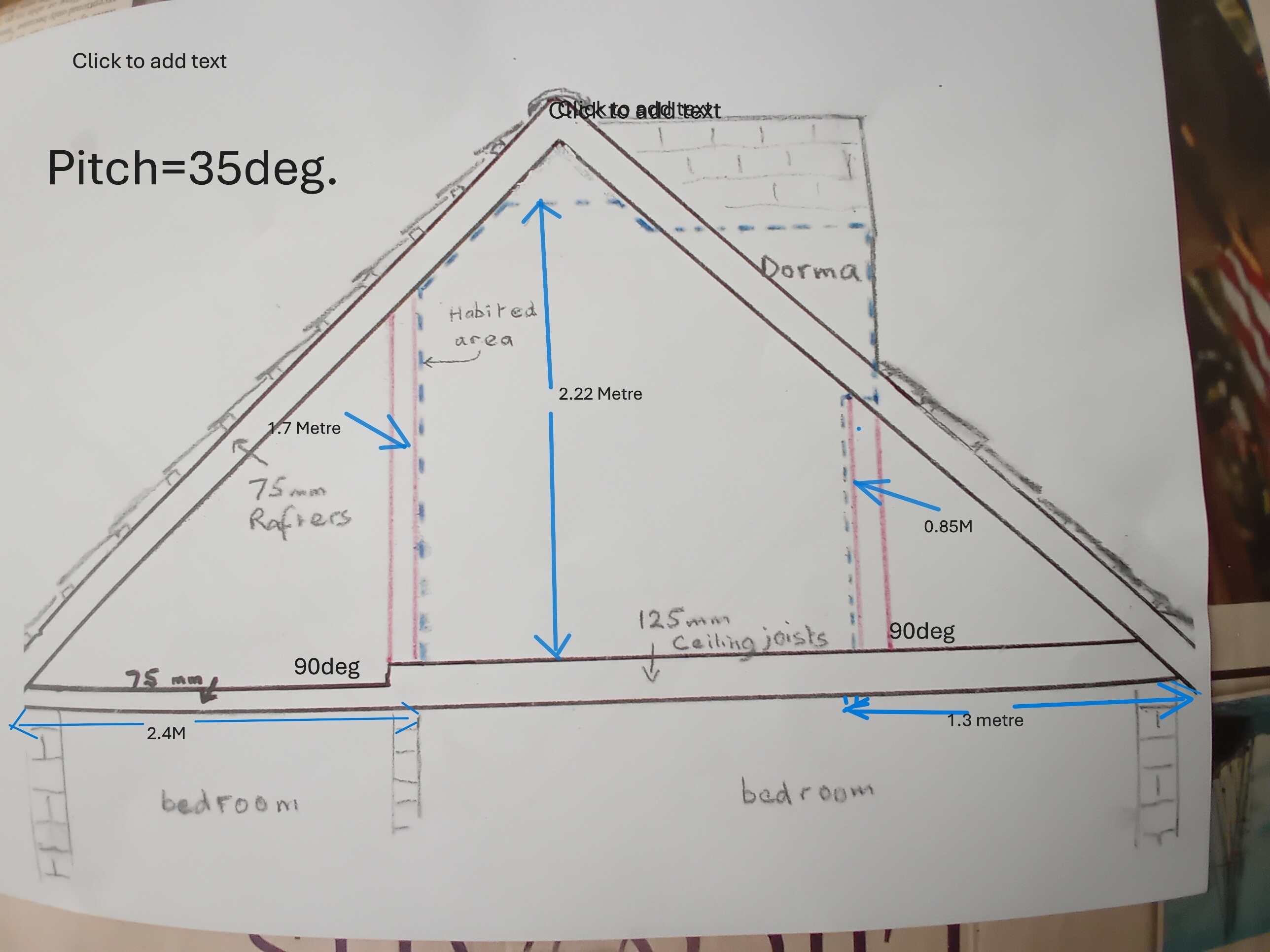

@Neverfinished, could you please post the dwg again with dimensions, so we can see what the pinch-points are? I am particularly unsure of how the 1.72m headroom 'kicks in'. Is it because the stair comes up under the sloping roof? Is there so much more headroom in the room itself that you could fit insulation under the rafters? Your statement below suggests not:

Many thanks@Redbeard your continuing interest in my roof+insulation upgrade. To answer yr Q's of last night hope the following helps:
1st pic is a 'section thru' my current roof as in my prior post but now with measurements. (It does include info too about the insulation currently in there but this likely ripped out during upgrade).
And here's a a pic taken from the entry point @ top of stairs:

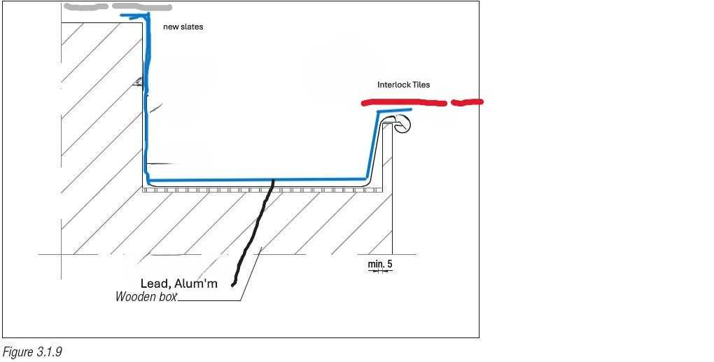

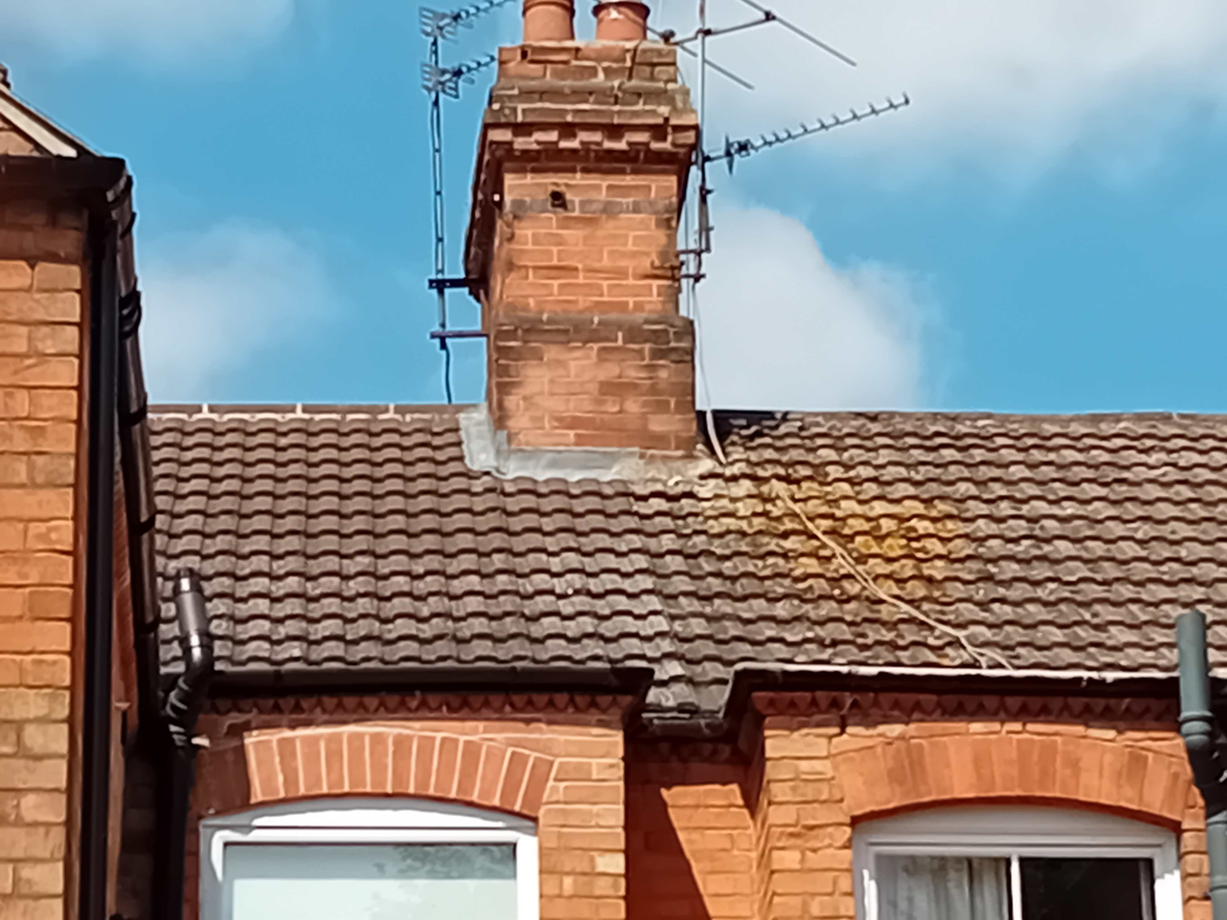

And, I've begun looking closely at the type of 'bonding gutter' I'll need at junction with neighbours roof (one side). A chat with a 'lead fabricator' / supplier has recommended a box gutter instead.
Photos below are:-
1, my current roof 'junction' (with neighbour); this runs down centre line of chimney.
2, This a perhaps suitable box-gutter design??
I'd much appreciate any views/suggestions from anyone on this aspect of the build. I'd employ a leadworker for such work but any independant views on this detail from forum members welcome, before I commit. Infact I can't find any photos of a box-gutter install on a roof like mine - only pics of where 2 (opposite) pitches meet together. Did the 'lead-worker' mis-advise me?
Any thoughts please, appreci\ted !

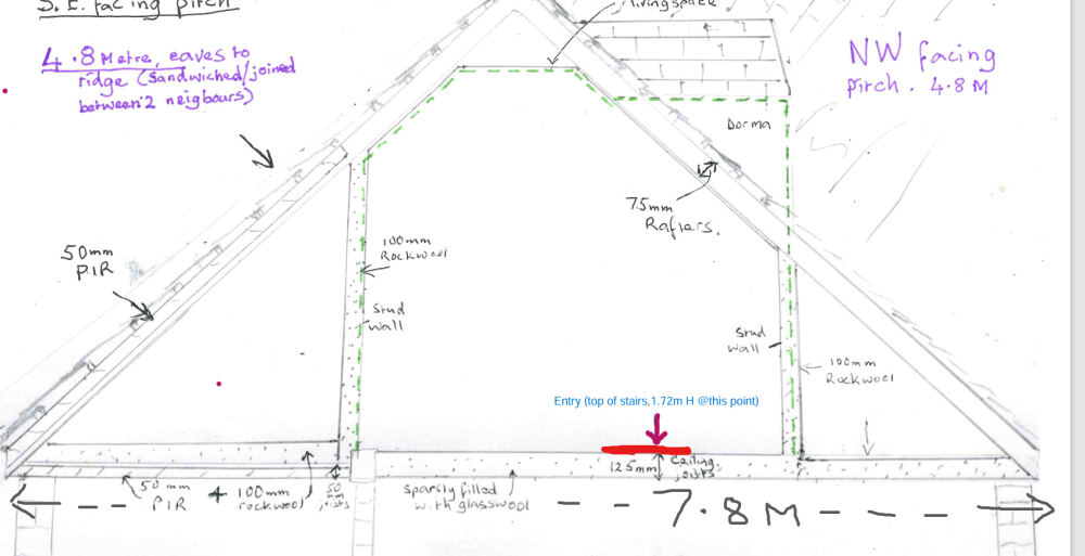

OK, so you have maybe decided to go for the +125mm on the roof (subj to Planning approval). But before you do that...
Can you add a dimension for floor to horizontal ceiling (I could draw it and measure it but (a) I am lazy and (b) I have lost my scale rule!). If it would not make things too crazy tight I have in mind a proposal to Bldg Control. For the width of the doorway 50mm PIR between rafters (leaves a 25mm vent gap which I regard as sub-optimal but as you are re-roofing with slate, get a really good membrane and you should be OK for that small area). That gives you a 'tunnel' to enter the room and you don't crack your head.
For the rest, 25mm PIR between rafters and 75 below, fixed at wide centres with insulation collars/screws and tightly taped as VCL. Plasterboard fixed directly below (which required you to remember where the rafters are under 75 PIR. For a loss of a further 25mm space, x25 x 50 battens at right angles to rafters over the PIR and adjust centres to suit your chosen boards (I can no longer wrangle 1200 x 2400 so I use 900 x 1800.
A very rough calc (unadjusted for the bridging of the rafters) for the main area with the 25 + 75 'sandwich' gives a U value of around 0.22W/m2K. You could propose that to BC as a compromise and quote the section from the Regs in my previous post. Note that even that reduced amount would give you about  9-10 times the insulation value of the un-insulated roof. They *could* ask you to have a SAP calc done to prove that doing it to the full std would have a payback of more than 15 yrs but I have only been required to do that once.
Edit: If you decide to go for the 'raise the roof' option be very clear on the design of the box gutter and the box it sits in. I would (could) be concerned about condensation on the bottom and sides of the metal box , wetting the timber box. Maybe consider building the 'under-box' out of Compacfoam or XPS? I would also get a roofer to express an opinion of the 'tails' on the box gutter. I would worry they are potentially too short/not profiled sufficiently.

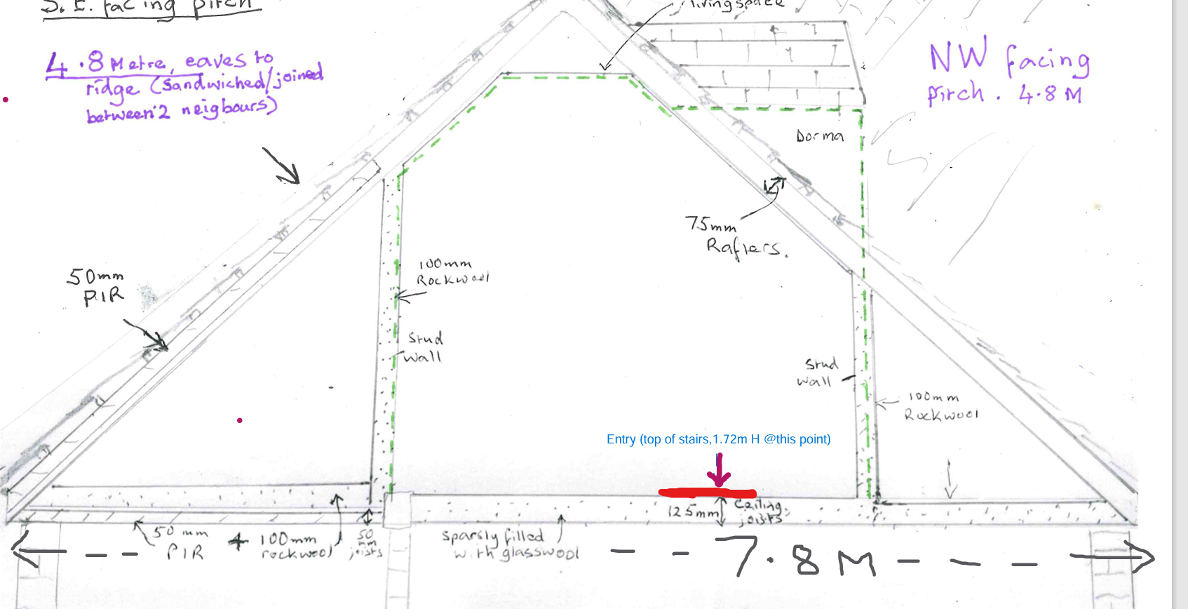

Thanks yet again @Redbeard for your latest suggestions & indeed I hadn't thought of this 'tunnel', & if I decide I can 'live with it' + convince B.C. this could be a way to avoid expense of raising the roof / insulation height.
I attach the diagram again but with various additional measurements.
Of course I could also add substatial amounts more insulation to those voids in both eaves, to (hopefully) create a much improved U-value & to compensate for deficiency elsewhere (though perhaps never able to get sufficient in) as you yourself mentioned a while back, as well as the 75 + 25 PIR you mention in yr prior post. If anyone knows how to calculate a u-value for these 2 'triangular voids' in Ubacus etc (filling up with rockwool perhaps) could be helpful.
Your 'tips' too about a SAP & a greater than 15yr payback period 'excuse' noted; then also your tips re materials for the box gutter construction sound helpful, thanks. This box gutter would be very much for a specialist to do, if I go that direction.
...and something I forgot to add about the box gutter. It is not just a condensation risk but also a whacking great thermal bridge, even if you mitigate it.
Re area-weighted U values:
Very roughly: 300 on the flat in eaves and 300 on walls, @lambda 0.044W/mK (U = 0.15W/m2K approx (no allowance made for 'base case' U value, but equally no negative allowance made for bridging thro joists/studs, so assume they cancel out.
