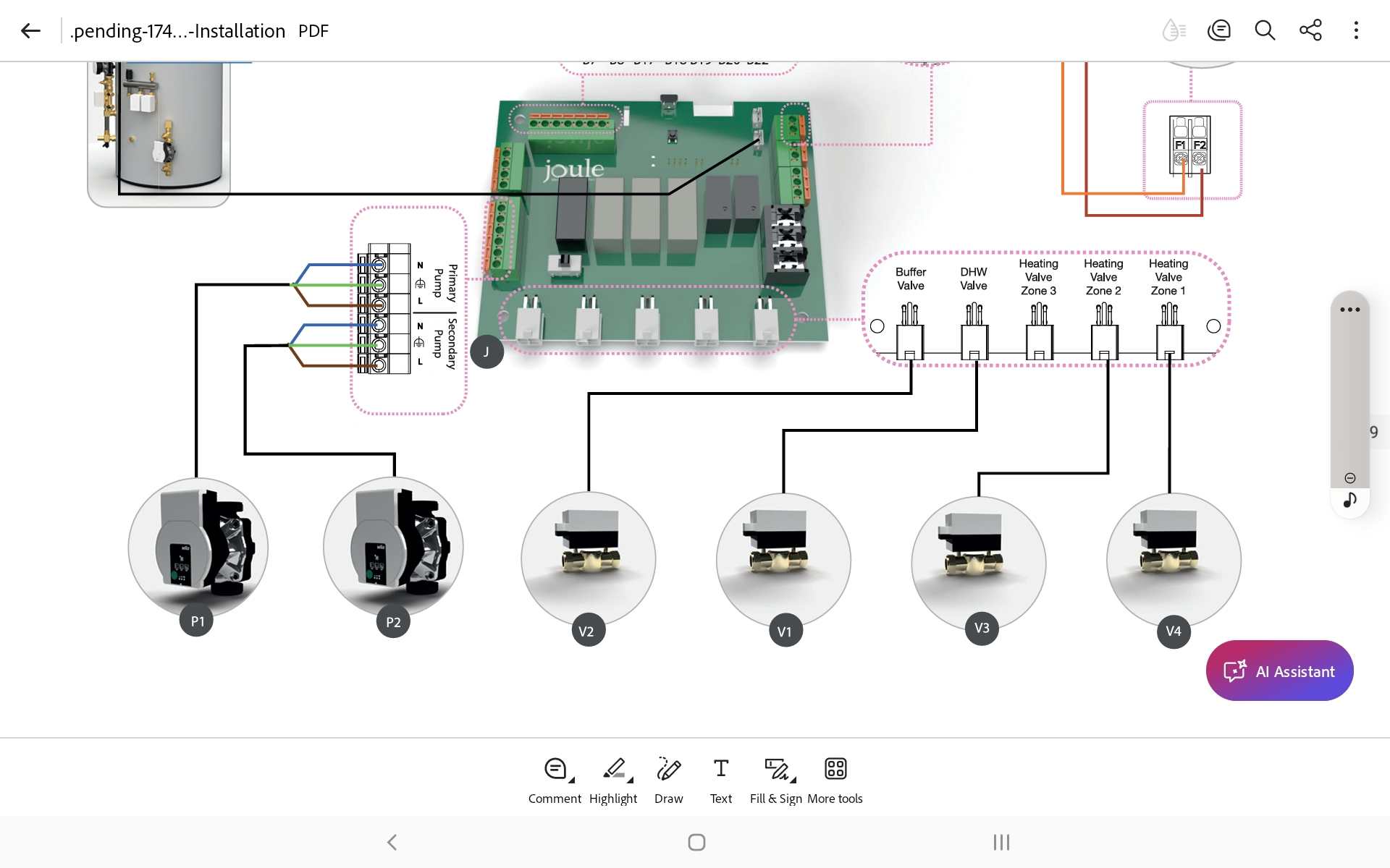

I noticed on page 59 of the install manual this diagram has a "buffer" zone valve output. Is your valve connected to that? or to the DHW output?
Screenshot_20250519-005840_AdobeAcrobat.thumb.jpg.81ae49f1c8628326c7ad6483d58b2284.jpg
That’s for a joule, with their own pcb. This is a pre-plumbed unit from world heat. The three port is working fine, and the zone valve is wired across the ‘zone valve1’ output (I forget exactly which terminal numbers it is on the Samsung MIM).

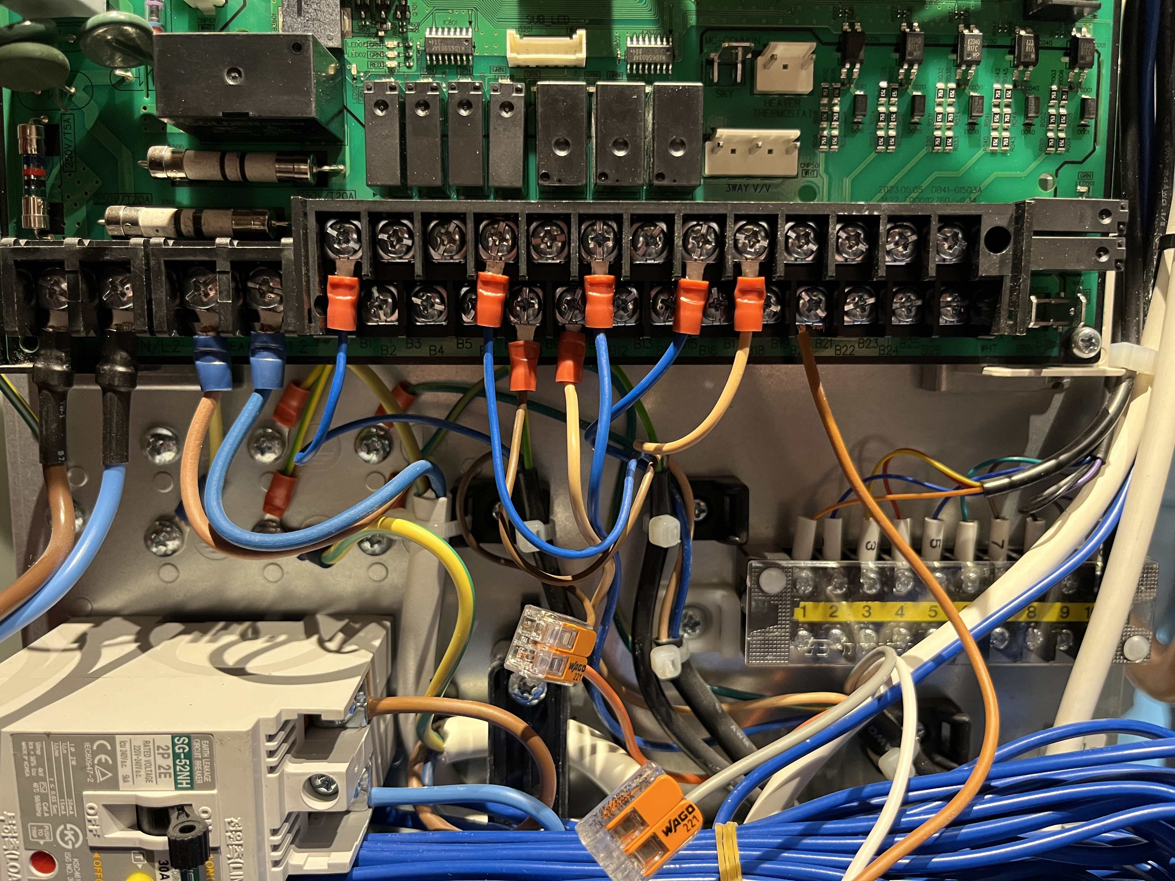

Zone valve is on 10 & 11, secondary pump is wago'd to orange... permanent live picked up off 20
