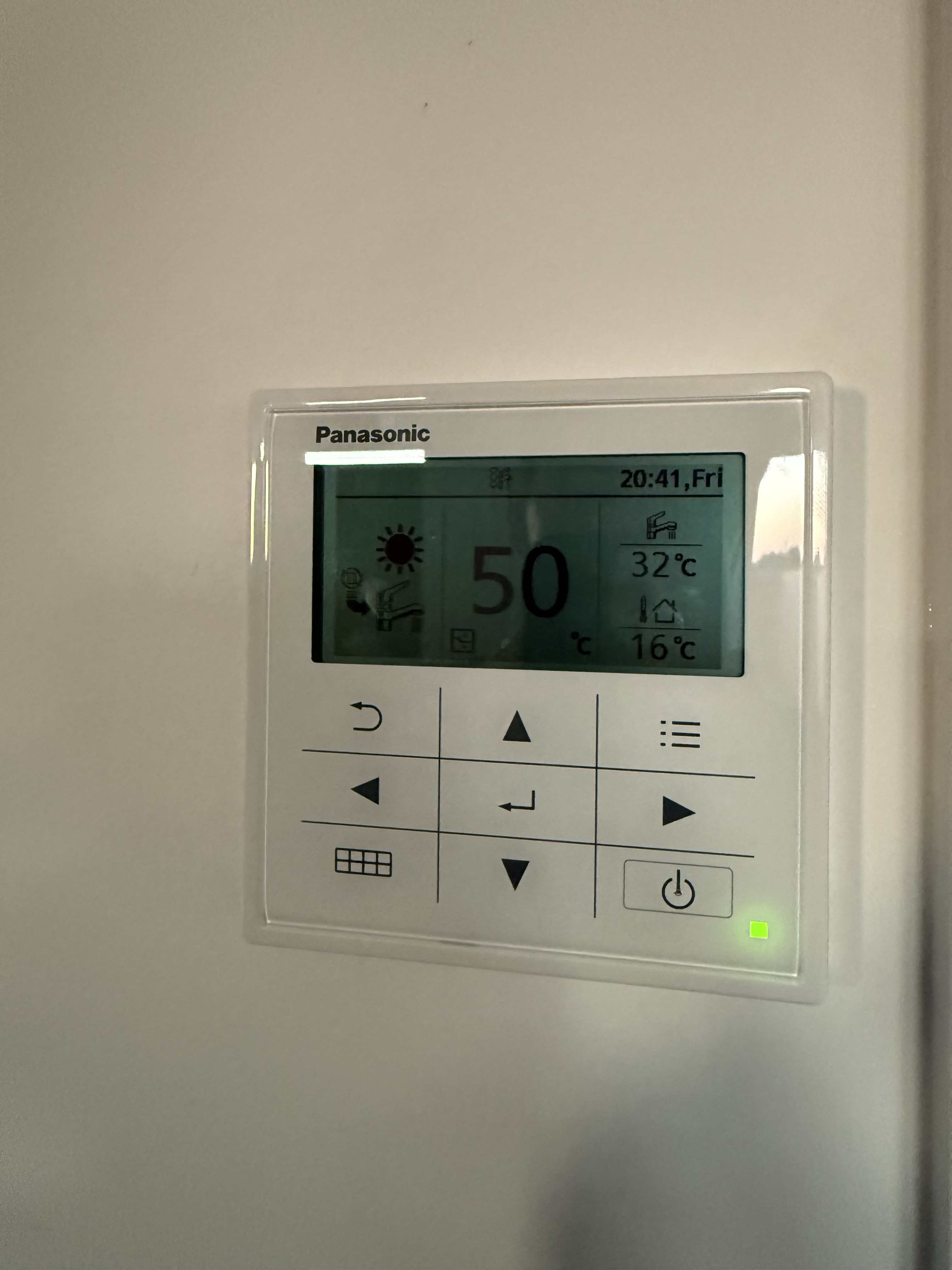

damspt Posted May 11, 2025 Posted May 11, 2025 hi, I’m new to this website, sorry if this is not the right place for this topic I’m a new build home owner, been here for 2 months. First time using heat pump. I messed up with the settings and i have no clue what to do. What temps etc looking for help to set the weather curve and whatever needs doing. Model: Panasonic WH-MDC05J3E5 Cost octopus tariff
ToughButterCup Posted May 11, 2025 Posted May 11, 2025 Hello. Have you got a copy of the relevant Manual? Page 20 of this manual appears to answer your question
JohnMo Posted May 11, 2025 Posted May 11, 2025 WC curve is pretty straightforward, use you manual to find the correct things to change as far as settings Curve start at 20 Deg outside set to minimum flow temp to 25 or minimum allowed flow temperature. At -6 outside for radiators set to 45 and UFH set to 35. That's a good enough start point. Now wait for the heating season to start. In rooms with thermostats set to max and with radiators thermal valves set to max. Also set all timers to run 24/7. Then let system run for 24 hrs, if overall house is too hot reduce the flow temp at -6 down, only adjust about half the overshoot, so if target is 21 Deg house and it up to 24, reduce flow by 1.5 degs. other way if too cold. Only adjust once each 24 hrs, until you get where you need to be. 1
