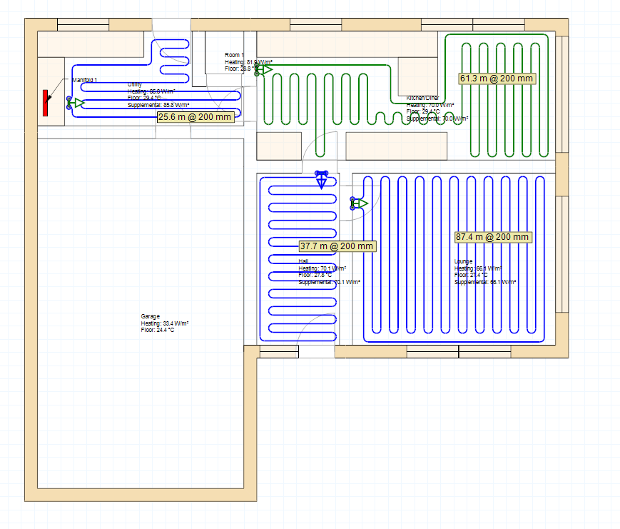

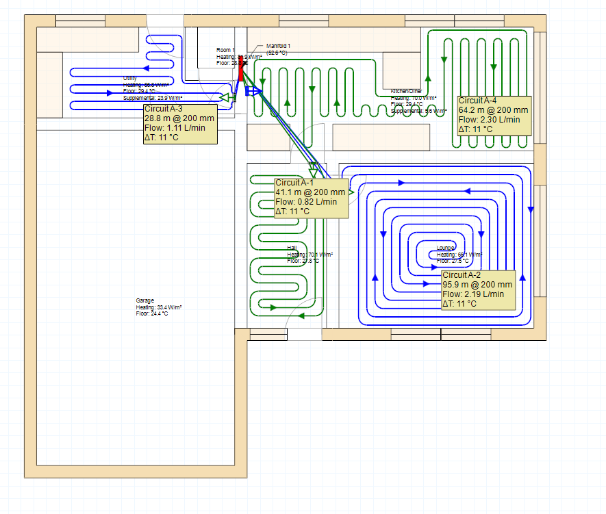

Which one??
Which is the better pipe layout for the lounge / hallway. Ignore the silly direct run to the manifold
Edit
And ignore the manifold position on the second plan :D

Top one will give  more even temperature. Bottom one might give a slight temperature gradient from one end of the room to the other.
