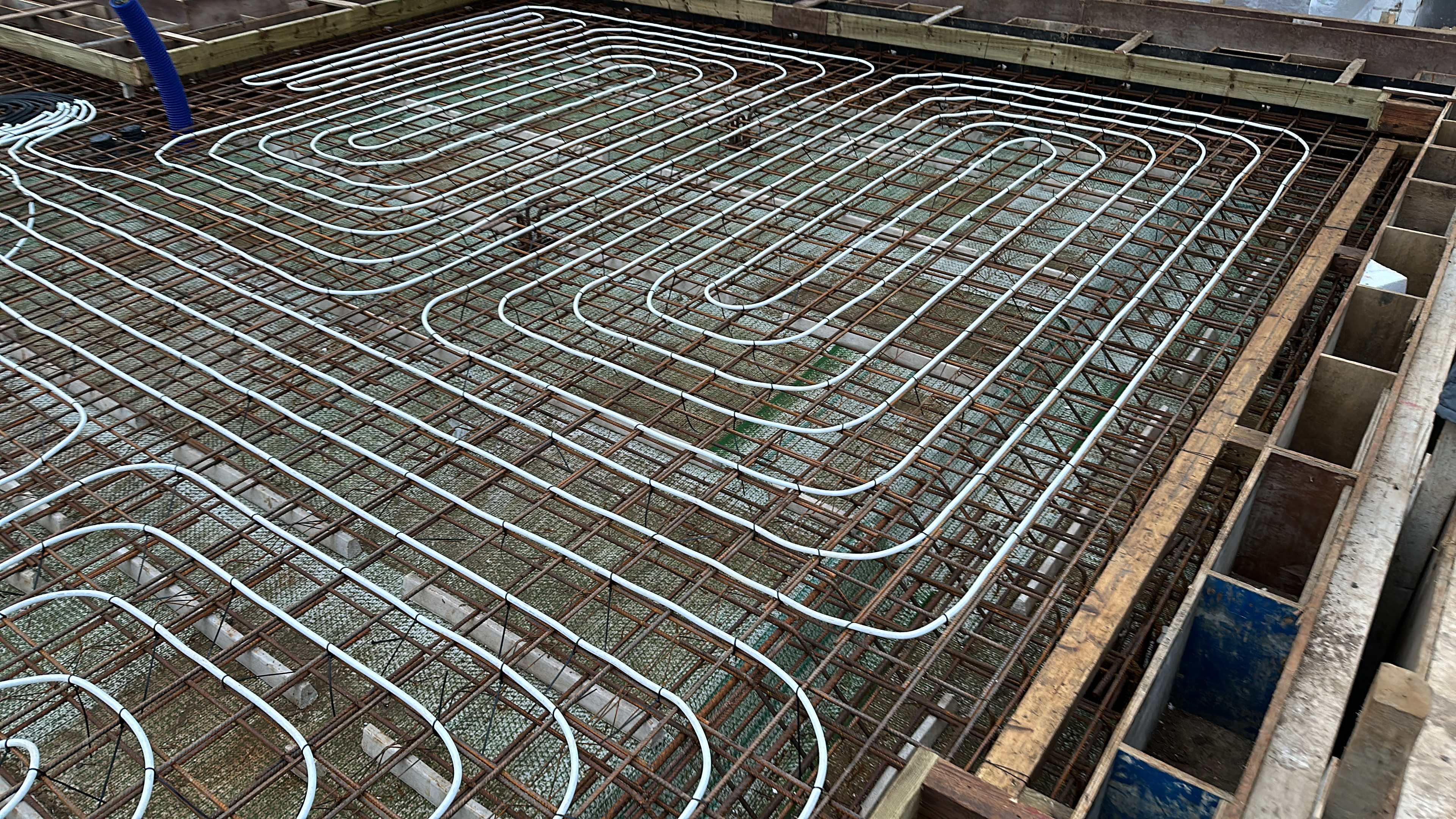

zzPaulzz Posted April 28 Author Posted April 28 I finally found a local Heat Geek to take a look at my requirements. His feedback was: maybe use a 5kW ASHP to avoid being capped for DHW on colder days; use a design temp of -3º external and 21º internal; use a spiral pattern to avoid pressure losses caused by excessive bends. Apart from the last one, you guys called it first I'm now waiting for him to quote for me for the design and install. Feeling much more confident. Thanks! 2

G and J Posted April 28 Posted April 28 15 minutes ago, saveasteading said: @zzPaulzz it could be that your se has simply taken the thickness off a drawing by others. It happens a lot in linear design, with no feedback in the design chain. Then it reaches the contractor who costs it, and client who maybe questions it, but usually accepts it. We could easily have fallen into that rut. However, I think I’m the other extreme. I'm too willing to stop, retrace, refine, improve, etc. That spills over into knob polishing very easily. But as a founder member of Obsessives Anonymous…. (@zzPaulzz - please can I see the alternative spiral pattern when you have it.) 1
zzPaulzz Posted April 28 Author Posted April 28 3 minutes ago, G and J said: We could easily have fallen into that rut. However, I think I’m the other extreme. I'm too willing to stop, retrace, refine, improve, etc. That spills over into knob polishing very easily. But as a founder member of Obsessives Anonymous…. (@zzPaulzz - please can I see the alternative spiral pattern when you have it.) I'm with you @G and J - I think I've driven my architect mad with all my revisions. I'm sure they'll have PTSD by the end of this process. Will share what he comes up with, though I hope he meant 'counterflow spiral'.
saveasteading Posted April 28 Posted April 28 4 hours ago, G and J said: I'm too willing to stop, retrace, refine, improve, etc. 4 hours ago, zzPaulzz said: I think I've driven my architect mad with all my revisions. It's good for them to learn about building from real people. 1
Nickfromwales Posted April 28 Posted April 28 4 hours ago, G and J said: please can I see the alternative spiral pattern when you have it Reverse / inverted / snail, all called different things by different folk, just where the pipe isn't serpentine; eg it's not just simple up / down / up / down runs with 180o loops at each end. This is easy to implement when pipes are at 150-200mm oc, but at 100mm it's nigh-on impossible to do anything other than inverted. 2
