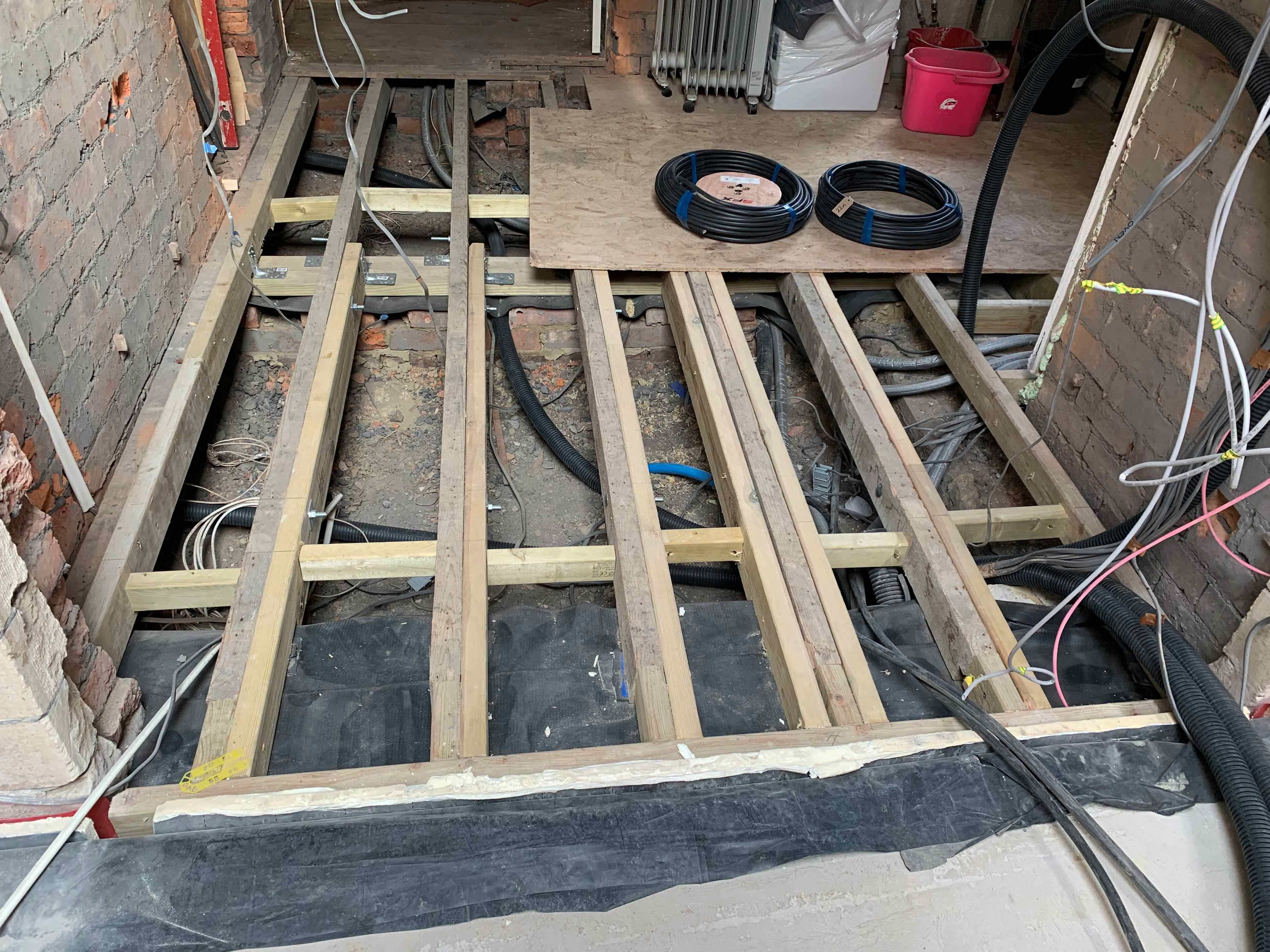

Dudefinch Posted April 23, 2025 Posted April 23, 2025 Hi all, bit of background on my house/floor - 1930's detached. Suspended timber floor (100 x 50mm) on either side of a concrete pad which used to hold a wall up and old oven. I've removed and replaced (with 95x45mm C24) all the joists on the smaller section of the suspended floor as they had woodworm, and checked and treated the other side. I think the woods ok, but trying to work out how to level both sides has got me scratching my head a bit. I've bought some u shims I was going to use on the smaller side, but on the bigger side some joists are 10mm different in height to the next one, and they're wedged into the wall pockets pretty well, so hard to adjust. I was thinking to use the heavier grey blocks (trimmed down) in between the new joists, mortared in, instead of the old bricks. Was also going to paint the joist ends in black jack to seal them. Also going to whack some noggins in between all joists about 600mm apart for rigidity. But the first step will be levelling it all, or rather, making it flat. Do I first go and record the heights of all the joists? Do I not worry too much and use self levelling compound over the subfloor (22mm moisture resistant chipboard 2400x600 with NoMorePly 1200x600 6mm sheets on top)? Do I sister the lower joists? Not sure how flat it all needs to be for the eventual tiles to go on top. Any ideas or process you normally follow would be mighty helpful.
Nickfromwales Posted April 23, 2025 Posted April 23, 2025 On these types of floors I just make the original as solid as possible and then install new timbers alongside the originals (sistering). You find the lowest point (use a laser is best) and work from there, screwing the very end of the new timbers alongside the original and then lifting it up to level it to the laser datum. Your new flooring gets fixed to the new timbers, the originals are just used for support.

Nickfromwales Posted April 23, 2025 Posted April 23, 2025 The originals stay put, no need to dig them out, that’s the reason for adding the new timbers alongside. When I say screw at the end, I mean so one end is fixed and the new timber can scissor up and down on that screw eg to allow it to be raised or lowered to meet the laser datum at the far end. Then you fix that new timber there at the end opposite where you screwed it. You then go back to the first screw you put in and remove it, then you raise that end of the timber to meet the laser datum, then you have a new bit of timber that is perfectly laser levelled both ends. Screw that along its length then for a permanent fix, and do the same process with the next, and the next. No need to joist hang the ends, just do the noggins as you say and then between those and the boards being glued and screwed down you’ll have no movement.

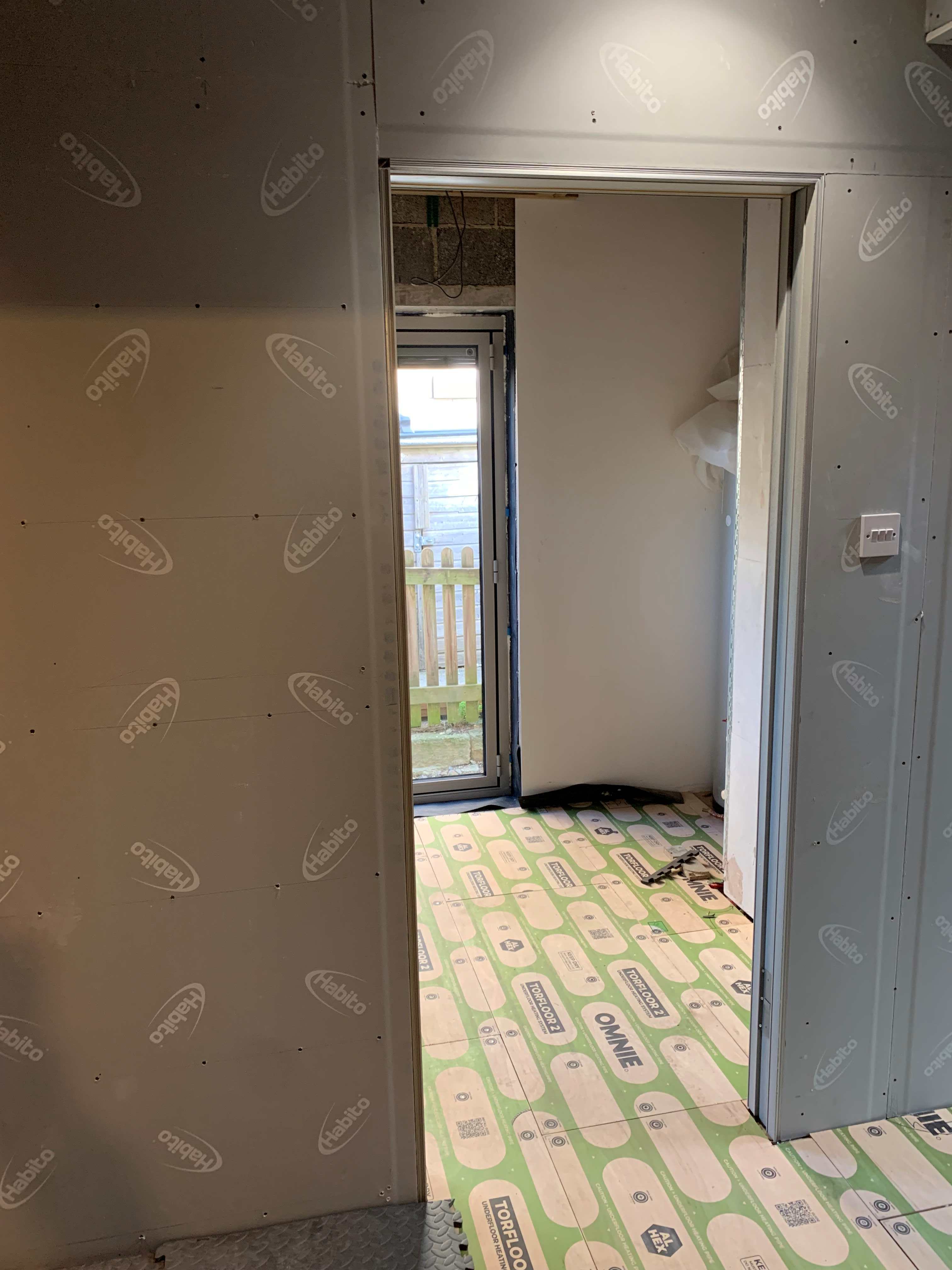

Spinny Posted April 23, 2025 Posted April 23, 2025 Photo from when ours were done in case it helps. Took them 4 goes and a visit from the structural engineer. 1

Dudefinch Posted April 23, 2025 Author Posted April 23, 2025 4 hours ago, Spinny said: Photo from when ours were done in case it helps. Took them 4 goes and a visit from the structural engineer. That does help to visualize, thanks

Spinny Posted April 23, 2025 Posted April 23, 2025 You don't need a concrete floor for u/floor heating of course. That photo I posted above now has underfloor heating. We were going to have a between the joist system but changed to a within the board system from Omnie when the builder cocked up the level of the concrete slab. (Insulation between the joists, 22mm pre routed board with a matching pre routed overboard - about 35mm thick on the joists.)
