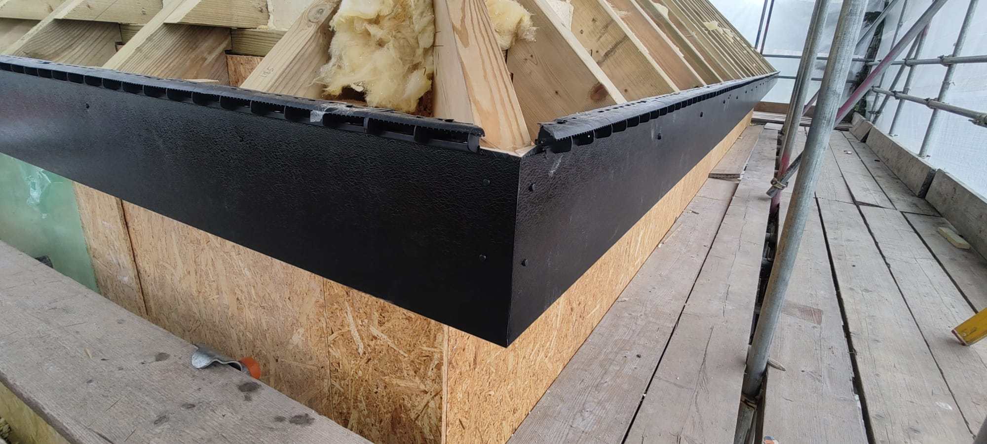

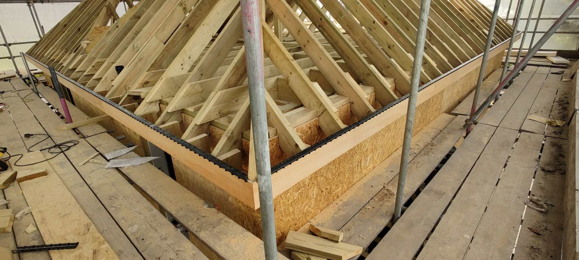

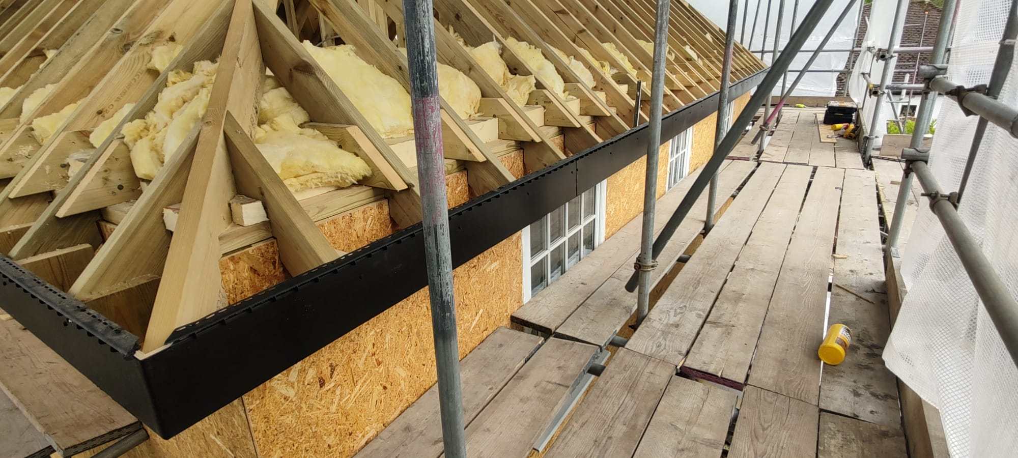

The Timber Frame company offer to put up the fascia and soffits, but this would mean installing them before the outer skin had been built. I was wondering whether anyone had any experience whether it worked better to install fascia and soffits before or after the outer skin is constructed.
Posted
IMO - I'd take your timber framers offer. I had my (aluminium) "foffit" (not a real name but a one-piece combined fascia and soffit) installed immediately after the framing, but before any slating (though some leadwork was being done at the same time.
You know your dimensions and wall covering thicknesses - so there's no real downside
