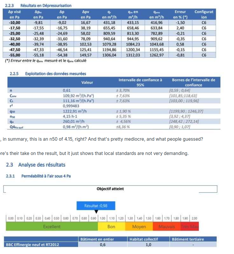

See one of my other topics - I had an fan test done. (Of course the ventilation bits at the top of the windows got taped over before the test.)
I got a score of
Q4Pa-surf in m3/(h.m2) : 0,98
I got a long list of small things to fix, which I did fix. The guys who did the test eyeball that it's probably around 0.7 now (if I did everything right).
