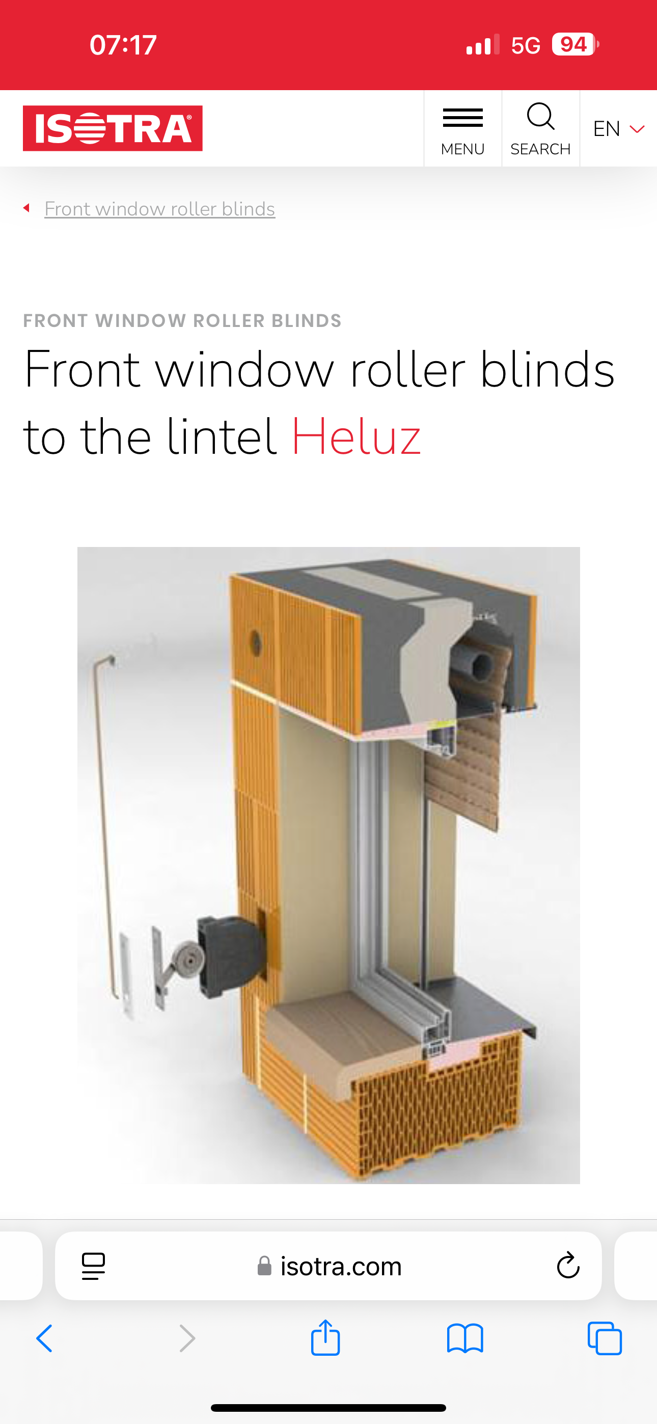

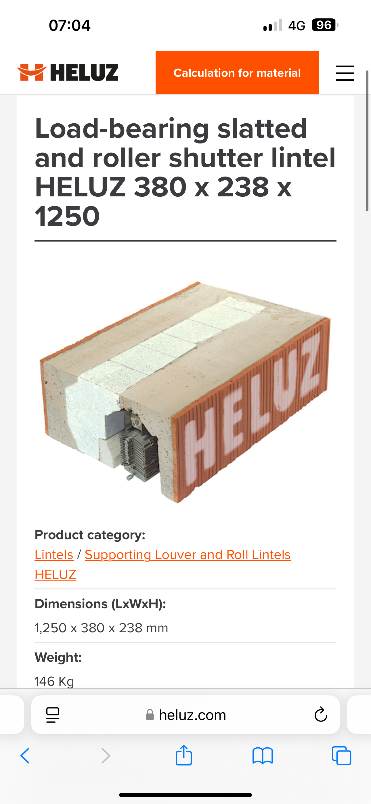

DannyT Posted April 5 Posted April 5 (edited) Here you go. don’t know where to source them from or how much they are in the UK but lintels that have the blind hidden inside of them. Im like you and want them hidden on a rendered house so need 6 for south and west facing. Im avoiding big sliders/bi folds now. Went to the dentist last week and they have patio doors facing west and it were roasting in there and that was in march. Edited April 5 by DannyT
