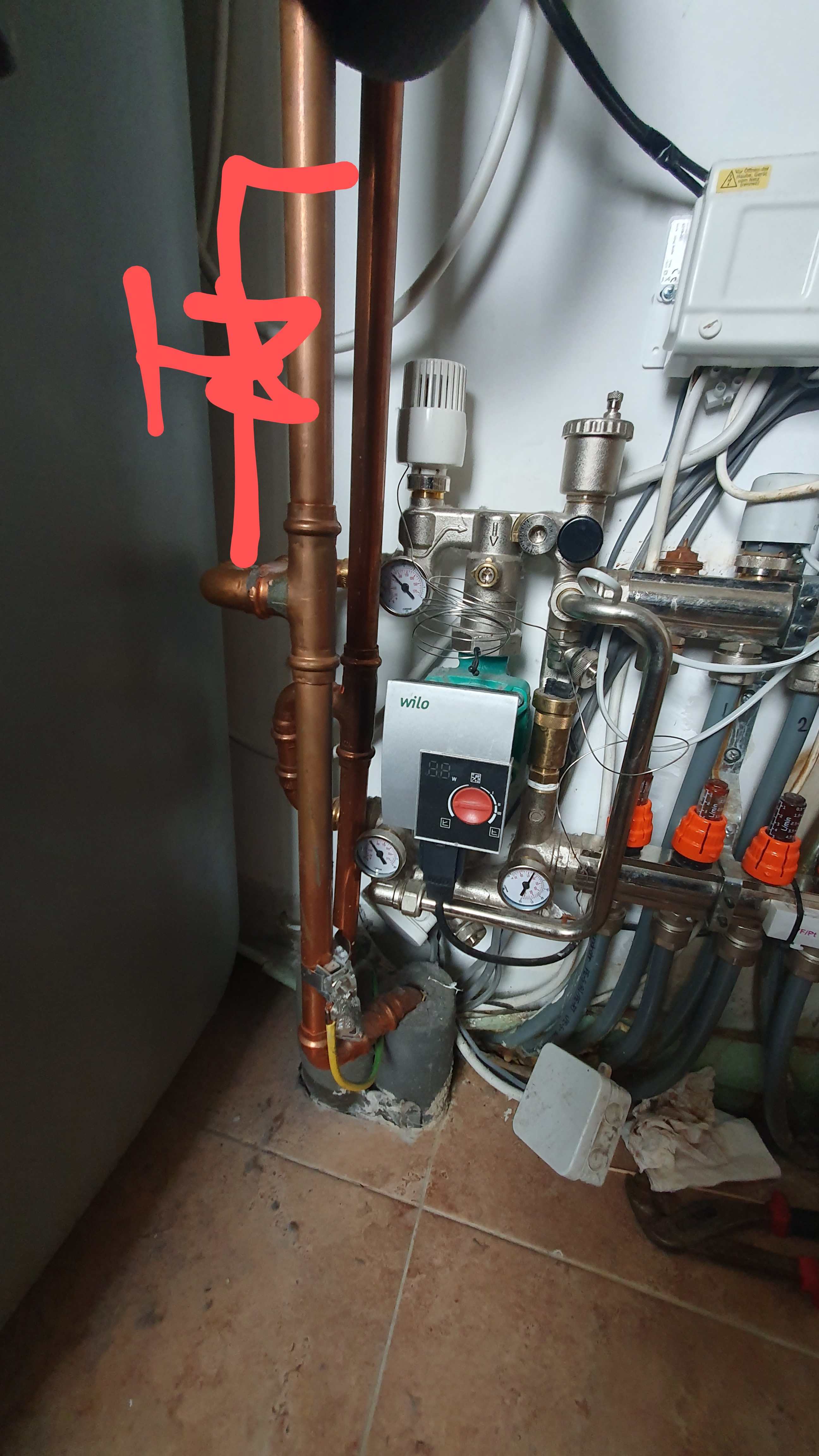

I've not been here for a few years cos everything's been fine. But now I have a return of an old problem and with plumbers here in Co. Clare been rarer than hens teeth I'm trying to sort this myself. Our manifold has no isolation valves. One of the pin valves needs replacing but I don't know how to do this without isolation valves. So my thoughts are to install isolation valves etc so that I can do do any future work myself. Attached is a photo of my manifold. Any help appreciated. Thanks Joe
One of the plumbers will advise I am sure but if you could take another photo with the pipe insulation removed they will see what joins to what more clearly.
You have an interesting mixture of actuators. I assume as a result of failures and replacements?
Thanks for the quick reply. Here's another photo with the insulation removed. The whole manifold etc is connected to the flow and return from the oil boiler. The pipes continue up to the thermal store. Essentially the system is installed so that there is no separation between the ufh part and the heating circuit from the boiler to the thermal store. I realise that there is probably a better design but I'm where I am unfortunately. And it has worked for the past ten years except for the occasional pin valve failure.

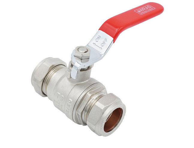

That’s tight as hell, so the only way you’ll get that isolated is to put a pair of 1/4 turns above and another pair below, and don’t even contemplate altering the pipework attached to the UFH, “operation can-of-worms!”.
You may have to use standard gate valves if 1/4 turns won’t swing, but ideally you’ll want full bore hence my mention of lever (ball) valves as the preferential ones. You can unbolt the levers if necessary, eg on the lower inner one where it’s getting tight.

Thanks for that. 1/4 turns? Do you mean something like in the attached photo? And would I need some sort of drain down valves on the manifold also (youtube suggested this to de pressurise the manifold once its isolated and to remove air once it's re pressurised).

Just make sure that they are suitable for the flow temps and that they don't introduce any restriction to flow
Isolator valves like the "screw driver" type isolation valves can be incredibly restrictive hence the need for "full bore" type

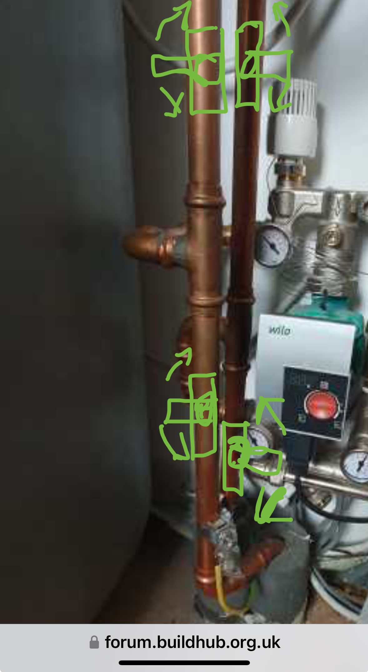

Nick thanks again. What i had been wondering was if I could insert isolation valves where I indicated in the attached. It would mean moving the whole shebang a bit to the right and I'm not sure if there is enought spare UFH pipe for that?  There is one unused connection for an extra ufh loop (visible third from right) that I wondered if this could be utilised to help with moving it all rightwards?
That would be a brave move, plus would see the isolations behind the copper pipes?
Disturbing that lot will need confidence and competence, so your call matey!
Anything can be done, but my option is of course reliant on you being able to lift the pipes vertically around 30-40mm.
These can be used if there’s zero movement above or below, or you go “gigantic ball’s” and do as you suggest.
Better to wait until May the 4th to do it. 🙏
So why wait until May 4th?
Regarding you initial suggestion I was thinking that I'd just cut sections out of the existing pipes and insert the four valves so to speak?
My idea of moving the manifold right would mean new isolation valves would be inserted where I drew the red circles on the photo so they wouldn't be behind the copper pipes. Maybe I misunderstood what your thinking is?
Top tip once you know what size copper pipe it is and you buy 4 suitable 1/4 turn full borr isolators - use two bits of pipe in one of the isolators to determine the length of cut section you need to remove
always better than cutting out too much 😉
