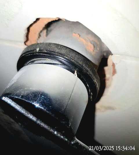

With your advice in mind, I've looked beneath the barrel of the mixer unit.  Below is a photo of the situation there.  The gap between the white ceramic tile and the barrel is just under a centimetre.
I actually have a tiny camera (with LED light) on the end of a 2 metre "snake".  The camera at the end of the "snake" is just under a centimetre in diameter.  While I might be able to force the head through the gap it wouldn't be able to turn to peer around in the space.  It could only look straight ahead.
As the photo shows, there is a "wall" of pink plaster under the barrel.  And it's dry, with no sign of having been damp.  Would it be of any worth if I used a screwdriver & hammer to chisel it away so as to peer in further?  Would removal of the pink plaster destabilise the position of the barrel to cause problems in the future?
Thanks.
Nope. Just chip away the bare minimum and scope away 👍. Ideally you’d be looking to see the hot and cold inlets at best, or at the worst just a bit more info than guessing and cutting walks.
