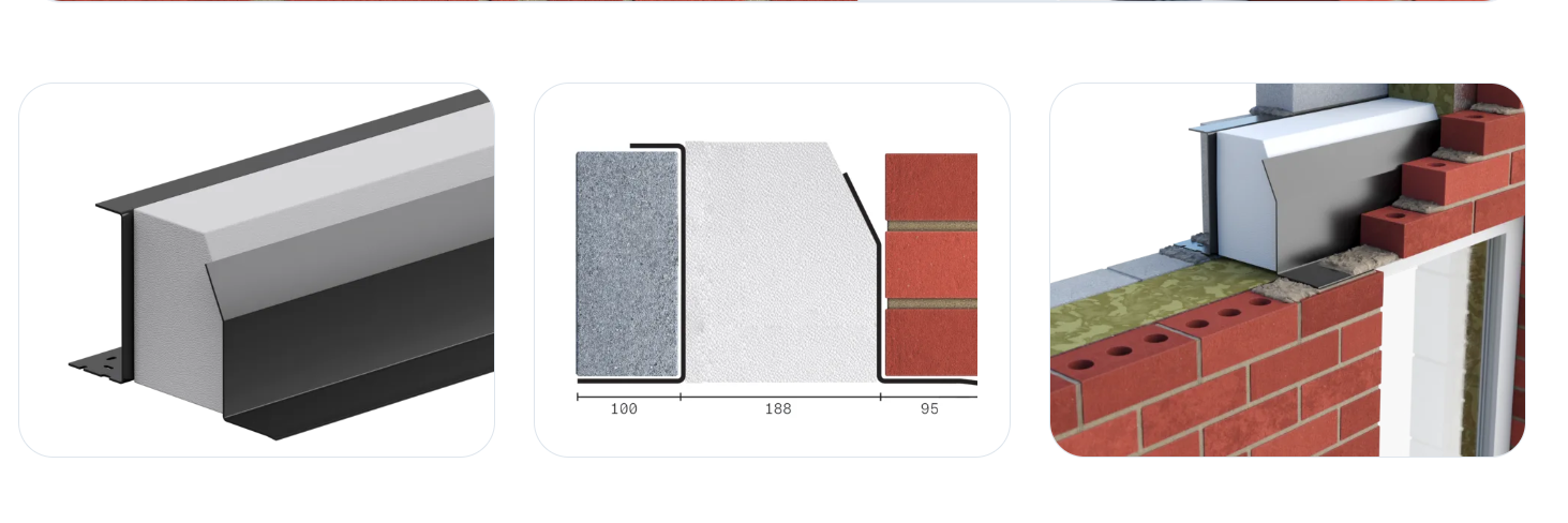

Nickfromwales Posted March 19, 2025 Posted March 19, 2025 https://condell-ltd.com/catnic-standard-duty-thermally-broken-cavity-wall-lintel-ts150-100-750mm?gad_source=1&gclid=Cj0KCQjw1um-BhDtARIsABjU5x6w0qbQNEyACFR81sLEzaErCAncCfhYPntTGQKbqppQ7jsLiWdxmjoaAmBoEALw_wcB Suggest these maybe?
SBMS Posted March 19, 2025 Author Posted March 19, 2025 1 minute ago, Nickfromwales said: https://condell-ltd.com/catnic-standard-duty-thermally-broken-cavity-wall-lintel-ts150-100-750mm?gad_source=1&gclid=Cj0KCQjw1um-BhDtARIsABjU5x6w0qbQNEyACFR81sLEzaErCAncCfhYPntTGQKbqppQ7jsLiWdxmjoaAmBoEALw_wcB Suggest these maybe? Thanks - are these recommended/needed (with the polystyrene insulation in middle) if we are doing beads? Or is the polystyrene on the product image just an example?
Nickfromwales Posted March 19, 2025 Posted March 19, 2025 Just now, SBMS said: Thanks - are these recommended/needed (with the polystyrene insulation in middle) if we are doing beads? Or is the polystyrene on the product image just an example? You may need to close the cavity off I expect, somehow, but as I don't have sectional drawings to comment from these are generalised bits of info from a man you've never met before on the internet. With blown full fill bonded beads, I'd have thought these would round things off nicely. Otherwise where do the beads stop during installation?

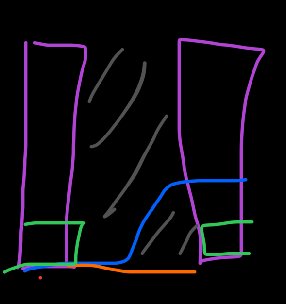

SBMS Posted March 19, 2025 Author Posted March 19, 2025 Just now, Tony L said: The Catnic split lintels look good to me. I know next to nothing, by the way, so don't take this as advice. I'm just wondering how these compare (performance wise) with the (presumably cheaper option) of two separate steel reinforced concrete lintels. I think he’s priced that split lintels will be cheaper and the beads will provide the insulation between the two leafs? I’ve tried to draw how I think itll work - does this work with getting the beads between the cavity tray and the cavity closer? pink is outer/inner leaf grey is beads green are box and inner lintels orange is cavity closer
Nickfromwales Posted March 19, 2025 Posted March 19, 2025 7 minutes ago, SBMS said: The cavity would be need to be closed at the head of the window - as with the sides. Very differently from the sides, as the head needs to manage and direct any falling water to the internal face of the façade and outwards through, for eg, weep joints.
Nickfromwales Posted March 19, 2025 Posted March 19, 2025 2 minutes ago, SBMS said: pink is outer/inner leaf grey is beads green are box and inner lintels orange is cavity closer And the blue?
Tony L Posted March 19, 2025 Posted March 19, 2025 May I just check, the tray (blue line above) goes beneath the lintel, as shown - I think it might go above. & I'll just remind you, I know next to nothing.

SBMS Posted March 19, 2025 Author Posted March 19, 2025 13 minutes ago, Nickfromwales said: And the blue? Sorry forgot to say that’s the cavity tray 1
SBMS Posted March 19, 2025 Author Posted March 19, 2025 13 minutes ago, Tony L said: May I just check, the tray (blue line above) goes beneath the lintel, as shown - I think it might go above. & I'll just remind you, I know next to nothing. Yes sorry it’s my fat fingers drawing on an iPhone 😂 the nhbc detail at least marries up with what I was thinking and what the builder explained to me. My main question is that a split lintel seems much better for thermal bridging. Is it just labour and cost as to why people use a One piece?

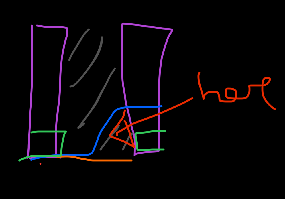

SBMS Posted March 19, 2025 Author Posted March 19, 2025 18 minutes ago, Nickfromwales said: Very differently from the sides, as the head needs to manage and direct any falling water to the internal face of the façade and outwards through, for eg, weep joints. I think this is what the cavity tray is for and then directs out to weep holes?? I think the closer sits below all this but I’m guessing to be honest. I think the nhbc detail Shows this. one thing I am trying to Work out as I cant think in 3d… Would pumped beads get to the cavity below the tray indicated below??
SBMS Posted March 19, 2025 Author Posted March 19, 2025 Just now, Nickfromwales said: We'll learn to forgive over time. But is it not easier to just use the thermally broken one? Probably! To me the thermally broken one is just a split lintel but they’ve supplied the insulation??
Nickfromwales Posted March 19, 2025 Posted March 19, 2025 1 minute ago, SBMS said: Probably! To me the thermally broken one is just a split lintel but they’ve supplied the insulation?? And done away with the need for the tray !! The EPS is bonded to the front tray profile so that manages the runoff

Nickfromwales Posted March 19, 2025 Posted March 19, 2025 4 minutes ago, Tony L said: I still think that. + a tray costs next to nothing, so why wouldn't you? Because it would stop the beads fully filling maybe?
SBMS Posted March 19, 2025 Author Posted March 19, 2025 1 minute ago, Nickfromwales said: Because it would stop the beads fully filling maybe? I wondered about that but there shouldn’t be anything stopping them flowing around and under the tray? I also wonder if these in 200mm are what he has struggled to get. Most places online seem to only stock up to 165mm cavity version. Maybe 200mm are special order?
