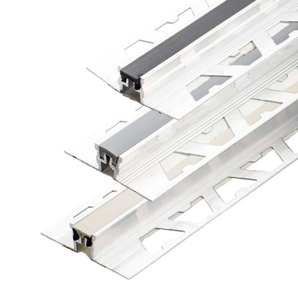

The tile supplier will match them to your tiles
Dont get the plastic ones Pay a little more for metal
