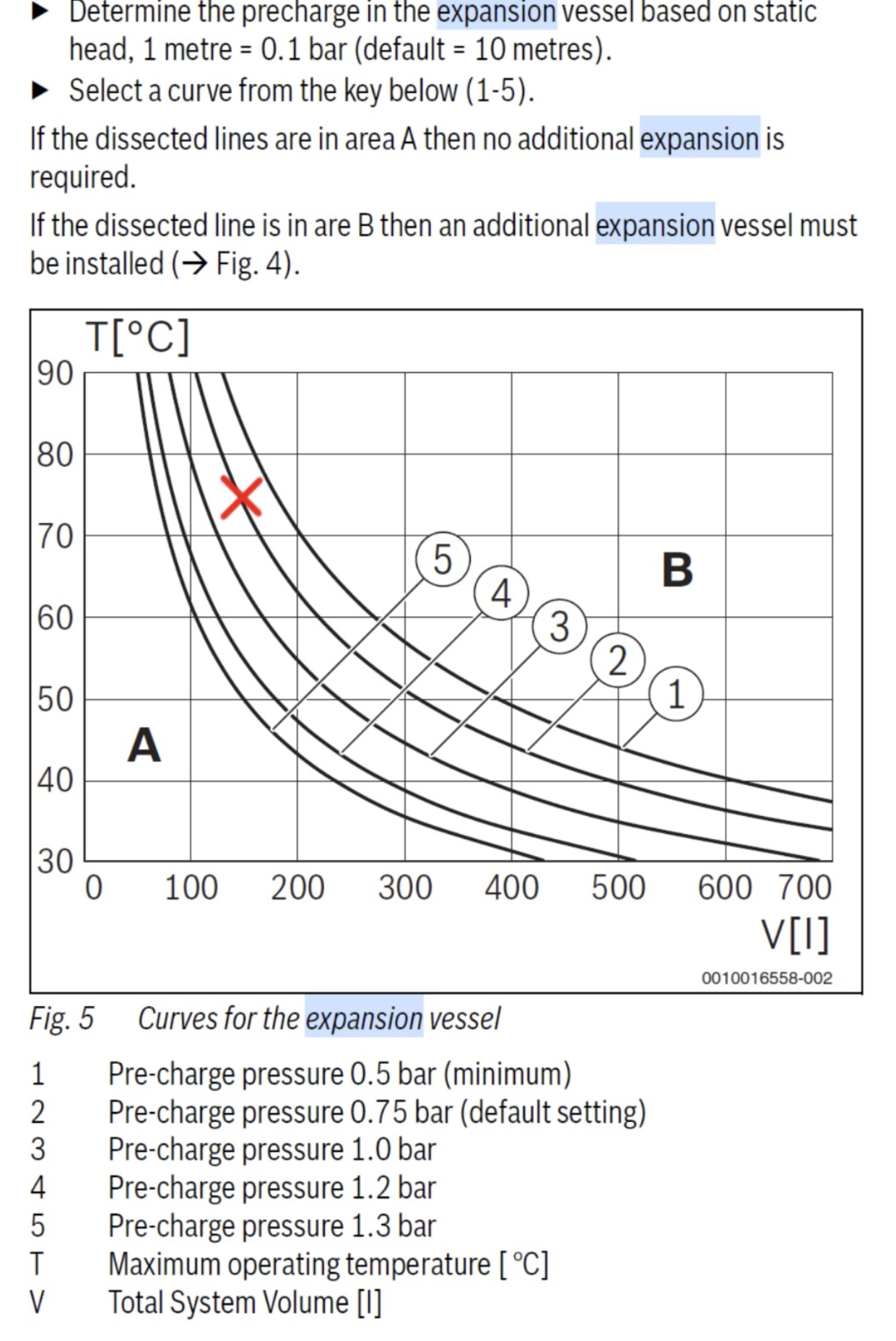

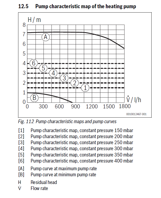

I did check the manual for what they recommend and saw this graph however.... i plotted the red X on where we are. I calculated we're at 150L or so based on all the specs of my radiators. (the designer triple column ones take up so much water!)
I can't see the size of the vessel inside referenced in the manual,. but looking on ebay for replacement parts, it would suggest the one i have inside is a 10L one.

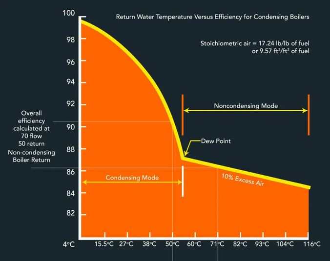

For a boiler to get to 70 deg flow really quickly yet the rads don't get there as fast is a bit odd - have you got an ABV in circuit that is allowing too much flow back to the boiler??
Why are you running the CH circuit at 70 deg C - that's way too high to get condensing benefit

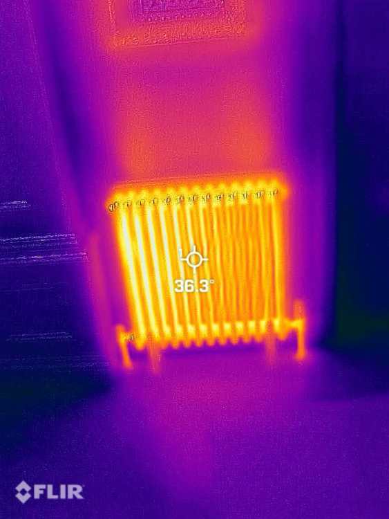

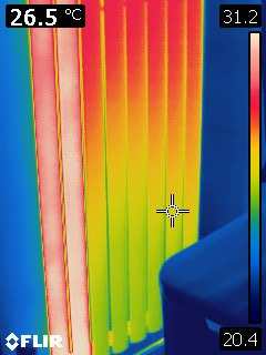

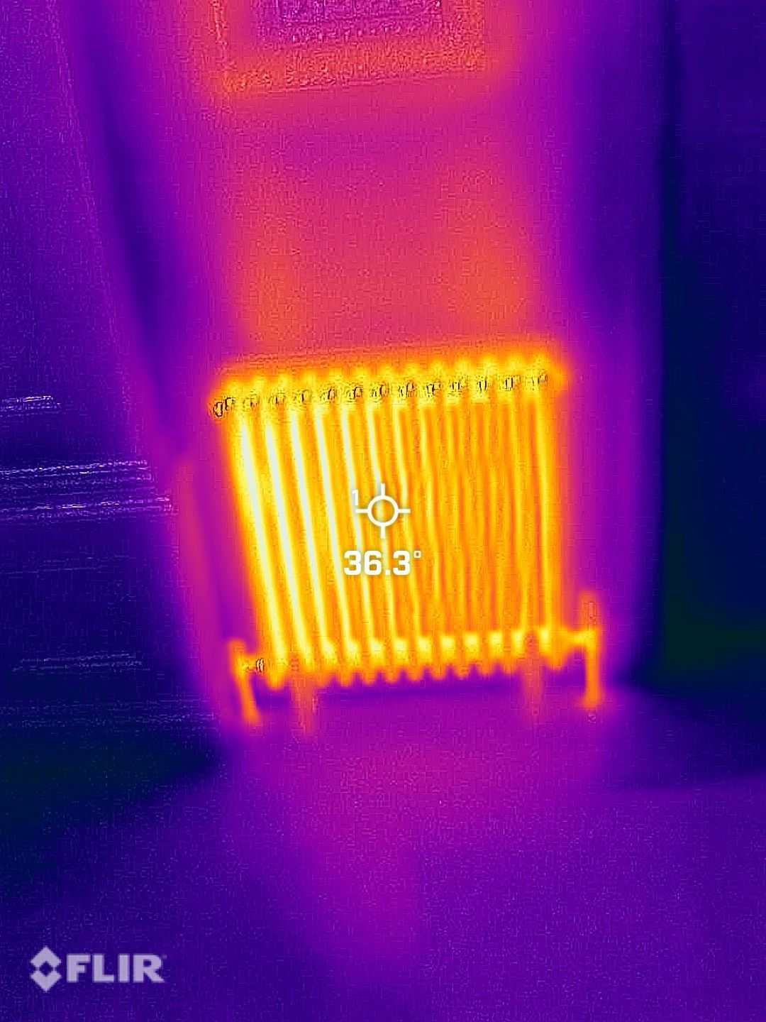

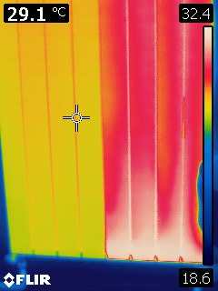

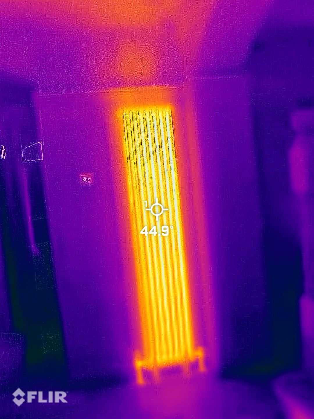

If you can borrow a thermal camera it might give you some good clues on the flow internally thro the rad
Below is one of my K22 or K33 rads running on a flow temp of ~30 Deg C
And here is one of my vertical rads (with the modification internally)
Below is a link to the issues I had with 2 vertical rads that were fitted with a diverter

Undersized capacity for expansion is number one issue here, and what happens is the system expands, a bit of loss from PRV to atmosphere, then the system cools down and creates a vacuum. That results in air being sucked in through the automatic air vents, and then repeat.
You need to add another 14-18L of expansion vessel capacity before further diagnosing, as that may resolve more than one symptom here. If there’s insufficient inhibitor install is 12 months old then you need to get the original fitter back to do this FOC as they should have calculated the system volume and installed this from day 1; this may have now provoked the PRV to dribble even when back to normal duty so you’ll have to monitor this for discharge after the second expansion vessel
is installed. Common to see tbh, as most don’t ever read the book word for word as they’re just wanting to be in and out asap on price.
I think it’s a mix of gas and air that’s accumulating in the radiator that you’re routinely bleeding, and if there’s insufficient inhibitor then the corrosion process releases nitrogen (iirc) which gets released by a) the auto vents and b), you manually bleeding the rads.
The issue of the boiler achieving such high temps so quickly points at pump flow rates being too low. One other possibility is that the pump isolation valves may have been inadvertently left part open instead of fully open (took me and 2 of my mates half a day of head scratching, to find this faux pas, where we had the same issues on a brand new job :S!!). How we laughed……

also good shout on the vertical rads, i do have a FLIR camera so i'll take a look. Out of interest should they or should they not have diverters in there? the place i bought them off told me the TRV should be diagonally opposite the bleed valve because of something. I imagine that's related to what you're saying?

Running 73 degrees because thats how hot i like the radiators. It does modulate down to 44% eventually after maybe an hour or so. and I can see fluid coming out of the condense pipe. So it is condensing.
I get the personal preference element but if the circuit is running at that temp unless the house is absolutely massive and has a horrendous heat loss when it's up to temp the boiler is going to cycle a lot
44% of 35kW is 15.4 kWh - that is pretty heavy usage!!!

Below 54 deg is essential for condensing
73 deg flow some boilers get upset if the return flow is greater than 20 -25 deg C so I'd guess your return once house is up to temp would be between 48 and 53 Deg C so only just scraping into condensing mode so running at maybe 90% efficiency as opposed to a 55 deg flow and a 35 Deg Return returning 96% Efficiency
If you already have a FLIR camera then the images will tell you a lot about where the heat and the flow is moving round
I never took a picture of my verticals that had a problem but the bottom rail of the rad was hot and the vertical bars were stone cold!!!!

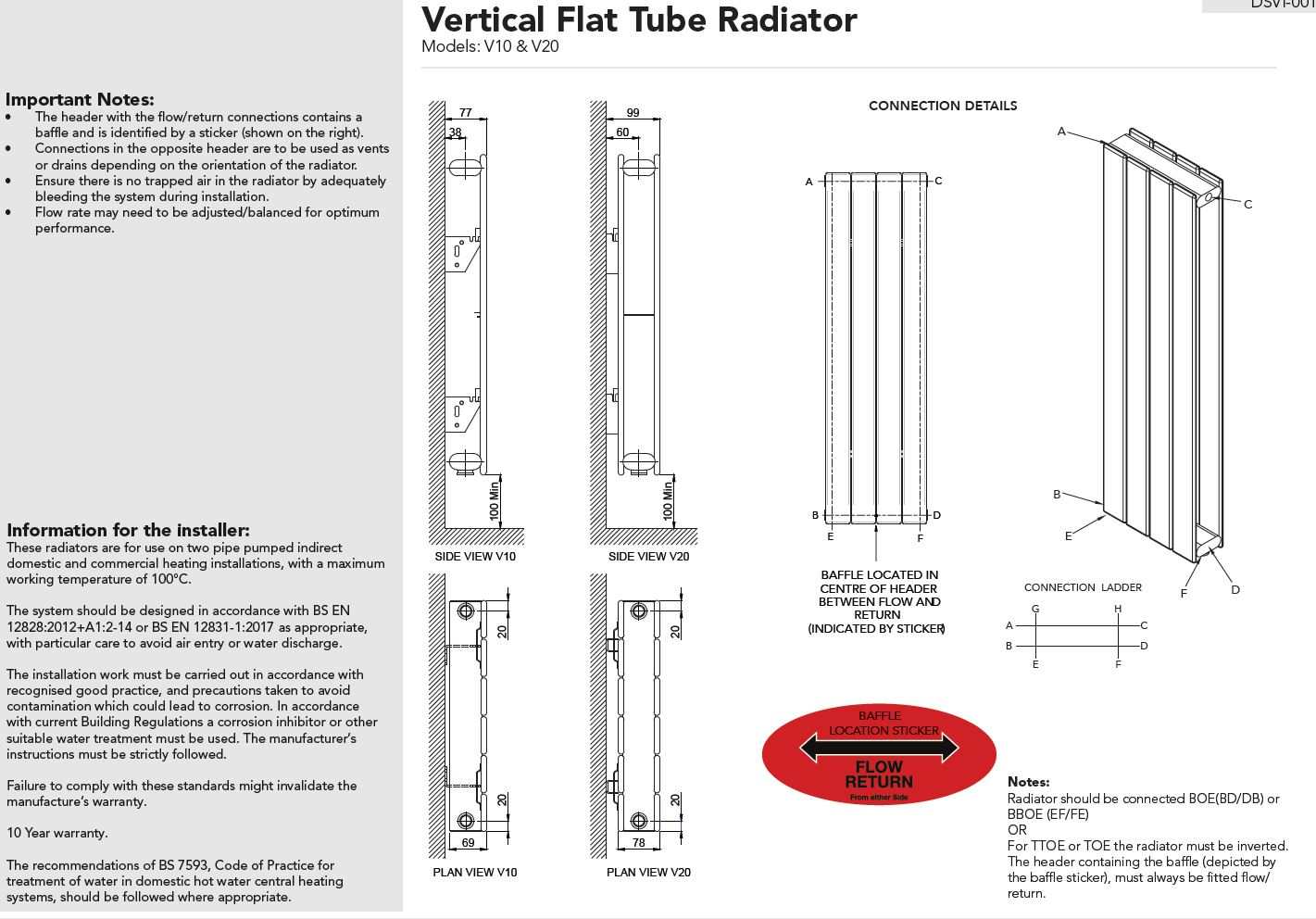

Modern TRV's that are bi-directional don't care which end they are on
Vertical rads should have diverters in there to help them work in lower flow temp systems
Good manufacturers clearly mark up the position of the diverter, the in and out
One of the pages of instructions with my big double vertical is below as you can hopefully see the instruction are very specific
The above gives different precharge pressures but no charging pressures which makes a big difference to the system volumes that can be accomodated by a (the) 10L EV.
For example they indicate that at a system mean temp of 65C that the EV wiil be sufficient for 180/185L, it will, (my calcs) but just about with precharge/filling pressures of 0.75/1.25bar, I would allways calculate for a final pressure of 2.5bar so the 10L EV will comfortably accomodate 150L with precharge/filling pressures of 0.75bar/1.25bar with a final pressure of 2.5bar.
Commonly used precharge/filling pressures of 1.0bar/1.5bar should give a final pressure of 3.0bar with a system vol of 163L but only 125L at a final pressure of 2.5bar.
A "trick" thats sometimes used is to have the precharge and filling pressures the same which gives a huge increase in system volume, for example the 125L above at precharge/filling pressures of 1.0/1.5bar can be increased to over 230L with precharge/filling pressures of 1.0bar/1.0bar and still not exceed a final pressure of 2.5bar, of course no reserve vol then to make up for tiny leakages/microbubbles which can lead to frequent top ups, or,  far worse, the installation of a auto top up (PRV) valve set to 1.0bar.

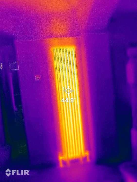

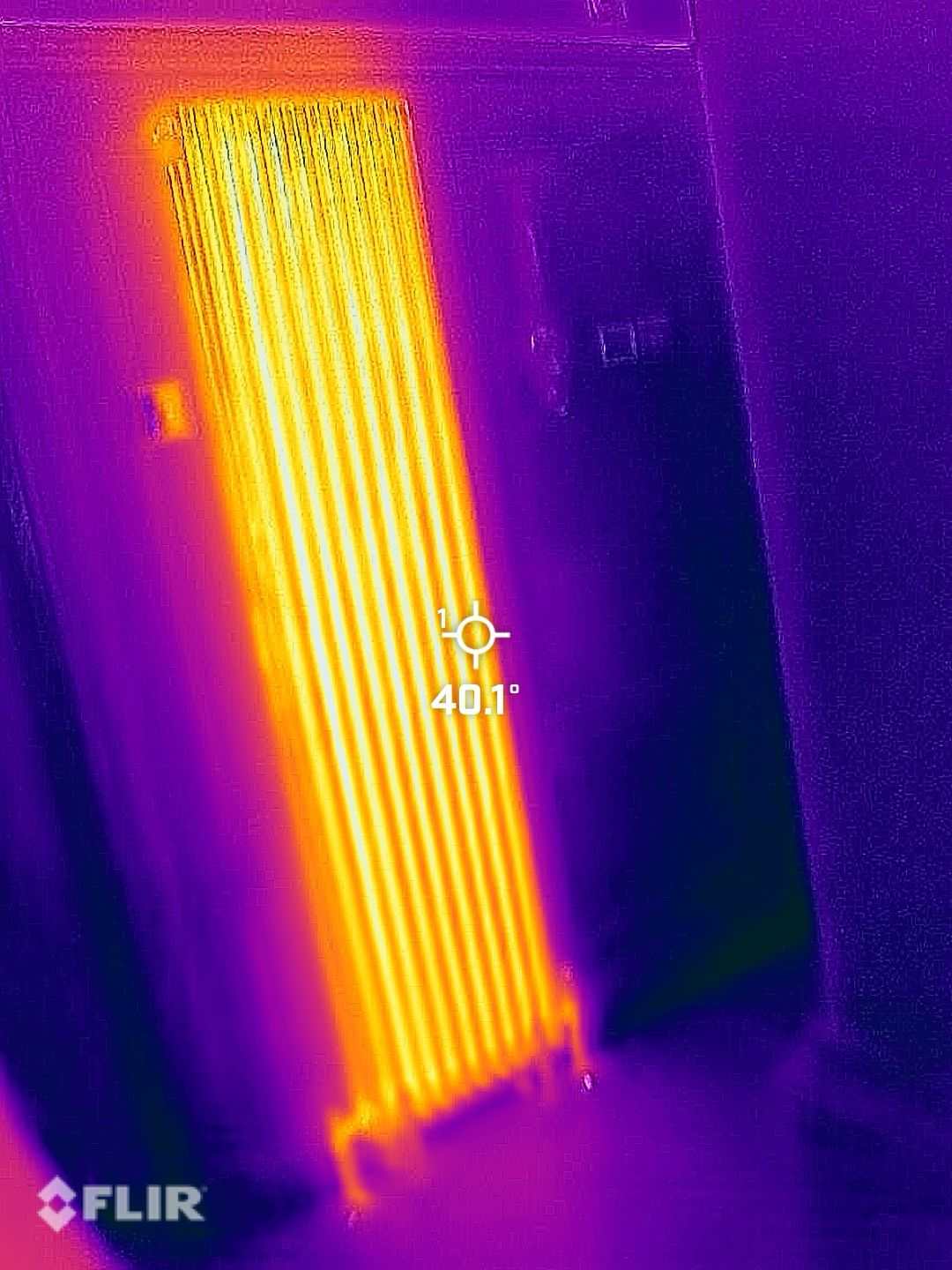

Yeah nice, thankyou for this. I will put the thermal cam on this weekend and see what's going on.

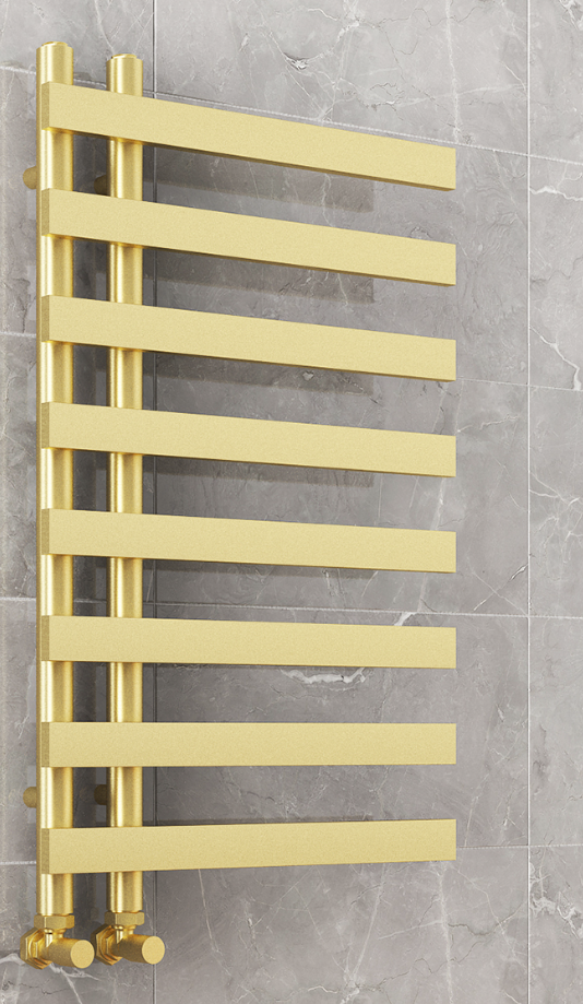

The designer radiators are called "Milano Windsor" from Bestheating.com I called their "technical support team" and asked about whether they have a diverter already in etc, they said they're required because these rads are specifically designed for water to go not simply pass through the bottom. So sounds like they have an internal baffle of some sort already, they also said it doesn't matter which way they're fitted, front to back, upside down. They said the design is symmetrical in box axis.... That said I've not put the thermal cam on yet.

The rad without the TRV is actually a towel radiator. Like the one below. Which do I adjust to essentially dial the bypassing down?

Posted
thanks, the graph i posted above does allude to the fact it might be fine if I run a really low charge pressure.
But based on the fact that I guess there's no such thing as too much expansion capacity. I may as well just add another 18L rather than fiddling about with the internals of the boiler.
Yeah regardless of the flow temp they show whats going on flow wise inside a rad
You can do either (or both equally because towel rails are a PITA)
I'd feel the pipes to see which one gets hot first and throttle that one back

Get someone to check the circ pump settings, possibly require setting 5 or 6 to give a residual head of 3.5 to 4.0M .
Posted
Yep this was my first plan of attack funnily enough, as i suspected it perhaps wasn't getting the heat away from the boiler quickly enough. Ive been running it at 6 for the past few weeks, no discernable difference really.
There is another pump mode you can put the pump in where it's speed is relative to the burner output. In the manual that reads as if the max in that mode is far higher than 400mbar....but when I tried that mode i got some very bizarre results, even worse than constant pressure.

Vertical Rads are a whole different ball game if they don't have diverters in them

WhatsAppImage2025-03-22at10_04.44_cca04ae8.thumb.jpg.bc30980136e752d525d997084716869a.jpgWhatsAppImage2025-03-22at10_04.44_b506c1db.thumb.jpg.406699b13398d8b1eb50107174fa114e.jpgWhatsAppImage2025-03-22at10_04.44_0eb9f829.thumb.jpg.58b0d7d85b4026e88ce252d78d581c54.jpg
Posted
5 minutes ago, EinTopaz said:
No issue with the designer rads in and of themselves, as far as I can see.
Not showing much of a temp gradient either.............. Not exactly what I would expect to see but they are heating up evenly and a vertical rad will do that at high temps even if there is no baffle/diverter - the hot water wants to rise above the cold so you'll get a very similar picture.
It's exactly the problem I had with a couple of verticals - at 55 deg flow temps they heated up nicely but as I dropped the flow temps to 40 deg it became really clear that there was an issue with the baffle as the heat differential wasn't big enough and the flow to fast for the hotter water to have time to rise.
Can you run the boiler at a lower flow temp and do the pictures again - maybe down at 40 deg - that should provide a better picture
Now I know I'm using low flow temps to heat my house (32 deg C max) but the above is a large vertical and shows clearly the impact of the diverter.
At this time of year your heat losses should be much lower so 73 deg flow temp is just going to drive room overheat or if TRV controlled rooms a circuit shrinking and boiler cycling (all of which is bad for energy consumption)
