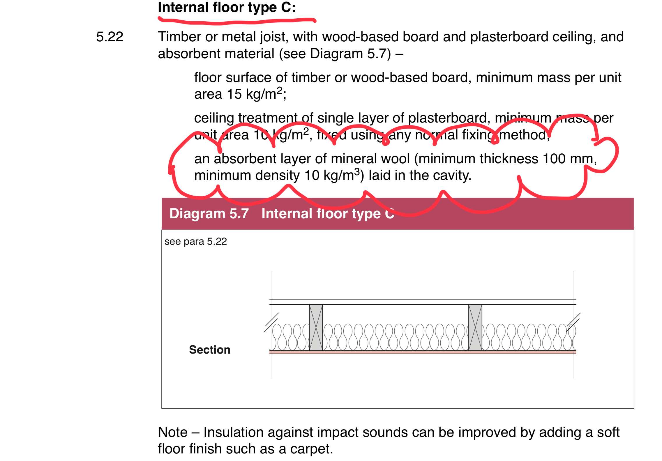

olley Posted March 13, 2025 Posted March 13, 2025 Getting ready to lay the floor of our dormer conversion, and I am wondering, do I have to insulate the floor in-between the joists?
nod Posted March 13, 2025 Posted March 13, 2025 8 minutes ago, ETC said: What about sound resistance between floors? You can do 99% of new builds have no insulation between floors
