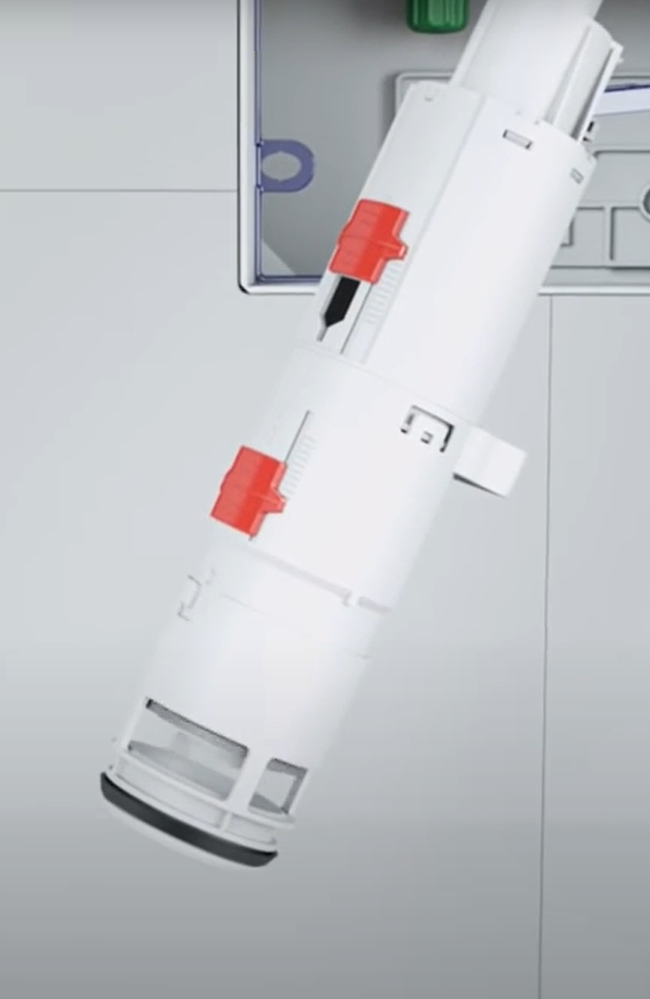

I have successfully removed the bits from the Roca concealed cistern. There was an excellent video, although it was difficult to find.
further to an earlier post, I was very pleased to find an additional stopcock inside.  the space available is tiny but it all clicks apart. I dread dropping anything.
The quality is stunning, although we will see if it goes back together again
I was expecting to find lime on the washer, thus being easy to stop the constant running, but there was no buildup. So I have given it a clean anyway and will shortly start the reassembly.
But I am concerned that I have moved these red sliders. I had assumed that they adjust the water flush quantity, but I can't see any effect on the mechanism.
The top one is labelled 'half, and bottom one labelled 'full', so that is simple enough.
On the red sliders the top one is marked  >POM<1-2
The bottom one is marked  <POM<1-3  I don't know what POM means.
and behind the sliders are scales the top one being 0 to 12, the lower one being  0-8
the picture attached is a screenshot from the video apparently set at zero for full flush and 12 for half flush.
confusing or what? I will accept any guesses but obv would love any real knowledge.
I  think I am going to put it back together with both high numbers.
Might see if I can reduce the fill level too in case that is the issue.
Adjusting the flush volume for short flush and long flush
get them in the right orientation and the flushes are both the same volume
That's  the query really.
acc to the spec, the thing seemingly does, as suggested above,  3/6litre flushes    I assume that means up to 3 and up to  6 litre, so what the scales saying 0-8 and 0-12 means is  a mystery.
And POM does not appear as plumbing on any searches .
POM is the type of plasic the part is made from, is it not?

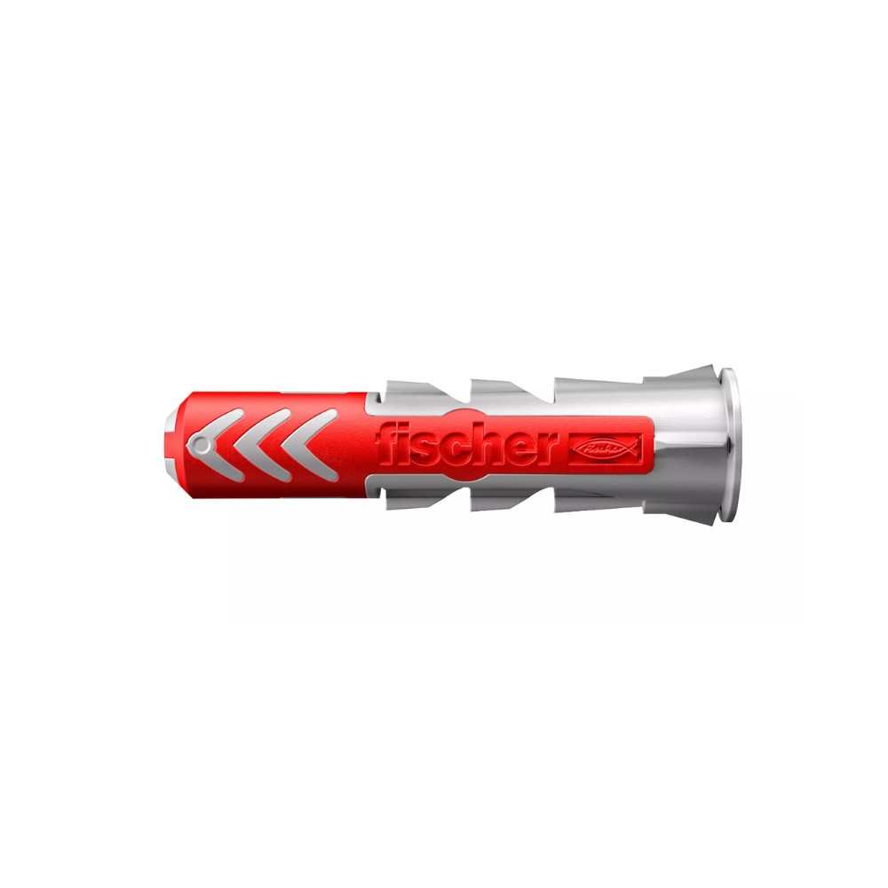

If you can get away with something that will take ordinary screws then the toggle fasteners that have a plastic rawlplug bit with two wings in front that splay out might be something to consider.
One of these. 12mm dia might do it and they are supposed to grab hold behind, though it works better for the demonstrator than for me.
