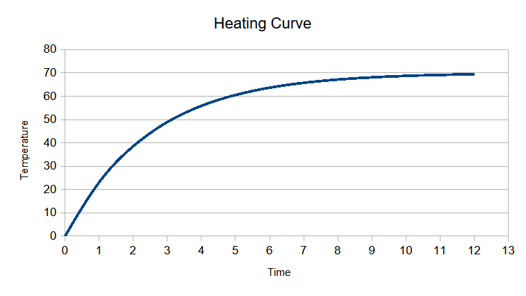

The more complicated formula involves exponential growth and the surround environment temperature.
So:
TF = Ti -(Ti - Ta) x EXP(-k x t)
Where:
TF = Final Temperaure
Ti = Initial Temperature
Ta = Ambient Temperature
EXP(-k x t) = Exponent of base e, where k is a unit less number and t is time.
This basically shows that as the material gets hotter, it looses more energy to the surroundings, and takes disproportionally longer and longer to get to a set temperature.
