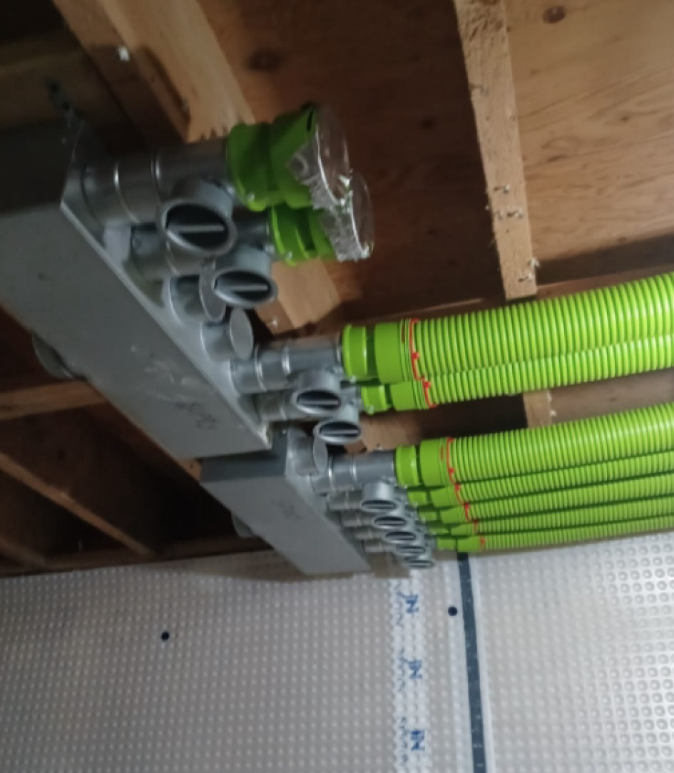

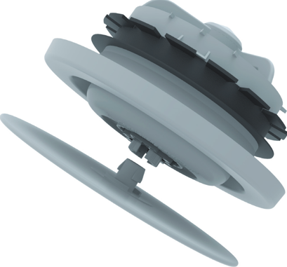

I've got my first supply and extract terminals here (Zehnder Luma). Doing a radial system with semi-rigid ducting, my plan is to do the throttling for each run at the manifold and have the terminals wide open for less resistance and noise.
In this setup, does the solid central bit inside the terminal holding the flow adjuster do anything useful (like meaningfully shape the airflow) or would a radial system like this do just as well with a flat plate hiding the plenum, a place for a filter cone, and nothing more?

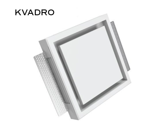

If you’re balancing at the manifold then just use a linear version which is bigger / longer than you need to distribute the airflow over a much bigger surface area.
Do you know what valves you’re using to control the flow of air, as poor ones will gain you the audibility that you are trying to rid the system of.

15 hours ago, Sparrowhawk said:
I'm thinking the design is a hangover from traditional branched systems where these are the flow restrictors, hence the name 'valves'.
It's because it's easy to adjust the flow at the valve during installation (25 different positions with that particular valve), avoiding the need to manually screw the valve in or out by X number of turns / avoiding the need to go backwards & forwards & cut sections out of a restrictor at the manifold.
Not really seeing any benefits. Works well at the terminals, zero noise, zero cost for more parts, measure, adjust done. Instead of measure, go to manifold pull off hose, pull out widget to change, re-assemble, check, repeat.
I don't yet (and in light of this thread now likely won't) but Ubbink's "pop out" rings were the kind of thing I was thinking of. Which valves are you using in your photo, they look well engineered?
Thanks gents. I'd picked up - I think from this forum, but also from at least one supplier of radial systems - that it was easier to do it all back at the manifold. Good to have cleared this up before doing anything, and explains why the terminals are as they are and not £4.99 for a metal plate and 2 retaining clips.
