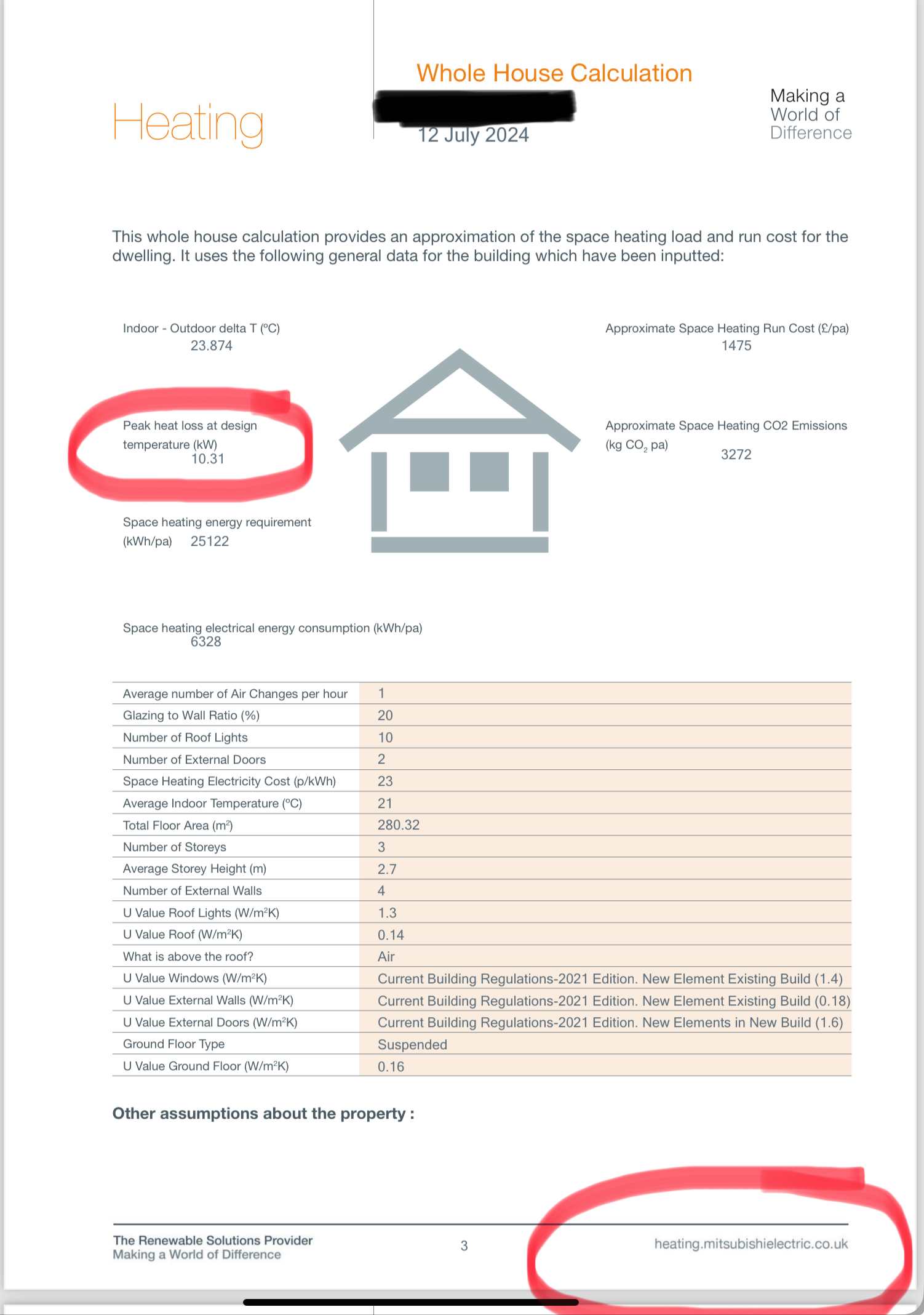

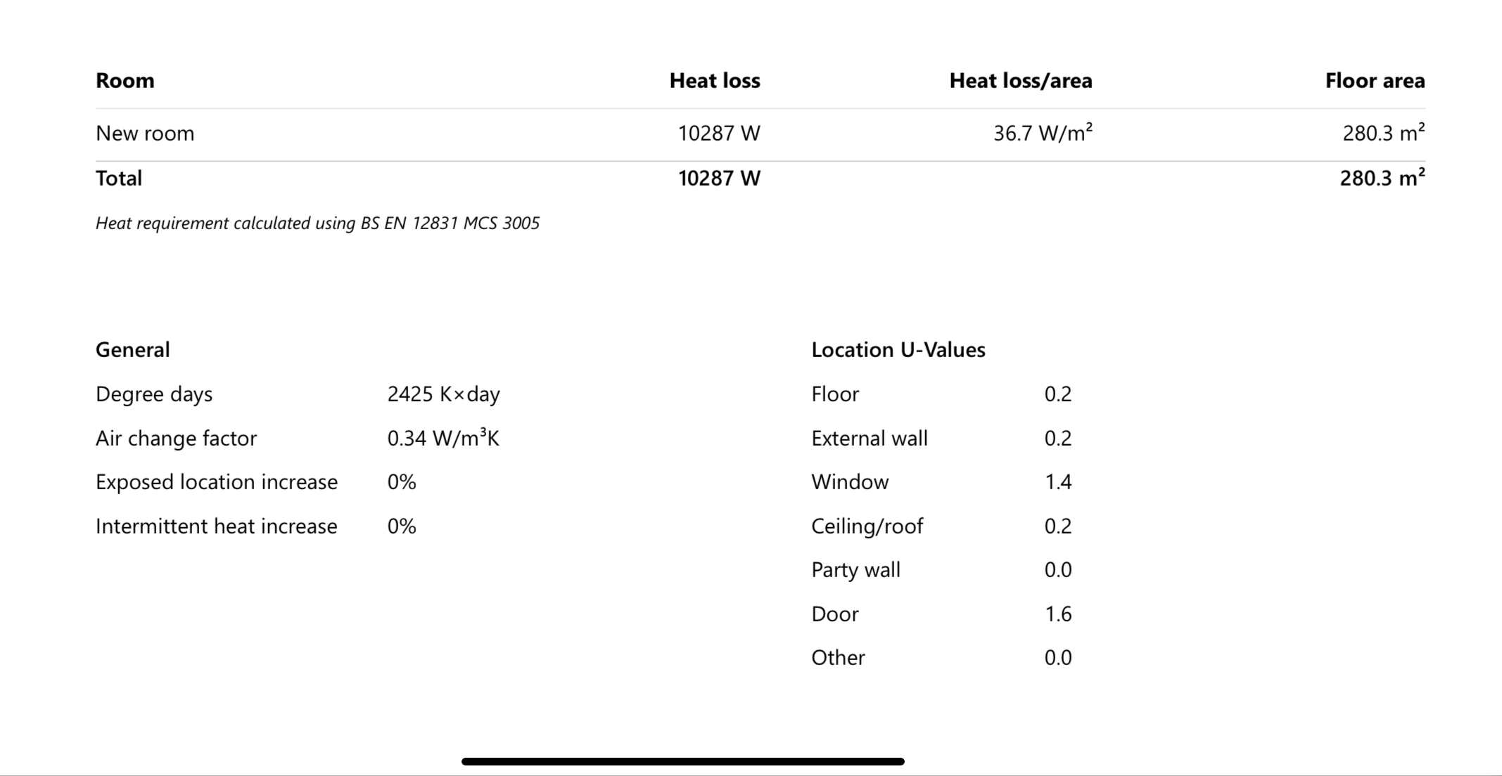

DREG Posted February 19, 2025 Author Posted February 19, 2025 3 hours ago, JohnMo said: New build and 10.3kW sounds huge. Have you checked the heat loss calculation. Post it on here to be reviewed. Or go into boffins corner and find the heat loss calculation spreadsheet and do your own calculations. To put some perspective on the number 10kW x 24hrs is 240kWh a day. A CoP of 3 is 80kWh of electric per day. Or £20 per day, just for heating. I’m doing this retrospectively as house was built in 2021. I’ve been trying to get hold of the data but it’s like pulling teeth. I believe this is the heat calc that was used by the heat pump supplier/installer

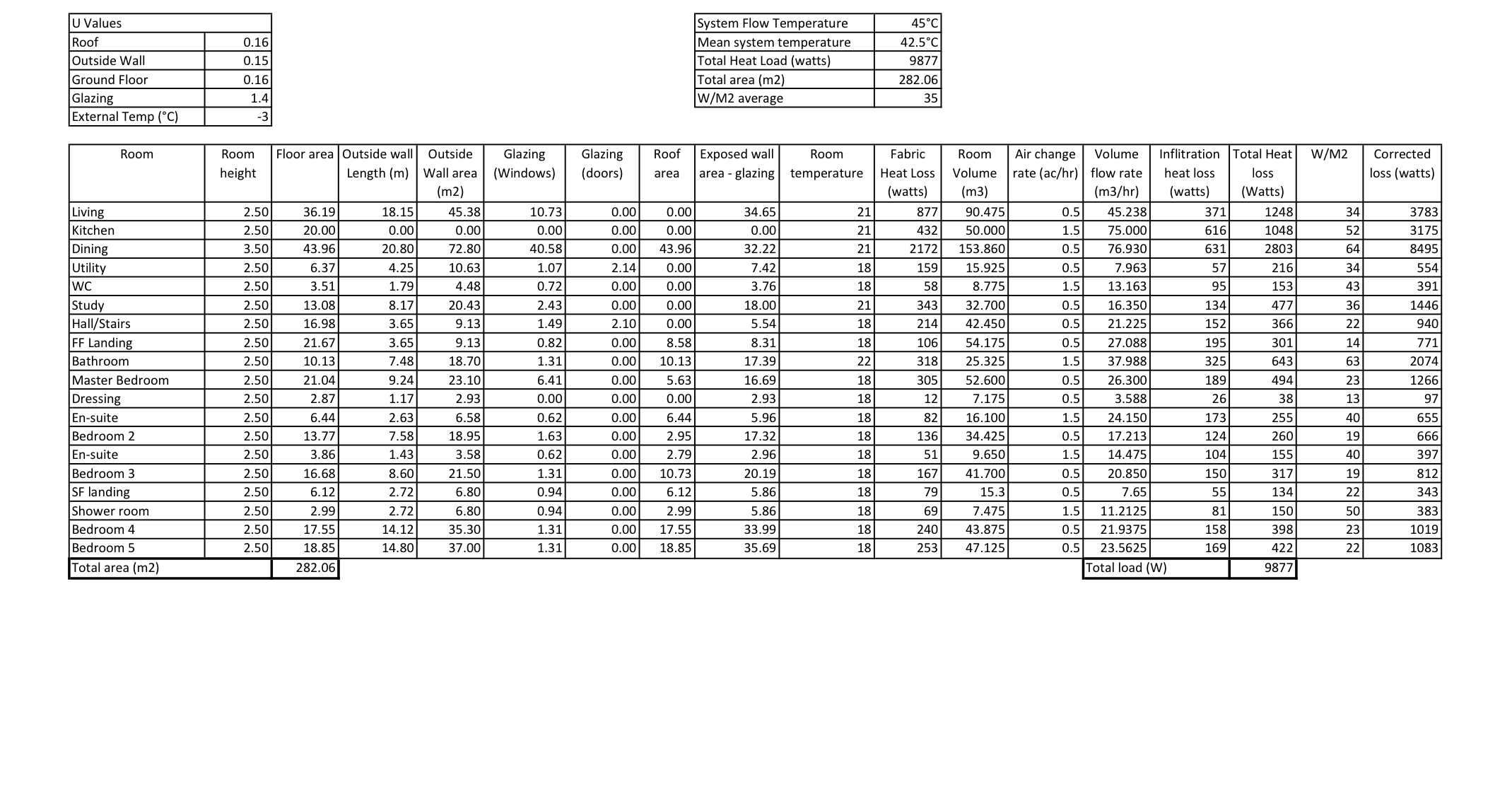

DREG Posted February 19, 2025 Author Posted February 19, 2025 (edited) There have been other heat calcs done….. heat loss 29-1-25.pdf Edited February 19, 2025 by DREG Incorrect file
JohnMo Posted February 19, 2025 Posted February 19, 2025 Compare the U values used to your build. Was an air test completed? Do you just have intermittent fans in wet rooms for ventilation?
DREG Posted February 19, 2025 Author Posted February 19, 2025 4 minutes ago, JohnMo said: Compare the U values used to your build. Was an air test completed? Do you just have intermittent fans in wet rooms for ventilation? Asked for air test result but none found. Was sent the SAP report. The bathroom and en-suites have switchable fans with isolator.
DREG Posted February 19, 2025 Author Posted February 19, 2025 1 hour ago, DREG said: I’m doing this retrospectively as house was built in 2021. I’ve been trying to get hold of the data but it’s like pulling teeth. I believe this is the heat calc that was used by the heat pump supplier/installer I think the specified room temps are incorrect: they should be 21C, according to NHBC TECHNICAL GUIDANCE 8.2/01. External temp should be -3.3C.

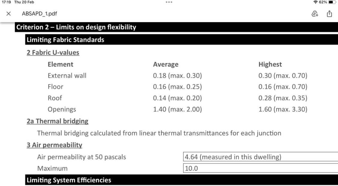

DREG Posted February 24, 2025 Author Posted February 24, 2025 On 19/02/2025 at 17:43, JohnMo said: Compare the U values used to your build. Was an air test completed? Do you just have intermittent fans in wet rooms for ventilation? Air permeability from SAP report
