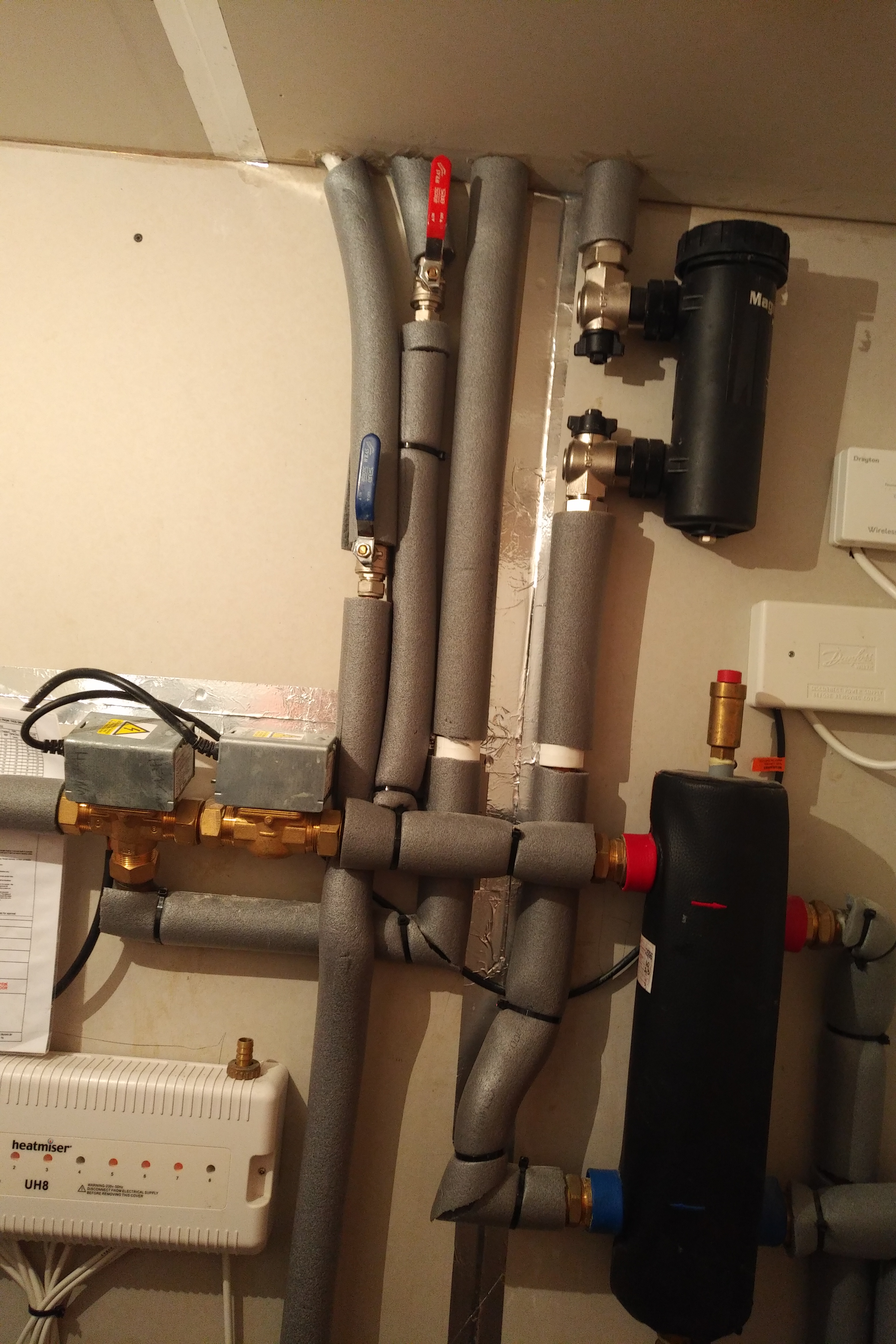

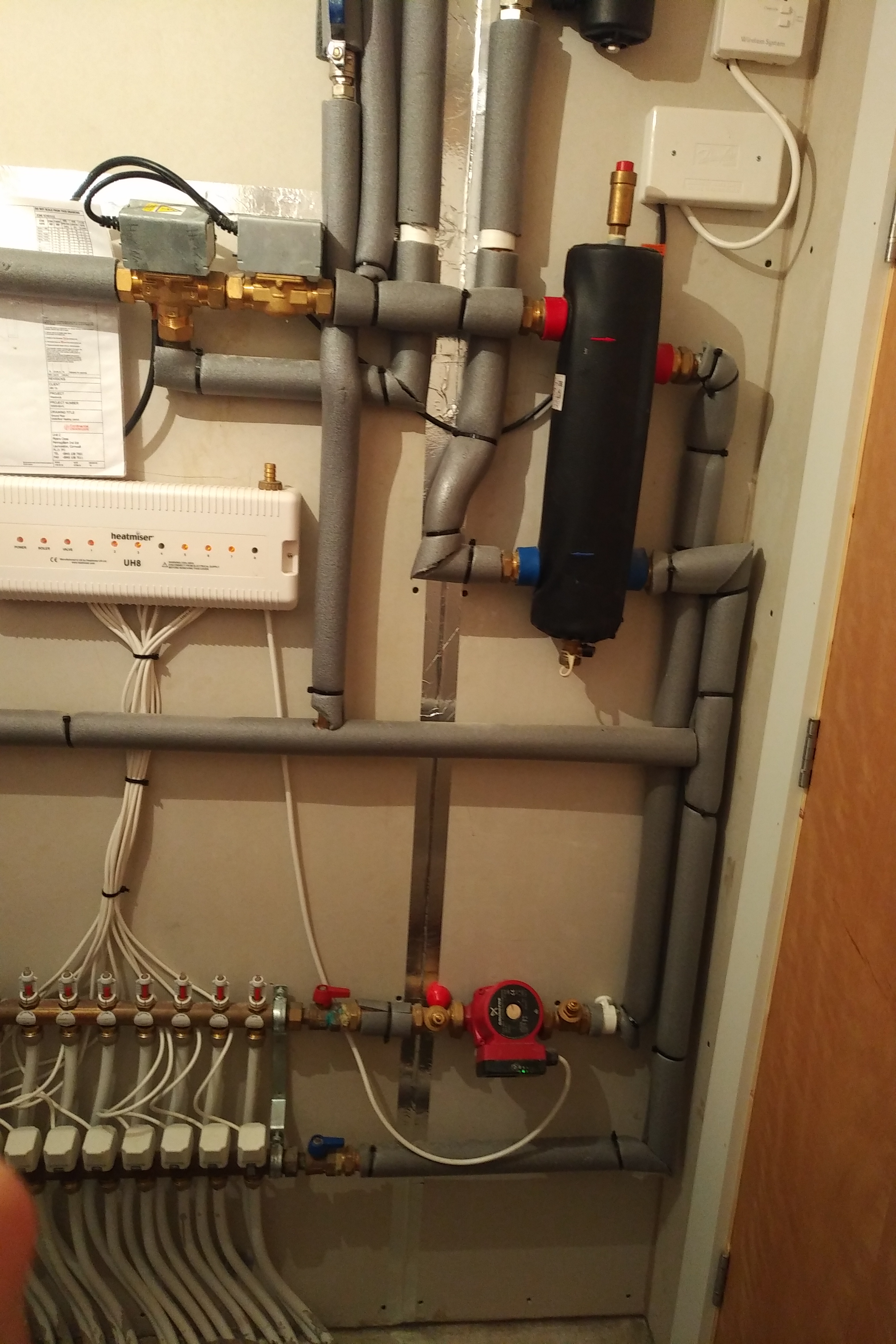

Jeremy Harris Posted December 7, 2017 Share Posted December 7, 2017 I'd still question whether the MINIMUM operating power of that LLH at the ASHP flow temperature is within limits (basically they don't work properly much below the minimum power). My guess from it's apparent size in the photo is that its minimum rating is around 40 kW at 60 to 65 deg C which means it will have a minimum of well over 60 kW at ASHP flow temperatures. I doubt your ASHP is rated at a minimum power anywhere near this. Link to comment Share on other sites More sharing options...
NSS Posted December 7, 2017 Author Share Posted December 7, 2017 7 hours ago, Nickfromwales said: ?? How does everything perform as it is now? Though I've never had UFH before so have nothing to compare to, the ground floor seems to be working fine. At present, the hall circuit tends to stay on for a bit longer than it would if it wasn't in effect trying to heat the upstairs too. Looks now as though bypassing the temp probe on the air rad is not a complete solution as it's made very little difference overnight. It calls for heat but there appears to be very little flow rate to the rad. The feed tees off before both the LLH (at least I now know what that lump is) and the circulating pump/manifold so i suspect they are drawing most of the flow. I'll add a pic showing a more general view of the set up. Link to comment Share on other sites More sharing options...
Nickfromwales Posted December 7, 2017 Share Posted December 7, 2017 Adding a gate valve to the LLH flow ( before the LLH but AFTER where it tees off for the rad ) will allow you to balance the output from the ASHP and split it equally between the manifold air rad. Link to comment Share on other sites More sharing options...
Jeremy Harris Posted December 7, 2017 Share Posted December 7, 2017 (edited) As the flow temp from the ASHP is very low, the heat output to the air rad would be well below it's design temperature, and the heat output is highly non-linear with temperature; a few degrees higher flow temperature can give a massive increase in heat output to the room when the initial flow temperature is as low as it is. My point about the low loss header, is that they have a minimum operating power at a rated temperature, and when run a long way below that power there will be a great deal of ASHP flow and return mixing, and this may well be reducing the heat available to the air rad even more, almost by accident. Edited to add: Posted at the same time as @Nickfromwales. Choking the flow to the LLH would effectively reduce the problem, but does the ASHP have a minimum flow shutdown? Some do, our Carrier does and I know that the Samsung units do too. The fix for them is not to fit a LLH but to fit a bypass relief valve, to allow sufficient flow through the ASHP if the demand side flow requirement is low. Personally, I'm not convinced a LLH is a good solution for an ASHP, as if you look at how they work they need a significant temperature differential between the heat source flow and return to operate well (hence the minimum power rating, I think). They were designed for use on boilers, really. Edited December 7, 2017 by JSHarris cross posted with Nick Link to comment Share on other sites More sharing options...
NSS Posted December 7, 2017 Author Share Posted December 7, 2017 2 pics Link to comment Share on other sites More sharing options...
Nickfromwales Posted December 7, 2017 Share Posted December 7, 2017 A 2-port AFTER the 3-port valve Curioser and curioser. . Link to comment Share on other sites More sharing options...
Nickfromwales Posted December 7, 2017 Share Posted December 7, 2017 @NSS Can you post the model / part numbers of each of those ( silver metal boxed ) zone valves please? Link to comment Share on other sites More sharing options...
Jeremy Harris Posted December 7, 2017 Share Posted December 7, 2017 (edited) 7 minutes ago, Nickfromwales said: A 2-port AFTER the 3-port valve Curioser and curioser. . And a magnetic filter intended for use in a system with ferrous metal components, something that would be routinely fitted to a boiler and radiator system but not to an ASHP and UFH system, as it serves no useful purpose. Any debris in such a system won't be magnetic, (no steel radiators), there's no collection of mixed metals to exacerbate corrosion, and all an ASHP system ever needs is a Y strainer. I'm even more convinced that the design was by someone unfamiliar with both ASHPs and UFH, and that the system has been designed as if it were radiators running from a boiler. This isn't surprising, as has been quoted here a few times, there is a bit of a lack of experience in fitting ASHP systems in the UK, and was the main reason given for the very poor results from the first heat pump performance survey conducted by the Energy Saving Trust some time ago. Edited December 7, 2017 by JSHarris Link to comment Share on other sites More sharing options...
NSS Posted December 7, 2017 Author Share Posted December 7, 2017 12 minutes ago, Nickfromwales said: A 2-port AFTER the 3-port valve Curioser and curioser. . Yep, that has me confused too, particularly as the 2-port is not actually wired into anything. They are both Honeywells, V4044C1569 and V4043H1106 Link to comment Share on other sites More sharing options...

Jeremy Harris Posted December 7, 2017 Share Posted December 7, 2017 (edited) 6 minutes ago, NSS said: Actually there are steel radiators (dual fuel towel rails) in the two ground floor bathrooms. Each is fitted in line to the respective UFH circuits. Ah, OK, so the filter makes sense. It begs another question though, with the ASHP set to such a very low flow temp, these radiators must be running at the same temperature, so they will also barely be getting warm. That may be fine if they are massively oversized to allow for the large reduction in heat output with flow temperature, though. I'm no heating engineer, but it would seem logical to me to run the higher temperature heating appliances, the radiators and air rads, directly from the ASHP, and set the ASHP to a reasonable temperature, say 40 deg C, so these work OK, then have a thermostatic mixer to reduce the flow temperature to the UFH so that can run at it's optimum temperature, probably no more than about 28 to 30 deg C, if that. Edited December 7, 2017 by JSHarris Link to comment Share on other sites More sharing options...

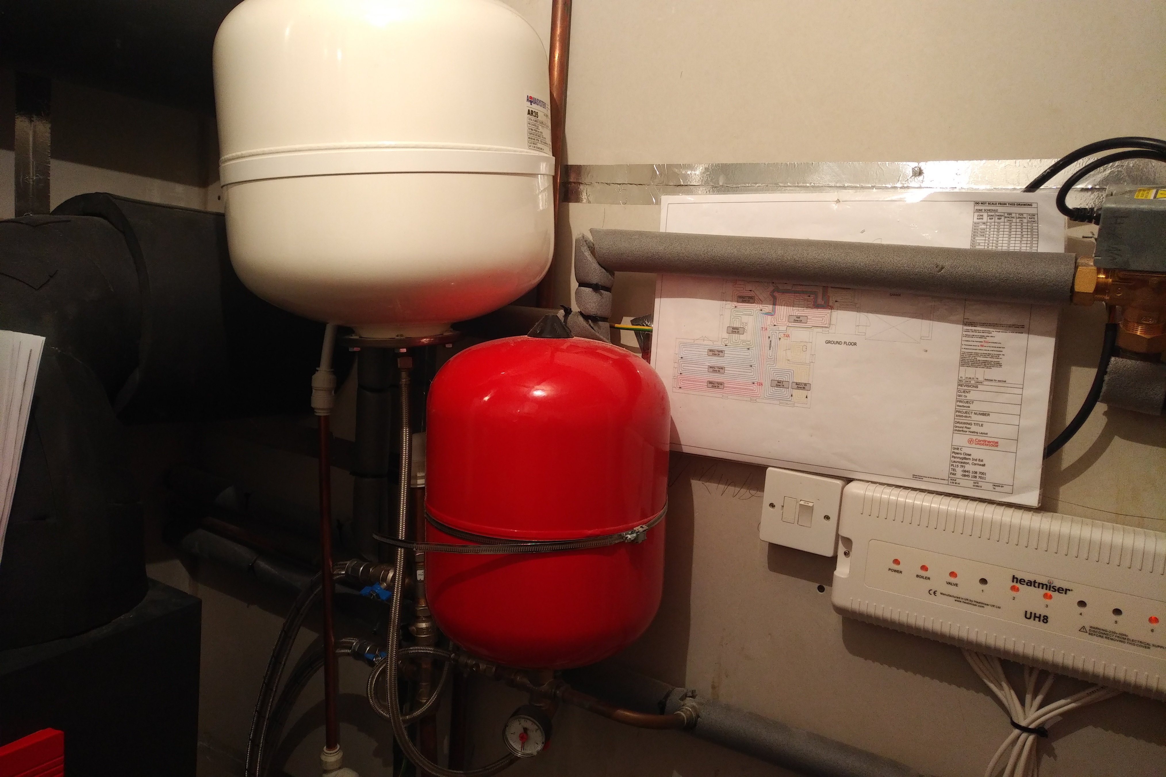

NSS Posted December 7, 2017 Author Share Posted December 7, 2017 8 minutes ago, JSHarris said: Curious that they should choose such an unusual configuration, and one that imposes restrictions on both the air rad performance and the ASHP performance, then. Out of simple curiosity, and as someone fond of odd and unusual set ups, why did you choose to have the system configured in this unusual way, with the ASHP throttled back to a small fraction of its rated output in order to maintain a very low flow temperature to the heating circuits? The efficiency hit must be quite high, as the ASHP will be running way below its minimum modulated output much of the time, especially with no buffer ( I assume there's no buffer because there's the low loss header). That implies that a lot of the time the ASHP will be doing many more starts and stops than it needs to, and it's starts and stops that hit ASHP life quite hard, particularly the compressor. Not sure how it effects what you're saying, but it does have a buffer. Link to comment Share on other sites More sharing options...

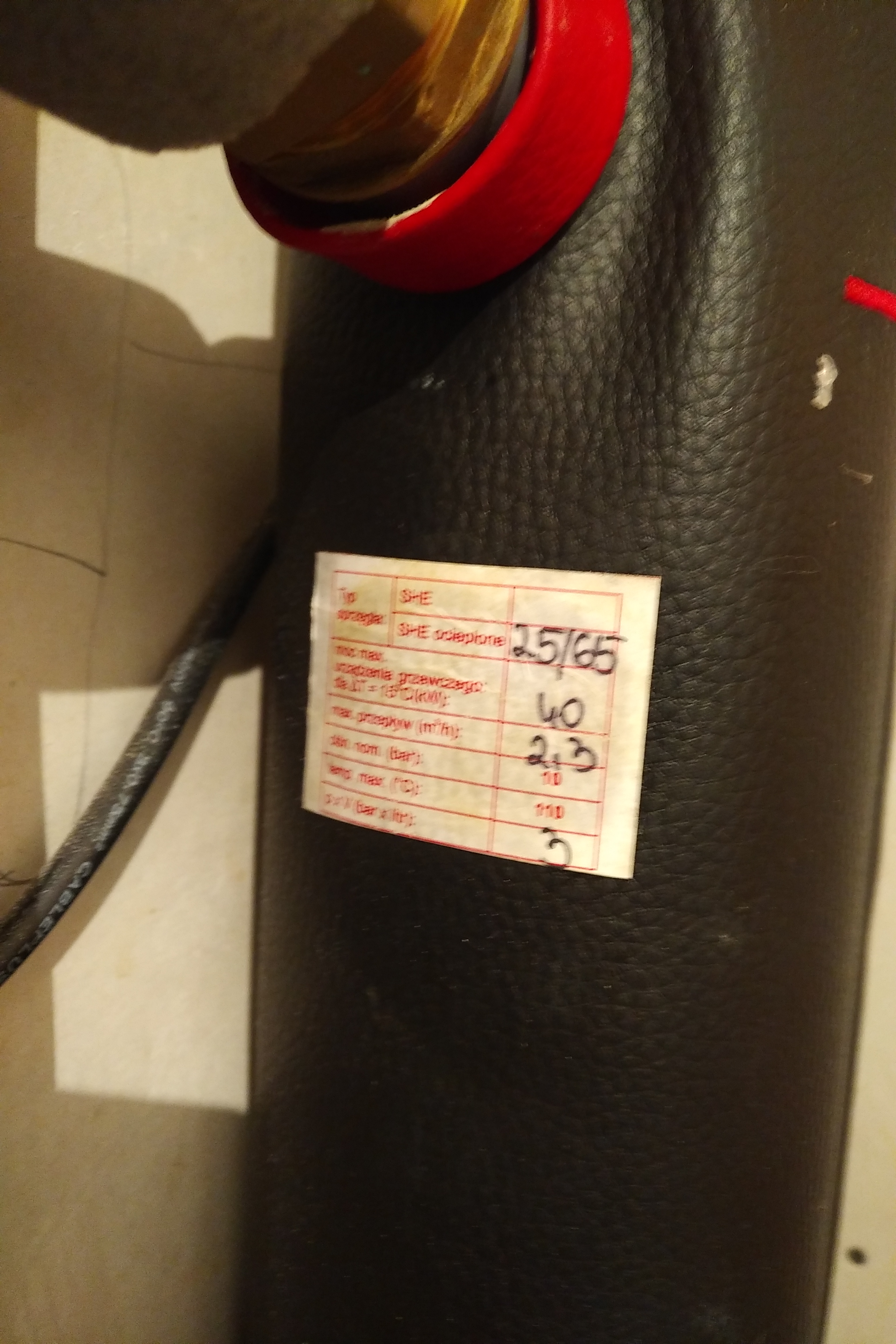

Jeremy Harris Posted December 7, 2017 Share Posted December 7, 2017 (edited) That's the pressure vessel, not a buffer tank. The low loss header is acting as an extremely low heat capacity buffer, but frankly won't really be working properly, because the temperature differential between the top and the bottom of it will be way below the design rating for that model, which looks to be a 40 kW boiler model. You can get taller low loss headers that are specifically designed to be used with low power output and low flow temperature heat sources like ASHPs. They are designed to reduce the cross flow top to bottom when the temperature differential is low, when compared to the high temperature boiler-type units, so they work OK at typical ASHP temperatures of around 40 deg C or so. They aren't that popular, it seems, perhaps because they are expensive when compared to the simpler fix of just fitting a standard pressure bypass valve across the ASHP flow and return in order to meet the minimum flow requirement without triggering a primary circuit over-pressure event. Edited December 7, 2017 by JSHarris Link to comment Share on other sites More sharing options...
PeterW Posted December 7, 2017 Share Posted December 7, 2017 I’m not sure even that LLH is correct as it’s behind the 3 way valve and there are what looks like tee’d returns into the manifold return before that. If that’s the case then that air rad is probably not going to get anything like the flow it needs as it’s reliant on back pressure elsewhere in the system to force the flow into it which the LLH is designed to eliminate ... Also if the rad is tee’d off before the diverted valve, then it will get heat during the DHW cycle too..! Link to comment Share on other sites More sharing options...
NSS Posted December 7, 2017 Author Share Posted December 7, 2017 13 minutes ago, JSHarris said: That's the pressure vessel, not a buffer tank. The low loss header is acting as an extremely low heat capacity buffer, but frankly won't really be working properly, because the temperature differential between the top and the bottom of it will be way below the design rating for that model, which looks to be a 40 kW boiler model. You can get taller low loss headers that are specifically designed to be used with low power output and low flow temperature heat sources like ASHPs. They are designed to reduce the cross flow top to bottom when the temperature differential is low, when compared to the high temperature boiler-type units, so they work OK at typical ASHP temperatures of around 40 deg C or so. They aren't that popular, it seems, perhaps because they are expensive when compared to the simpler fix of just fitting a standard pressure bypass valve across the ASHP flow and return in order to meet the minimum flow requirement without triggering a primary circuit over-pressure event. Okay, as most of you will have guessed, a lot of this is going straight over my head. Here's a close up of the 'plates' on the LLH. Link to comment Share on other sites More sharing options...
Jeremy Harris Posted December 7, 2017 Share Posted December 7, 2017 Yes, that's a standard boiler 40 kW low loss header. Link to comment Share on other sites More sharing options...
