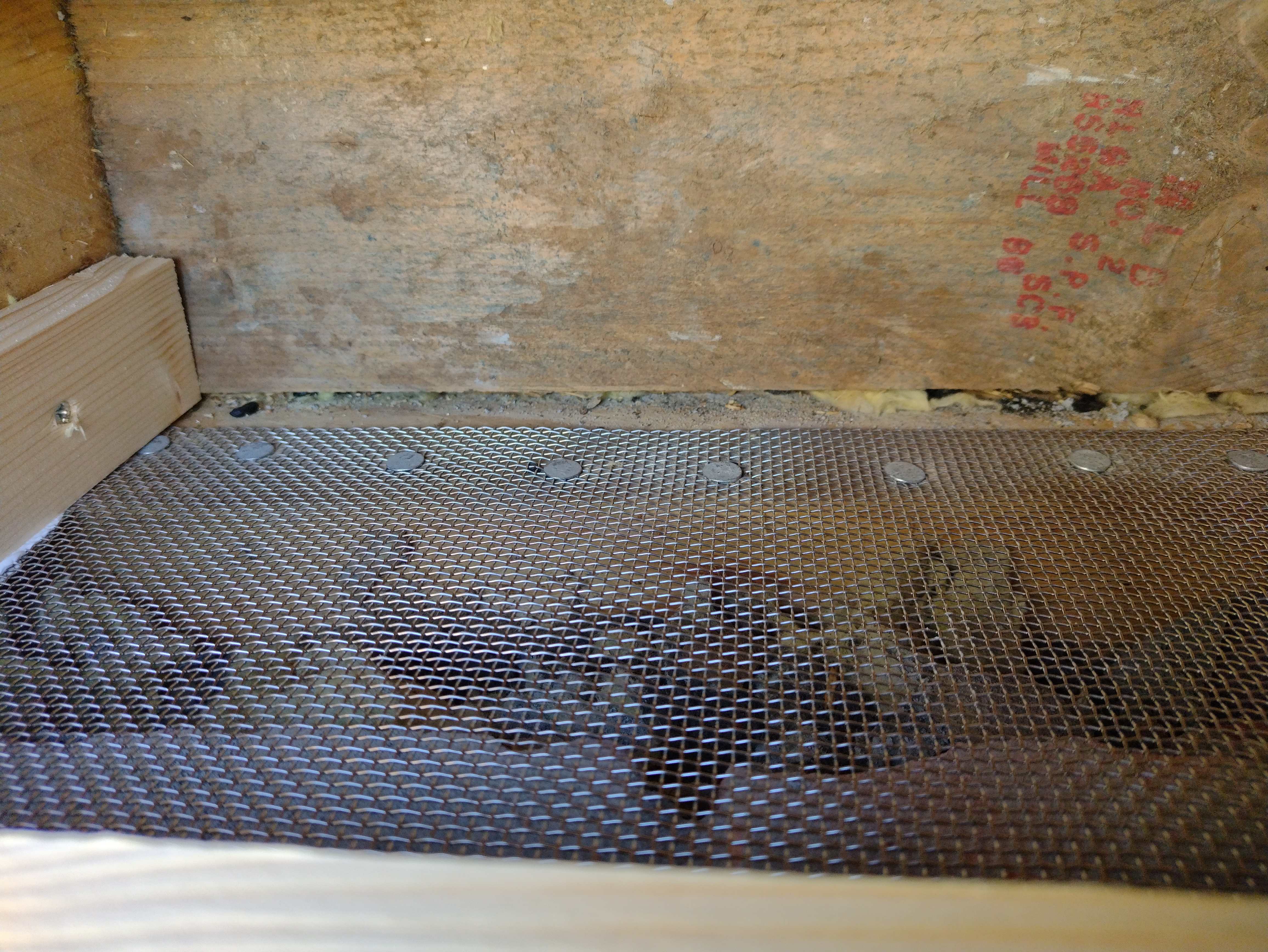

Big Jimbo Posted February 12, 2025 Posted February 12, 2025 So while I have been away, my daughter told me that the rats were back in her kitchen ceiling. Now I expect they are getting into the walls by the lintels over the drains. The trouble is that the path is concrete, and to access the soil pipe and lintels I am going to have to break that up. Unfortunately that is on the neighbours land. I will have to sort that at the end of the day, but in the meantime, as the extension is 90's cavity, I guess they are getting into the cavity, and climbing up, then having a party in the ceiling. The extension needed some new facia boards. I took the opportunity to block off the top of the cavity (which I believe is now a recommendation in building regs.) I used a roll of stainless steel mesh. It has solved the problem although I expect they are still in the walls. I will sort that when I get a chance to sort with the neighbour about digging the path up.
Big Jimbo Posted February 12, 2025 Author Posted February 12, 2025 I will get the Mrs to dig out the receipt, and let you know. Stainless steel, so no rot.
Big Jimbo Posted February 12, 2025 Author Posted February 12, 2025 I cleared out about 25 nests, so it was a bigger problem than I thought. I put a gallon of white vinegar into the cavity. Poured onto the fluffy stuff. The smell apparently deters them for a time

Big Jimbo Posted February 12, 2025 Author Posted February 12, 2025 @Onoff. The mesh company . Com Rodent mesh. 1
