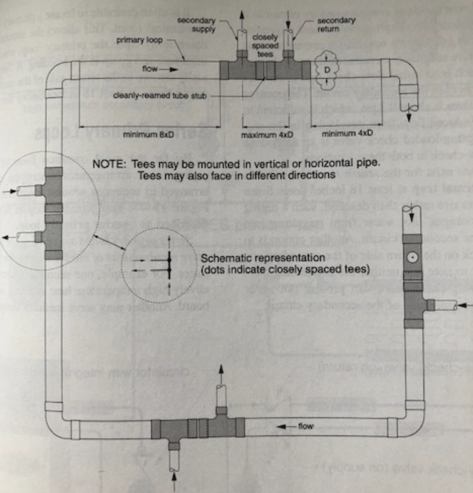

Nickfromwales Posted February 13 Posted February 13 1 hour ago, Burkle said: It does have one out from the diverter back to the back of the return / pressure release valve, and it often gets too hot to touch Probably opening when the UFH is the only demand, and has been doing so for a long time, as with the UFH (as mentioned above) the flow from the boiler pump is firing against a brick wall (when UFH is doing very little / house nearly at temp and just one stat is still calling) unless the bypass valves take the strain and open up. Issue is, they just get worse at closing fully as time goes by. I also do not ever fit those types of UFH blending valves as they are notorious for making squealing noises when the hot in / hot out ratio is close or equal. as they try to strangle the flow; this is at it's worst when it's a decent house with very low temp required or the UFH flow to the loops. The knock on effect of that 'water hammer' (in essence) is that is gets sent hydraulically back through the system and wakes up any other valves or parts which want to sing in harmony. UFH is often fitted very carelessly, and I have seen some installs that you'd think I was making up just how shite the install / setup / plumbing to and from was, and that's not getting started on the number of jobs I have visited that just should NEVER had UFH in the first place (70oC flow into the loops and the rooms at 17oC and no more). If the boiler gets changed or fixed, I'd still want a piece of 22mm pipe bridging the flow and return at the UFH, installed as close to the UFH pump as possible, on close couple arranged tees, so the boiler can just whizz back to itself with zero resistance. An ABV is just unnecessary tbf, and the tee in arrangement will work wonderfully well at completely hydraulically separating the boiler flow from the UFH flow. A lot of people forget that the UFH manifold pump is sucking water through the TMV vs pushing it through. It is free to ignore the TMV and recirculate without effort, the same scenario which you should be creating for the boiler pump. I fear lots have been fixed / interfered with here, instead of the culprit, and this has woken the 'old gas boiler gods' and made them all angry. I have to strip my Ariston combi next week as the PHE has started to dribble, and I bet that ends up in the skip and me in therapy.
Burkle Posted February 13 Author Posted February 13 2 hours ago, Nickfromwales said: If the boiler gets changed or fixed, I'd still want a piece of 22mm pipe bridging the flow and return at the UFH, installed as close to the UFH pump as possible, on close couple arranged tees, so the boiler can just whizz back to itself with zero resistance. An ABV is just unnecessary tbf, and the tee in arrangement will work wonderfully well at completely hydraulically separating the boiler flow from the UFH flow. Something like figure 3 in this image thank you for a thorough explanation of everything too! 1
Nickfromwales Posted February 14 Posted February 14 22 hours ago, Burkle said: Something like figure 3 in this image thank you for a thorough explanation of everything too! Yup, that's the kiddy. That should make the (new / old whatever) boiler very happy and let it go on to live a full working life AND enjoy retirement 1

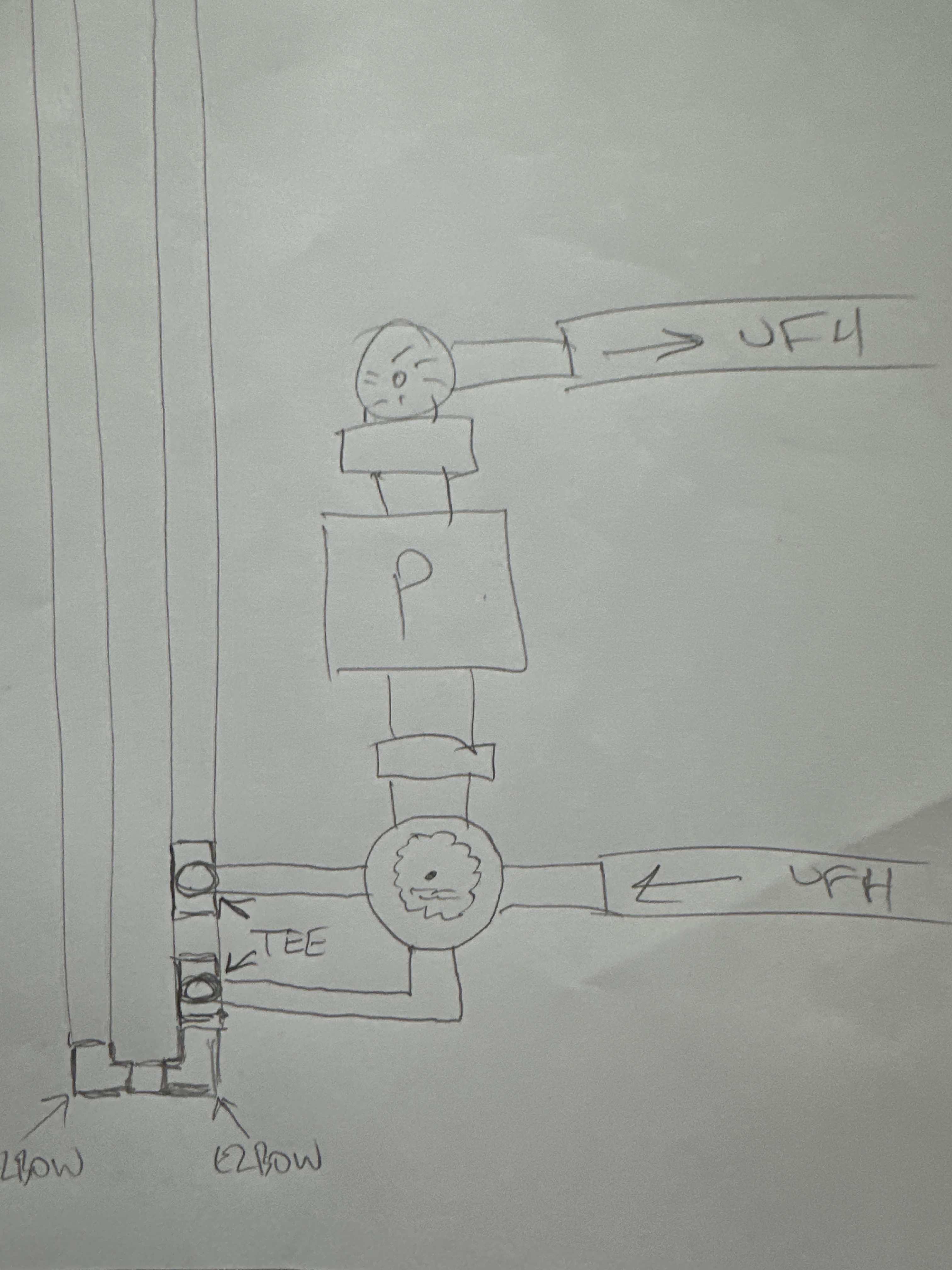

Burkle Posted February 16 Author Posted February 16 I will have a proper look when I'm home, but not sure there will be enough space available where the pipes have been dropped down in a corner. Might be able to make a primary flow circuit in the first floor under floor boards before they drop down as secondary (secondary flow pipes are going to be around 3m away though then).
Nickfromwales Posted February 16 Posted February 16 33 minutes ago, Burkle said: I will have a proper look when I'm home, but not sure there will be enough space available where the pipes have been dropped down in a corner. Might be able to make a primary flow circuit in the first floor under floor boards before they drop down as secondary (secondary flow pipes are going to be around 3m away though then). Post a pic so we can make some suggestions. 👍
JohnMo Posted February 16 Posted February 16 Guidance on close coupled tee install dimensions, so you get proper hydraulic separation. 1 1
Burkle Posted February 16 Author Posted February 16 These photos show the current arrangement under the boiler upstairs with the ABV, and then the arrangement at the manifold downstairs
Nickfromwales Posted February 16 Posted February 16 If this was to be the 'ultimate spec' conversion, then between the 2 close-coupled tees would be another 2-port motorised valve that is "normally open". This would stay open until it was energised by the brown wire that provides signal to the radiator motorised valve. The worry would (could) be that, if there is this permanent bypass loop, when the rads are on that may allow the boiler to ignore some of the rads or decrease the flow to them more than you'd want. The second 2-port would allow the system to toggle between UFH only (with the valve open to allow the boiler to recirculate) and UFH + RADS (with the valve closed) to return this to the way it's currently plumbed). This sounds like overkill, but it's actually the correct way to set this up without a buffer or low loss header. Soooooooooo many plumbers just don't get it; that they set things up which appear to work "fine" on the day, week, month or year(s), but the setup is on borrowed time from day 1 as so many parts are functioning under duress.
Burkle Posted February 16 Author Posted February 16 There is the current 2 port valve (the snug lite) for the ufh on the flow, then the CH circuit valve under the boiler on the flow after the t off to the ufh flow.... so if i read correct, ideally the 2 port valve on the ufh circuit would be between the close coupled t's (open with ufh all the time), and would be closed if both the CH and UFH are on... that way there will be a circuit to the CH open at the same time the UFH is on a loop, but if only the UFH is on then there is a bypass on with this. As you can see there isn't space for this, and the manifold can't move, but might there be anything to help this with the current ABV set up? Obviously currently the ABV is there whether the UFH is on or the CH or both, and I presume in reality the setting of the ABV would be different if you treat both individually. Sorry for all the questions! I have a basic understanding of how the circuits can and would work, however I don't have the experience of it! If I am replacing the boiler I'd like to try and ensure the system is going to function. Just as a side note (whilst I'm waiting on people to see and quote for boiler replacement), I've stripped down the diverter valve again and put all the old parts back in but cleaned up with the washers from the newer parts. There is no longer any whining / whistling, and the CH seems to be working OK (albeit, the system still needs balancing properly since all rad valves got replaced). However, the UFH circuit now cuts the boiler after around 10 minutes with either safety stat fault or primary circuit fault. I've tried increasing the UFH pump speed and decreasing it but both seem to be the same. The water gets through as the manifold gets warm. It's presumably a flow issue, and another reason for trying to ensure the actual circuit is OK before just replacing the boiler

Nickfromwales Posted February 17 Posted February 17 11 hours ago, Burkle said: As you can see there isn't space for this, and the manifold can't move, but might there be anything to help this with the current ABV set up? I’ll have another look at space / options and reply a bit later 👍 1
