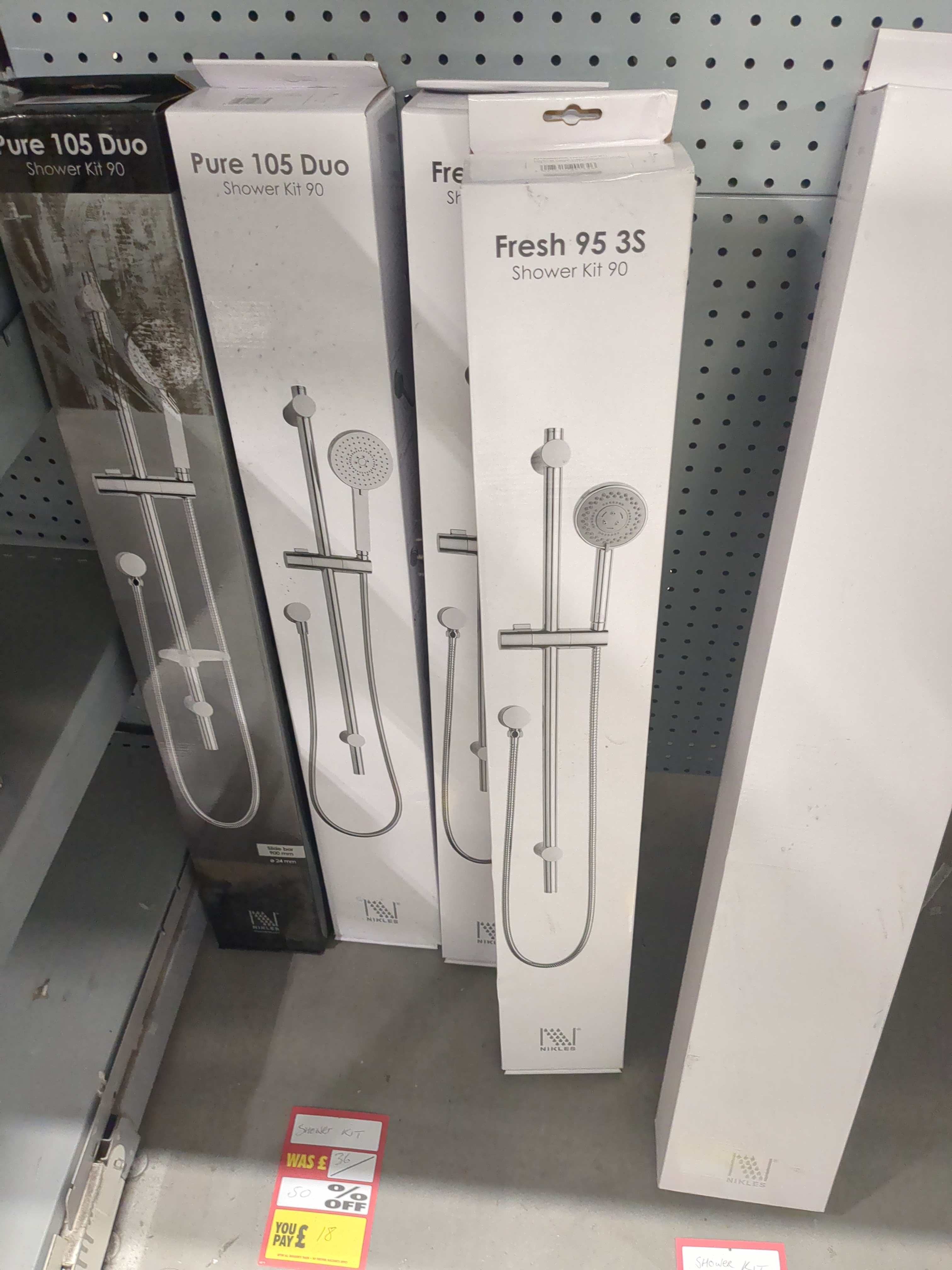

Hi there, in homebase it's closing some bargains....
Saw these for shower and was wondering would they do? They will be supplied from tank in loft. So is it just a matter of the plumber attaching this to the 2 pipes coming out of the wall? £18
Edited by CalvinHobbes
They are just shower heads, a pipe and a wall bracket.  There way be a flow restrictor in there somewhere.
You'd need a thermostatic mixer valve to connect to the 2 pipes, then this setup pictured receives the output of the valve.
This is also only suitable for a concealed arrangement, so a PITA to fit.
