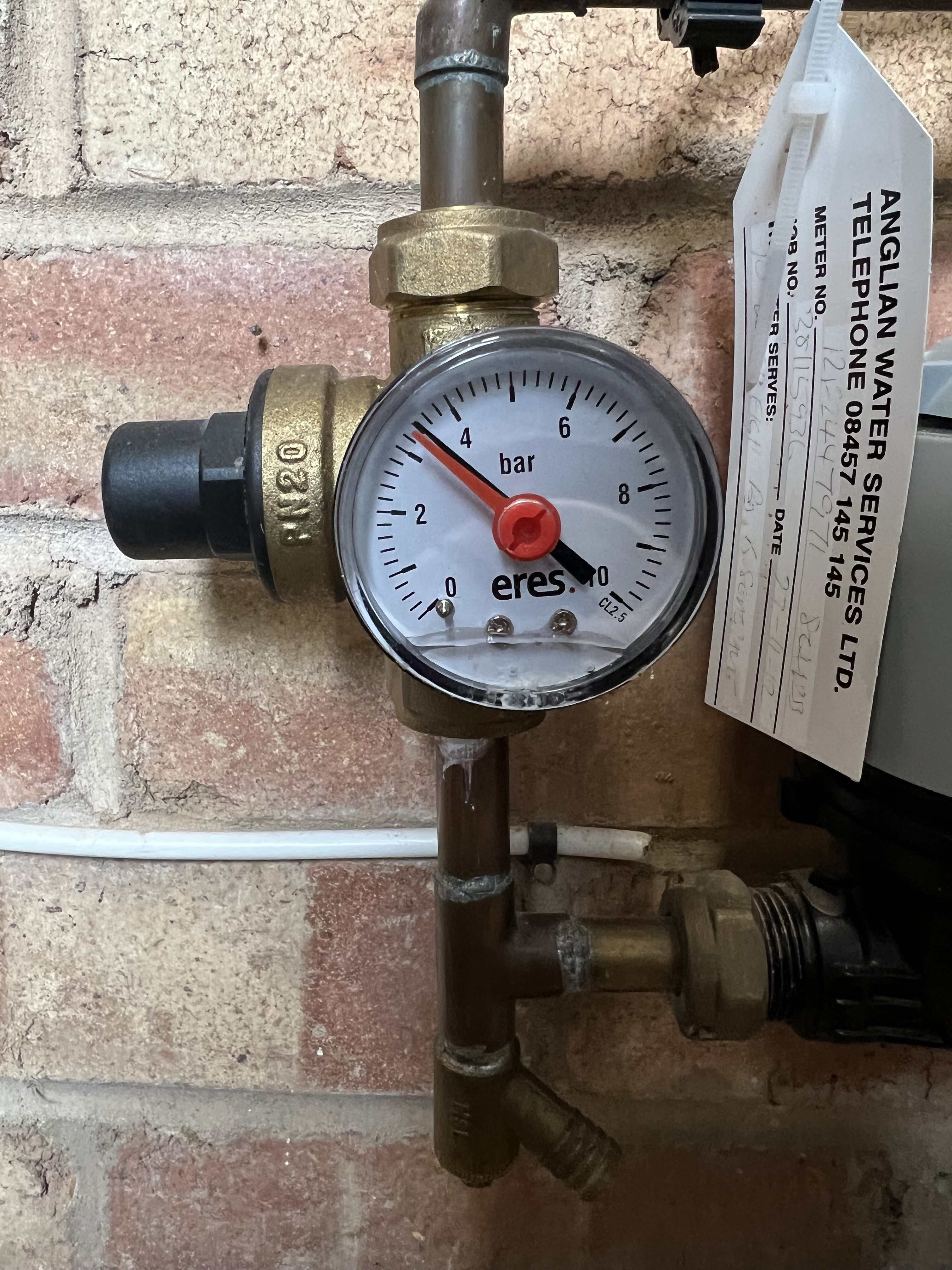

steveoelliott Posted Sunday at 13:44 Posted Sunday at 13:44 (edited) It happens after a reheat if it’s going to happen, but then doesn’t always. here is a picture of the PRV. I am concerned there is water in a gauge which I’ve just noticed. Good advice re setting the PRV. I will try that. Edited Sunday at 14:09 by steveoelliott
steveoelliott Posted Sunday at 17:58 Posted Sunday at 17:58 And of course replace the gauge next week @John Carroll. I know previously you’ve said about installing gauges at multiple locations but the risk of this happening to them and potentially leaking is a concern for me.

steveoelliott Posted Tuesday at 08:26 Posted Tuesday at 08:26 @Alan Ambrose @John Carroll Thanks for the feedback. The valve in this case is just part of the PRV but it can be easily capped off. I noticed this morning that the water has dribbled out the front of the gauge but there doesn't appear to be any new water. Something must have triggered this weep or it could even be condensation. My plumber is supposed to be coming to cap it or swap it.

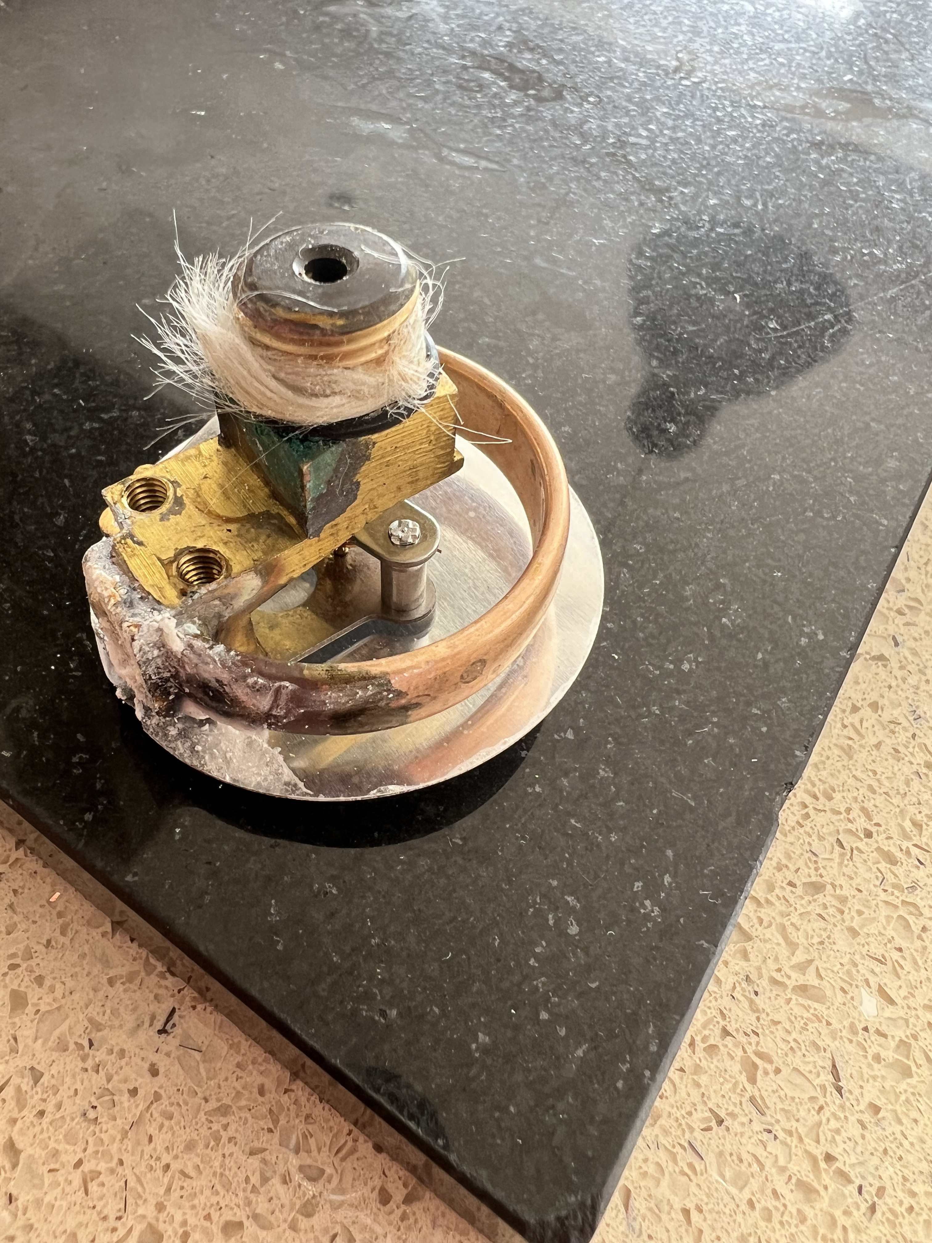

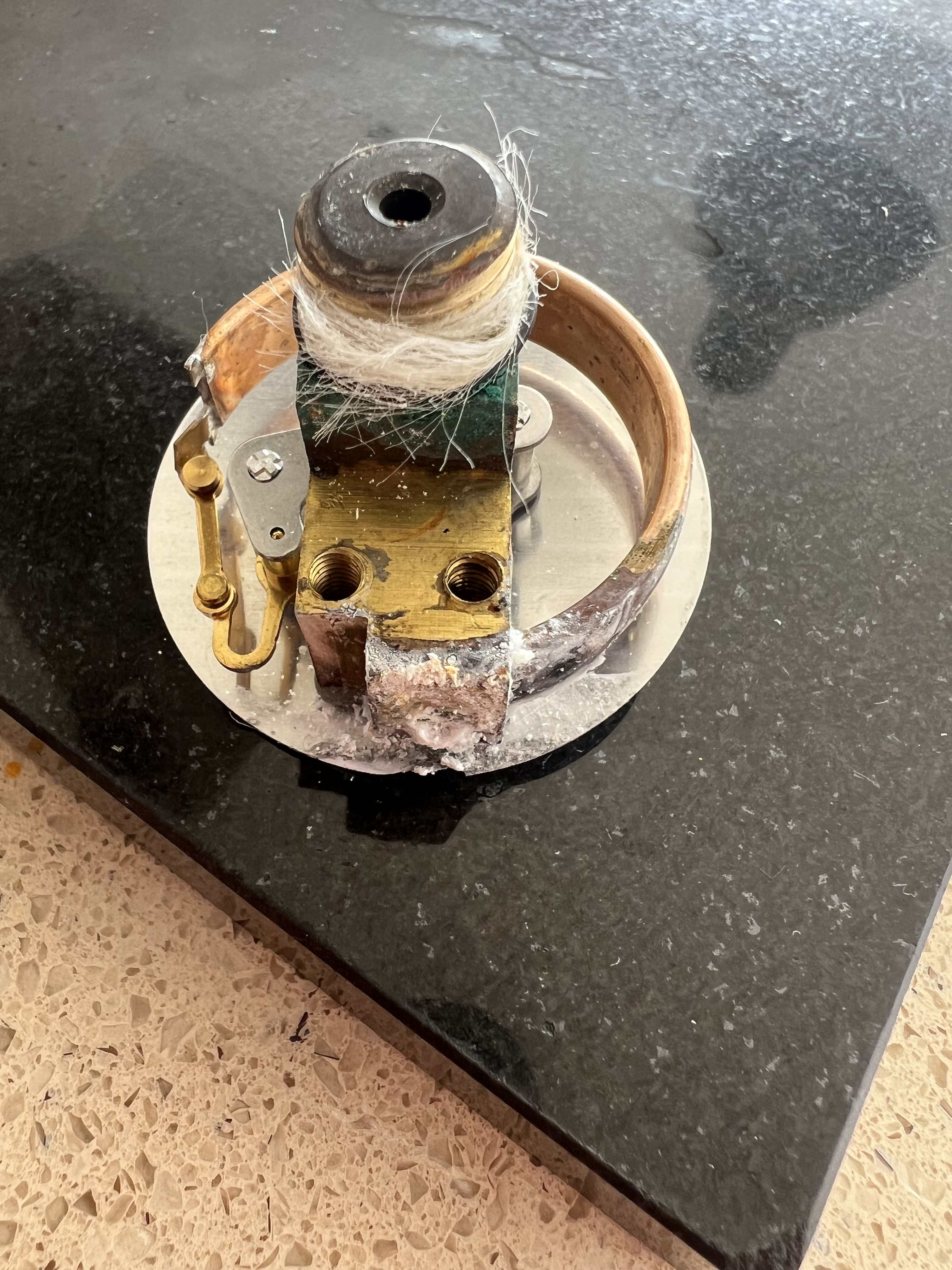

steveoelliott Posted Tuesday at 15:14 Posted Tuesday at 15:14 Interestingly I got a response from the manufacturer stating that the gauge on the PRV should only be connected when setting the PRV and then capped. They said that constant exposure will inevitably lead to corrosion of the bourdon tube and lead to leaks.
steveoelliott Posted Wednesday at 16:06 Posted Wednesday at 16:06 The gauge was removed today by my plumber and capped off. As you can see there was some corrosion internally and I think eventually this may have caused some issues. 1

Nickfromwales Posted Wednesday at 16:23 Posted Wednesday at 16:23 Looks to have passed the O-ring and not to have breached the hydraulic body as such. Prob because string / rope was used not PTFE tape....
steveoelliott Posted Wednesday at 17:13 Posted Wednesday at 17:13 @John Carroll I didn't play with it whilst the gauge was compromised, I will need to do this with a gauge on the outside tap again. @Nickfromwales Not sure if the gauge was pre-installed or my plumber put this on the PRV. I know the new cap thread was put on using liquid PTFE. That said, the leak was definitely internal to the gauge. That green staining behind the O ring was never wet and I suspect it may have been the result of condensation as I've seen it on these pipes before when cold water comes in. 1

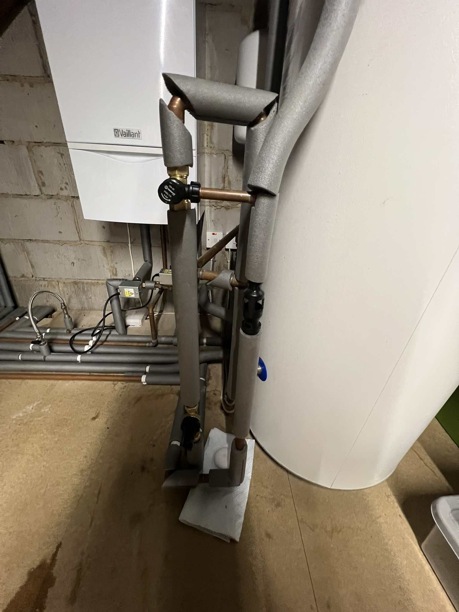

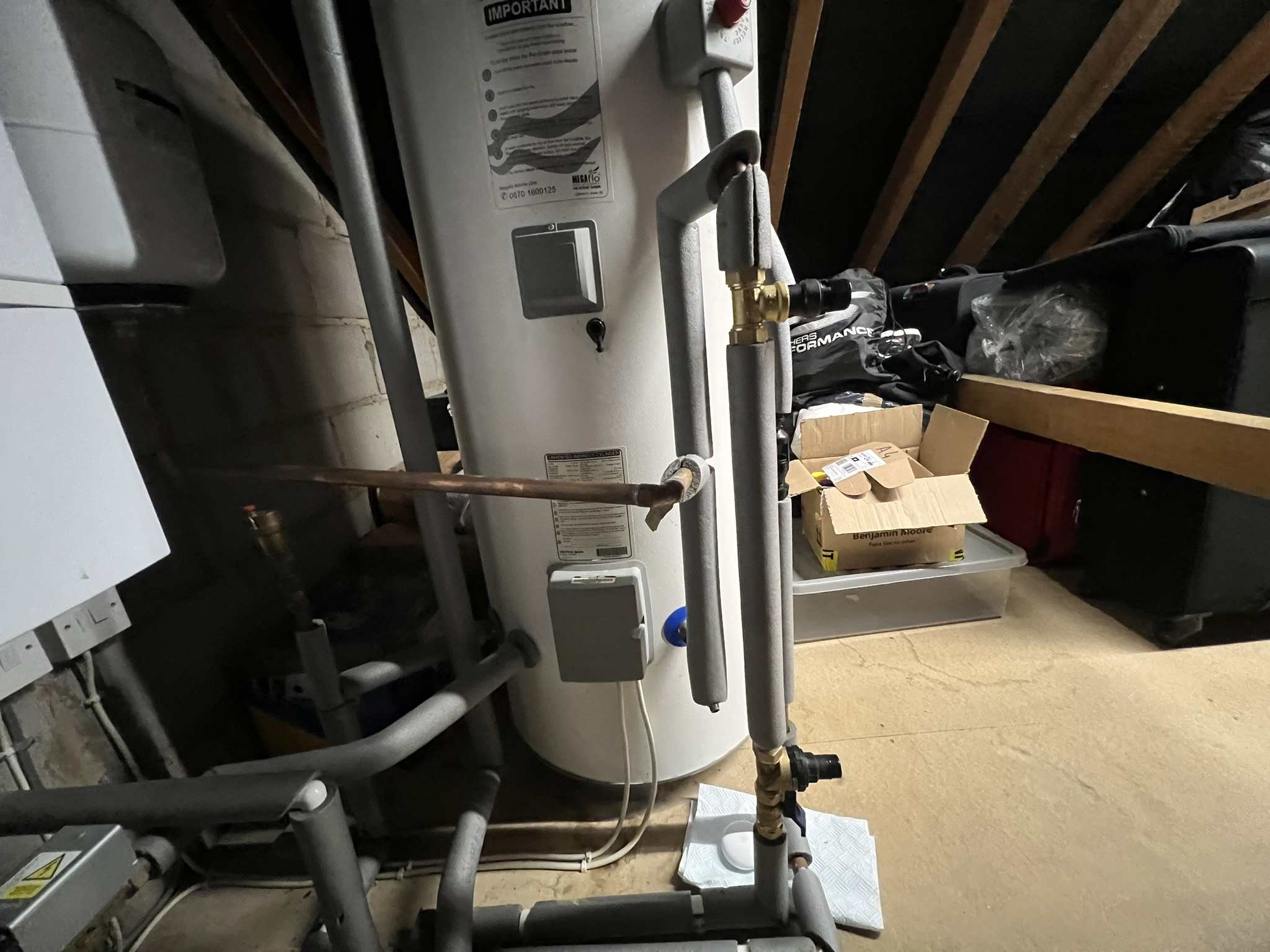

steveoelliott Posted 21 hours ago Posted 21 hours ago Coming back to my original issue, I even got the noise (previously) with the cold inlet to the Megaflo shut off after a reheat. Now I guess there would be pressure in the small piece of pipe between the cold inlet closed but I would be surprised if this caused the issue. I measured the water temperature at the tap which is some distance from the tank and it measured 57.5 with the tank thermostat set to whisker above 3. I debated dialing the temperature down a little to see if that stops it but one has to be careful of legionnaires. I haven't lowered the EV pressure to 1.8 bar yet, it's something I intend to do when back from a business trip. Playing with it just before I go and leave my wife here isn't something I'm keen on doing as at least I can keep an eye if here. Mind you it was set at 2.8 bar back in January so I suspect it will be decreasing slowly anyway I had wondered if the layout of the pipework from EV may cause issues like this to occur or be worse.
