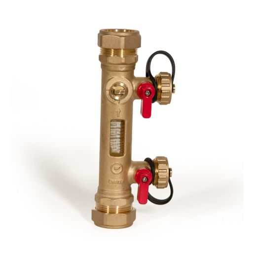

Beelbeebub Posted February 9, 2025 Posted February 9, 2025 Might be worth getting an old fashioned flow gauge fitted at the same time so you can get a visual indication of thr flow independent of any electronic device.  Faulty flow sensors can be a bugger to identify, especially if they are intermittent.  With this type of gauge you can confirm if there is a flow or not (plus can see the condition of the fluid)Â
