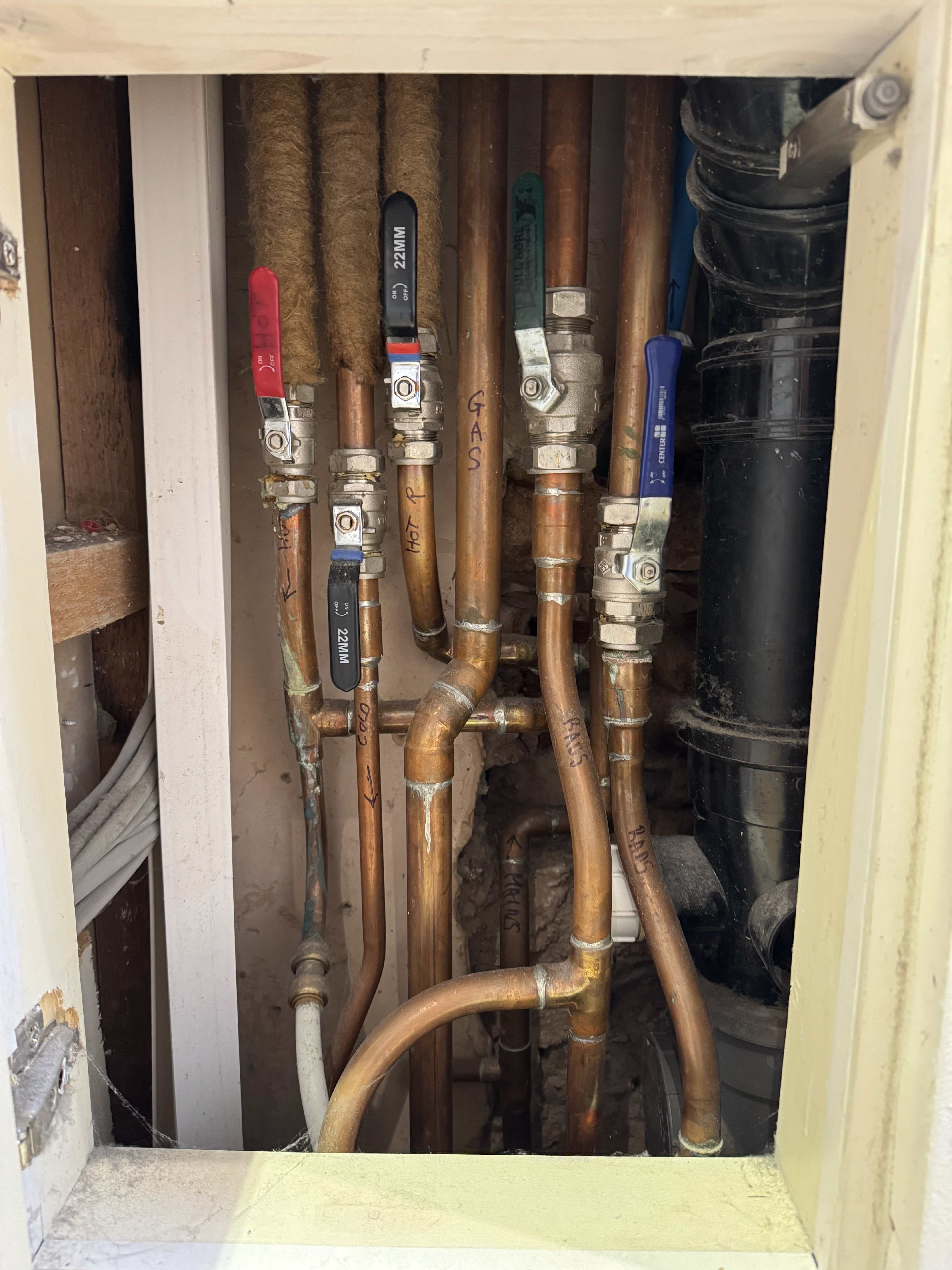

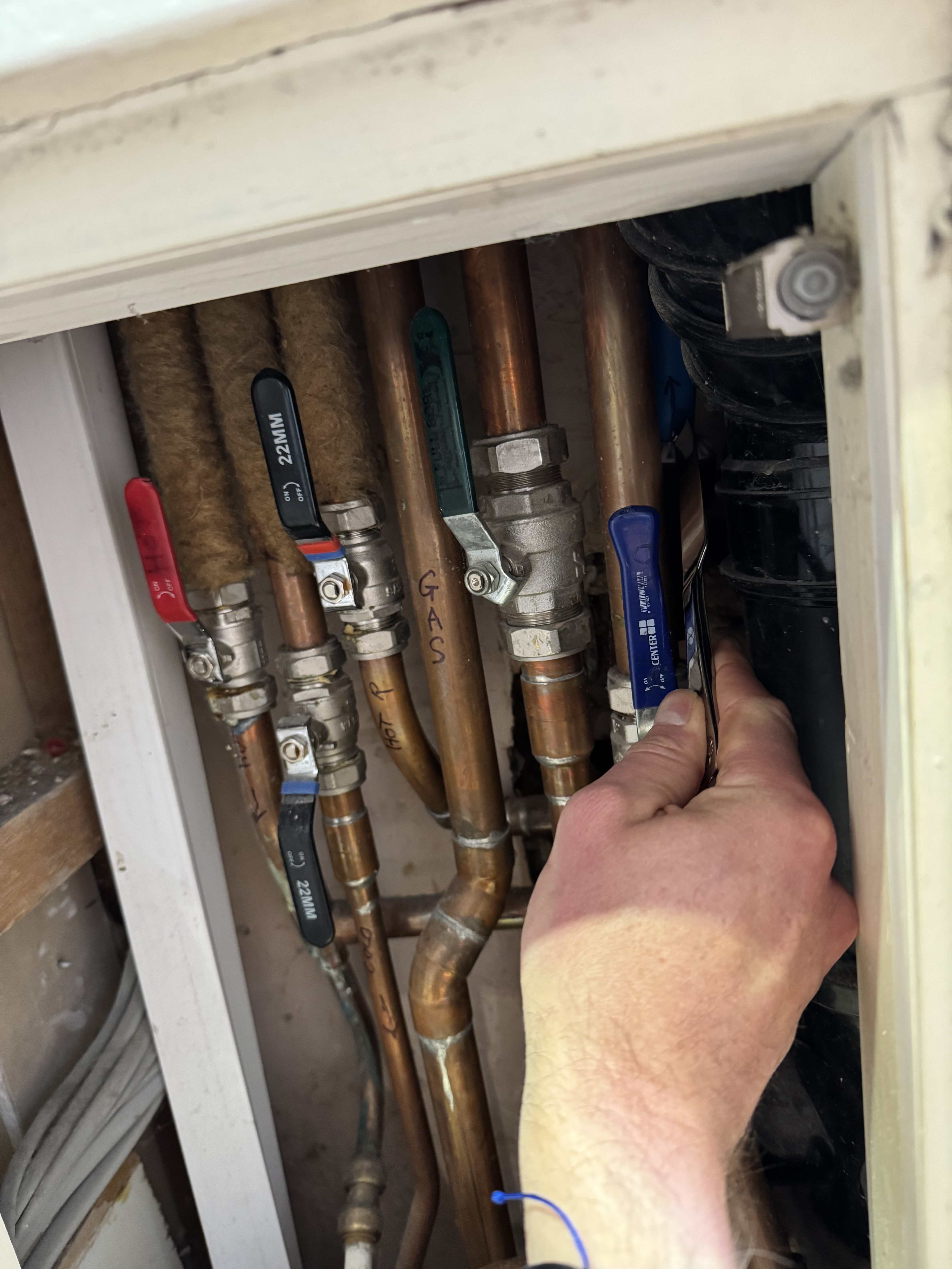

Ok, first job is to get a pressure gauge on the end of the blue pipe bringing cold mains up to the attic.
Do you have a pic of the other end of that blue pipe, eg at the ground floor stopcock?
Turn that off, disconnect the cold feed in the attic, put a pressure gauge on it and see what the static standing pressure is on the mains. Let’s start there.
https://www.screwfix.com/p/monument-tools-mains-water-pressure-test-gauge-11bar/82412?gclsrc=aw.ds&gad_source=1&gbraid=0AAAAAD8IdPy5YHYzsMfKRwsac1otIxnYQ&gclid=EAIaIQobChMIwO6Vm87ZiwMVv5FQBh2ahwdrEAQYAyABEgK5bvD_BwE
I think the blue pipe is that one which I’m pointing at behind all the copper pipes.
im hesitant to start disconnecting things as I really am not very technical.
Thanks.
Yes, if you zoom in you can see the 15mm copper pipe with MAINS written on it, so I assume that converts to blue pipe (MDPE) and goes to the attic uninterrupted.

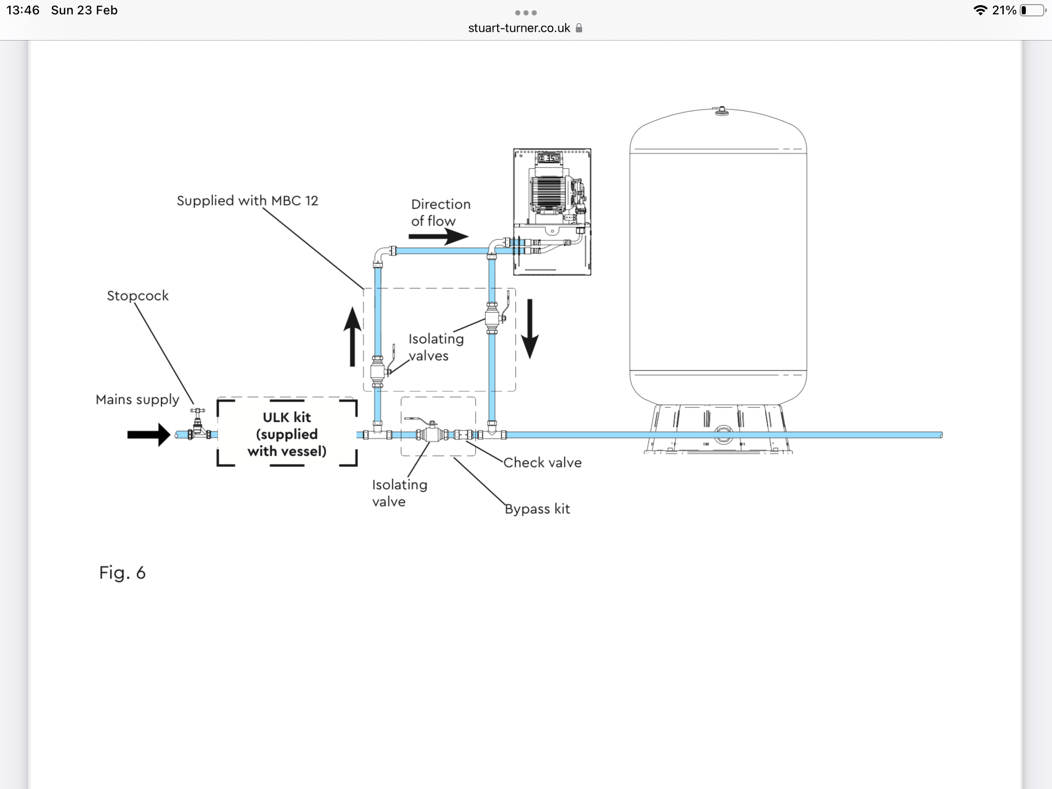

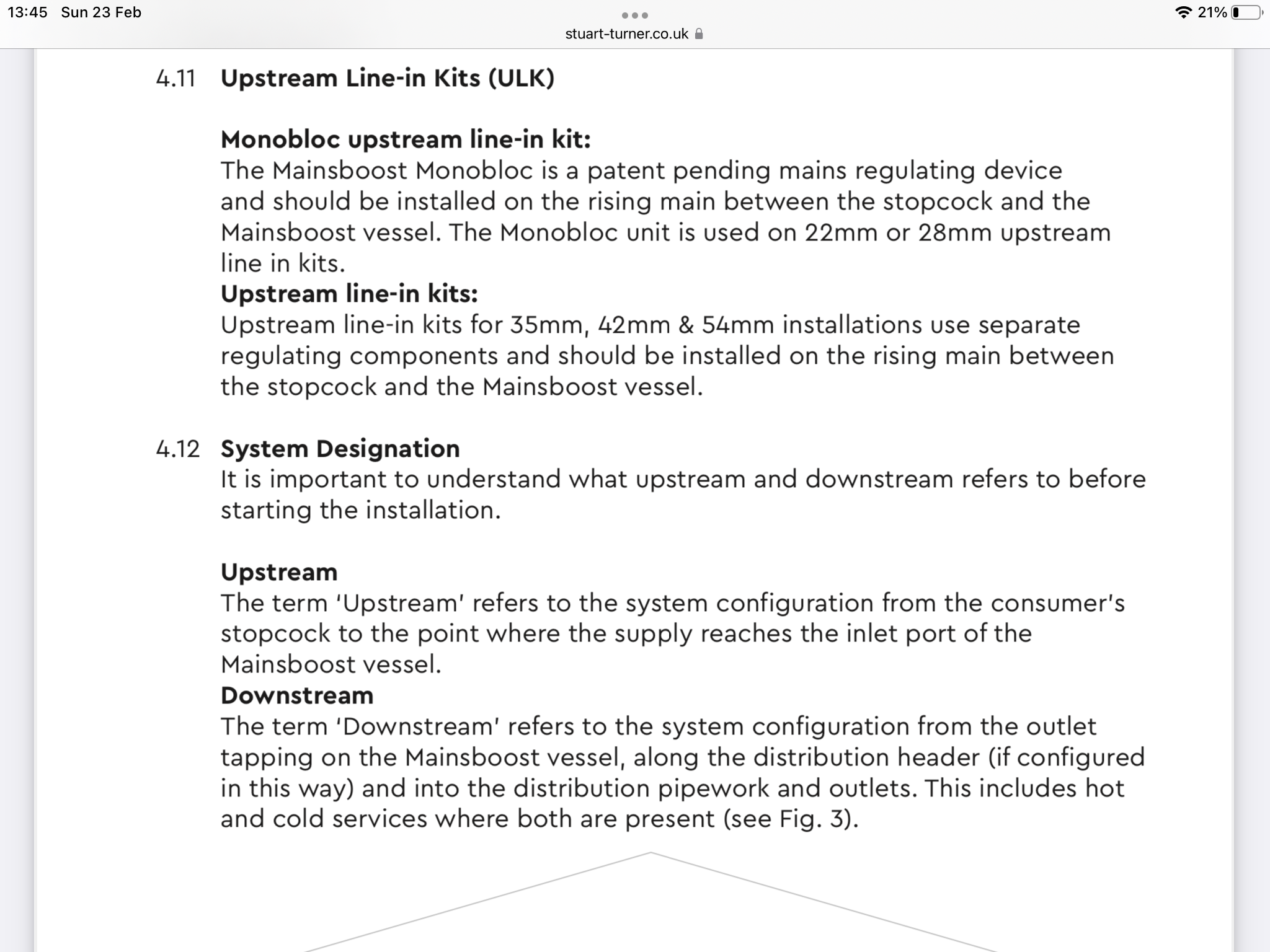

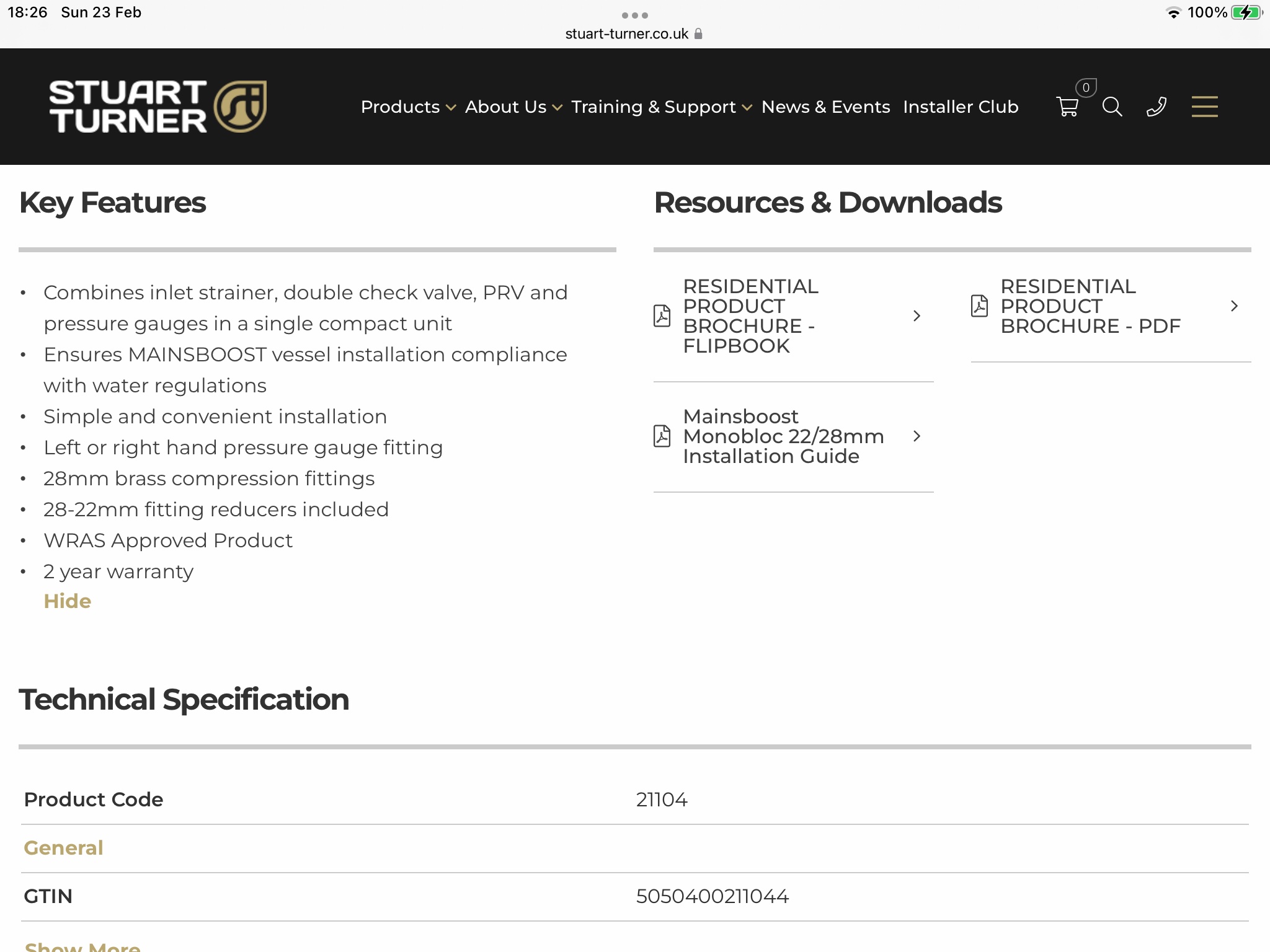

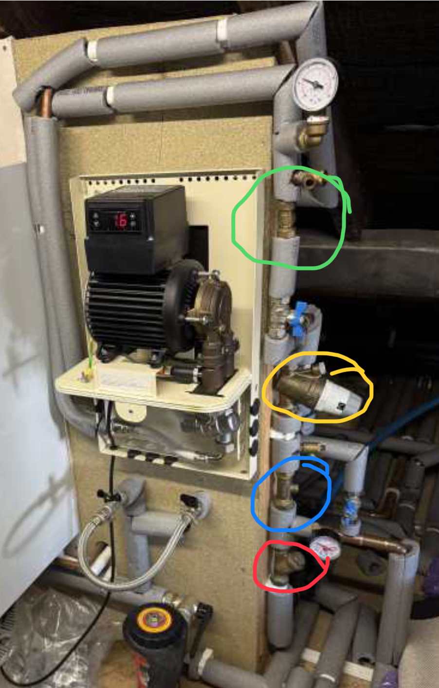

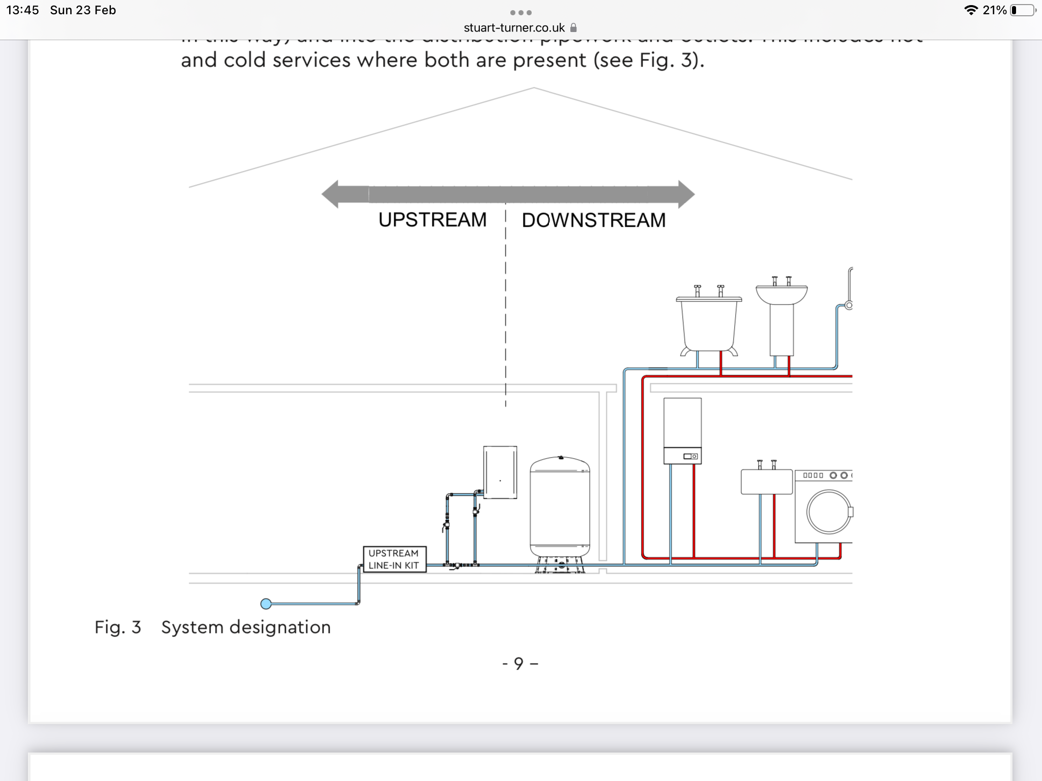

Can you confirm if this upstream ‘line in kit’ is present / installed?
How do I find this please? Cheers

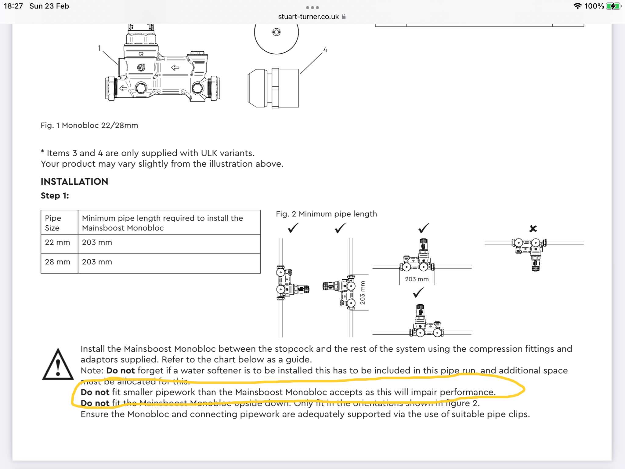

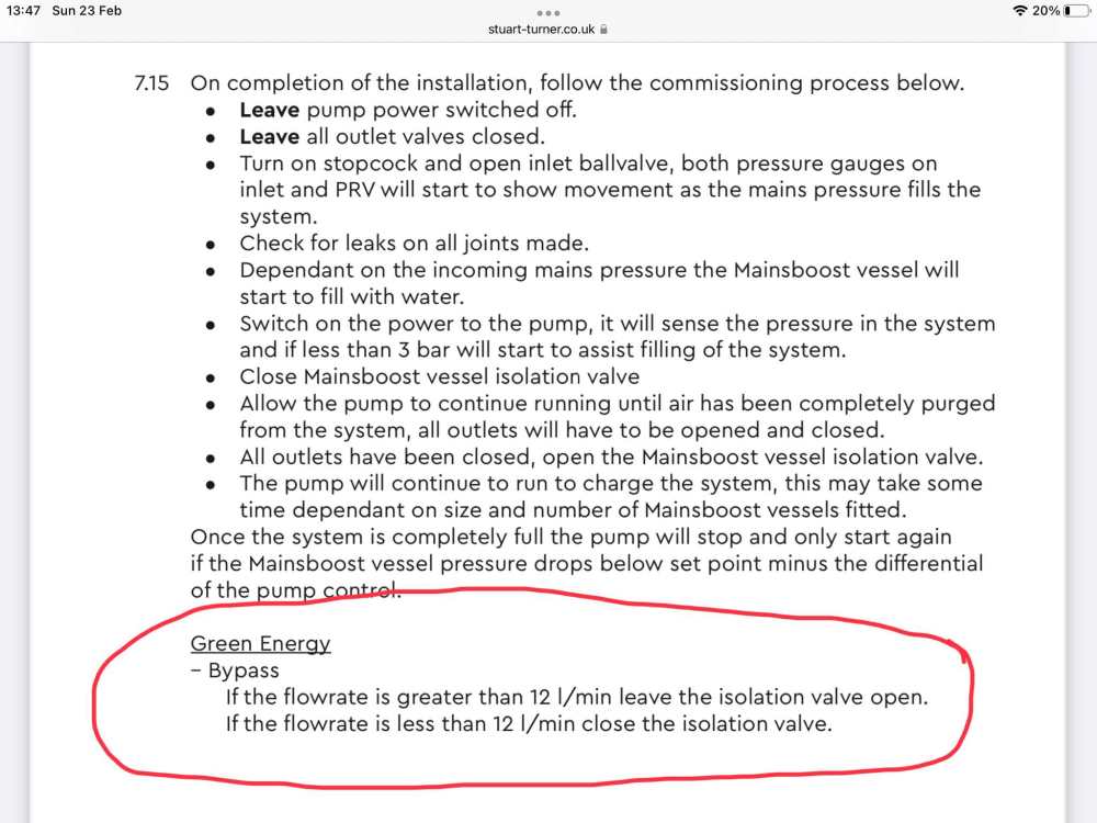

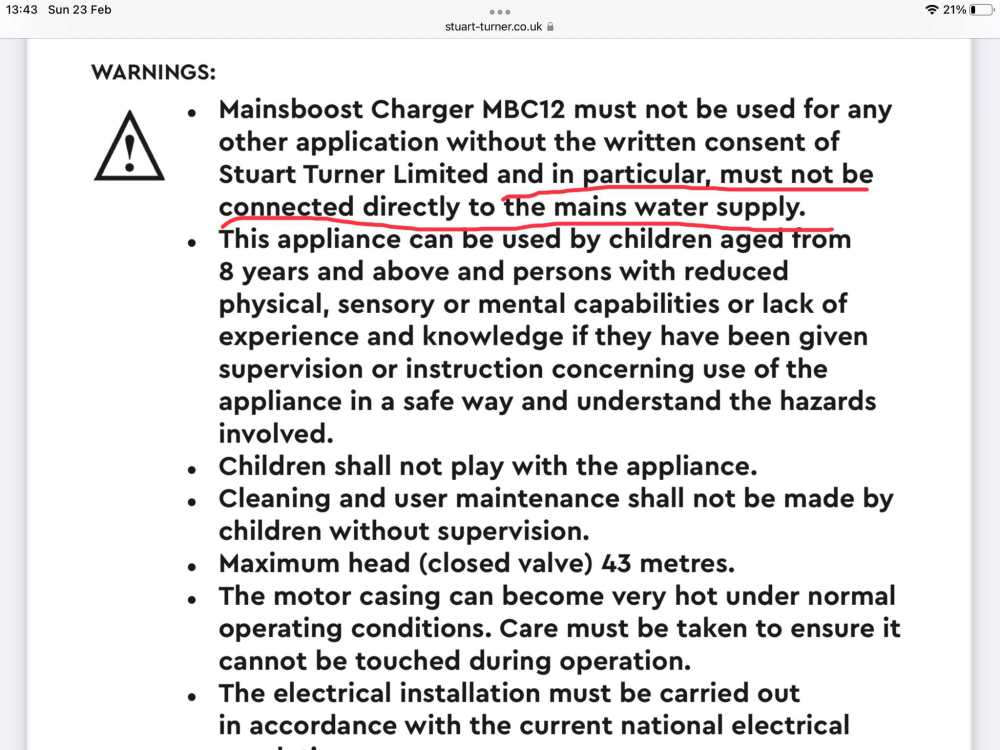

I don’t see any pressure reducing valves in the installation guide, so I’m now curious as to why you have them and why they’re set so low.
I see what I think are non return valves (green defo, but not sure about blue), a Y strainer (red), and a PRedV (yellow), so we need to find out what’s supposed to be there, what’s not, and what could be causing issue.
Not the foggiest. Can you find reference to it in any paperwork you have there? I am assuming it has been “recreated” by the plumber in the previous post.
