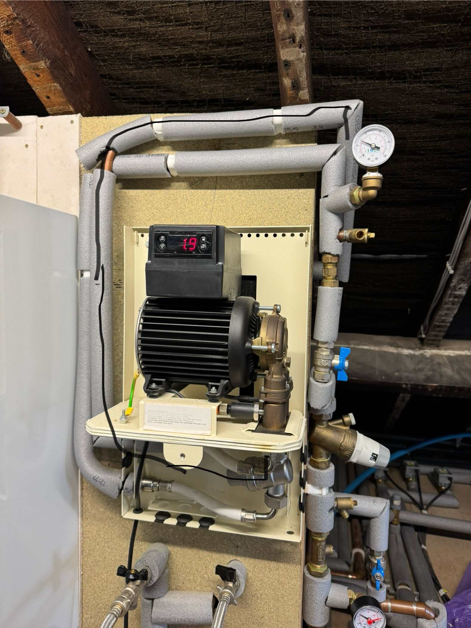

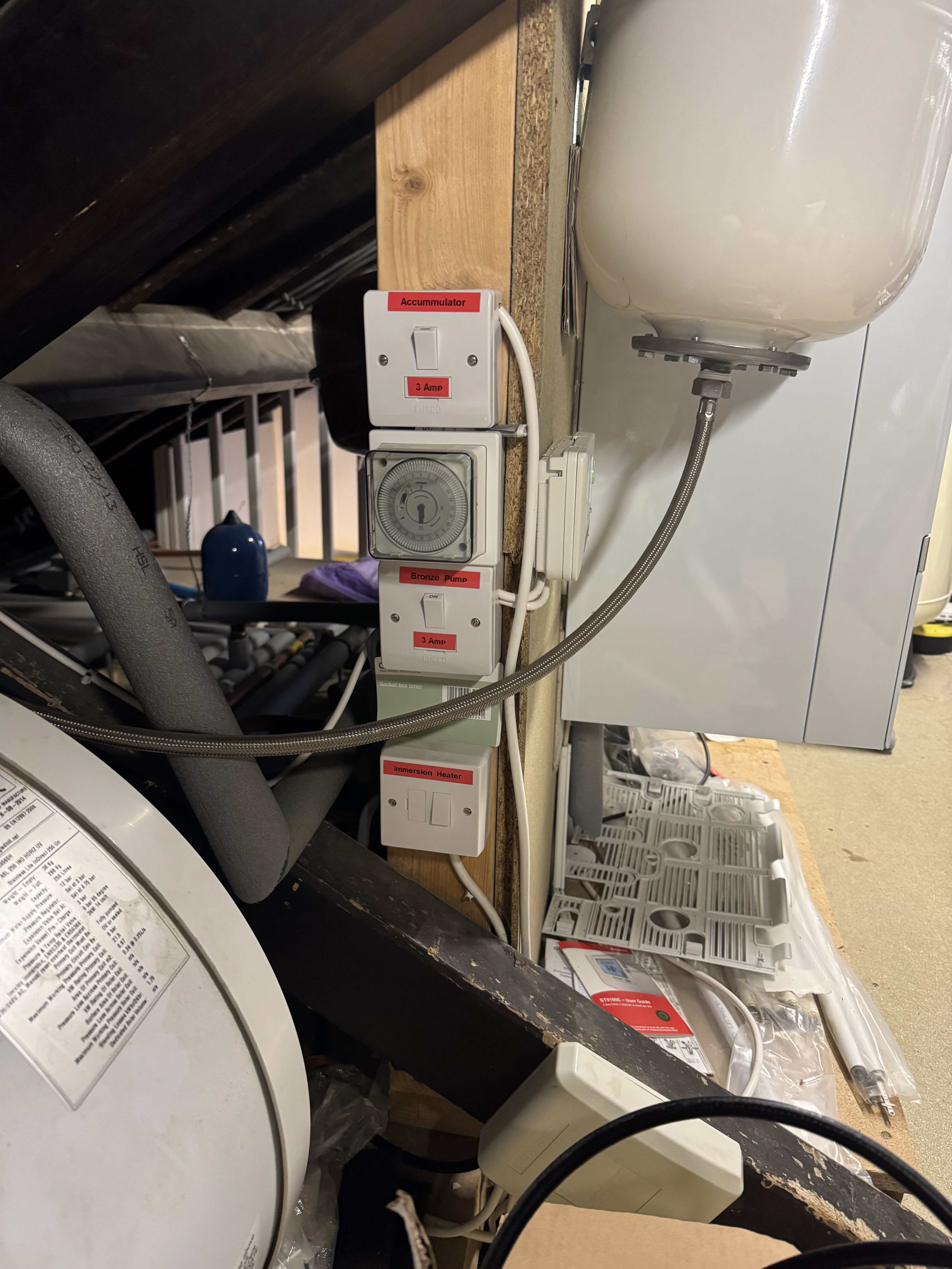

ok thanks will do this today.
cheers
The circumference is 169 cm
The height is 150 cm
I turned off the pump
Opened 2 taps to drain about 15 mins of water and it was lacking pressure.
The 2 analogue dials didnt move. I think they are broken.
I then left taps running and turned pump on at 15.12
I then after 1 minute turned taps off.
at 15.49 ie 37 mins later it reached 2.2 and turned off.

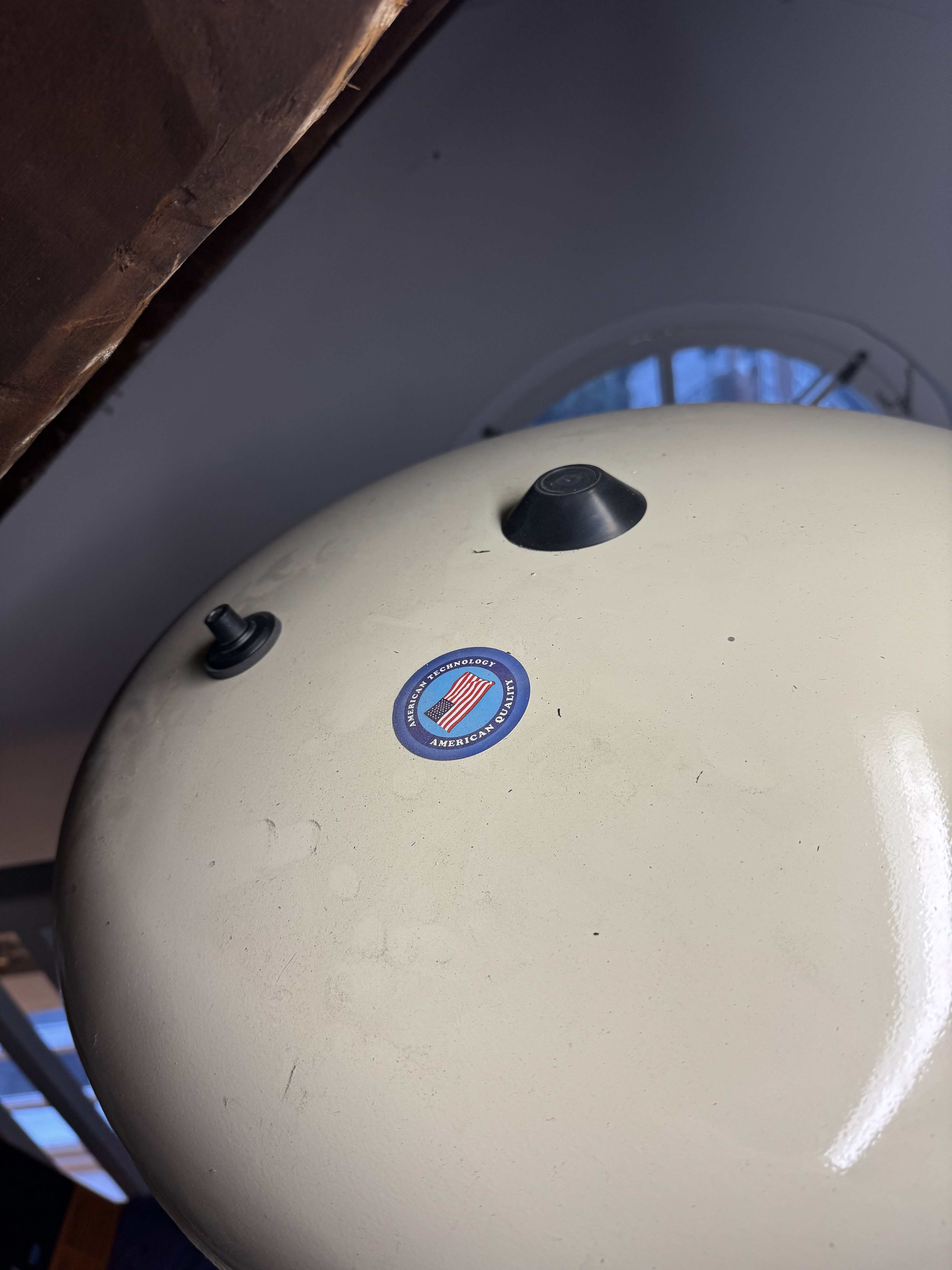

I will attach a video to try to explain what is up there regarding any valve top (which i cant see) and a question regarding where my hot water is stored.
Thanks

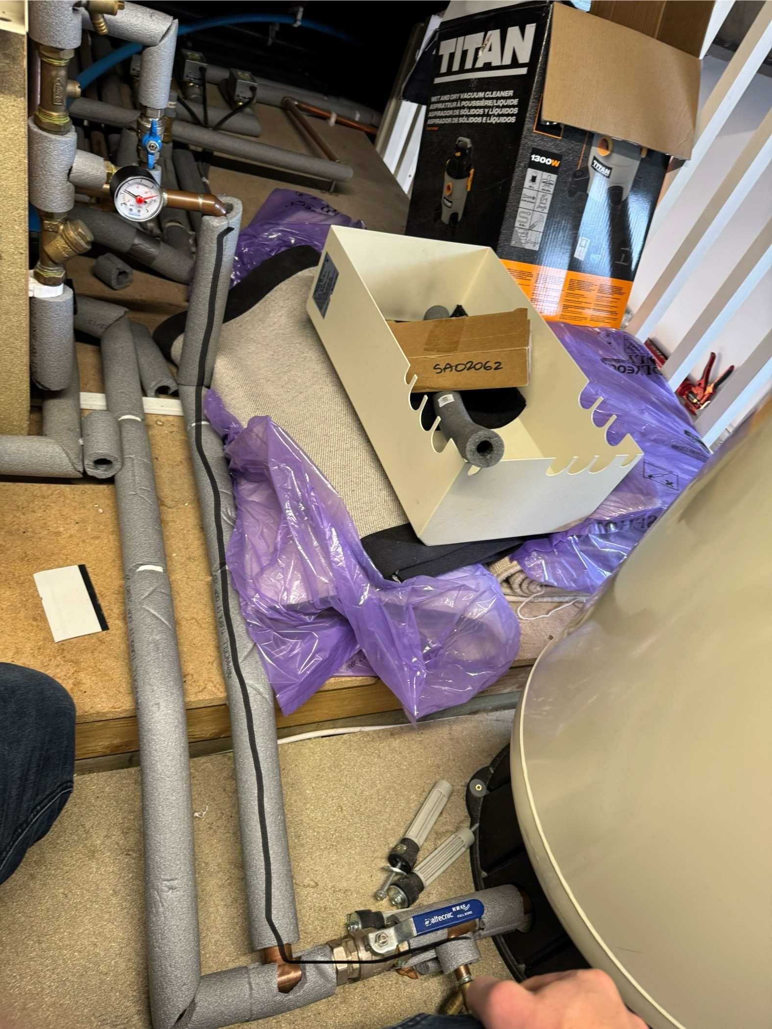

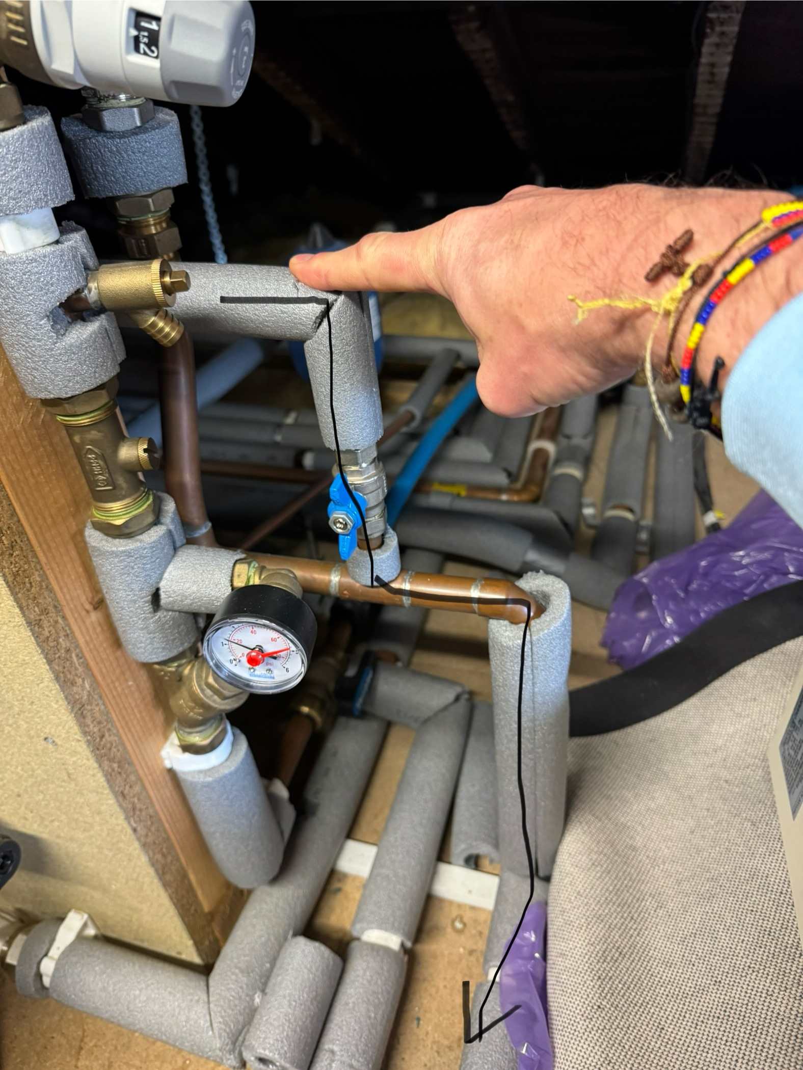

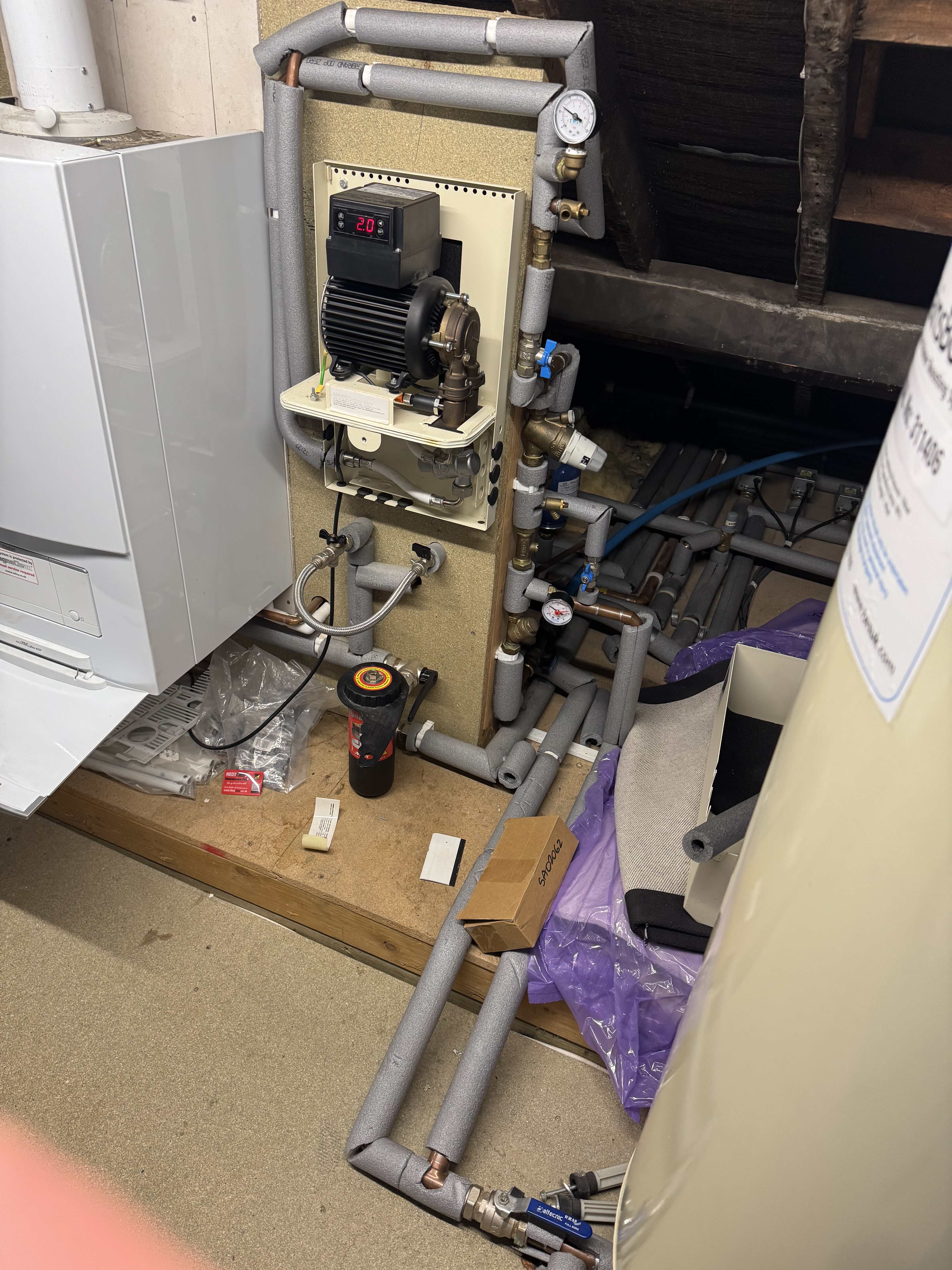

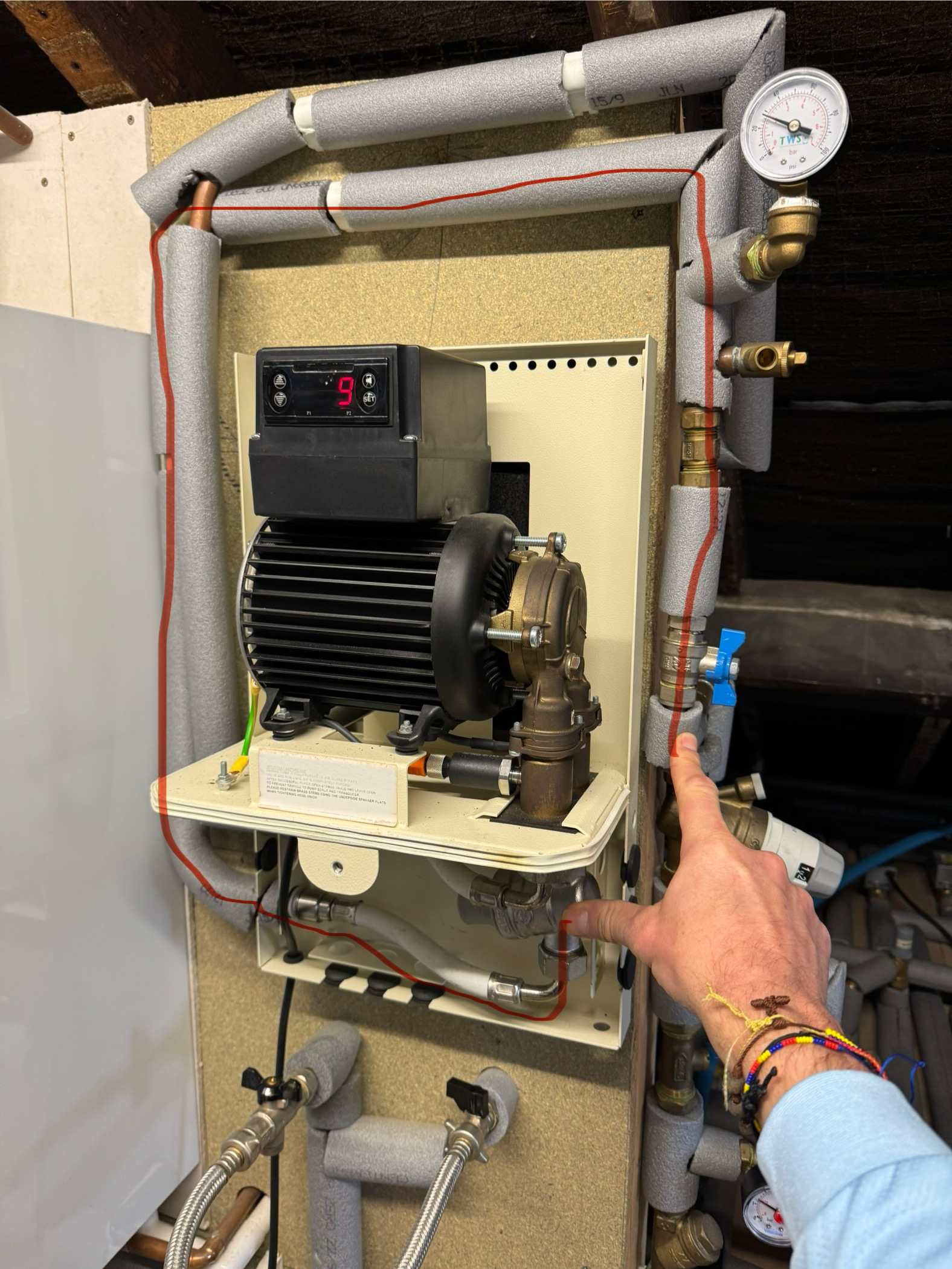

Hi It wouldn’t let me send a video
but I’ve added some pics
I am not sure how to work out where the outlet goes? And I can’t see any valve or guage on top of the tank.

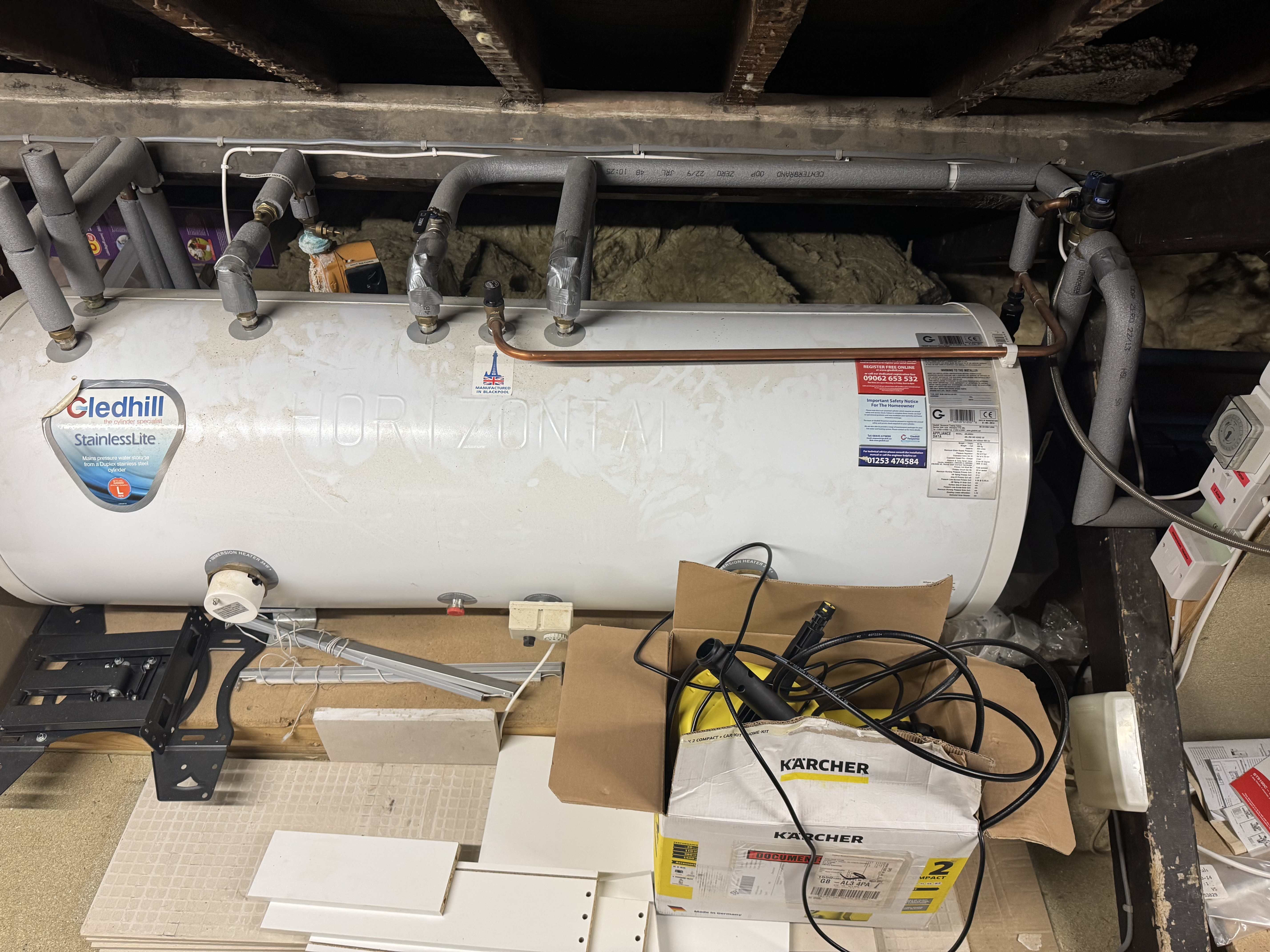

as an aside the horizontal tank I believe is my immersion tank. Is it also where my regular hot water is stored when I don’t use the immersion (which I almost never do)
thanks

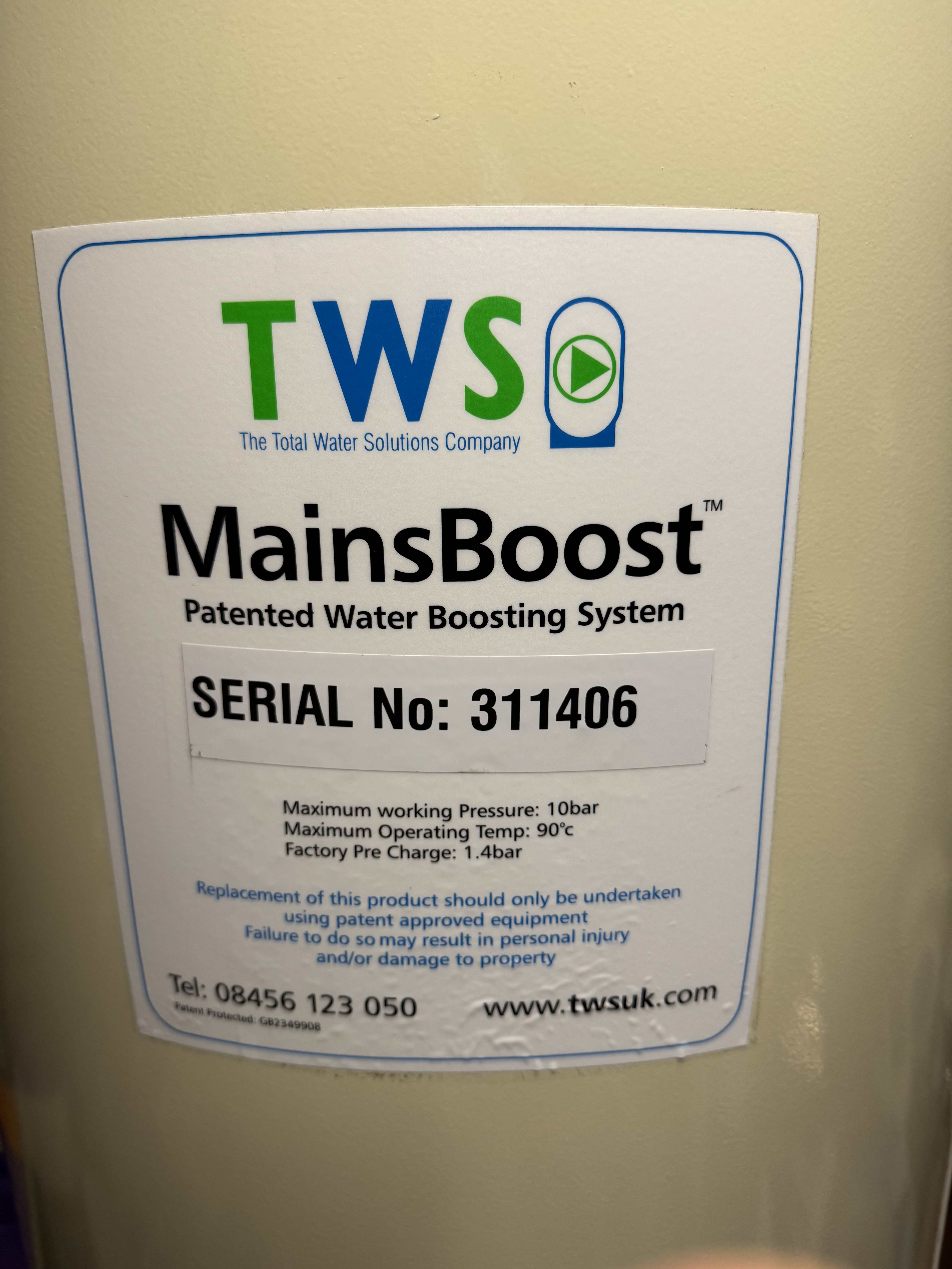

I estimate that you have a 300L accumulator,
A precharge pressure of 1.4 bar and a charged pressure of 2.2bar will give a available accumulator vol of 75L, two taps running for 15 mins to use up this 75L gives a combined flowrate of 5.0LPM, (not a lot).
It took the pump 37 minutes to recharge the accumulator with, theoretically, 75L, gives a pump flow rate of 2.03LPM, no good.
Have you any idea of the flowrate from those two taps before the flow rate fell off.
Its very difficult to tell whats happening without a accurate schematic of the pipework.
You will see a round plastic dust cap right on the very top of the accumulator, unscrew or prise this off and you should see a  (schrader) valve exactly like your car tyre valve, you require a tyre type pressure gauge to check this pressure with the accumulator fully drained. Before considering doing this, or getting it done, with the pump running and no water demand, press down the (schrader) valve pin with your finger nail, if air comes out, diaphragm OK, if water comes out for more than a few seconds then diaphragm knackered.

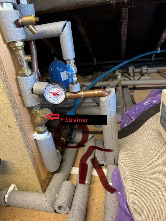

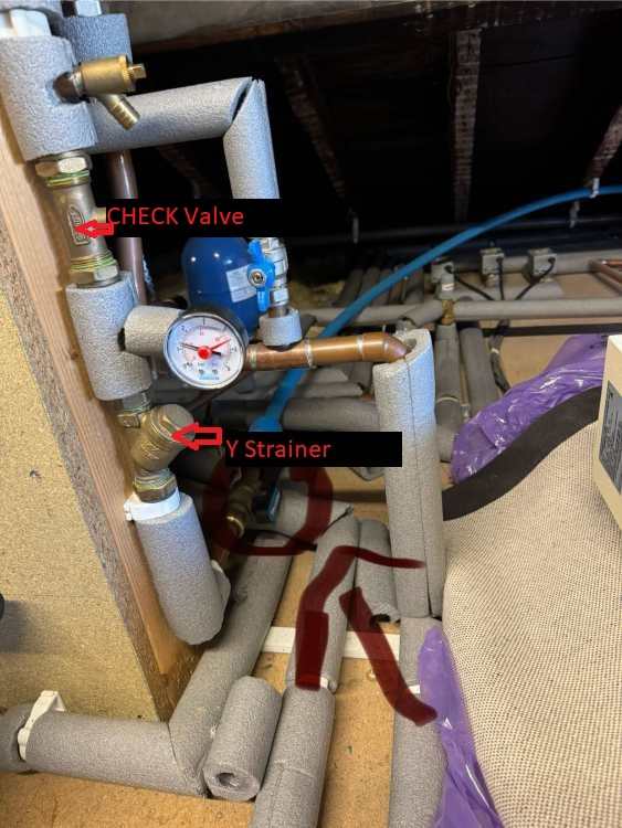

Suggest cleaning the Y strainer and removing the two pressure gauges, (ensure they then read  zero pressure) ensure tapping points clear then replace them.
With pump off run a "high" flow hot tap only,  like a bath tap, if installed, run the hot tap into a bucket/container for exactly 30 secs, measure with a 1 litre milk bottle or whatever, X by 2 to give the flow rate in LPM, note the two pressure gauge readings before and during test. Then start pump with tap still open, throttle the tap flow until the pump pressure is close to 2.0bar, then again note repeat the flow measurements,  again note the two pressure gauge readings before and during test. That should/might  give enough information on how to proceed.
Try and do this please

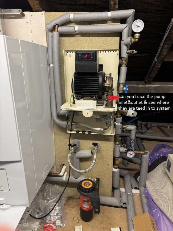

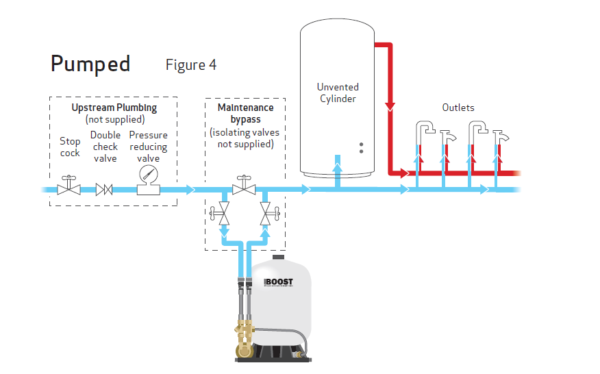

Typical Pumped Installation below
Edited by John Carroll

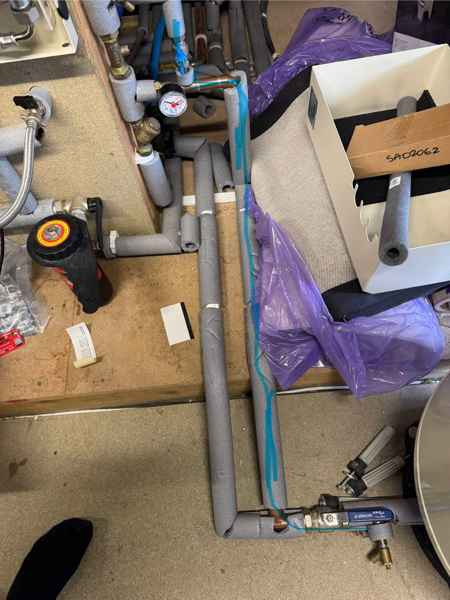

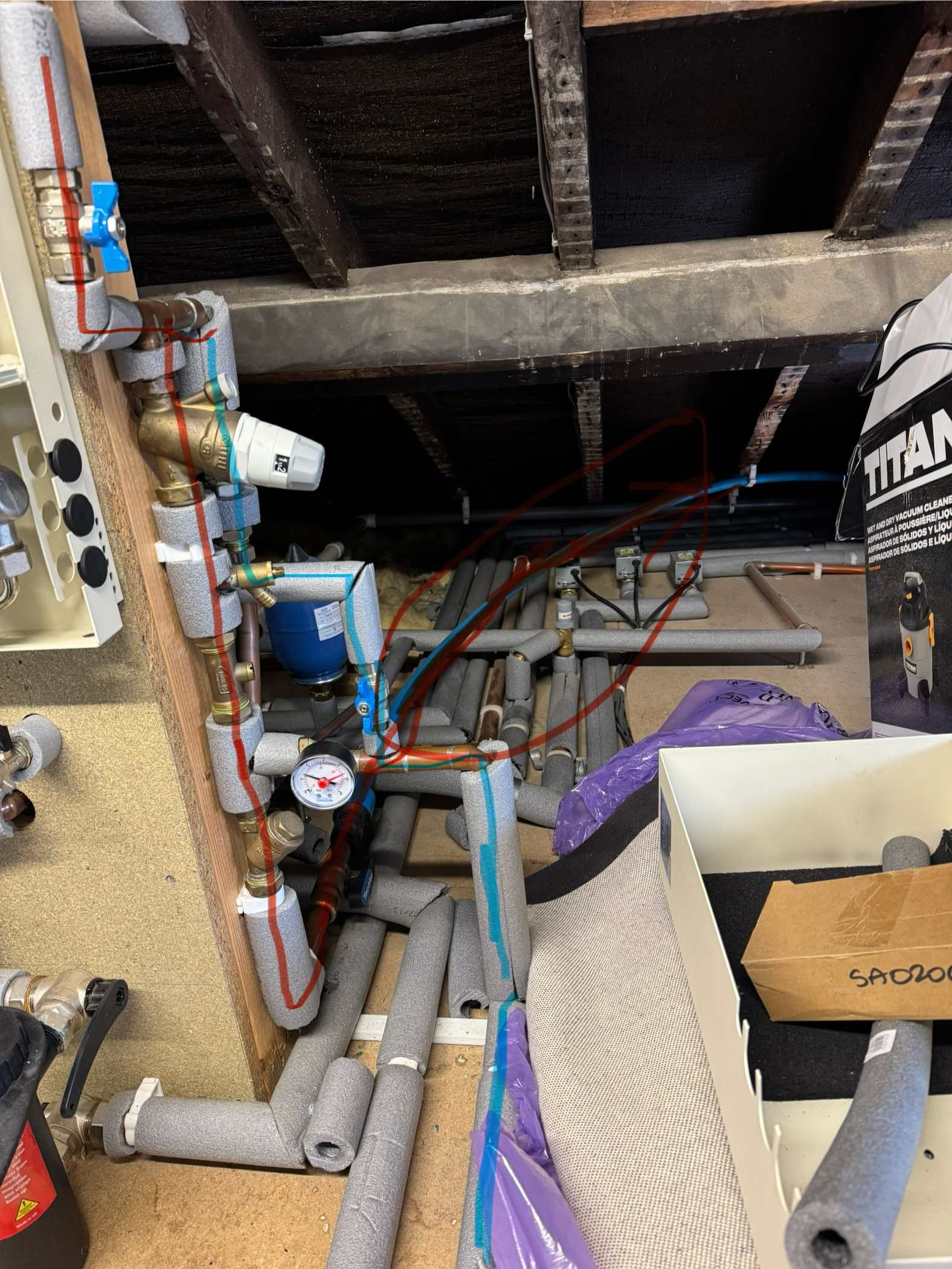

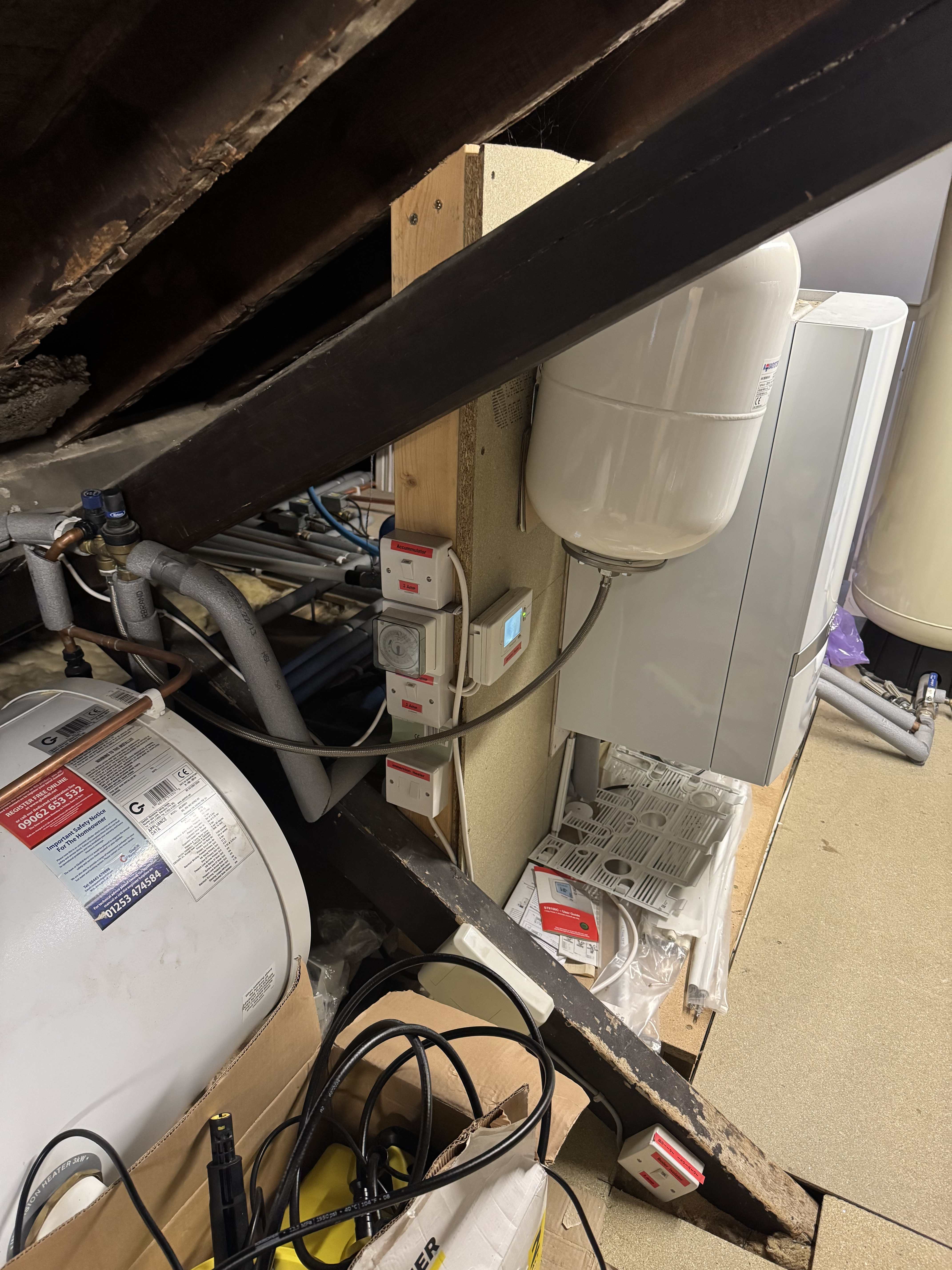

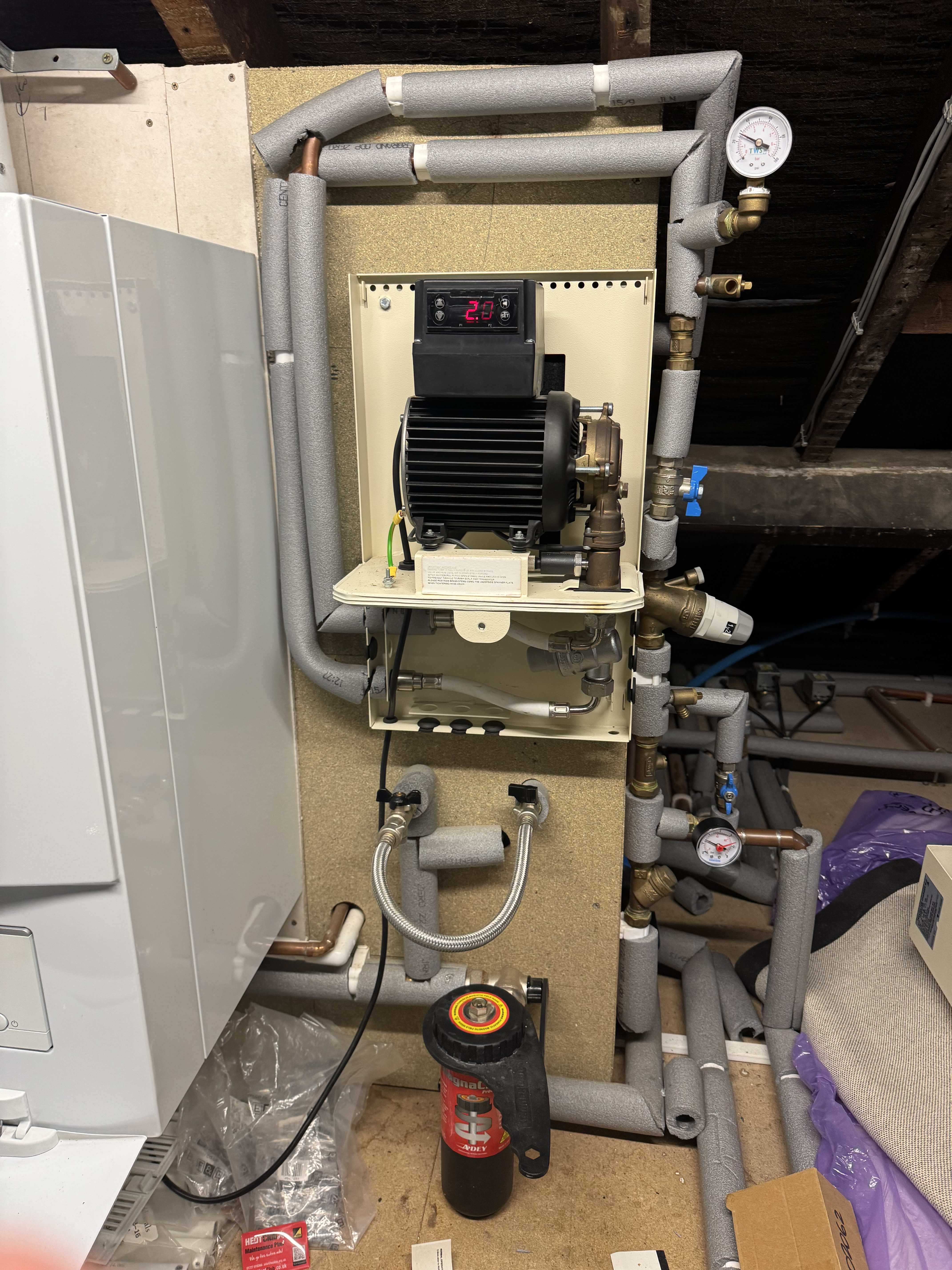

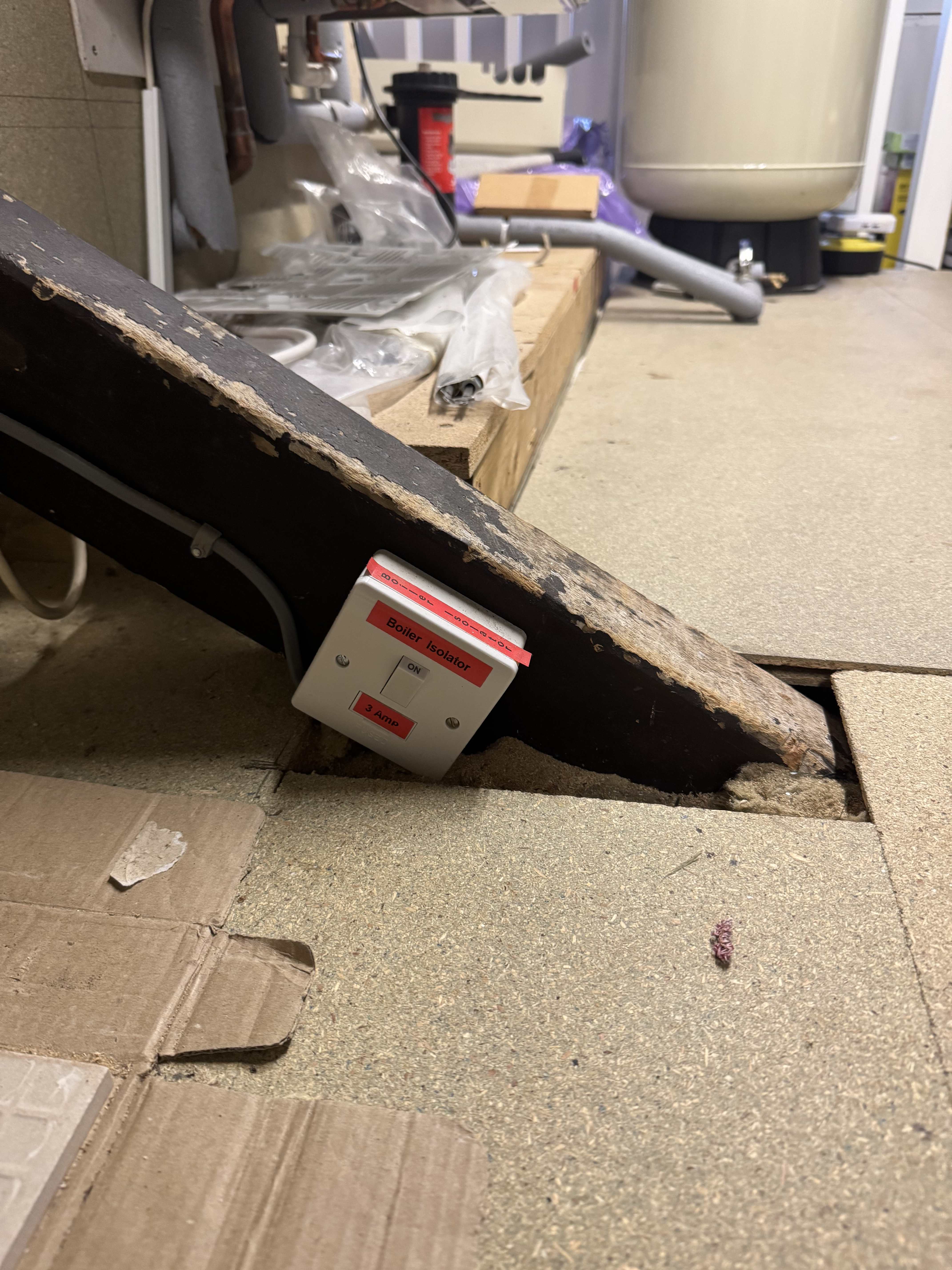

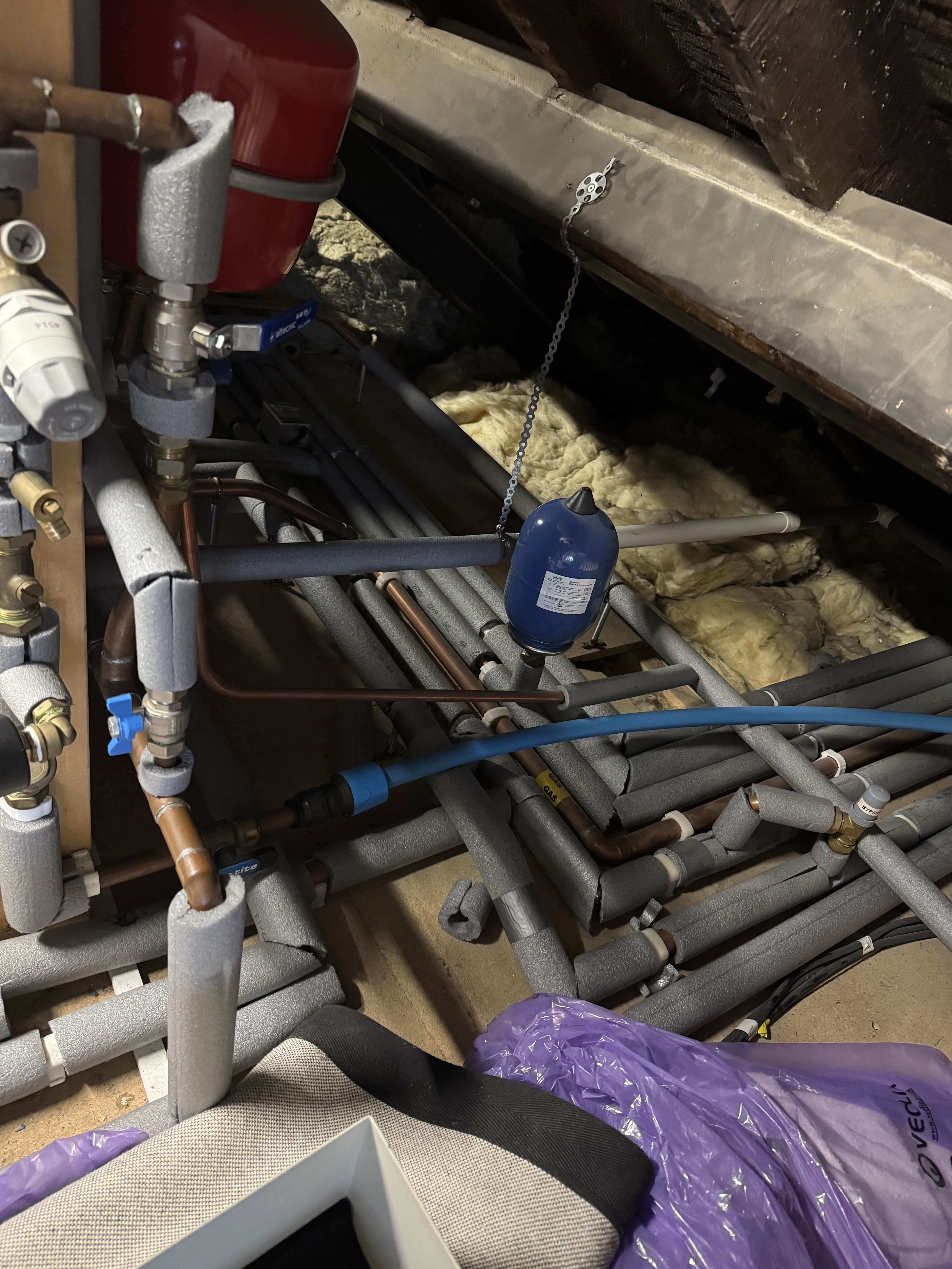

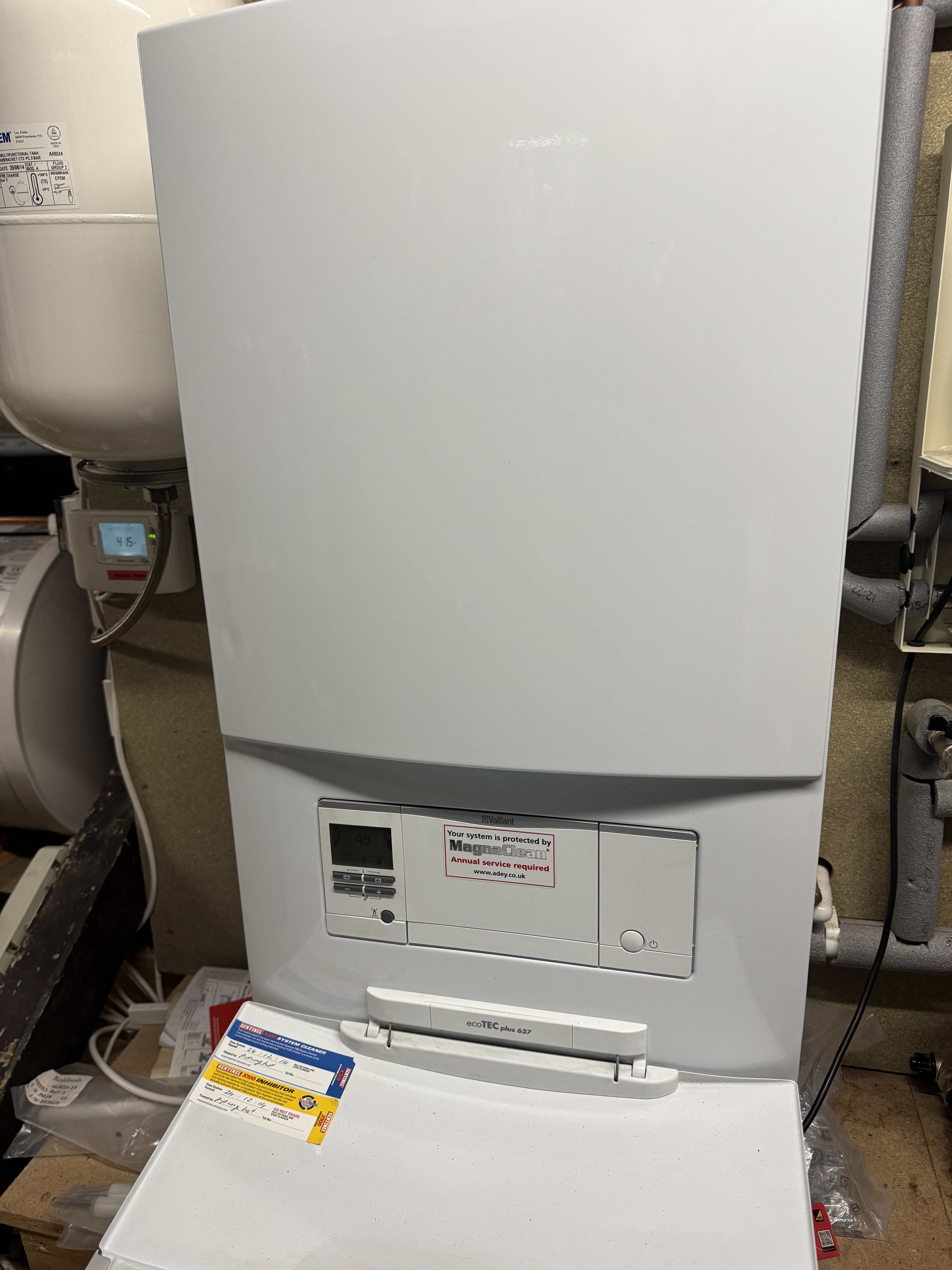

The next 3 pictures show the route of the pipe nearest to me.
The next 3 pics show the line of the pipe furthest from me
I’ve added red and blue lines the blue is when one part seems to fork off into different directions
thanks

I think its vital, before making any decisions, to get as much data as possible, expecially those two pressure gauge readings, more importantly, the lower one to see what the pump suction pressure is, its no good installing a second accumulator if the mains cannot supply the minimum pump suction head required. Would suggest getting you'r plumber to get these gauges "working" and clean the Y strainer.
As stated previously, 1.5bar/2.2bar precharge/charged pressures will give a (300L) accumulator output of 65.63L (present output?), if the charged pressure was at its design of 3.0bar then you will get a increase of over 71% to 112.5L, it might/would require a new charging pump but a charged pressure of 3.5bar will give a increase of over 100% to 133.3L and 4.0bar will give over 128% increase to 150L, as much as adding another 300L accumulator with a charging pressure of (both) of 2.33bar.
