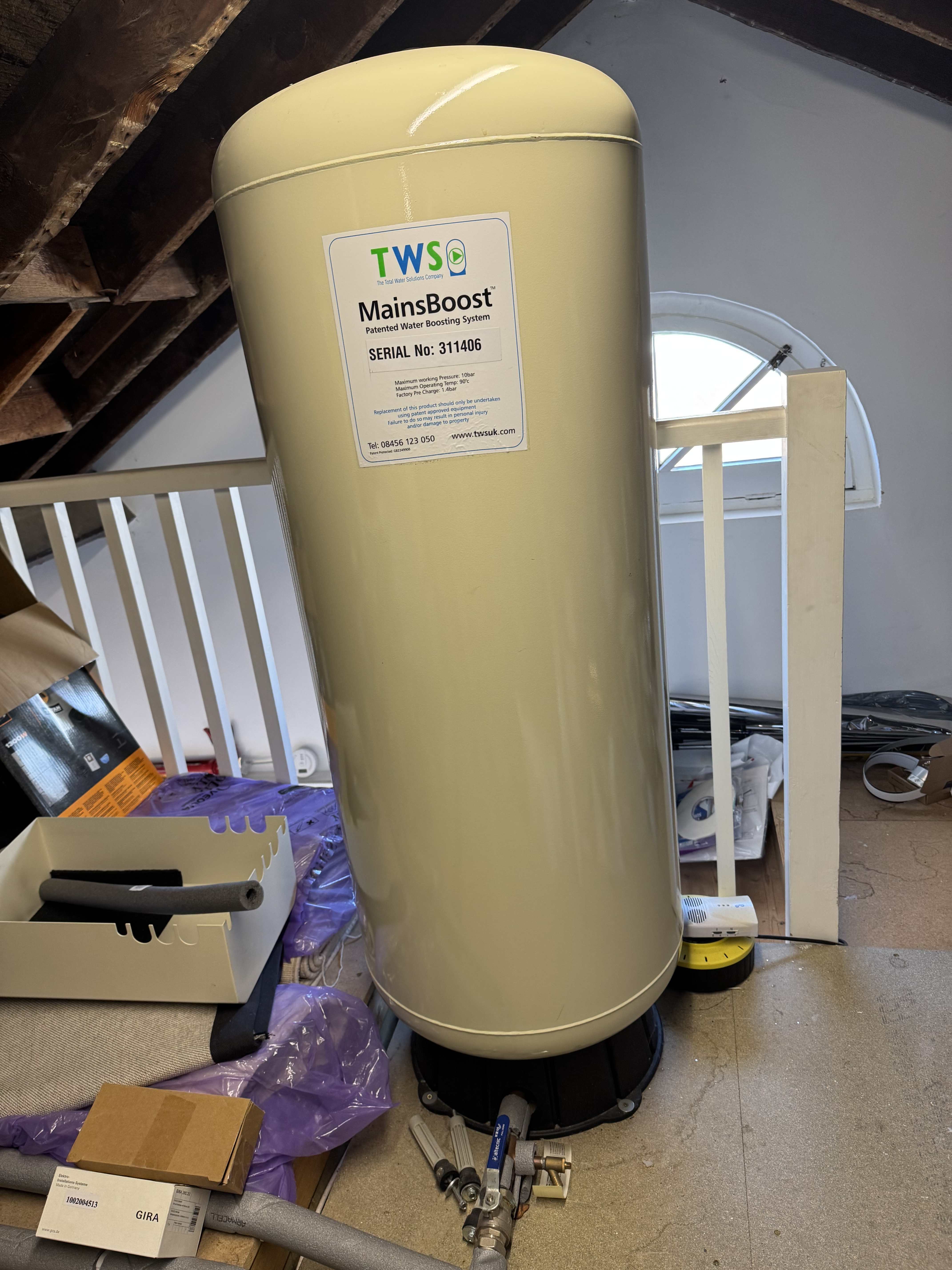

Hi i am not sure if anyone can please help.
I have low pressure coming into the house around 1.1 bar.
We have 3 story terrace. The boiler and the Stuart turner accumulator and mainsboost are in the loft.
When it works it is great. We get really powerful showers. Only one person can shower at the same time though. It will also lose pressure after about 10 mins of a shower.
This is ok in parts. However it has so many alarms go off and i have to go up and restart the MJ2 accumulator. It is frustrating.

Does any one have any tips. My tank is pretty big its a vertical tank about 6ft tall.

    It's just maths, and not an issue with your currently installed equipment.   The amount of water you are consuming, between each event of 'recovery', exceeds the capacity of the system that
  • Nickfromwales
    Nickfromwales
    The quick and simple solution here is to add a second, similarly sized accumulator to boost the stored capacity. After this your issues will be solved.  Put the second vessel the opposite end of the

If you can post a link for the actual product that would be good. Nearest I can find on the web in a quick search is this so I will assume it is something like that. See also this guide.
If so it has a pump which boosts the incoming supply and stores the resulting water under high pressure in an accumulator partly filled with air. When it reaches the set point of 3 bar it will stop. The 0.5 bar will be the amount the pressure has to drop before the pump cuts back in, this is to stop it going on and off all the time. The max run time is a limit to how long the pump will run to try and refill the vessel up to the set point. I am surprised it ever takes as long as 3 hours, that is a flow rate of only 1 litre/min so it must be really struggling for water.
I am assuming it works on cold water only so I am guessing the high temp limit is a measurement of the motor winding temp to prevent it burning out, I am not surprised this is triggered if it is struggling.

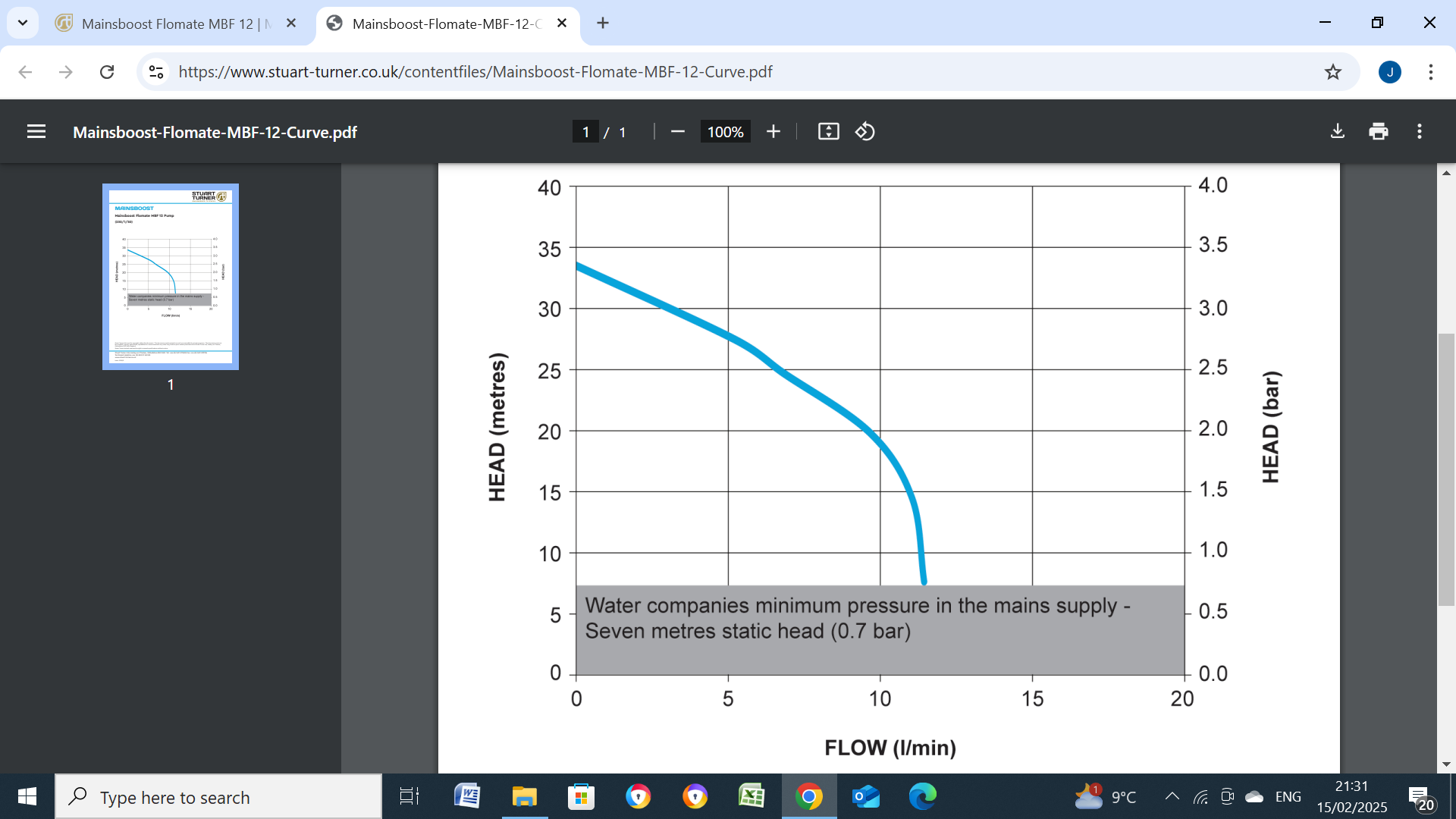

The stored volume of water is only 174 litres so that is the max you can get out at the boosted pressure, which should be enough for maybe three 5 min showers, after that you will only get the flow rate that the pump can manage from the mains alone which is very feeble. You could try increasing the set point as much as you can before you get to the 4.5 bar h.p. warning level to give you the maximum storage volume.
The 0.2 bar is a warning level, presumably the pump needs at least this on the suction side to function correctly, so you do not have this all the time.
However if the pump is up in the attic with the rest of the plant and the incoming mains pressure is only 1.1 bar (is that static or with any flow and if so how much?) then it can only lift the water to a height of 11 metres. If the mains pressure is not sufficient at a reasonable flow rate to get the water high enough for the pump to be able to function properly without cavitation the pump will struggle to pressurise it any further, I think this is likely to be what is happening. Check what suction head the pump is designed to achieve.
In which case the solution is to re-install the pump (or a different pump) at ground floor level so it is flooded on the suction side and will perform better.
DAB pump sets are I think well regarded, comparable with or better than Stuart Turner IMO, but the one in yr link works differently. It has a tank storing 500 litres at the incoming mains pressure and then a pump to provide the supply to the house. If you want 3 showers at once you need (a) enough stored volume (b) sufficiently large diameter pipework to minimise pressure drop and (c) enough pressure, 3 bars should be adequate as that is what unvented cylinders usually work at. This DAB pumpset will provide 80 litres/min at 3 bar so enough for 4 rain showers at once.
But it relies on the mains pressure to fill the tank to begin with and so could not be installed in the attic if the underlying problem is that the mains pressure will not lift the water that high, and it will not solve the problem.

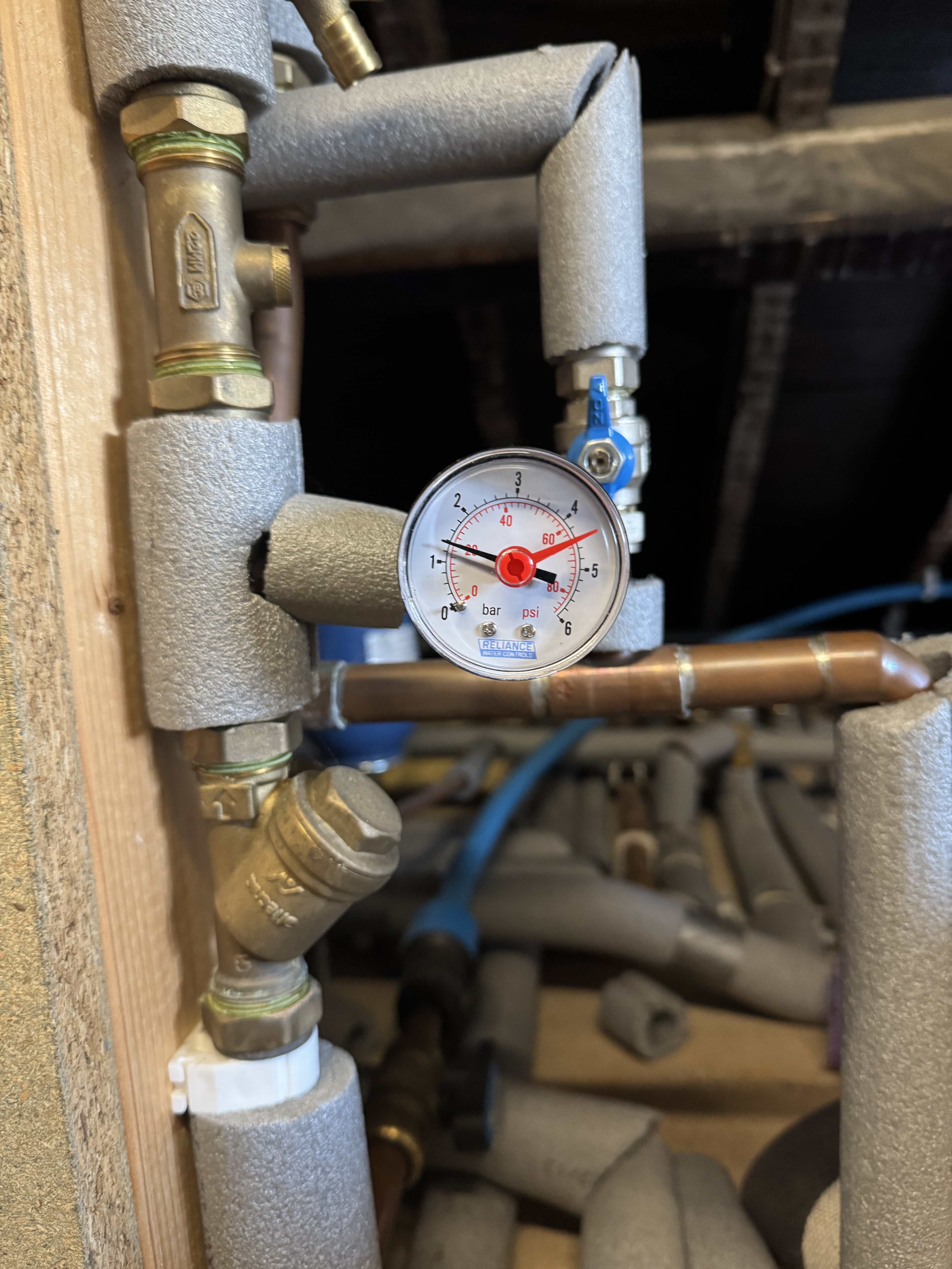

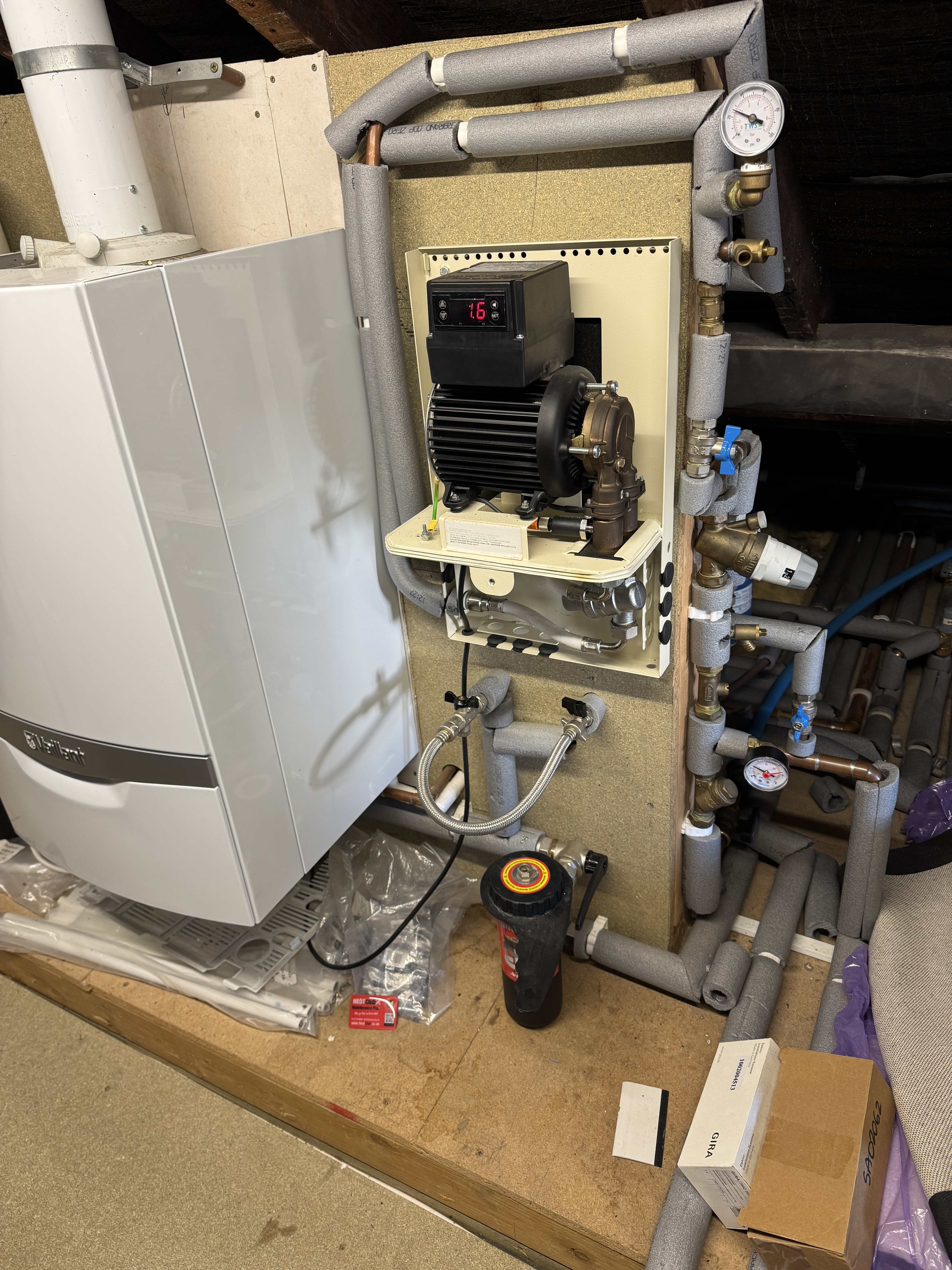

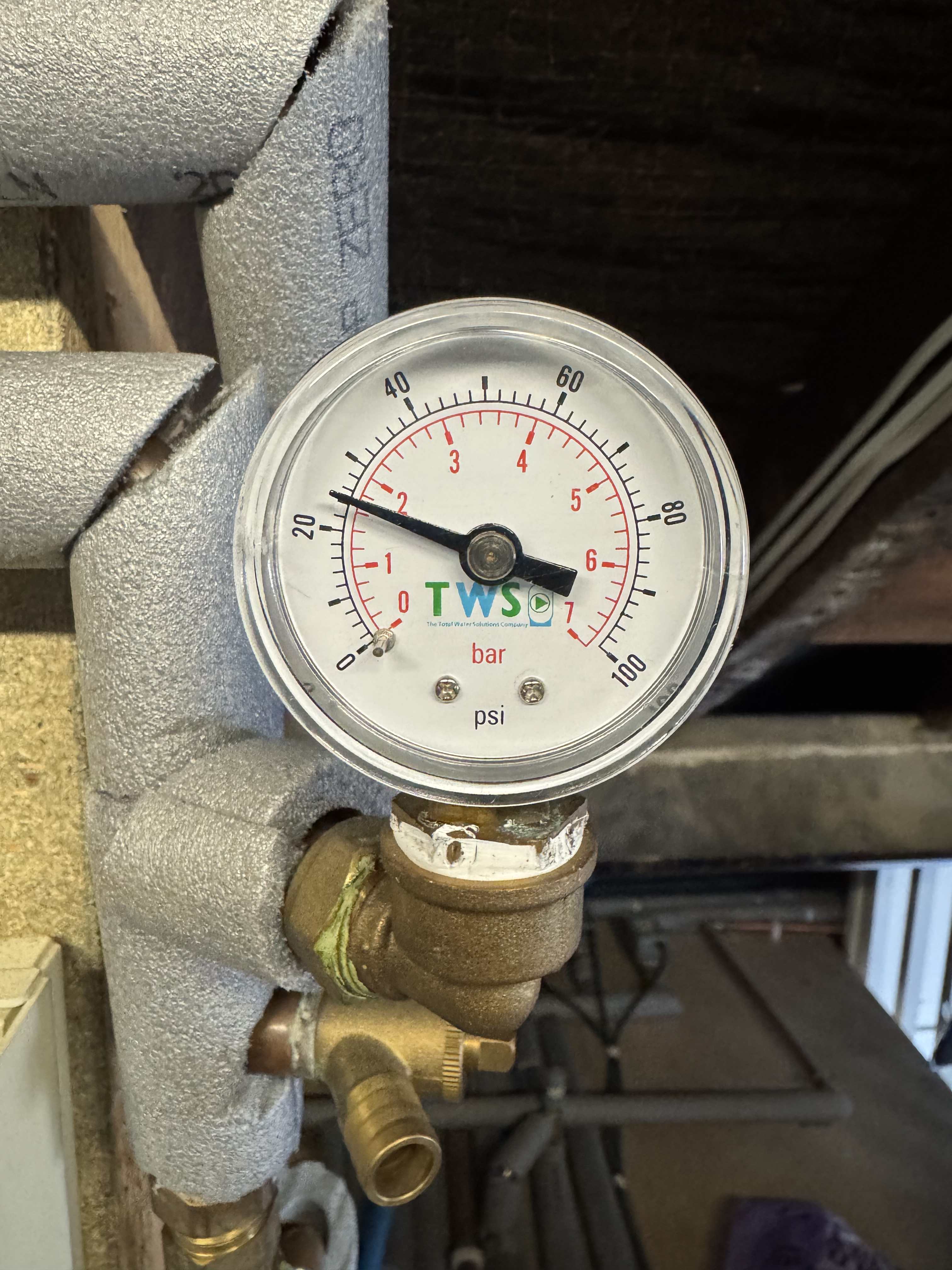

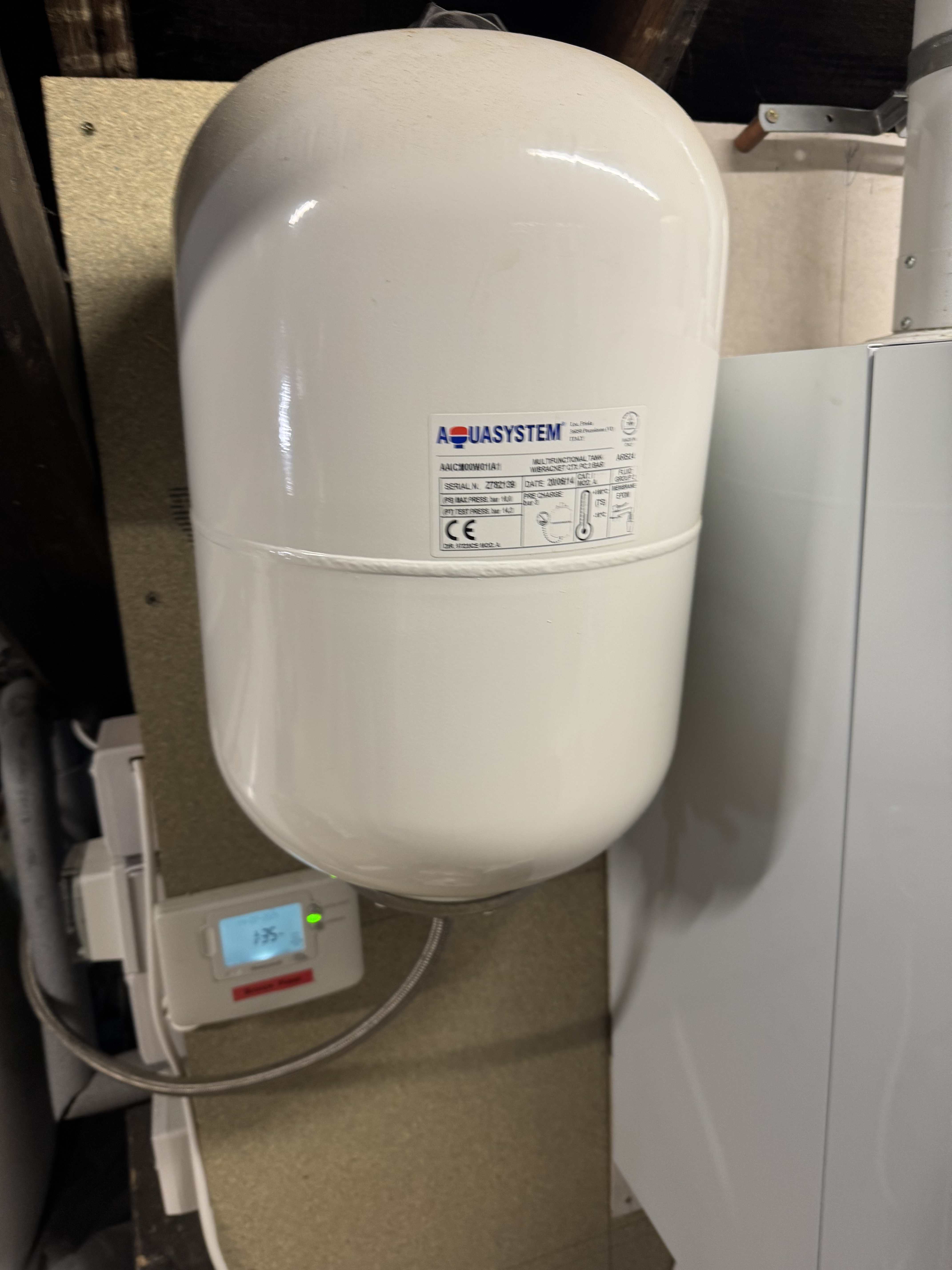

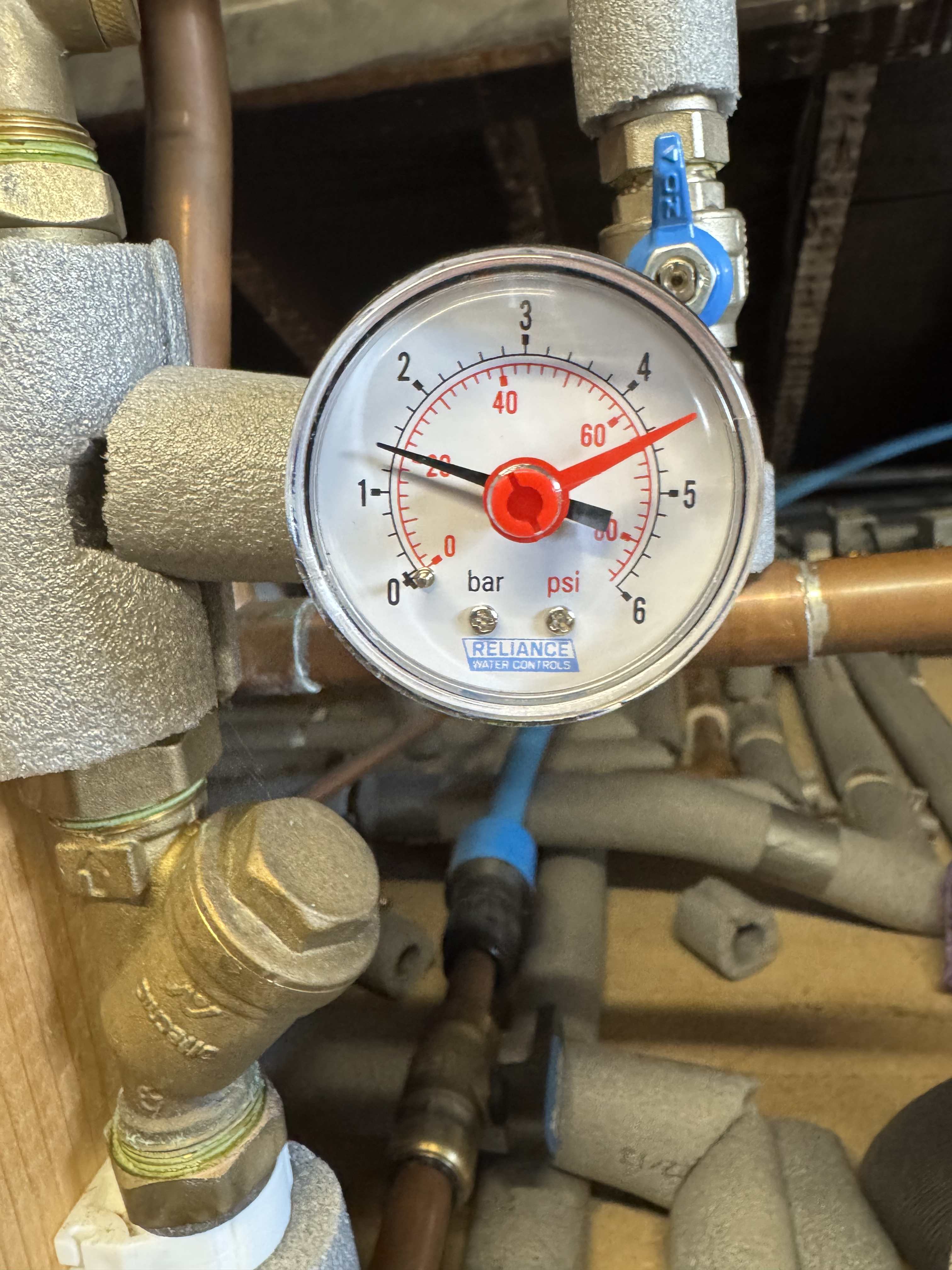

I've attached the pics above. The manual dial is the pressure of the water coming in. I think its showing 1.4 at the moment but it can fluctuate. I have shown a pic of a tank called an aquasystem I have no idea if this is linked to the situation but have added it anyhow.
I play about with the numbers and as thing stand i have not had an error for a while using the following ( i forget what they were on before i wish i had noted them down)

You say 174 litres. I am not sure if this is correct. How do i check this? You say set the set point high i am concerned this may lead to it trying to achieve this and over heating?
You ask me regarding the pressure and if its static or flow reading. The readings vary but at the moment static ( as in no water flowing) is 1.4 when ive just ran the tap the 1.4 stays the same. I am not sure if this is what you are asking me though. Regarding the 1.1 (it was on the day i posted initially but today it is 1.4) that is the reading i have in the attic. I am not sure how to test it downstairs?

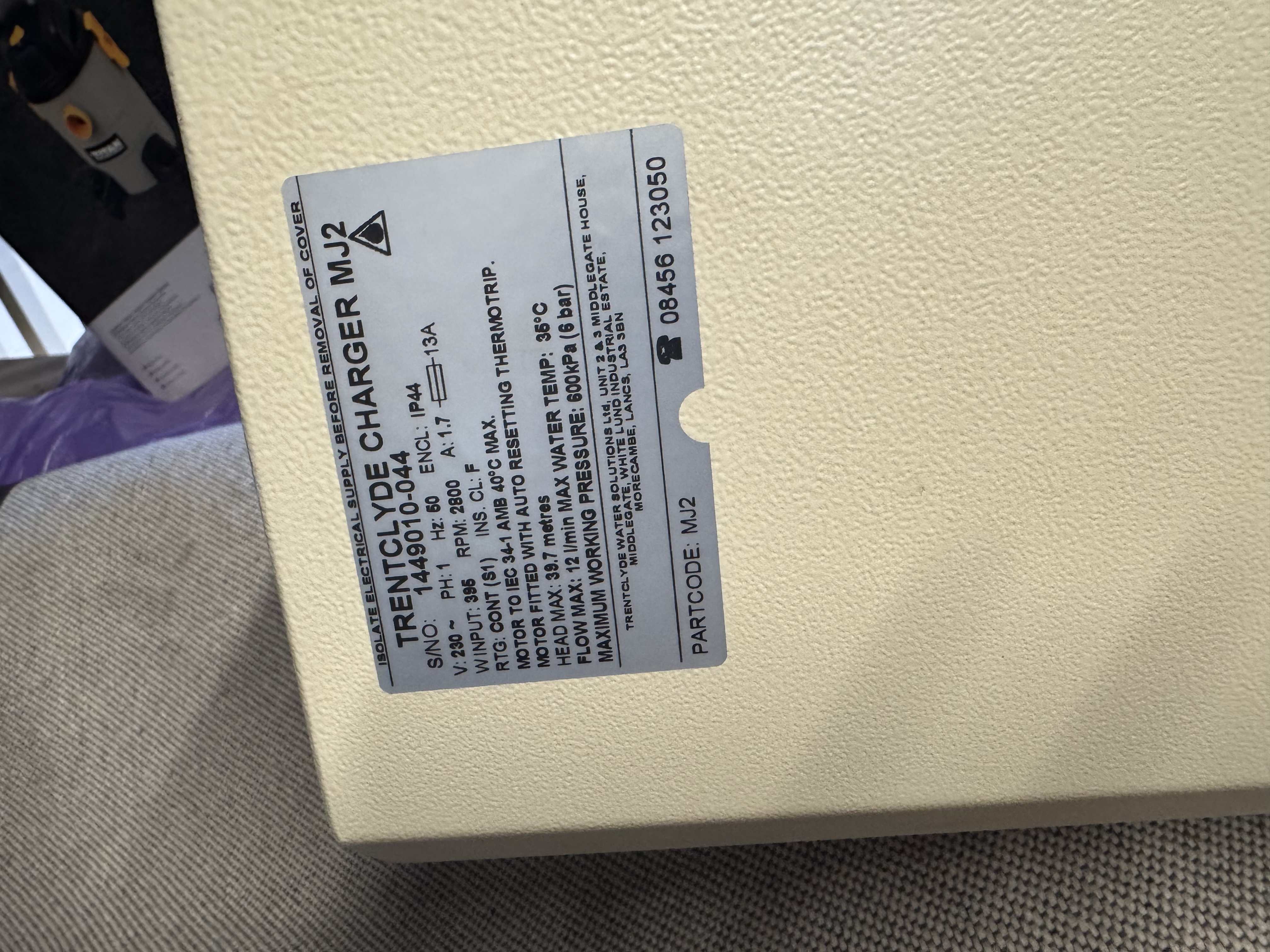

"Check what suction head the pump is designed to achieve" how do i check this please?

A few basics about any accumulator.
Its important that the precharge pressure (air end pressure with no pressure at the water end) is set to just slightly less than the minimum required pressure, if, for example, the minimum required pressure is  1.5bar, then the precharge pressure should be set to 1.3bar, if the pump SP pressure is set to its design? pressure of 3.0bar then the available water vol per 100L of accumulator capacity is 34.5L, if the precharge pressure, for whatever reason is set to only 0.5bar then the available water vol in falling from 3.0bar to 1.5bar is only 22.5L, important to bear this in mind. You have the pump SP at 2.2bar , assuming the precharge pressure is 1.3bar then the available water vol in falling from 2.2bar to 1.5bar is 28L (per 100L of accmulator vol), I would definitely suggest checking that precharge pressure and set it slightly below your required minimum pressure and reducing the diff to 0.8 bar, as you suggested, Can you also post the pump inlet and outlet pressures with a big demand.

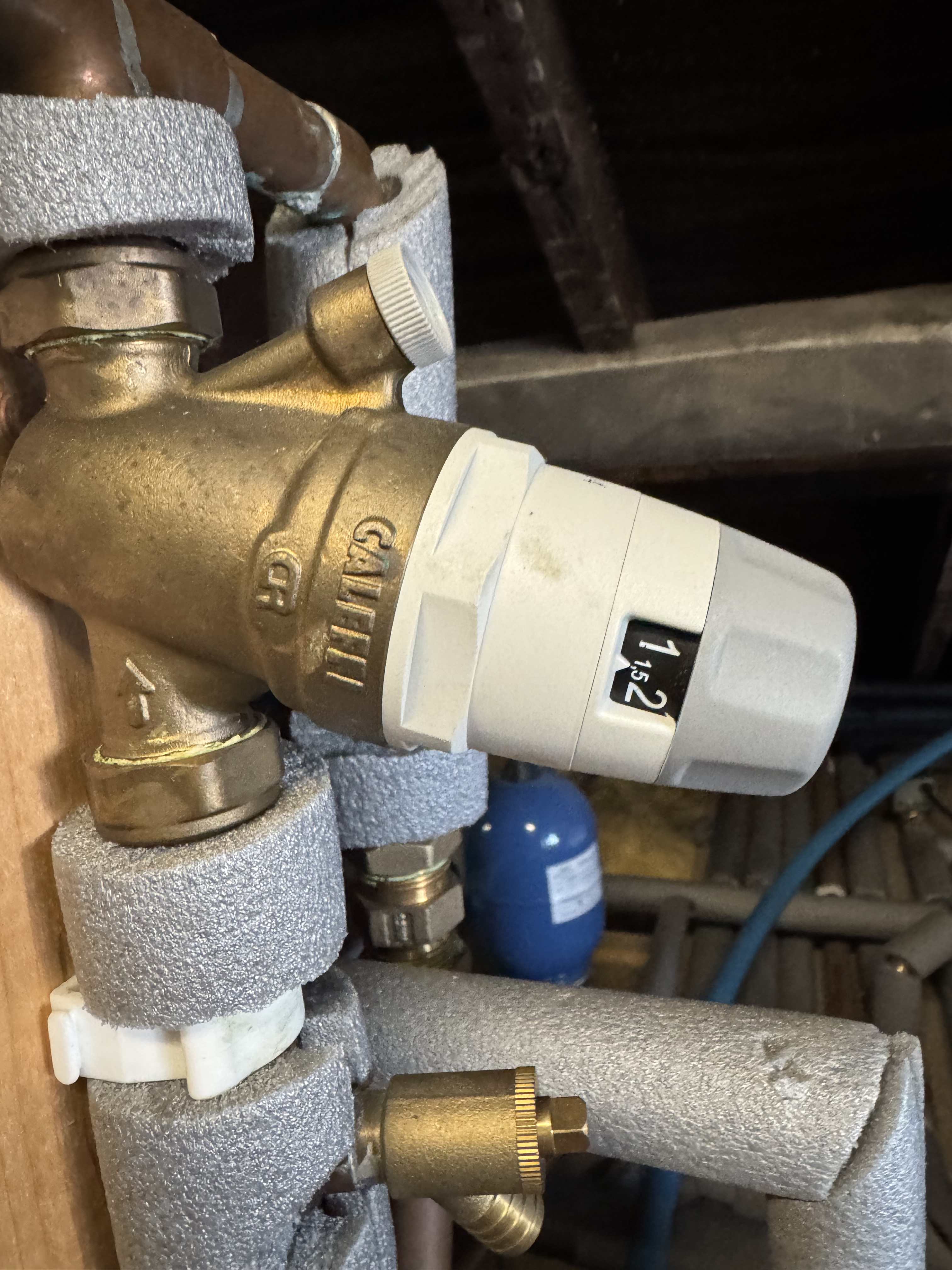

Also the the indexed setting in the window of that ABV?, automatic bypass valve, located between the two pressure gauges.
This is probably very similar to your pump, your pump has a higher closed valve head of 3.98bar. It should really have no problem in reaching a cut out SP of 3.0bar when the demand finishes, as long as the inlet pressure is > than 0.7bar. How long is it running for before it cuts out at 2.2bar?
You might also measure the accumulator circumference with a tape, can then get a good idea of its capacity at 6ft? high.

As suggested upthread, measure the diameter and height and calculate the apparent volume of yr cylinder, though I am surprised there is not a capacity label/rating plate somewhere on it.
If you mean overheating of the pump motor, I don't think it would make much difference and it says it has a thermal cutout anyway.
If you are getting 1.1 or 1.4 bar pressure at the level the pump is installed at i.e. in the loft then some of my earlier remarks do not apply. Though it doesn't explain why it takes such a long time to refill/re-pressurise. I think the main problem is simply the setup is too small for your usage pattern as @Nickfromwales states.

I would get that pump looked at for a start.
If that was operating as designed then it should have no problem in achieving 3.0bar could  give a 71% increase in the accumulator output, refilling time for a 175L accumulator should still only be 11 ninutes or so.

"Can you also post the pump inlet and outlet pressures with a big demand.
Also the the indexed setting in the window of that ABV?, automatic bypass valve, located between the two pressure gauges."
I think you want me to run a lot of water as in a lot of taps to be open at the same time? If so i will do this. But before i do what measures do you want me to show. Is it these 3 things? ive attached 3 pics in the follow up to this post. I am not sure if they are accurate as one seems to be stuck on 1.4 whenever i look at it. If it is not these can you let me know. Once i know ill run the taps to capacity and post.

Is it these? NB I’m not running the taps I just want to be sure it’s these you talk about before I run the taps and monitor,

If you have a pump connected directly to the cold mains, and you are consuming water faster than the mains flow rate, then you’ll be “sucking” on the mains supply aka applying a negative pressure.
A lot of plumbers will speak to a sales rep or some guy behind the counter in the merchant and sell the plumber some kit, the plumber will fit it, and no one ever checks if it’s all ok / compliant as they both just want paying.
These systems should be designed after a survey, I say this all the time particularly where an accumulator is the intended solution; this way, when I install expensive equipment and disrupt someone’s lives to do it all, it works afterwards (as intended / promised) and has a great service life.
If you have sub 11 lpm flow at the main the 1st advice should be to petition your water authority to see if you can get the local supply uplifted slightly; sometimes there’s just been another 30-40 new homes built and they’ve done nothing to maintain your existing supply, other instances could be that the tapping into the main in the street is furred up (I always ask the neighbours if I can test at their outside taps too to ensure it’s not an isolated issue).
If you have a system that fills an A>B break tank then you can’t ‘suck’ on the cold mains supply as the system will be hydraulically separated by an air gap in the break tank. These systems should pump would just be sucking that break tank bone dry faster than the incoming mains can refill it.
Put the second vessel the opposite end of the attic to put the additional weight away from where the current one is.
Ideally these should have had some timbers under them run perpendicular to the attic joists, so maybe do that for the second vessel to be sure to spread the weight.
This all needs proper, methodical thought and planning, or, do what I have done previously, use a metal cradle mounted to an external masonry wall to sit the second vessel on.
Link the 2 vessels together with MINIMUM 35mm pipe (which every plumber on the planet will tell you is completely overkill / unnecessary) and this solution will allow you to close the door on this.
You can’t really improve on this I’m afraid, as it exists, without either a) installing a couple of ‘coffin’ sized break tanks for the pump to suck on, or b) (the best solution and to stay fully potable) fit the second accumulator.
I’ve done bucketloads of these types of installs, mostly in HMO properties and massive student accommodation conversions; one example had 14 ensuite shower rooms, 2 full bathrooms with baths, and 2 kitchens + utility running off 1 x 15mm cold mains, and all still in and working after over a decade of service.
You can’t squeeze any more juice out of this lemon ;) You need to add capacity. Simples.
I only saw this photo today.
Can you switch off the pump and open a few taps to give a good flow ~ 15LPM and note the two pressures, switch on the pump and note the pressures again, shut the taps and note the pressures as the pump stops.
Also check to see where the pump discharge (outlet) pipe is teed in to the system.
