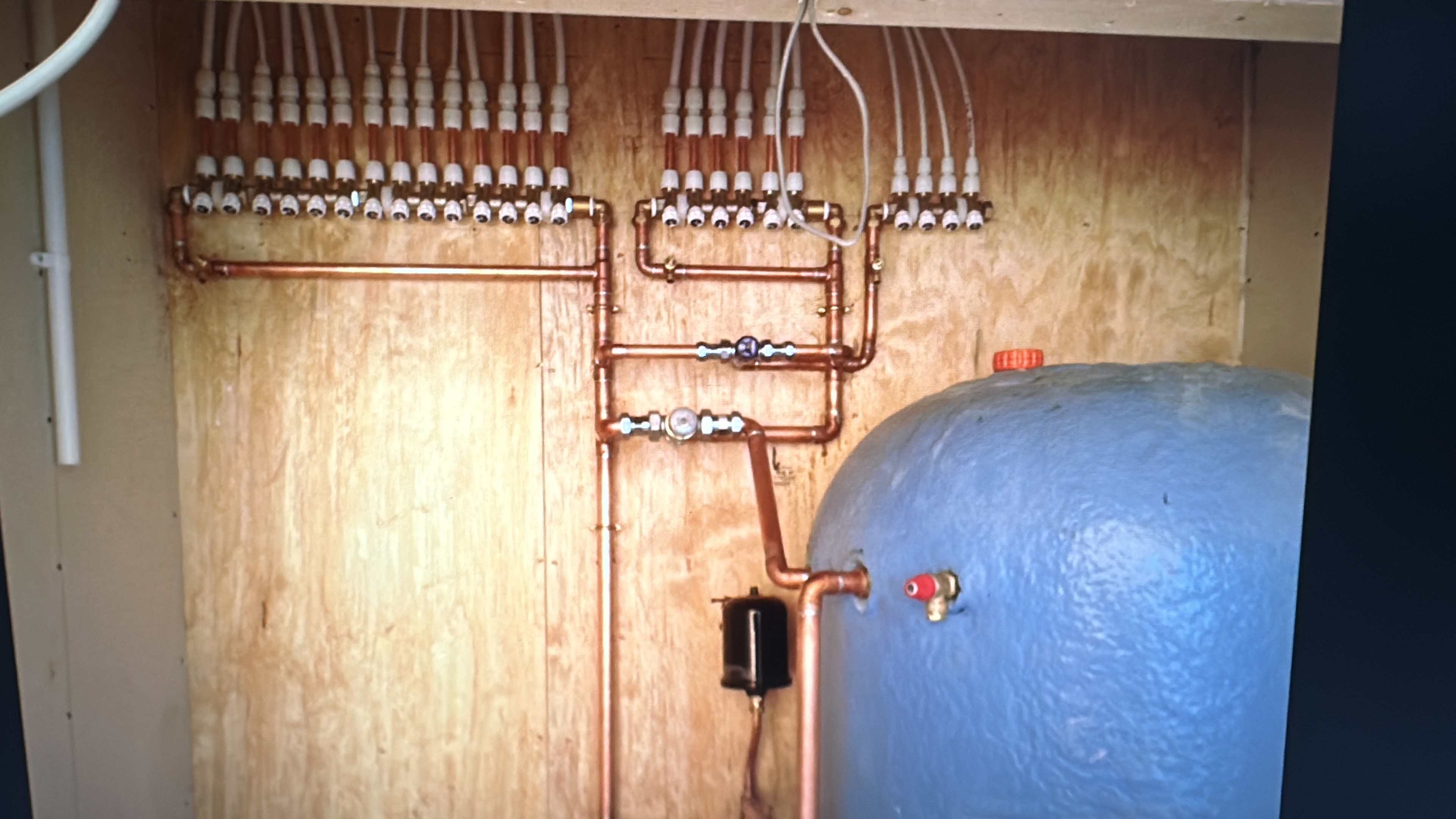

Nickfromwales Posted February 5, 2025 Posted February 5, 2025 I do the showers, baths, and (if they’re less than 12m away) the kitchen and utility hot feeds all in 15mm on radials without the HRC feature. I then fit a second manifold via a TMV, which feeds to all wash basins ONLY, on 10mm flow (<12m) or 15mm flow (>12m) and always on 10mm returns to the HRC pump. This means the recirculated water is never over 46°c, so you can use Hepworth (without voiding their warranty) and the dT is much lower than sending 50-55° DHW direct off the primary UVC TMV, thus reducing losses to the point it’s not worth crying about; but obvs the pipes are all insulated too! An HRC is a brilliant luxury I would afford myself in a heartbeat, especially if I had solar PV > UVC all summer and an ASHP for cheap as chips DHW in the first place. Defo include!

Nickfromwales Posted February 6, 2025 Posted February 6, 2025 These were all short runs, kitchen and utility very close, most bathrooms directly above, so no hot return required. Furthest basin was piped in 10mm and was less than 5-6 secs to get premium temp hot water out of the tap. Far right manifold was 4x wash basins and if you follow the pipe work back you’ll see it is fed via a TMV to cap the max temp at the basins.
