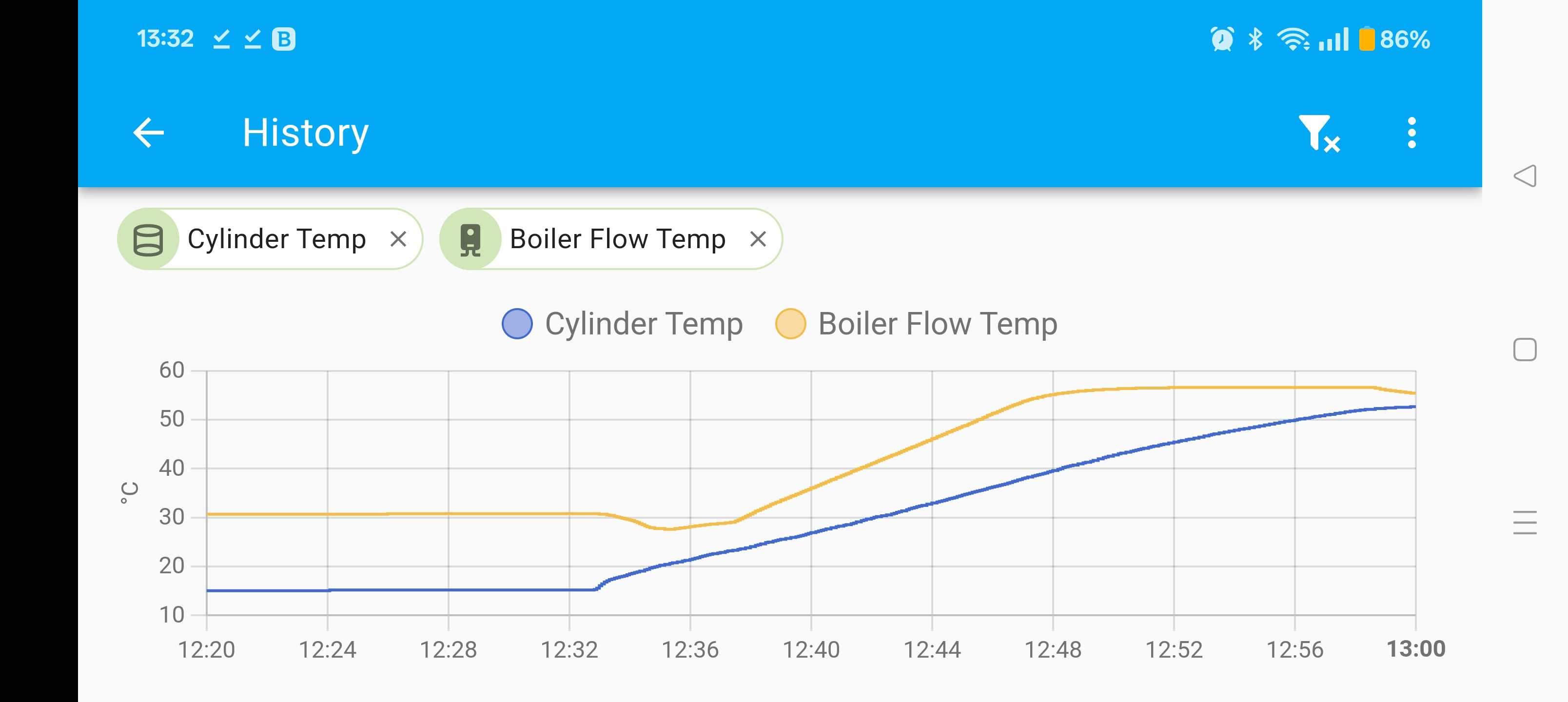

JohnMo Posted February 8, 2025 Posted February 8, 2025 (edited) For anyone scratching there head about gas boiler and heat pump cylinder, this is a plot of one. Note the boiler temperature, the dip at the end is the heat cycle going offĀ Ā Ā Edited February 8, 2025 by JohnMo 1
