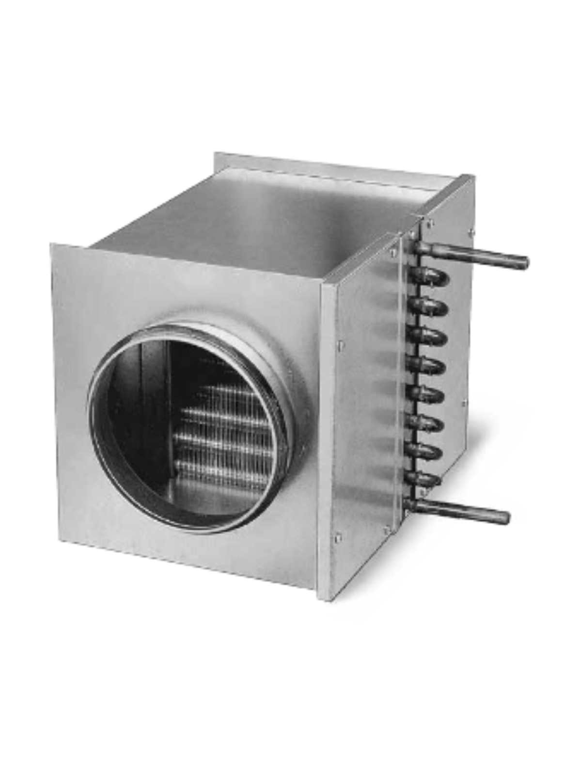

Wookie_73 Posted January 29, 2025 Author Posted January 29, 2025 On 28/01/2025 at 12:50, Nickfromwales said: To mitigate that particular issue I “heat” (zap the cold out of) the incoming air; this is done by sending the supply air coming out of the MVHR unit into a heat battery, fed from the ASHP, and then onto the distribution manifold. This had the equal effect in the summer, zapping the heat out (if the HP is in cooling mode). What heat battery did you use?
Nickfromwales Posted January 29, 2025 Posted January 29, 2025 5 hours ago, Wookie_73 said: What heat battery did you use? I bought all the kit from CVC Systems. I'll ask for the product details when I speak to them next, as it's quite a few invoices ago There are 2 row / column, 3 row / column versions, giving different 'power' per unit, so I size according to the M&E requirement. Random internet pic: This kind of thing. This one is a heat only, as it’s not got a condensate drain. 1
G and J Posted January 29, 2025 Posted January 29, 2025 This (sort of thing) is on your MVHR supply main duct I assume. DO you find it effective?
Nickfromwales Posted January 29, 2025 Posted January 29, 2025 1 hour ago, G and J said: This (sort of thing) is on your MVHR supply main duct I assume. DO you find it effective? I install M&E systems and "renewables" for domestic clients who are, primarily, self building, some up to, and some at Passivhaus certified standards. I do not have a home that MVHR would work in, it's a airtight as a colander. The saying "builders house gets done last" is pretty accurate lol. One day.... The 'effectiveness' is decided at the design stage, and nothing gets actually fitted which doesn't do what I promised it would. I got a nice little award to stick on the fridge from the good people at the Sussex Heritage Trust for my M&E achievements on a £~4m Passiv / NZEB project, so I guess it must have all worked . Either that or the system blew up and killed everyone lol. Part O now gets far more attention as the lid comes off the UK's dire understanding of these things (the repercussions of building a highly airtight and very well insulated home). Worst at it currently are architects and the clients themselves, some don't understand it at all, some don't want to "set fire to the money" installing equipment they think they won't / do not need.... These heat / cool units go immediately prior to the fresh supply manifold, before the air gets delivered to the room. They don't need to do much, (if there's a quality MVHR unit with a high % efficiency rating for heat recovery) so with clever design and a bit of know-how / prior experience, these can be put in to work with barely any controls etc (dumb climate control), and then they just go about their business. In a true PH or thereabouts dwelling, I will often install a 1st floor thermostat (where there was no requirement / need for 1st floor UFH etc), and then put a zone valve on the heat / cool battery that services the 1st floor; this requires a second supply manifold to segregate the upstairs rooms (again, all done / decided at the design stage). For a smaller dwelling you'd just use the 1st floor stat to kick cooling into gear, dependant on a 'cool capable' heat pump having being specified, and it being on already doing cooling via the slab; you just tee off that primary circuit and pump a supply to the heat / cool battery. Oh, I forgot to add, I install a relay for when cooling is activated, to get the requisite higher volume of air to all spaces. This does make the MVHR system slightly audible, definitely notable in quiet spaces / bedrooms, but the human brain is happy to hear something making the house cool (a-la A.C.) so that's not an issue I've found. The trick is to design a system that preempts the house becoming uncomfortably hot, deals with it quickly and efficiently (labours during the day > early evening), and then the home should be comfortable enough at bedtime to not have to try and sleep with the system still on boost.

Wookie_73 Posted February 3, 2025 Author Posted February 3, 2025 On 29/01/2025 at 19:50, Nickfromwales said: I bought all the kit from CVC Systems. I'll ask for the product details when I speak to them next, as it's quite a few invoices ago There are 2 row / column, 3 row / column versions, giving different 'power' per unit, so I size according to the M&E requirement. Random internet pic: This kind of thing. This one is a heat only, as it’s not got a condensate drain. Thanks 👍
