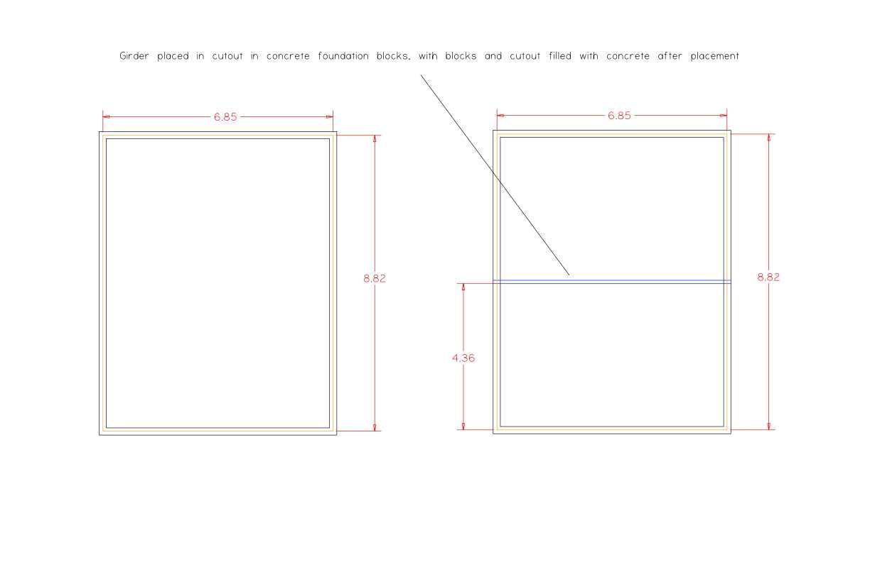

Boyblue Posted January 18, 2025 Posted January 18, 2025 (edited) I've seen mention of girders as part of beam and block but I can't find a video or pictures showing how it's done. Is a girder able to span 6m and carry the weight of all the beams that would be resting on it? Edited January 18, 2025 by Boyblue
crispy_wafer Posted January 18, 2025 Posted January 18, 2025 Beams are typically placed on blocks over here and spaced out to suit the loading above and length/width of block infill. Cutting a channel into foundation blocks for the steel? Got to ask why? Is this structural engineer designed?
Boyblue Posted January 18, 2025 Author Posted January 18, 2025 (edited) 1 hour ago, crispy_wafer said: Beams are typically placed on blocks over here and spaced out to suit the loading above and length/width of block infill. Cutting a channel into foundation blocks for the steel? Got to ask why? Is this structural engineer designed? As mentioned I haven't seen how the girders are used in conjunction with beam & block, and I'd be curious as to how it works. The drawing is just a sketch, no engineering involved. Let's presume the girder is properly sized and attached, the purpose would be to support beams and block that would run perpendicular to the girder. So that instead of 250kg, 6.85m beams you'd have mor managable 4.36m beams to install. Maybe it's because all the homes here are built slab on gade, but most plans have few internal foundation walls, so opting for Beam & block could add significant cost. I was just thinking that in a case where the plans have already been approved, having an engineer add the girder detail would be a simple fix, that is if they are designed for that purpose. Of course the simplest thing to do would be to add the middle wall to the foundation design. Edited January 18, 2025 by Boyblue
G and J Posted January 18, 2025 Posted January 18, 2025 From what I've read on here if bnb spans more than 5m there's a definite danger of ‘bounce’. As a result we're putting an extra foundation (is it called a sleeper wall?) down the middle of the house to reduce beam length. We will have to manhandle these beams as we cant use a crane (overhead wires) so that helps with that too. Are you thinking of using a beam to save the extra foundation?
Boyblue Posted January 22, 2025 Author Posted January 22, 2025 (edited) On 18/01/2025 at 03:32, G and J said: From what I've read on here if bnb spans more than 5m there's a definite danger of ‘bounce’. As a result we're putting an extra foundation (is it called a sleeper wall?) down the middle of the house to reduce beam length. We will have to manhandle these beams as we cant use a crane (overhead wires) so that helps with that too. Are you thinking of using a beam to save the extra foundation? It was because I liked the idea of having manageable lengths plus, I had an issue sourcing a crane that didn't include excess charges. But you've now introduced a new dynamic. In a situation where the technology is new to folks here, bouncing floors would be a nonstarter, so if we need to include additional support, it will have to be done. Whether by installing a sleeper wall or a pier with a beam I’ll let the engineer decide the most economical solution. Edited January 22, 2025 by Boyblue
Temp Posted January 23, 2025 Posted January 23, 2025 (edited) We have a large room and the SE specified two steel beams to reduce the span of the concrete beams. Only issue was the steel beams are a bit taller which could have caused issues with the UFH upstairs. PS This was a B&B first floor. Edited January 23, 2025 by Temp
Boyblue Posted January 24, 2025 Author Posted January 24, 2025 15 hours ago, Temp said: We have a large room and the SE specified two steel beams to reduce the span of the concrete beams. Only issue was the steel beams are a bit taller which could have caused issues with the UFH upstairs. PS This was a B&B first floor. That must have been some span, did you use standard beams or 215 beams?

Temp Posted January 27, 2025 Posted January 27, 2025 On 24/01/2025 at 02:13, Boyblue said: That must have been some span, did you use standard beams or 215 beams? We needed two beams because a single central beam would bear on a window and the design of the window made that difficult. Afraid I can't recall how deep the beam are.
