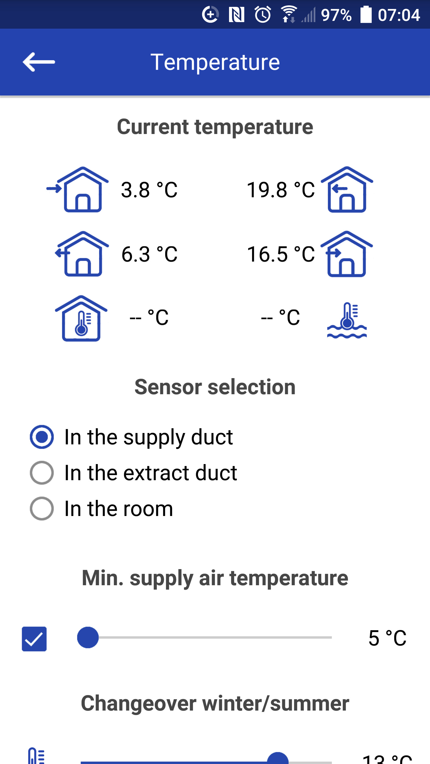

I'm running a Blauberg SB 550 unit which is possibly a little oversized for our build. When commissioned  the air flow temperatures suggested I was getting pretty much 94%, today, three years later it looks as though its running at about 80%. The filters are clear(newly fitted), the heat exchanger core and internals of the unit and clean and indeed look like new.
When commissioned the air entering the house was less than 3.3C colder than the air leaving the house.
Now it's pretty much 5.3C cooler. That's a big enough difference to notice as a draft. The figures looks like it has to be the heat exchange unit unless I'm getting a lot more air into the house than is leaving it through the MVHR. Our build ACH of 0.6 was, testing the flows should let me know if this has changed.

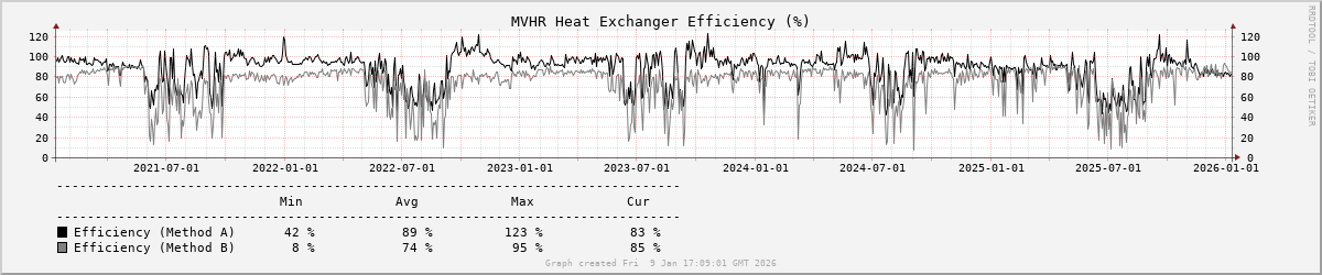

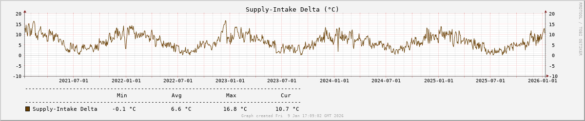

Just stumbled across this thread and happened to have been looking at some charts for our MVHR system covering the five years since first installed and thought them worth posting as it looks like performance has remained fairly consistent with no apparent degradation:
The overall average efficiency rating of 89% (or 74% using a slightly different calculation method) doesn't seem too bad, particular given the annual drops over the summer as the bypass kicks in an out thus throwing all the figures out. The supply-intake delta (difference in temperature between the outside air and what is being supplied to the rooms) has similarly remained consistent over the years.
In terms of maintenance, all I've ever done is replace the heat exchanger filters every 6-12 months. I haven't cleaned any ducts, external grilles, the heat exchanger itself etc.

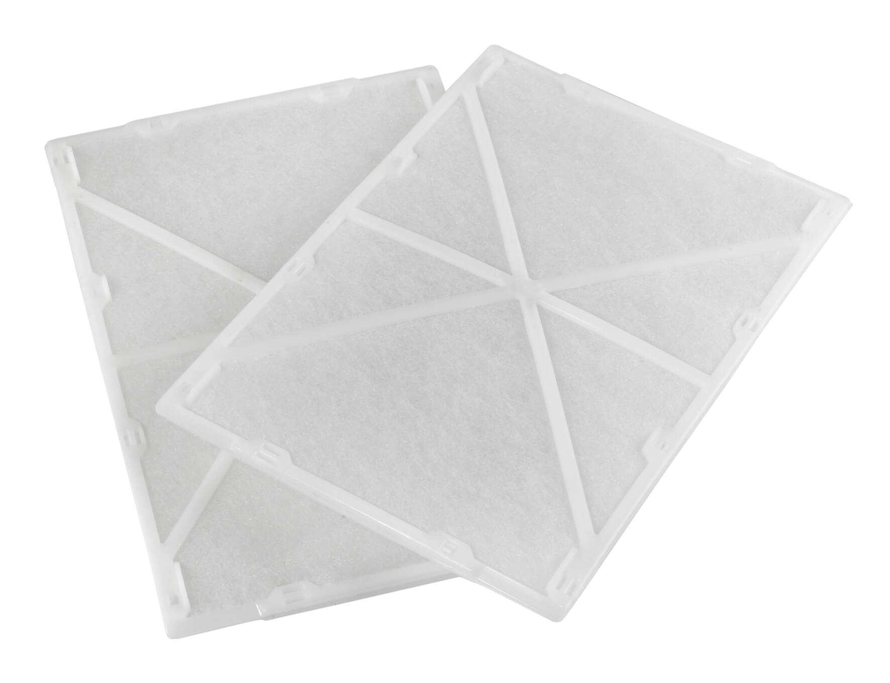

Do you change or clean the filters? Mine were washable
Change. Ours came with G4 filters and for their replacement I've just been using a giant roll of cheap generic filter material that I cut and fit into the stock frames.
They are certainly always very dirty each time, particularly the incoming filter which is black and full of various insects! The extract is cleaner, but still quite dusty.
Data is so useful, so much better than guesswork.
I am quite impressed with the efficiencies, what are the two different methods you use?
I got them from a Paul Heat Recovery page at this link which, unfortunately, no longer appears to exist. This is a shame as it went into some detail behind multiple methods being useful, and explained it well along the lines of the other info that they still publish.
Here are the calculations though:
Method A Efficiency = 100 x ( SupplyTemp - IntakeTemp ) / (ExtractTemp - IntakeTemp)
Method B Efficiency = 100 x ( ExtractTemp - ExhaustTemp ) / (ExtractTemp - IntakeTemp)
Method B attempts to factor in unit insulation loss which can also include heat going into the unit from the surrounding area this artificially boosting the apparent efficiency calculated with Method A. I am probably explaining it badly, and always just used to refer the the explanatory graphic on the page that illustrate the addition heat flow paths that Method A doesn't take account of.

On 28/02/2026 at 00:22, ectoplasmosis said:
Would you mind sharing your source of filter material?
Apologies; I missed this. As @JohnMo said this was just generic filter material - I bought mine from https://www.justfans.co.uk/synthetic-air-filter-media-10mm-1000mm-1000mm-p-2037.html. I see it is listed as G3 whereas I thought I was buying G4 as per what was originally supplied. Either the page/product has changed or maybe I never was. I'm not too fussed either way as I've been using it for a few years and it seems to be doing the job.
