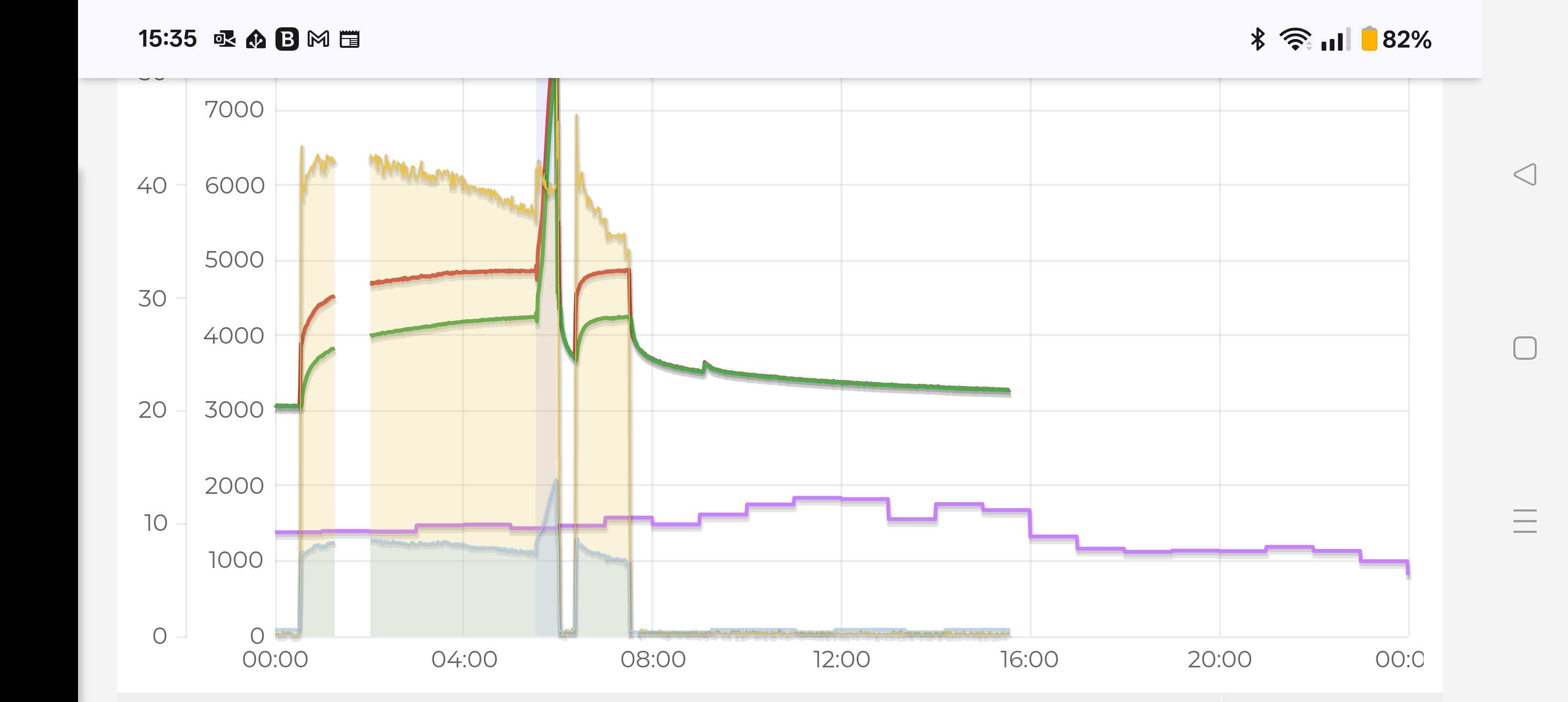

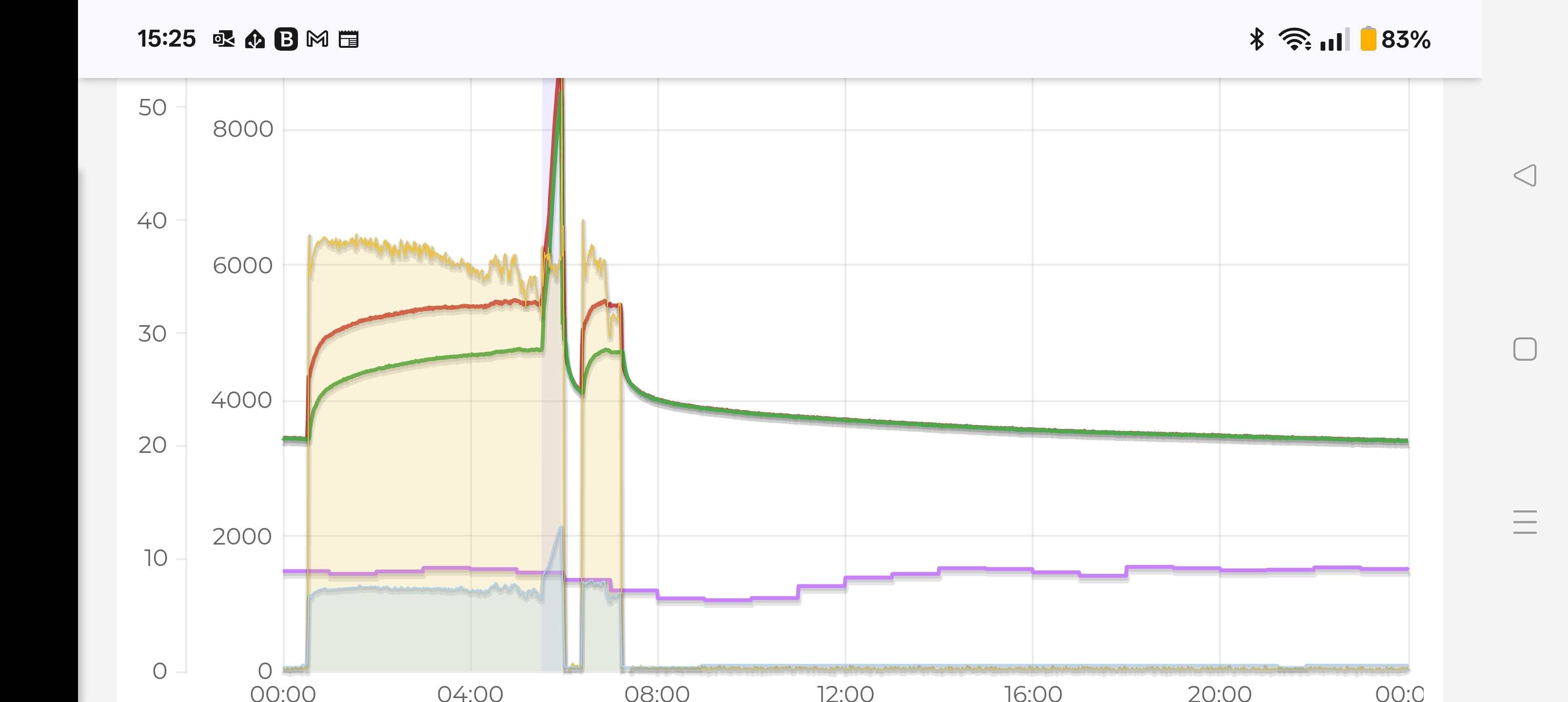

JohnMo Posted January 17, 2025 Posted January 17, 2025 5 minutes ago, Super_Paulie said: So no matter what i do to this my efficiency is going to be the same, its about finding the point where im condensing for longer i suppose to try and win back a few pennies and not ruin the boiler through super-low cycles No not correct. You can get long cycle times, but you have to run it differently. Long runs will decrease gas consumption considerably. You need to think of using your floor more as storage heater. You fill it with energy then switch off the heat source, allow energy to deplete then recharge. That is what a simple thermostat does. Your smart stat may do that for you, but suspect it won't as it will want to run in TPI mode, not in hysterisis mode. This is what my heat pump did last night (boiler does the same but cannot give a pretty image). It was supplying around 6kW against about 1.2kW heat demand. It ran for a long period, because I had allowed the floor to deplete it's energy. All controlled by a simple thermostat. The yellow bit is kW, the red line is flow, green line return. Purple is outside temp. The long green line after the yellow is the combined flow and return (pump stays on). The spike is DHW at about 6.30am. The gap in data was the modem rebooting. Previous night for reference
Super_Paulie Posted January 17, 2025 Author Posted January 17, 2025 30 minutes ago, JohnMo said: No not correct. You can get long cycle times, but you have to run it differently. Long runs will decrease gas consumption considerably. You need to think of using your floor more as storage heater. You fill it with energy then switch off the heat source, allow energy to deplete then recharge. That is what a simple thermostat does. Your smart stat may do that for you, but suspect it won't as it will want to run in TPI mode, not in hysterisis mode. This is what my heat pump did last night (boiler does the same but cannot give a pretty image). It was supplying around 6kW against about 1.2kW heat demand. It ran for a long period, because I had allowed the floor to deplete it's energy. All controlled by a simple thermostat. The yellow bit is kW, the red line is flow, green line return. Purple is outside temp. The long green line after the yellow is the combined flow and return (pump stays on). The spike is DHW at about 6.30am. The gap in data was the modem rebooting. Previous night for reference Thanks for that that. That is how i would like to go really due to my boiler modulation being shitty, heat that thing up, let it radiate for long periods, thats what i did all winter really. Do you have any suggestions for me John based on the above? I havent had any heating requirement for 17hrs now but its within a degree of the stat calling as we speak. My flow of 57, mixer of 45, bypass rad open 1/4 keeps my return within the range for condensing but with a decaying cycle time ultimately ending the evening on a 8minute cycle.
