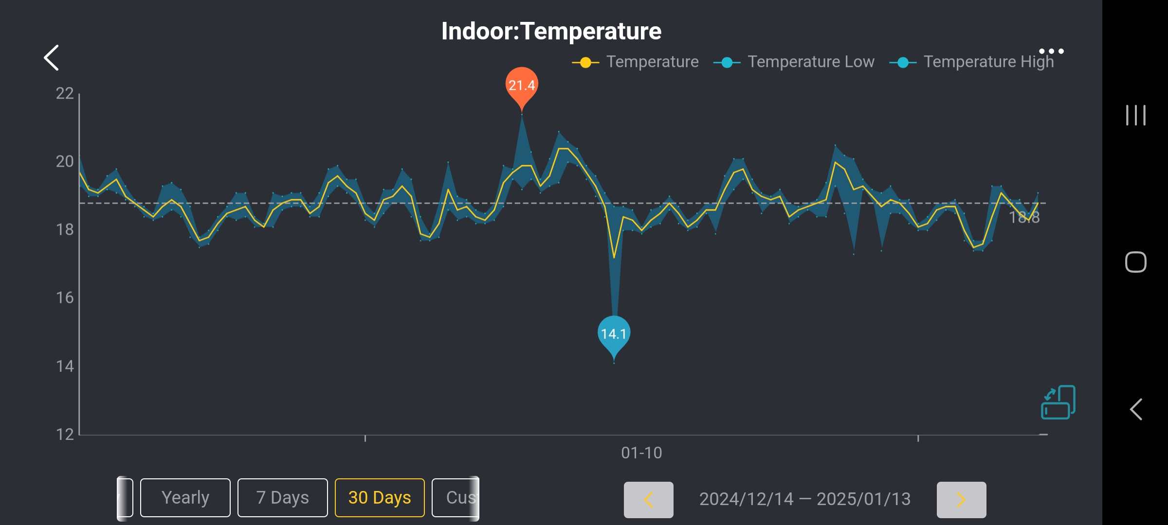

It doesn't really happen. We've ours set on weather comp on 7 hours per day (low rate overnight) with single stat set to 19.5c. During cold spells we just manually turn the heating on 24x7. There no need to control rooms individually.
As you can see, temperature only varies by 1-1.5c every 24hrs, sitting at an average 28.8c. peaks are either heating periods or having extra people in the house. The big trough was when I had to open the doors to vent the house after some pungent stir frying

You should just be putting enough energy into floor to keep house stable. You will have to do some loop balancing during commissioning.
Or you just use thermostats as limit stops set a Deg or more above target temp only room that may get effected by solar gain. You don't want zones calling for heat just closing a few loops off. But UFH is pretty much self regulated. Floor temp is generally only a Deg or two above room temp. So if room gets two degs warmer than target (same temp as floor) floor output reduces to zero.
