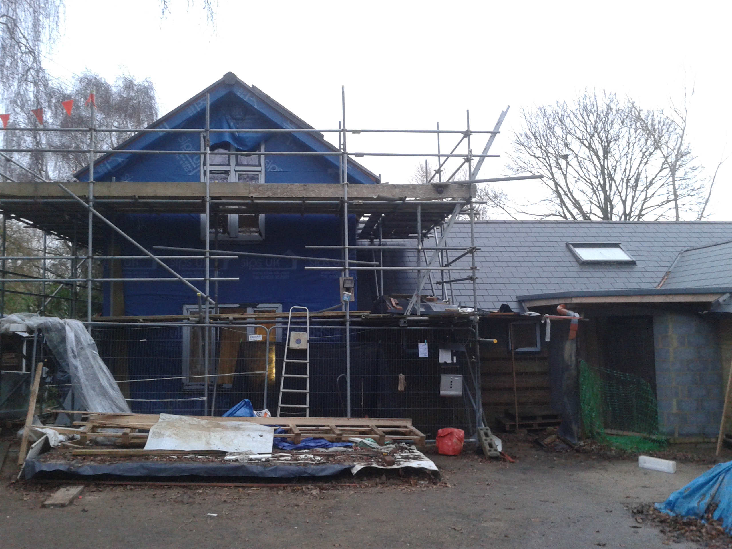

Weekend spent in the loft getting things prepped for plumbing and building studwalls (for creating an atrium hallway downstairs) and I have been trying to plan routes for my MHVR ducting. Most of the ducting will serve a bungalow with ducting to go via loft, but will also have to route it into a 2 storey extension that has been built onto the other side of a gable wall, i.e:
Most likely will end up going for the semi-rigid type stuff. My only real concern is that there are likely to be a few obstacles in the way that will have to be navigated around which means the ducting will have to go up by 500mm and then come down again by the same amount, a bit like so:
