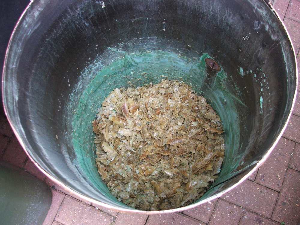

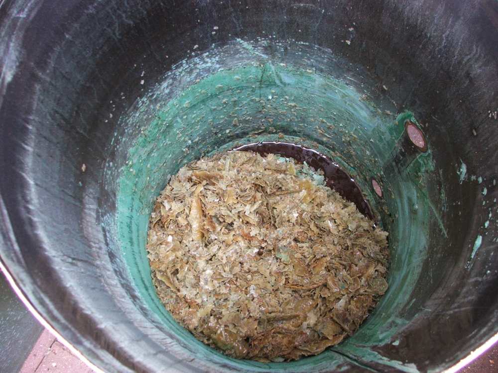

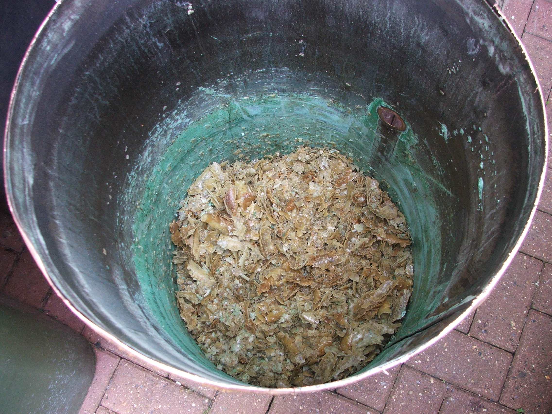

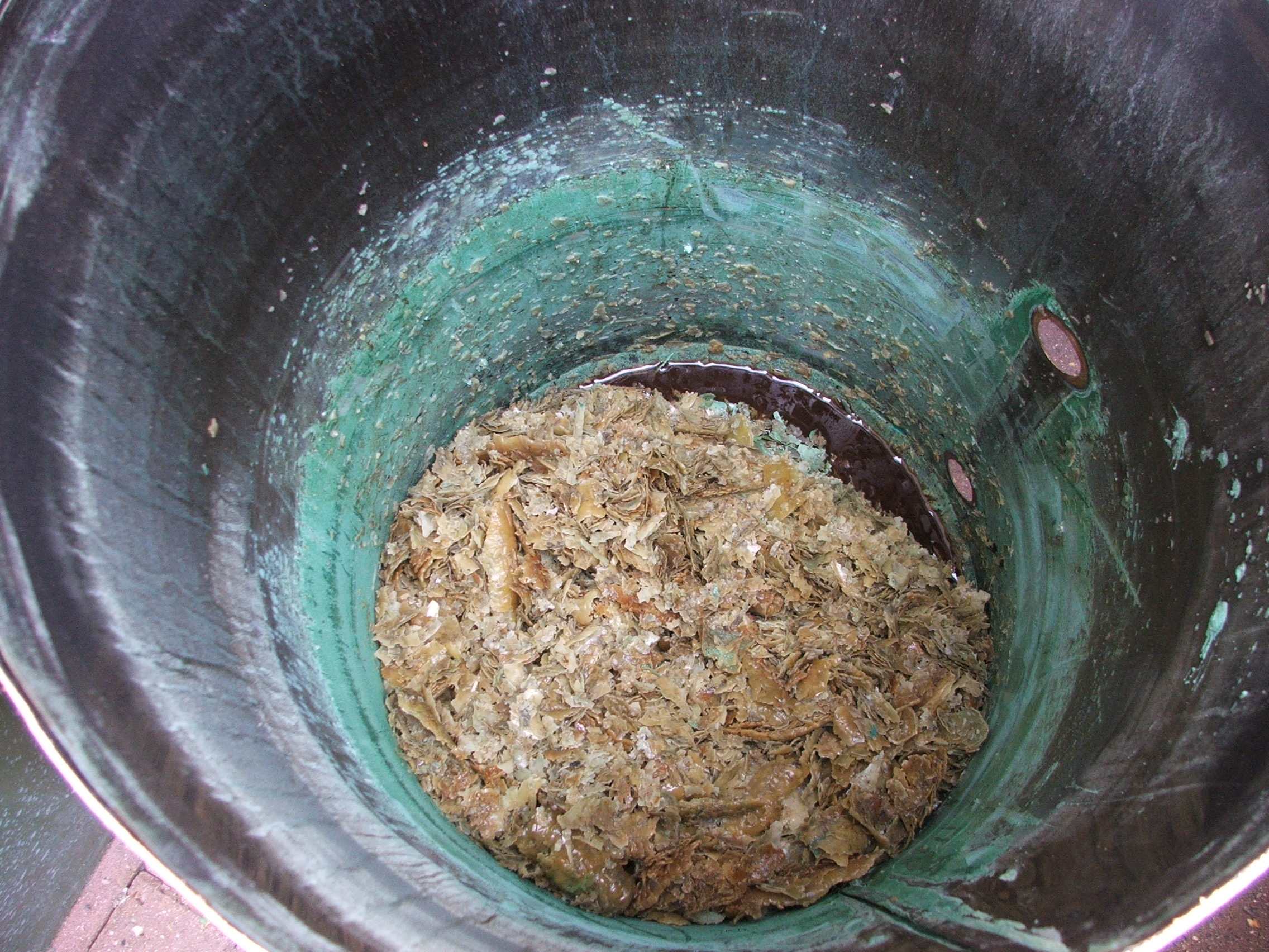

marshian Posted January 11, 2025 Posted January 11, 2025 19 hours ago, JohnMo said: Means nothing really. The issue is not materials but scale being deposited. You could make it out of gold and you would still get deposits killing the coil heat transfer. You need to stop the deposits forming in the first place. Spot on ^ We live in a stupidly hard water area - kettles last at best 2 years and anything that gets in contact with water has water marks all over it When I replaced my 115 litre copper HW tank in 2011 (old one had been in since house was built in 1982) I drained it down and disconnected it - I could hardly lift the damn thing and it took two of us to carry it down the stairs The local scrap dealer would give me a good price for copper but stipulated that it had to be cut open and any scale removed before he'd weigh it and give me cash for it I could not see the heating coil for all the scale inside!!!!! I've got a picture somewhere of the inside of it!! I fitted a water softener after that and now the glass and tiles in the showers stay super clean and the taps don't fur up Kettles still only last 2 years max but we don't use softened water for cooking or drinking
MJNewton Posted January 13, 2025 Posted January 13, 2025 On 11/01/2025 at 11:03, marshian said: I've got a picture somewhere of the inside of it!! I'd like to see that. I am considering descaling ours in the spring/summer and would like to know what I might be up against!
marshian Posted January 13, 2025 Posted January 13, 2025 2 hours ago, MJNewton said: I'd like to see that. I am considering descaling ours in the spring/summer and would like to know what I might be up against! i couldn’t see the heating coil when I cut the top off once I’d cut the coil connections and pulled it out this was was left inside 1
MJNewton Posted January 13, 2025 Posted January 13, 2025 Ooh nice. Will be interesting to see what I've got, and whether a 2kg tub of Fernox DS3 will dissolve it!
