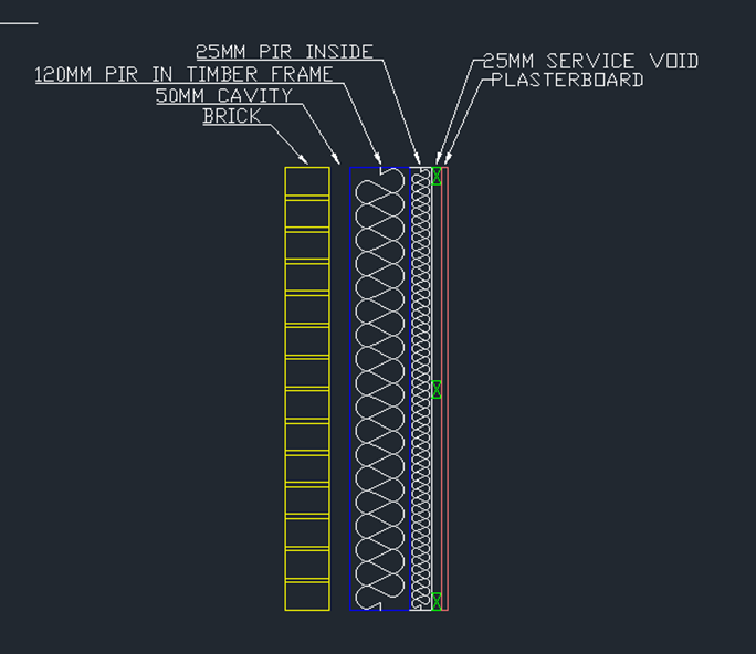

sgt_woulds Posted January 8, 2025 Posted January 8, 2025 According to your drawing, there doesn't appear to be any racking board on the frame. Is that correct? In 'traditional' UK timber frame I would expect to see OSB or plywood fitted external to the timber frame. (You also show a 120mm frame in the drawing but say it is only 90mm? If it is 90mm why not fully fill the space - use two layers of 45mm or 90mm boards - both options available from Celotex?) Is your frame open to the cavity? What protects the insulation and timber frame from the moisture in the external cavity - there should be a breathable membrane external to the frame? This is very important as it determines the 'breathability' of the structure and the type of VCL you need to fit internally. This also creates follow-up questions regarding your insulation choice and fitting methods. Detailing will be critical to ensure no long-term repercussions of 'upgrading' the insulation. Are you insulating the whole house, or is this just a small section?
Redbeard Posted January 8, 2025 Posted January 8, 2025 I am very confused! Thanks, OP, for your response to my last post. The annotations (notably the dimensions) on your drawing do not seem to match up with the words in your description. The dwg suggests a total of 145 PIR (25 and 120). Your description below On 07/01/2025 at 03:18, thetdog666 said: 20mm PIR on the face of the timber → 80mm PIR in-between the timber studs suggests a total of 100 (80 and 20). Can you clarify? @Russell griffiths above referred to terminology. Am I right in assuming that the reference to 'battens' below actually refers to the (vertical) structural Studs? 15 hours ago, thetdog666 said: Space is also an issue so am only going for 20mm on the face of the battens.
Redbeard Posted January 8, 2025 Posted January 8, 2025 On 07/01/2025 at 03:18, thetdog666 said: My setup will be from the inside = Plasterboard → Service Void using 40mm x 20mm battens → 20mm PIR on the face of the timber → 80mm PIR in-between the timber studs → OSB → Membrane → Cavity @sgt_woulds, I think it's down to the difference (see my post above) between the dwg and the description. The OP's description (above) has OSB over the studs.

Redbeard Posted January 8, 2025 Posted January 8, 2025 (edited) @thetdog666, noted the OSB and membrane missing, but apart from that is that *the* dwg of what you plan to build, with a total of 145mm PIR, as against your description, in your original post, of 100mm? Edit: Cross-posted with @sgt_woulds Edited January 8, 2025 by Redbeard
thetdog666 Posted January 8, 2025 Author Posted January 8, 2025 3 hours ago, sgt_woulds said: According to your drawing, there doesn't appear to be any racking board on the frame. Is that correct? In 'traditional' UK timber frame I would expect to see OSB or plywood fitted external to the timber frame. Sorry OSB is fitted on the outerside with membrane on the outside side of the OSB. 3 hours ago, sgt_woulds said: (You also show a 120mm frame in the drawing but say it is only 90mm? If it is 90mm why not fully fill the space - use two layers of 45mm or 90mm boards - both options available from Celotex?) This is a drawing of one I found off the net. I didnt make it up so is slightly different to what i have. I heard there can be a tolerance with the timber frame studs and people have had trouble trying to fill it fully as the insulation sticks slightly past the timber frame. 3 hours ago, sgt_woulds said: Is your frame open to the cavity? What protects the insulation and timber frame from the moisture in the external cavity - there should be a breathable membrane external to the frame? Answered above. OSB with breathable membrane 3 hours ago, sgt_woulds said: This is very important as it determines the 'breathability' of the structure and the type of VCL you need to fit internally. This also creates follow-up questions regarding your insulation choice and fitting methods. Detailing will be critical to ensure no long-term repercussions of 'upgrading' the insulation. Are you insulating the whole house, or is this just a small section? Kitchen only just now but ot takes up 1/3rd of my downstairs. Livingroom and dining room next year (if there is a notable difference in temperature) which would be 80% of my downstairs done.
thetdog666 Posted January 8, 2025 Author Posted January 8, 2025 2 minutes ago, sgt_woulds said: And the dimensions? Of the room? 6m x 3.4m
thetdog666 Posted January 8, 2025 Author Posted January 8, 2025 1 minute ago, Redbeard said: @thetdog666, noted the OSB and membrane missing, but apart from that is that *the* dwg of what you plan to build, with a total of 145mm PIR, as against your description, in your original post, of 100mm? Edit: Cross-posted with @sgt_woulds That drawing I posted up is off another page. It is the most similar one iv come across to mine. My frames inside is only 90mm thick.
Redbeard Posted January 8, 2025 Posted January 8, 2025 OK. Got it! So your proposal is 100mm total PIR, as per your original description: *not* as per the drawing. Confusion over. Thanks!

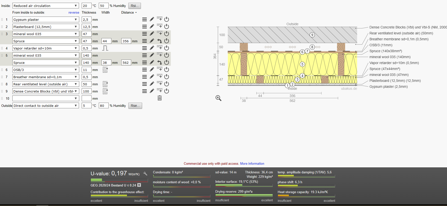

Iceverge Posted January 8, 2025 Posted January 8, 2025 (edited) Lots of confusion re vapor as usual here. Its like worrying about a mouse when there's an elephant in the room. Airtightness is the real bogeyman. Poor air sealing allows hundreds of times more damaging vapour into the wall than vapour diffusion does. Not to mention the outsize effect airtightness has on building comfort and efficiency. I see you've been seduced by the headline K value of PIR to put it in-between the studs too. I wouldn't. It'll age differentially to the timber and you'll get gaps around it. You'll end up throwing lots and lots of offcuts in the skip too. Keep the mineral wool if it's still in good condition, perhaps add another 50mm to ensure the studs are full. ( I assume the studs are 140mm CLS at 600cc? Then an airtightness barrier. Then cross batten and insulate the service cavity. Very buildable, very little waste. A workable robust airtightness strategy. Much cheaper than what you proposed previously. Edited January 8, 2025 by Iceverge 1
Iceverge Posted January 8, 2025 Posted January 8, 2025 (edited) Cross post I see the 90mm frame now and assume the centres are 400mm. Edited January 8, 2025 by Iceverge

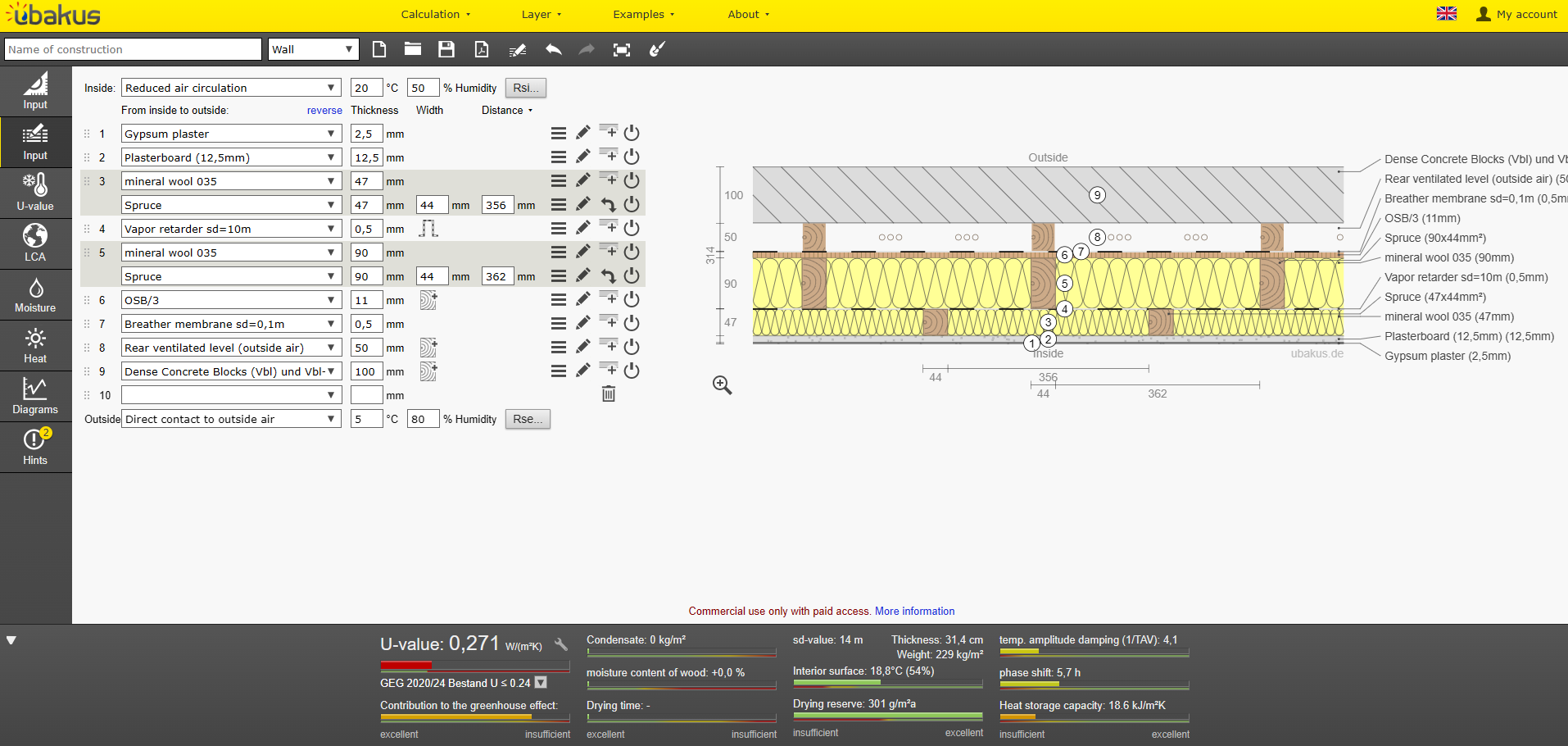

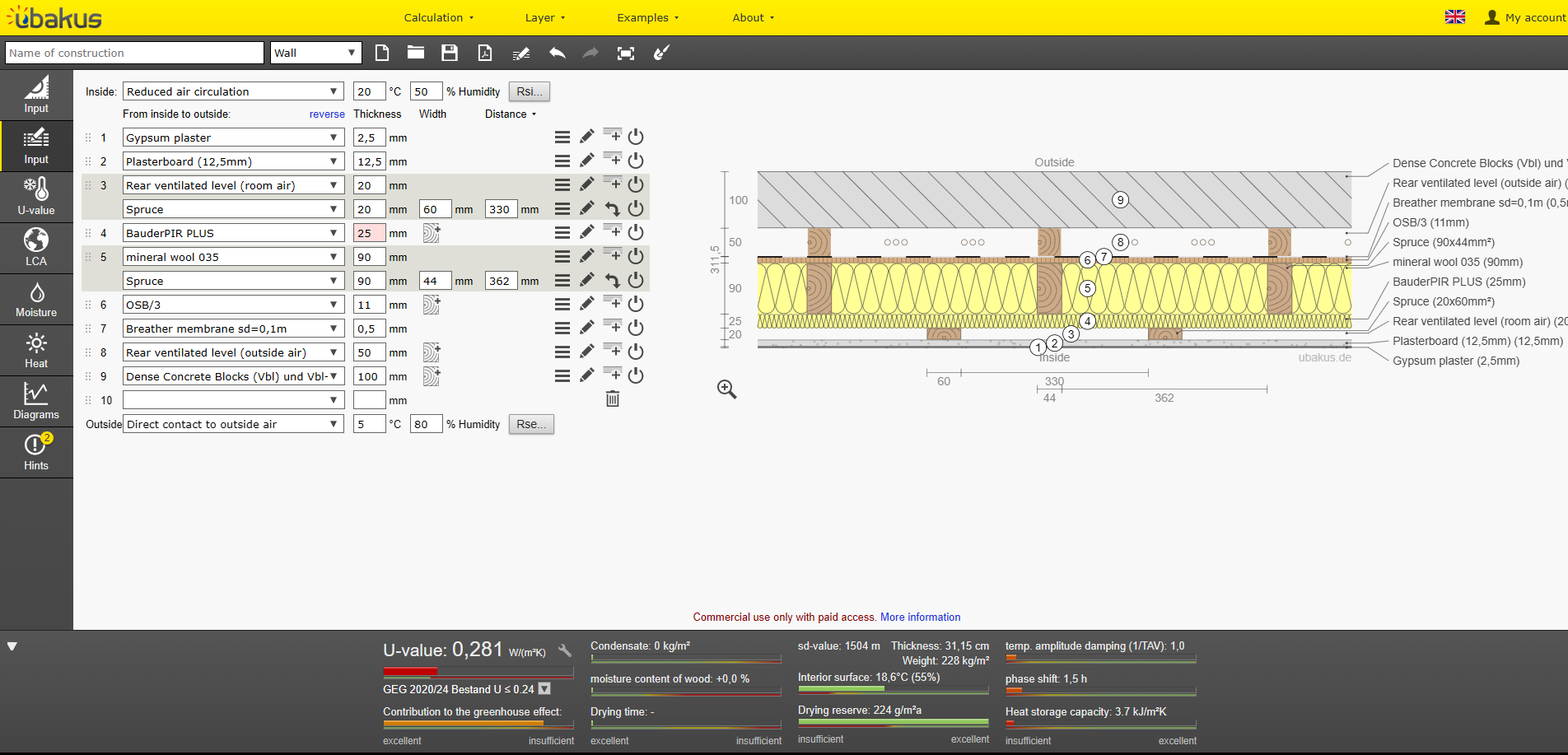

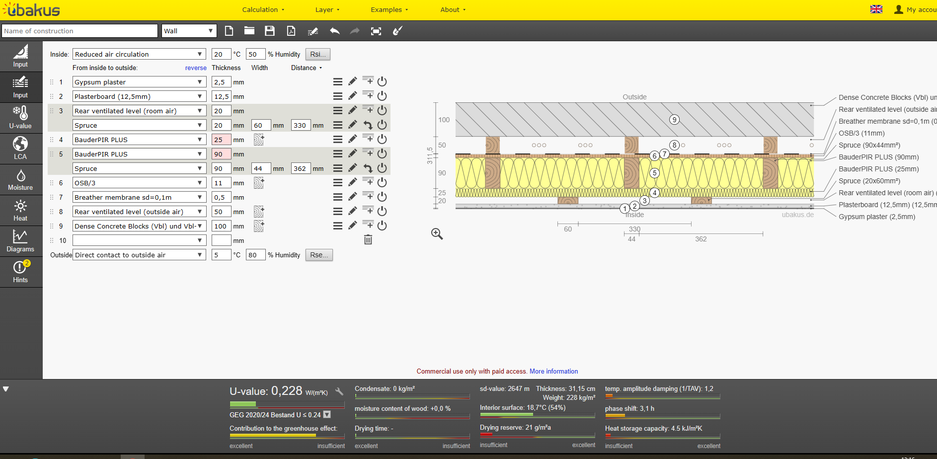

Iceverge Posted January 8, 2025 Posted January 8, 2025 Here's the above with the mineral wool and a 25mm layer of PIR and 20mm of a service cavity. U value is much the same as the full fill mineral wool service cavity. Here's what you are proposing with the PIR in between the studs. A theoretical improvement of 0.043W/m2K. Say you have 100m2 of external wall area, that makes a difference of about 86W to your maximum heating load. A rough guestimate would equate that to about 120kWh of energy annually assuming the house was permanently heated to 21deg. Assuming energy costs of 12p/kWh then you'd save £15 per year. Allowing for waste 100mm PIR is about £15/m2. At 100m2 it would take 100 years to payback, excluding the cost of your labour. Thats before you look at the real life situation with shrinkage and subsequent thermal bypass of the PIR in a timber frame. You'd be better off setting fire to £20 notes than replacing the mineral wool in the wall with PIR.

thetdog666 Posted January 8, 2025 Author Posted January 8, 2025 (edited) 51 minutes ago, Iceverge said: Here's the above with the mineral wool and a 25mm layer of PIR and 20mm of a service cavity. U value is much the same as the full fill mineral wool service cavity. Here's what you are proposing with the PIR in between the studs. A theoretical improvement of 0.043W/m2K. Say you have 100m2 of external wall area, that makes a difference of about 86W to your maximum heating load. A rough guestimate would equate that to about 120kWh of energy annually assuming the house was permanently heated to 21deg. Assuming energy costs of 12p/kWh then you'd save £15 per year. Allowing for waste 100mm PIR is about £15/m2. At 100m2 it would take 100 years to payback, excluding the cost of your labour. Thats before you look at the real life situation with shrinkage and subsequent thermal bypass of the PIR in a timber frame. You'd be better off setting fire to £20 notes than replacing the mineral wool in the wall with PIR. Wow thanks for putting that all Into perspective. I thought PIR would be alot better than mineral wool. Say I went with 100mm mineral wool and 20mm pir over the top would I need a vapour barrier? Thanks Steven Edited January 8, 2025 by thetdog666
