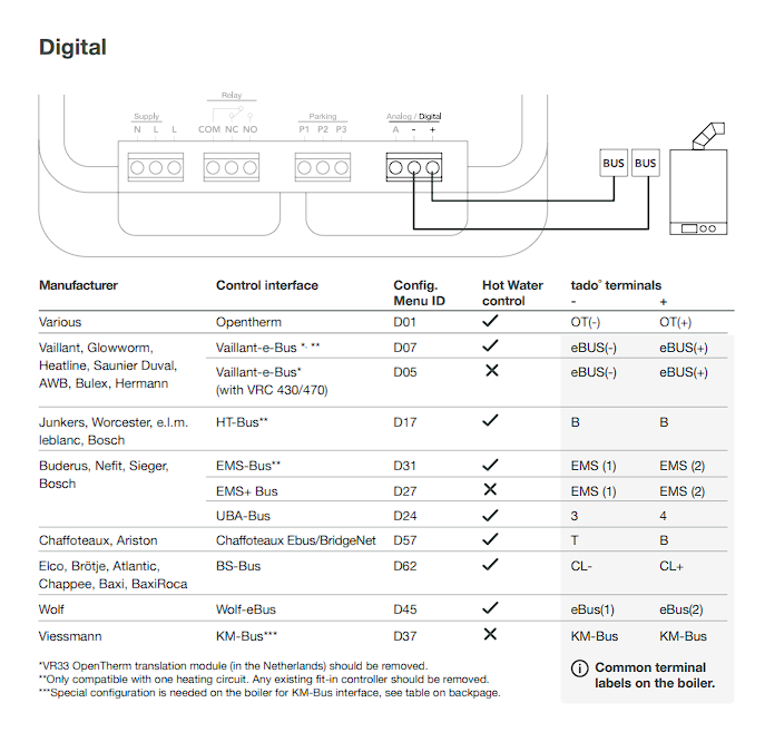

OpenTherm is just one of many Digital Connectivity methods, this is from the Tado installer manual:
All of the digital methods allow two way comms, and the setting of things like flow temperature on the fly from the controller, Tado for example now has flow temperature optimisation which changes on an hourly basis depending on outdoor temperature. It also has the ability to request a specific amount of heat, as opposed to analog which is a simple on or off, and the boiler would modulate down based upon the temperature of the water, this in theory stops huge overshoots of temperature from happening, and therefore wasted energy.
