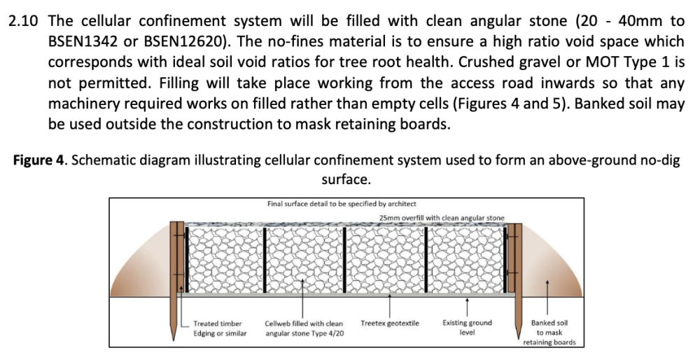

Great_scot_selfbuild Posted December 29, 2024 Share Posted December 29, 2024 So, we need 'a little' cellular confinement system for our build to use as tree root protection (TRP). This isn't a surprise given our densely wooded plot, but I have been genuinely surprised by how much the plastic webbing material costs! How does plastic webbing measuring a just few metres cost this: 3.1m x 8.2m (100mm deep) = £155+ (rated to 8T) 2.7m x 7.3m (150mm deep) = £210+ (rated to 16T) Any tips on finding the most cost-effective cellular TRP? Have you experience on the loading rating being accurate or exaggerated to drive sales? A bit more detail... We have limited access, and will be building the driveway early on, but access past this point is limited to 2.9m wide (just!), and with very little manoeuvring available, so plant equipment will be limited in size. Our tree protection plan requires the area to be covered in cellular confinement system filled with clean angular stone type 4/20 (see attached screenshot), and so whilst I'd like to keep the temporary area as thin as possible (for cost reasons), we will need some plant equipment and heavy materials carried in, so it's likely we'll need to use 100mm deep cellular system throughout, with 150mm for the area adjacent to the road where delivery vehicles will off-load. Other info - The build is a timber frame and will have some steelwork (longest section ~7.5m) Keen to hear from anyone who has done this / similar. TIA Link to comment Share on other sites More sharing options...

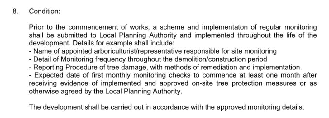

Great_scot_selfbuild Posted December 31, 2024 Author Share Posted December 31, 2024 29 minutes ago, Mattg4321 said: Definitely a box ticking exercise The only way it will get checked is if someone complains and the planners send someone out to look. Our tree protection plan including ramming scaffold tubes into the ground around the tree, with a barrier attached to it. No machinery or materials needed to go near the tree, so would’ve been more damage caused by following the plan. It got ignored. @Mattg4321 I managed to do my research RE: fencing as I also had the same scaffolding suggestion proposed - and managed to get this reduced back to the far cheaper option which doesn’t involve driving large tubes into the ground. unfortunately one of our conditions specifies monthly inspection visits… check out this extract! 🤦🏻♂️ Link to comment Share on other sites More sharing options...
