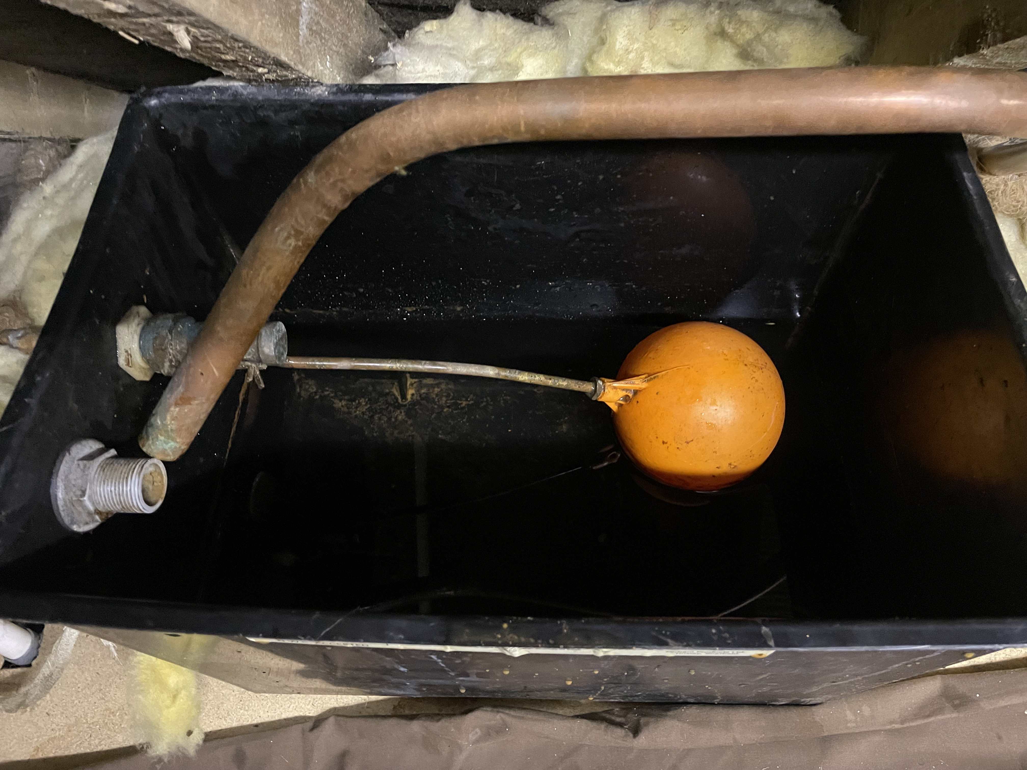

Peaklander Posted January 4, 2025 Author Posted January 4, 2025 I didn't try it earlier because I was distracted by my Dad. Later I felt that maybe PP1 will be too slow and I can't be there to check over the next few hours. So I have come home to go to a 50th wedding. It will be good now until Tuesday when I am going to be steered by what Plumber #2 wants to do. However it could be as simple as lowering the water level. I did bend the float arm but couldn't bail any out as that's when Dad felt odd and I had to check for stroke and heart (I am not a medic). Also there is scope for the vent to be raised. Maybe that's all we end-up doing on Tuesday.

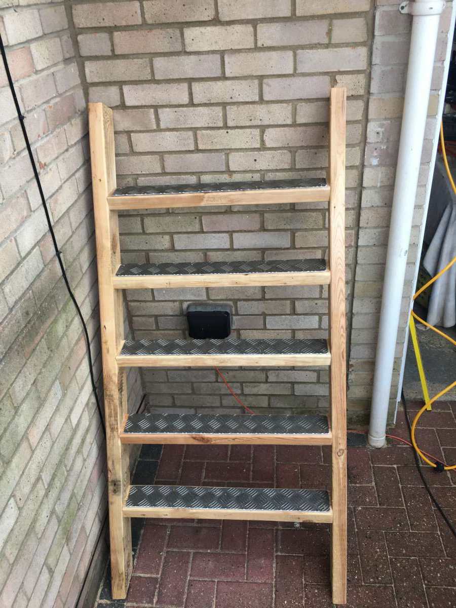

marshian Posted January 4, 2025 Posted January 4, 2025 PS off topic but just to say I fabricated (welded up) some hanging brackets for the pit ladder so that in the winter when the pit can get a bit wet (high water table) the ladder can be swung up and tied off - That was just a check it fits in the hole shot

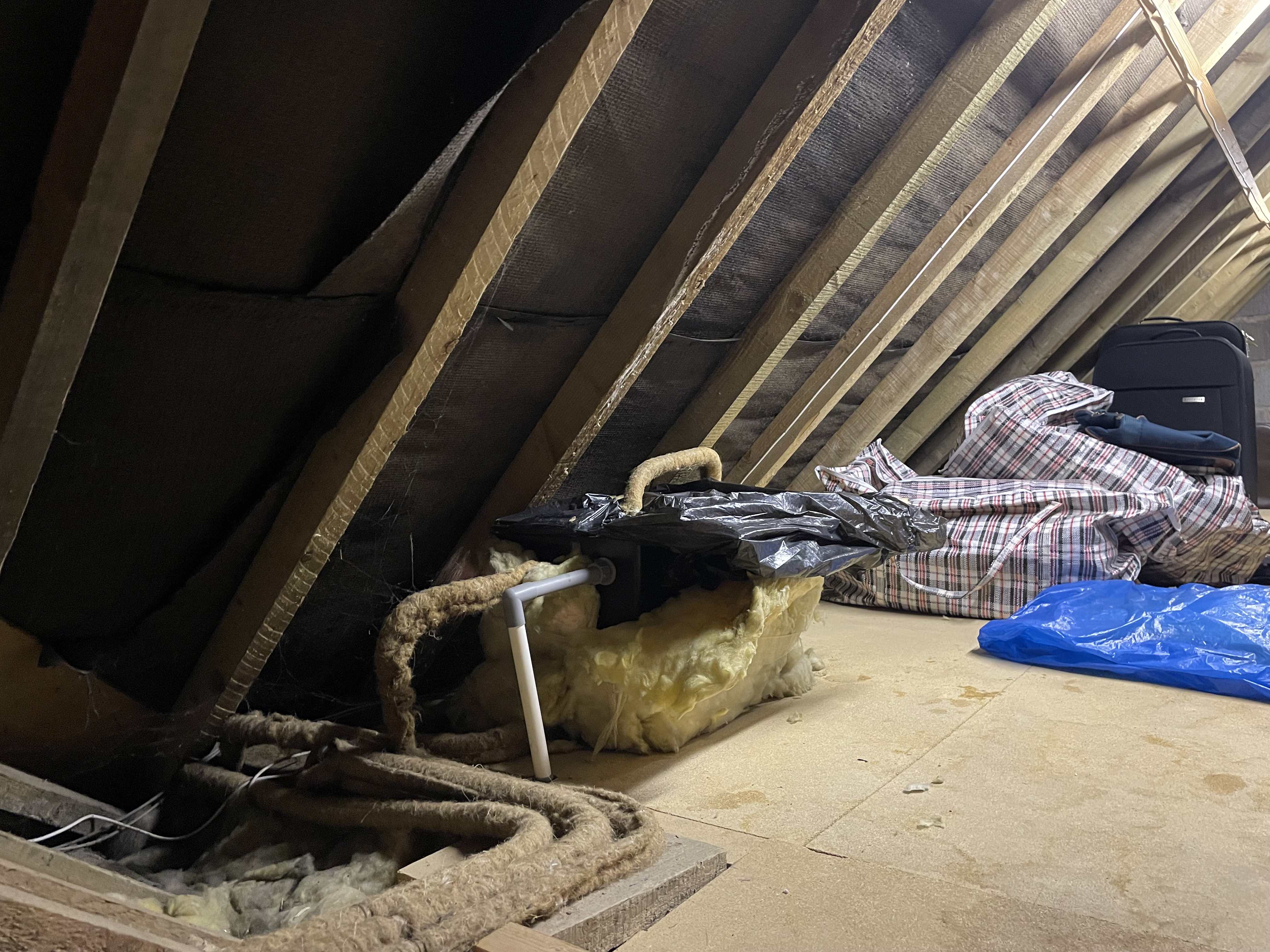

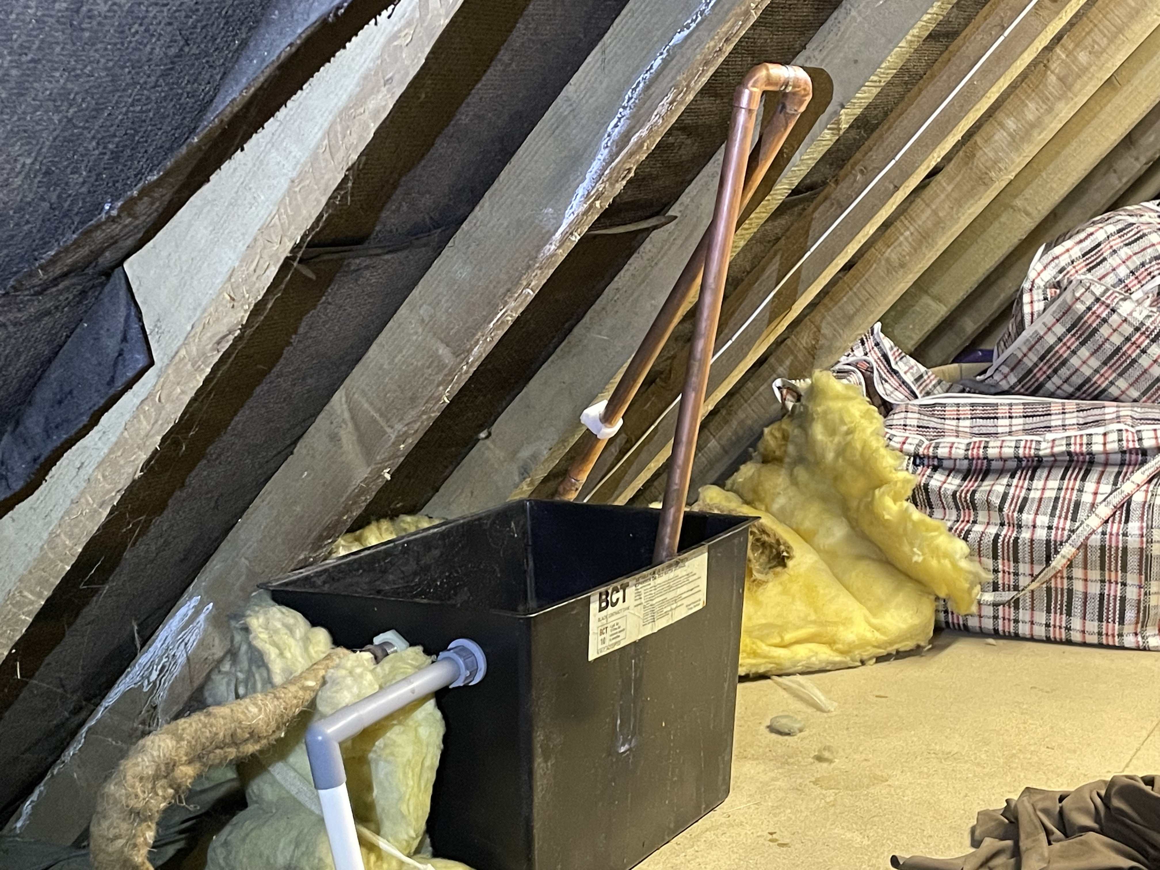

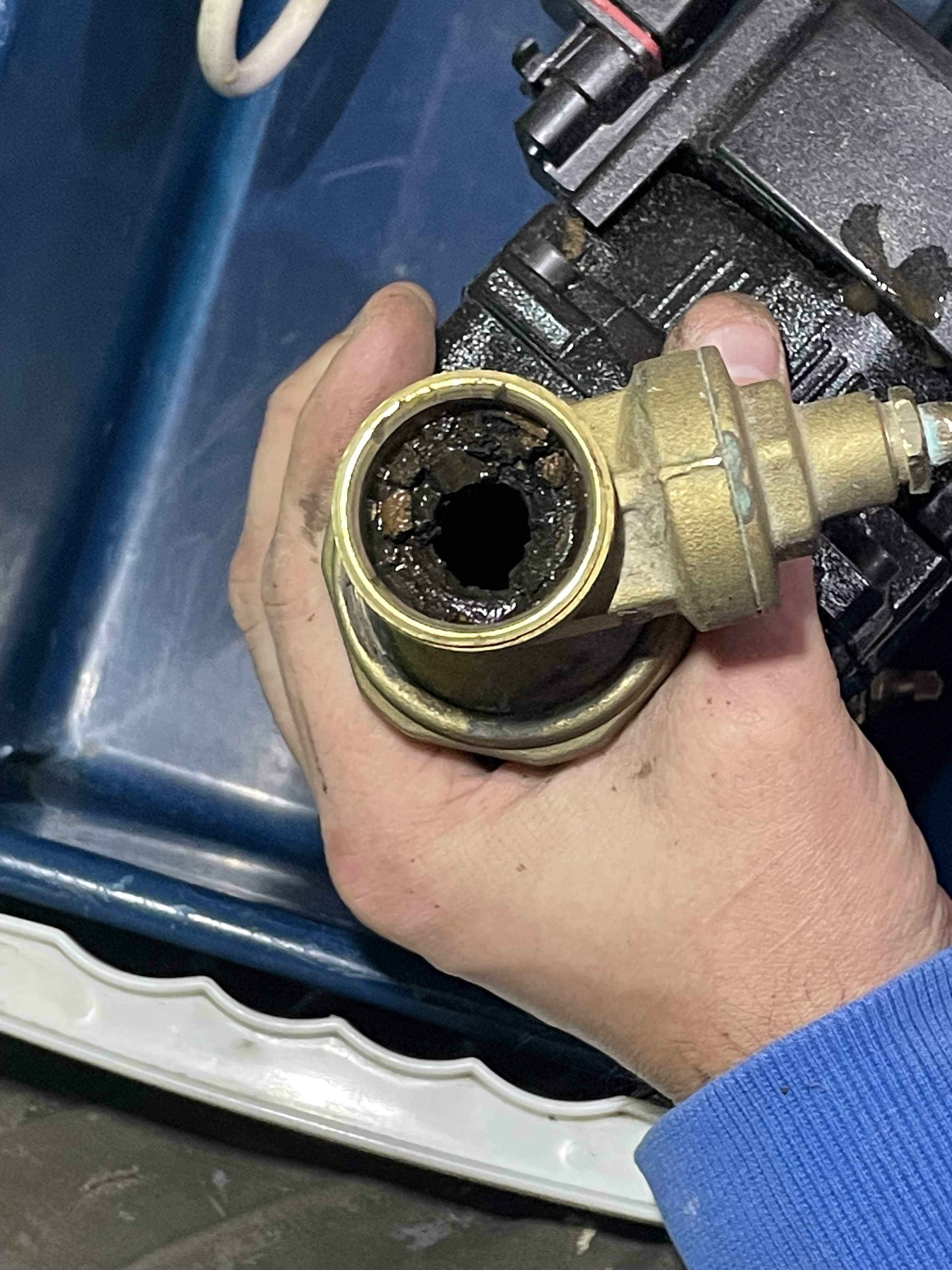

Peaklander Posted January 7, 2025 Author Posted January 7, 2025 Hi, here's the update. We cut the H pipework out, releasing it on the top side of the pump inlet valve. Popped a hosepipe below the cold feed isolating valve and emptied and cleared the header. There was plenty of gunk just in that, obviously most sitting on the bottom and sides under the water level. The inlet side of the pump was choked though. I don't have a pic of the H pipe as I was in the loft but that did have residue on the pipe walls. After this was re-instated the partial refill that was needed seemed to go better than previosuly and there was no pump-over at PP2 pump setting but still a little at full bore. So I asked plumber to lift the vent which he did. I'd already told him that I didn't want to retro-fit a pressurisation vessel. There was no pump-over after that at CC3 but in fact I left it at PP2 and all was well. The header had got some brown water in again from that brief pump-over and so I'm resigned to another full drain and flush/fill - but not until the summer. It has some Fernox P3 in for now. I need to leave it and give my parents relief from the to-ing and fro-ing. Thanks again guys for your sage advice and comments. It has been very helpful and gave me confidence to stand my ground and not do the pressurisation and certainly not rip the whole lot out and replace for £5k 2
marshian Posted January 7, 2025 Posted January 7, 2025 28 minutes ago, Peaklander said: Hi, here's the update. We cut the H pipework out, releasing it on the top side of the pump inlet valve. Popped a hosepipe below the cold feed isolating valve and emptied and cleared the header. There was plenty of gunk just in that, obviously most sitting on the bottom and sides under the water level. The inlet side of the pump was choked though. I don't have a pic of the H pipe as I was in the loft but that did have residue on the pipe walls. After this was re-instated the partial refill that was needed seemed to go better than previosuly and there was no pump-over at PP2 pump setting but still a little at full bore. So I asked plumber to lift the vent which he did. I'd already told him that I didn't want to retro-fit a pressurisation vessel. There was no pump-over after that at CC3 but in fact I left it at PP2 and all was well. The header had got some brown water in again from that brief pump-over and so I'm resigned to another full drain and flush/fill - but not until the summer. It has some Fernox P3 in for now. I need to leave it and give my parents relief from the to-ing and fro-ing. Thanks again guys for your sage advice and comments. It has been very helpful and gave me confidence to stand my ground and not do the pressurisation and certainly not rip the whole lot out and replace for £5k Well it's pretty clear that that's the smoking gun found I've not seen a valve that choked before but I have seen a pump that was pretty similar Have you had a magnaclean or similar installed in the system yet - If you've put Fernox F3 in the system it's probably going to free up other deposits I'd want something in the circuit to collect them rather than letting them build up And yes you can look at it as £5 K saved (for now) Now do you still have the old Grundfos pump
Mattg4321 Posted January 7, 2025 Posted January 7, 2025 Well done. As above, get a magnetic filter on there assuming there isn’t already! 1

John Carroll Posted January 7, 2025 Posted January 7, 2025 If the vent height was like it is now I'd say you would never have had a problem because of that big bore 28mm? H.
Peaklander Posted January 7, 2025 Author Posted January 7, 2025 Yes 28mm around the bottom of the H on the boiler flow to pump and 22 up to vent with 15 down. i don’t know how long it has been since a drain-down or what chemicals have ever been in.

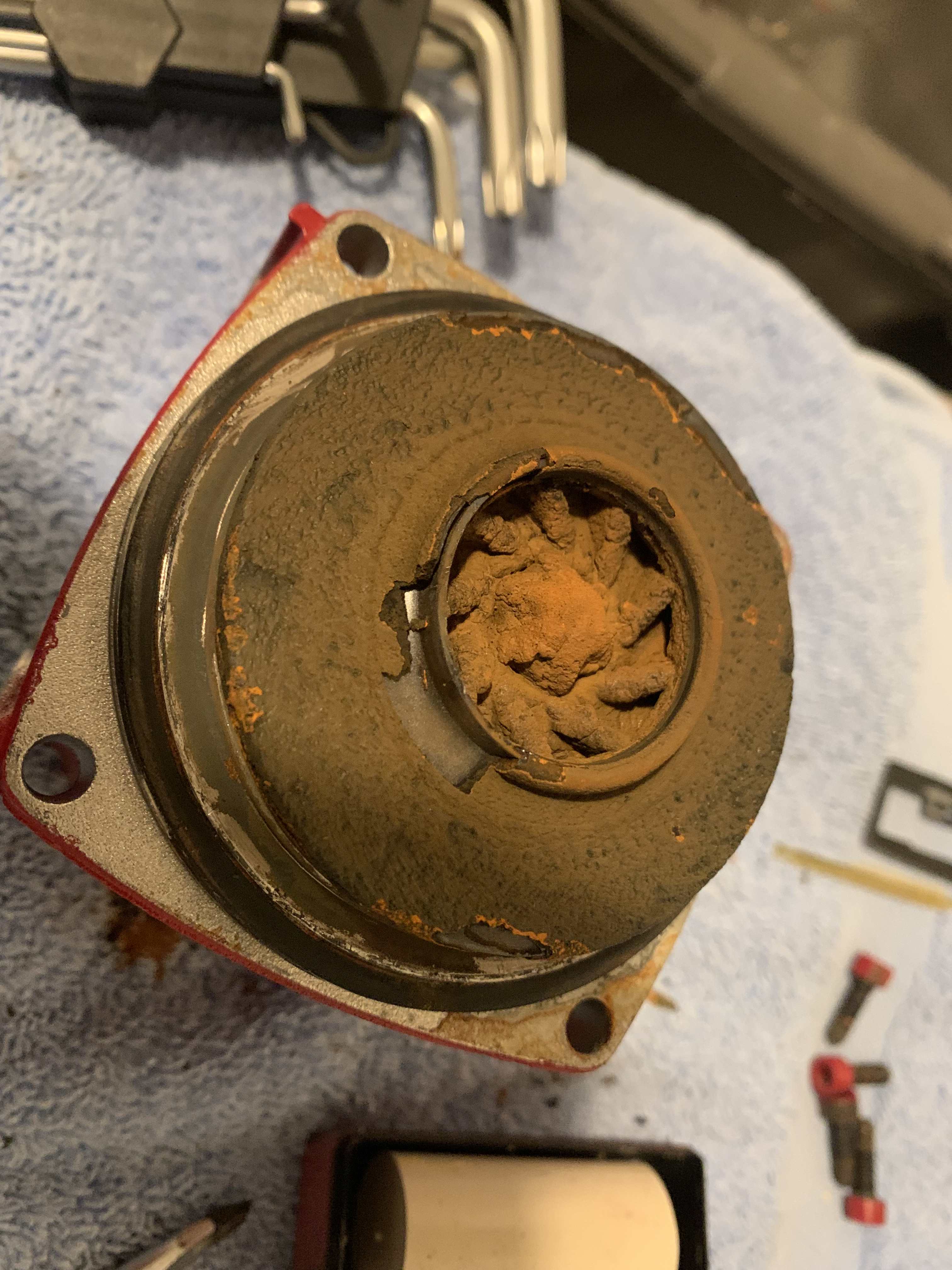

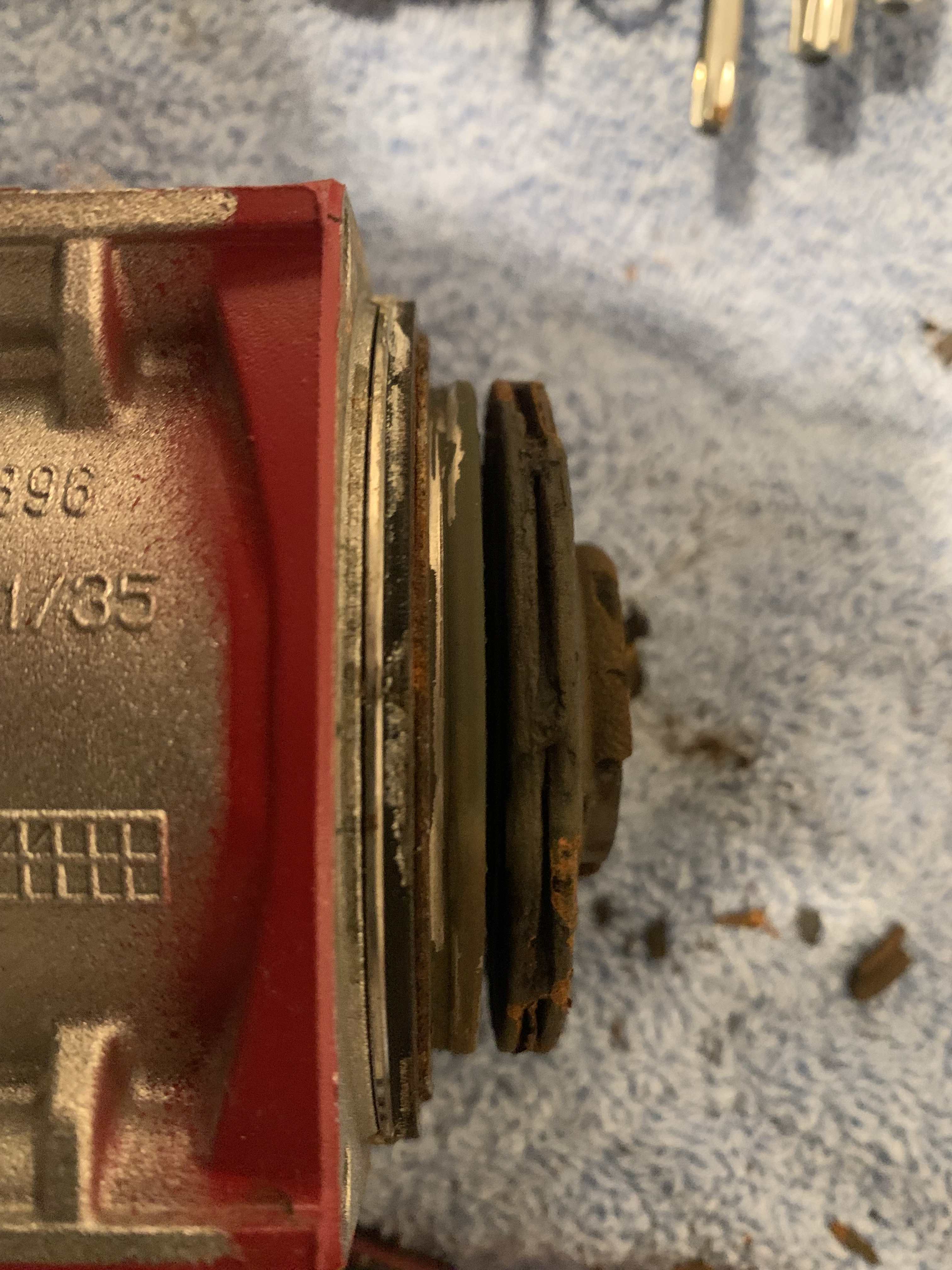

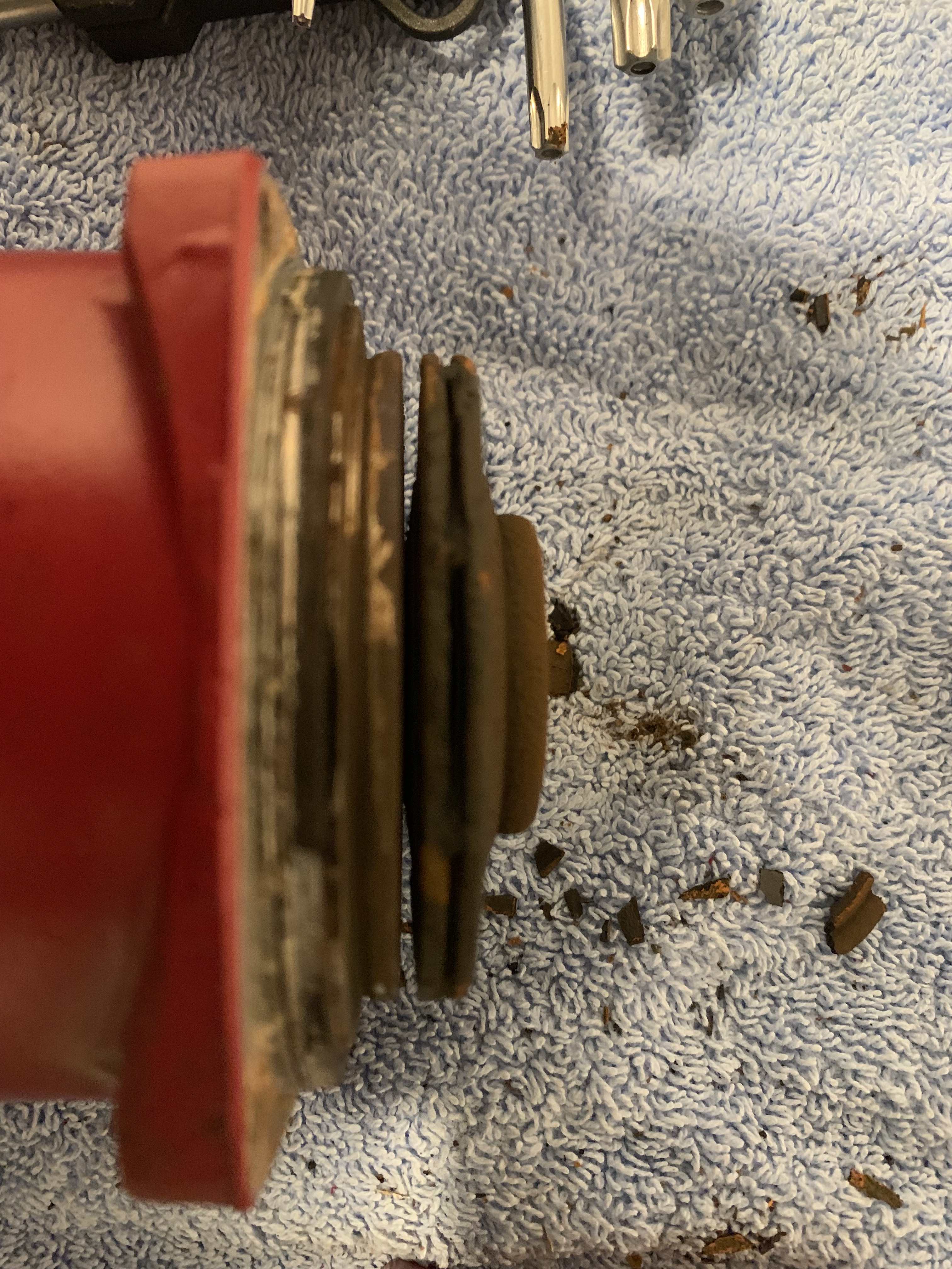

marshian Posted February 19, 2025 Posted February 19, 2025 Well @peaklander sent me his old pump and tonight I had chance to strip it down and transfer the speed controller (to replace the one on my pump which was broken by a hamfisted gas engineer) Easy job but being of an inquisitive mind I couldn’t resist stripping it down completely and I wasn’t surprised at what I found this post is with permission of Tim @Peaklander this is the impeller from above side view other side I could only find a couple of channels that looked like they would pump water

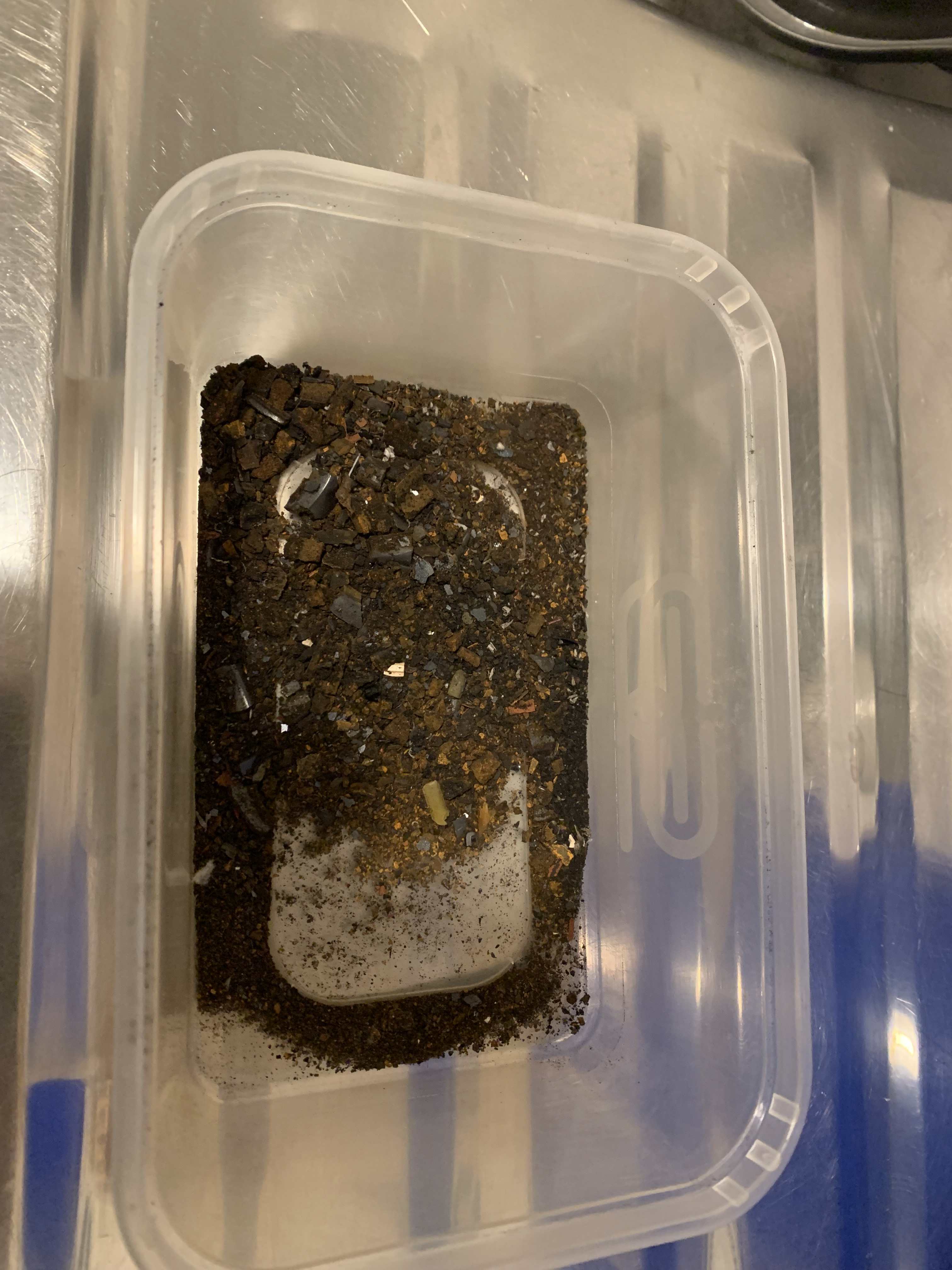

marshian Posted February 19, 2025 Posted February 19, 2025 Gave up trying to clean it out after removing this much detritus pump has a much thinner impeller than my one despite being the same pump??? 1 1
John Carroll Posted February 19, 2025 Posted February 19, 2025 All because the vent wasn't carried up and over the F&E Cistern originally?.
marshian Posted February 19, 2025 Posted February 19, 2025 28 minutes ago, John Carroll said: All because the vent wasn't carried up and over the F&E Cistern originally?. I don't think so @John Carroll I think @Peaklander parents system is dirty - the magnetite has built up in the H above the pump and in the pump itself The original issue was probably caused by the blockages in the pump impeller but replacing the pump for a new one (and probably much more powerful in terms of flow rate) resulted in the pump over that wouldn't have happened with the original pump It's not the first time I've seen a pump restricted like this it happened to my own system - I couldn't work out why a system that had run for 15 years on the lowest pump speed and the boiler was happy and then I needed to use speed two to reduce the boiler short cycling because it was unhappy It took me a long time to work out what was happening - probably too long if I'm honest I'm adding to the post just so anyone searching for similar faults can see that a check on the pump might be a good first port of call
