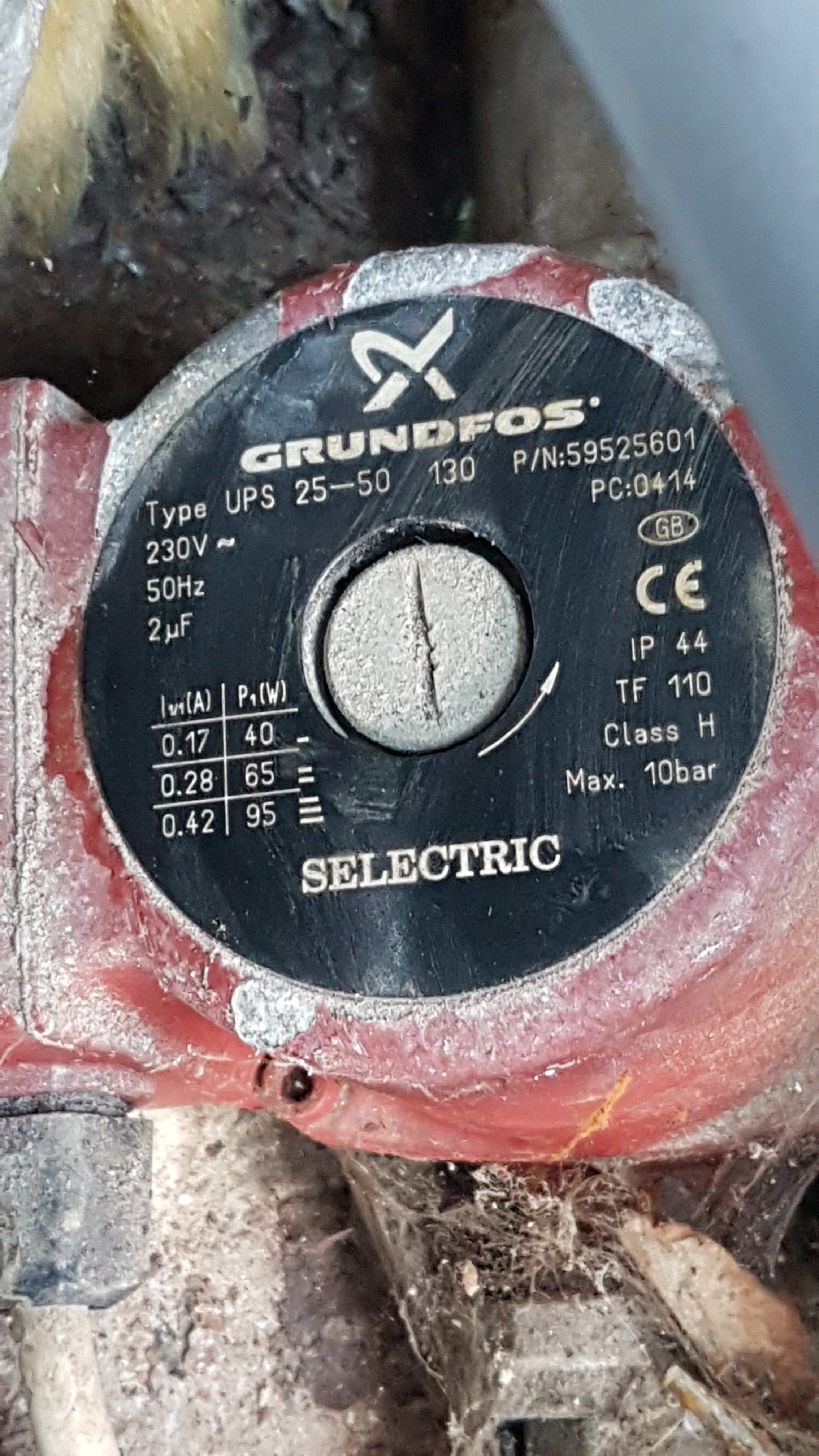

That pump is a relative youngster, PC0945, week 45 2009. My daughters is PC0414, week 14 2004, look at the way its installed! Upright! and still running perfectly, don't know when Grundfos manufactured the cobweb though.

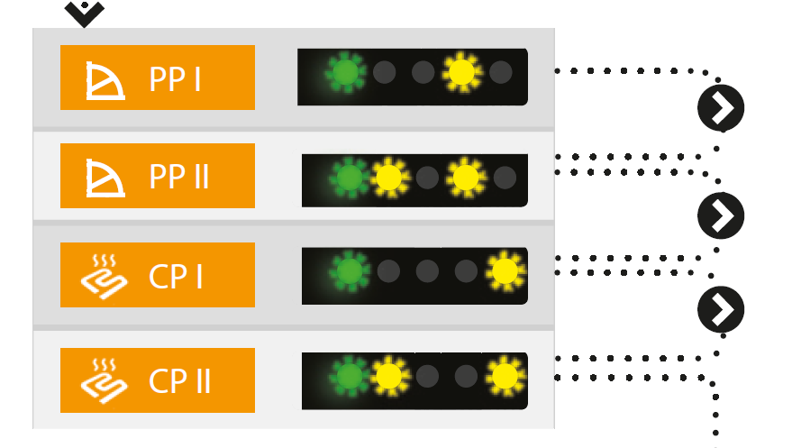

Ok some pics plus my father is having some sort of issue which I’m keeping an eye on.
This is the first setting and the water flow over.
This is PP2 with reduced water that sounds worse than it is. That just means I should have looked and not listened.
There is scope to lift the height of the vent.

OK so pump over can be reduced but even on lowest pump speed/pressure it's still there.

Do the LEDs flash when changing modes/settings, don't know if this is for your particular pump or not but its showing pulsating LEDs in PP or CP mode?
Yes the yellow leds flash on those variable speed modes - just needed to catch it right with the phone otherwise they are OFF!
I haven't gone to PP1. I will leave until Tuesday and I suspect that Plumber #2 will want to remove the tank as I said. I think I can risk that. Screwfix have the parts ready for me to pick-up.
