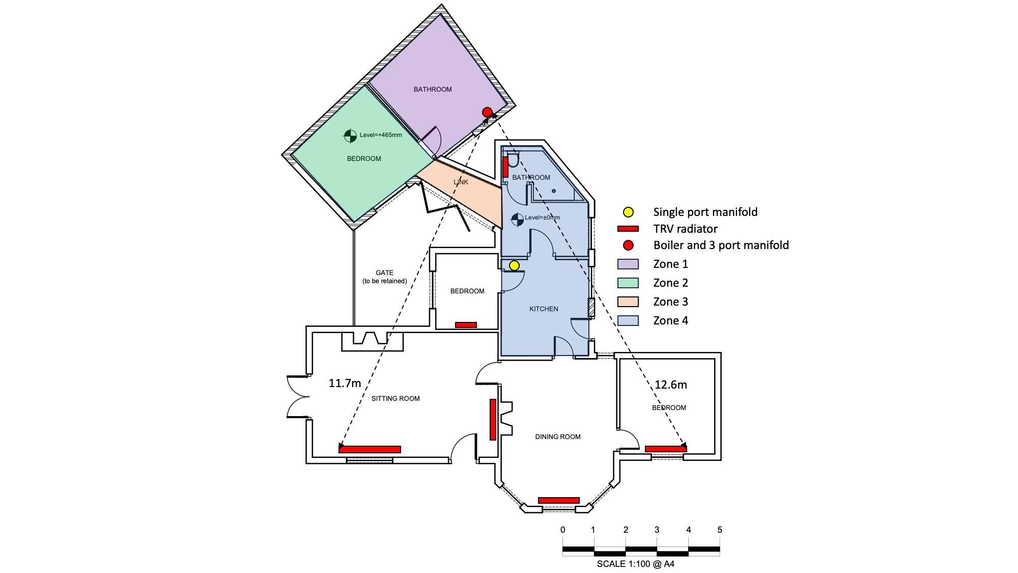

tvrulesme Posted Thursday at 16:23 Share Posted Thursday at 16:23 I have a central heating system in our old bunglow which is due to be added to with an additional 3 UFH zones as part of an extention build. Currently the thermostat is a bit of a hack as when I moved the boiler to what is currently the garage, the thermostat struggled to connect via RF due to very thick walls in this old property. Looking to upgrade this and add some Smartness and control for UFH. I'm currently narrowing down options to: Tado - v3 system doesn't appear to have extenders which worries me. X looks very expensive. Customer support from reading on forums seems to be very slow and with rubbish answers Drayton Wiser - Limited support for UFH. People seem to moan a lot about connectivity Heatmiser - We have this at a previous home and after an argument with their returns department I swore I would never buy again but may have to bite humble pie Any other systems I should be looking at or any of the worries above I should not be worried about? House layout with existing rads and proposed UFH zones below. Zone 4 already exists and is working well My main requirements are: Must be able to communicate through thick stone walls Wall thermostats would ideally have integrated humidity sensor. I’ve been battling (and mostly winning) against a lot of damp so want to ensure I am still in control. Ideally would not require separate humidity sensors Should be controllable remotely. Needs the ability to have multi zone underfloor heating integration Will need multiple thermostats. I can go wired but would prefer the choice of battery or wired My boiler is a Viessmann Vitodens 100-w Link to comment Share on other sites More sharing options...

JohnMo Posted Thursday at 16:41 Share Posted Thursday at 16:41 Be careful with the number of zone and their size. Small zone means boiler short cycling. Which in turn results in bigger than expected energy bills. Humidity issues indicate an issue with ventilation, use ventilation to resolve dampness. You only need thermostats with humidity sensing, for cooling, not for heating. I like Computherm thermostats they are not smart but are good and transmit through think concrete walls, and into a foil lined shed without issue. UFH is best left to tick away on a low flow temp. Link to comment Share on other sites More sharing options...

tvrulesme Posted Thursday at 16:48 Author Share Posted Thursday at 16:48 4 minutes ago, JohnMo said: Be careful with the number of zone and their size. Small zone means boiler short cycling. Which in turn results in bigger than expected energy bills. Thank you. Very good point. I'll look into this 4 minutes ago, JohnMo said: Humidity issues indicate an issue with ventilation, use ventilation to resolve dampness. You only need thermostats with humidity sensing, for cooling, not for heating. Most issues have now been resolved but I want to continously monitor going forward given how much effort I've invested in sorting 5 minutes ago, JohnMo said: I like Computherm thermostats they are not smart but are good and transmit through think concrete walls, and into a foil lined shed without issue. Not heard of these. I'll take a look. Issue is the need to control remotely so would ideally need smart. This place is 45 mins from my home and I often log in and wack on the heating while I'm driving there. Remote access is a must Link to comment Share on other sites More sharing options...
tvrulesme Posted Thursday at 16:49 Author Share Posted Thursday at 16:49 2 minutes ago, JohnMo said: Why not just a Shelly H&T (or similar) in each room, integrate into a min max helper and use a generic thermostat, do it in home assistant. Then bounce the signal about via wifi? Love Shelly, hate the H&T. It was a PITA before I gave up and returned. I'm trying to minimise gadgets and wires everywhere so if wall thermostat measures humidity saves having another device Link to comment Share on other sites More sharing options...
